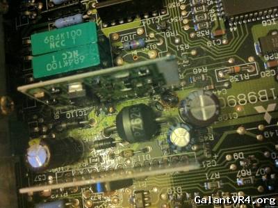

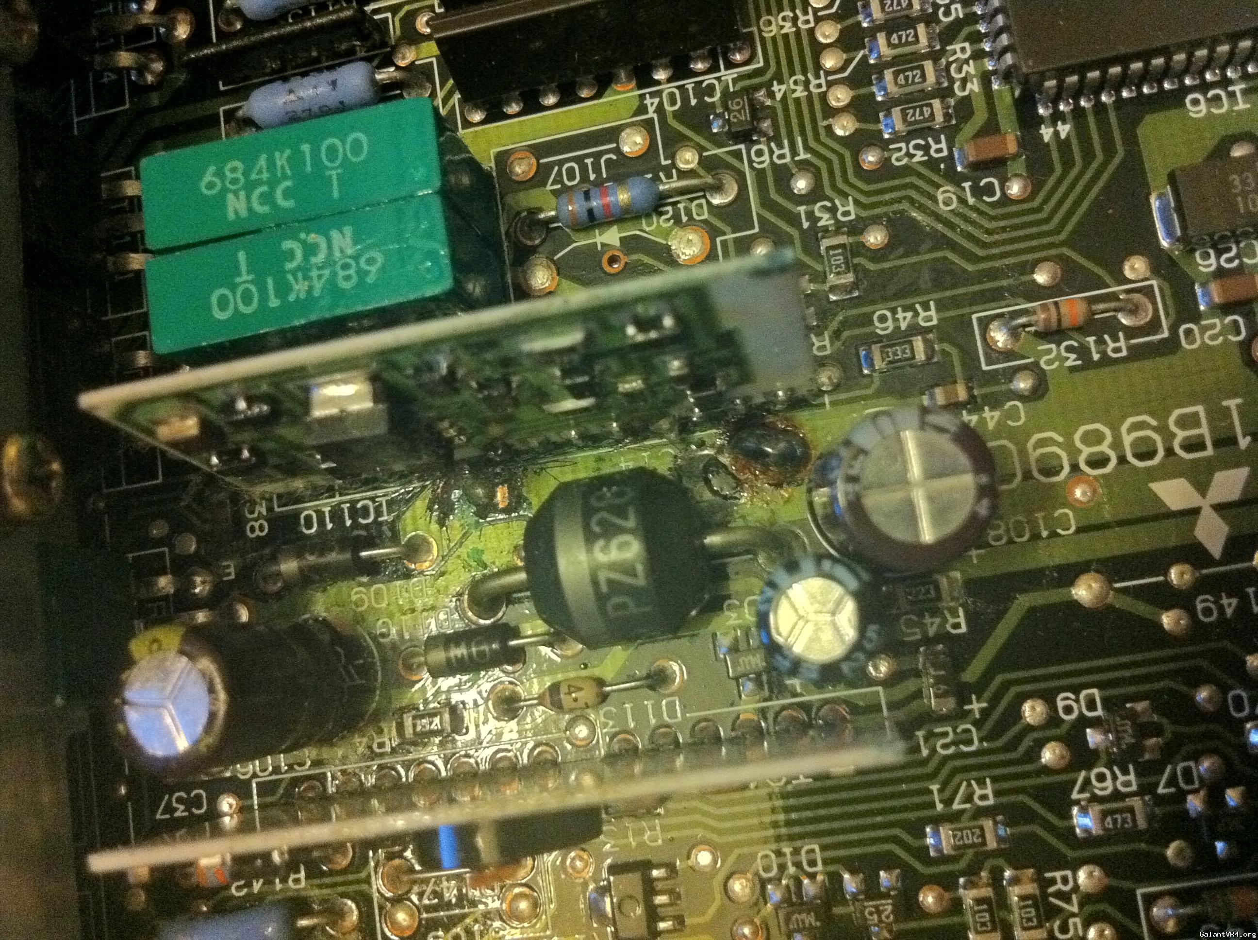

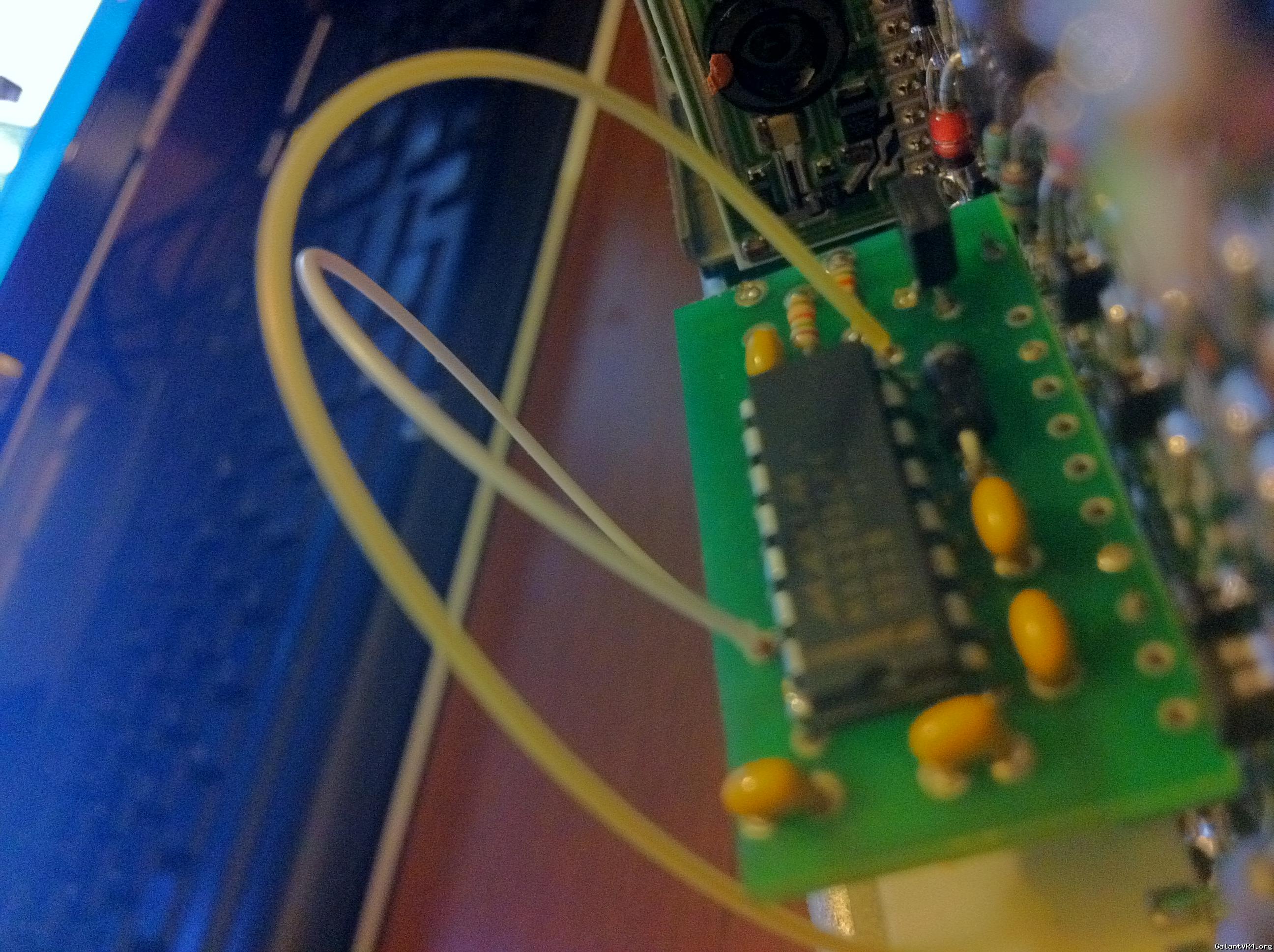

Heres the quick story, so my friend bought a galant vr4 like 2 years ago or so, He drove it home one night and went to drive it in the morning, and it would not start. He thought it was the fuel pump, and never got it running. It sat for over 1 year. He got low onc ash and sold it to me. I towed it to my house. Plugged a 1g ecu in it that I got from a friend and it started right up.

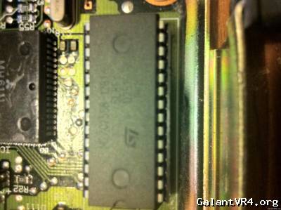

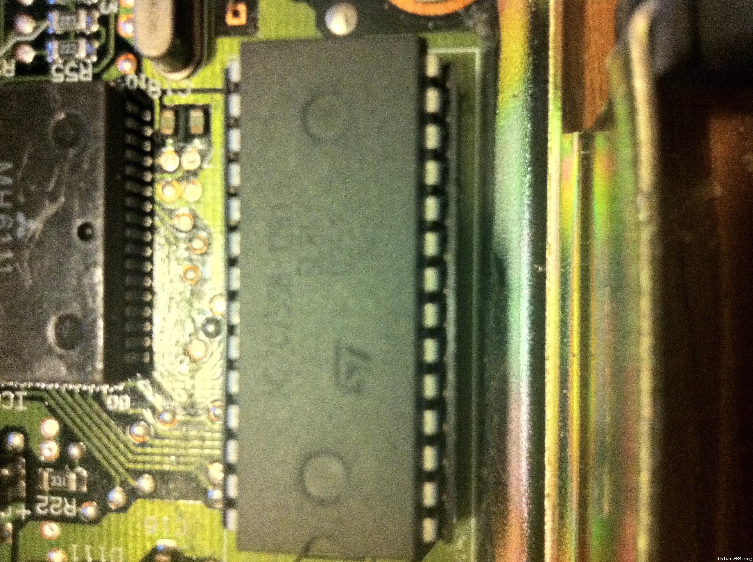

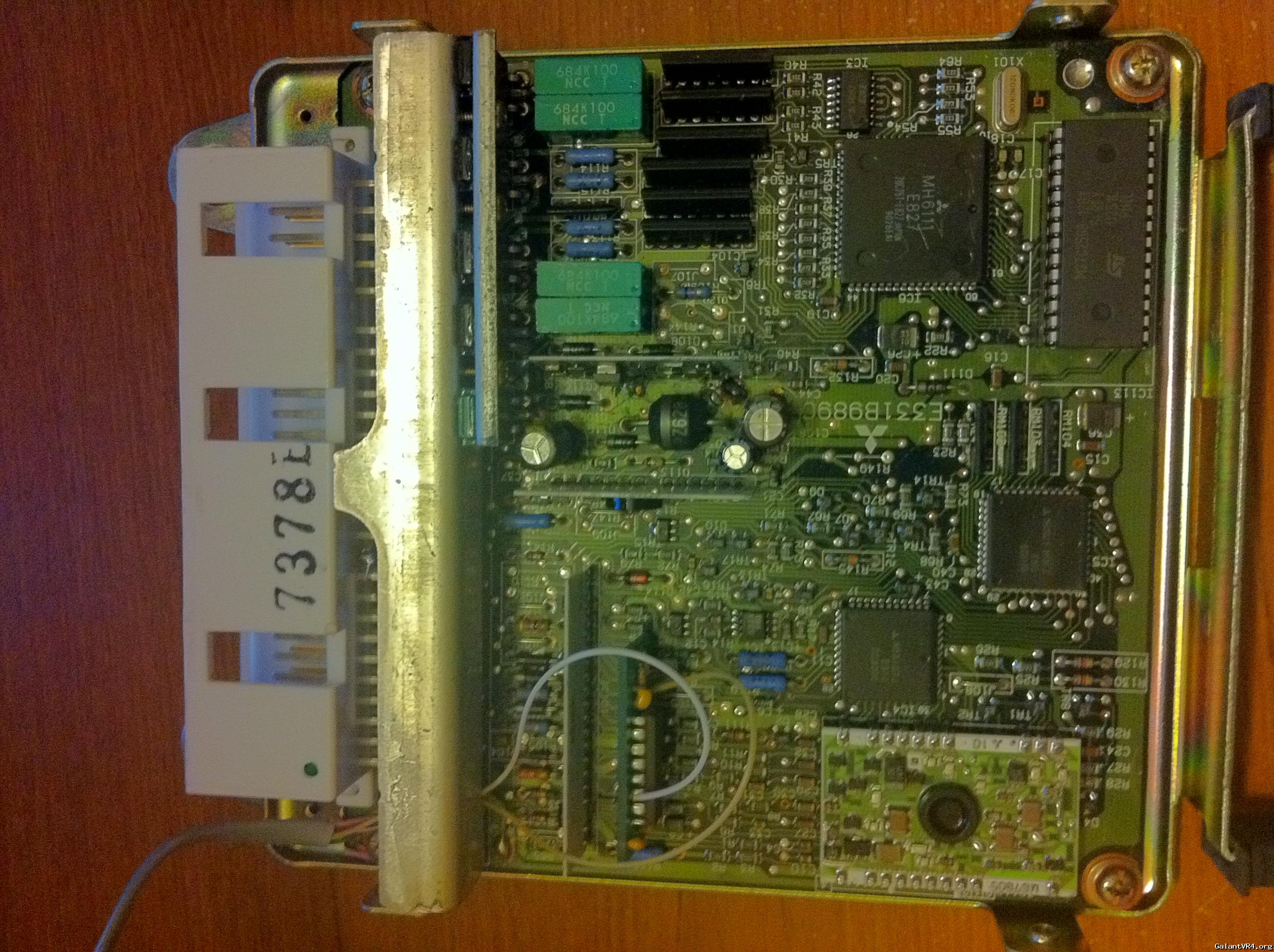

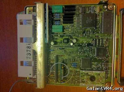

Now when I give the car any gas, it stalls out. I'm not sure if the gas is bad or it has something to do with the ECU. Here is why I think its the ECU. The ecu that went bad, had a keydiver chip in it. Now im not sure what that keydiver chip contains. my thought is bigger injectors, and when it step on the gas the car stalls out because it dumps to much fuel. Here are some photos of the ECU's. If u guys can tell me whats going on with the one that went bad I'd appreciate it. It has alot more going on inside than the one I swapped it for, it has a telephone cable hanging out of it, its socketed and chipped, and has just more crap in it. can u guys please evaluate it and tell me what I have.
The first 4 pics are of the BAD ecu that came out of the car,
The 5th pic is the ECU which i put in, and the car started, and idles

You installed a non-EPROM ECU.
If you get an EPROM ECU, just pop in the old Keydiver chip and it should run as it did before the original issue.
