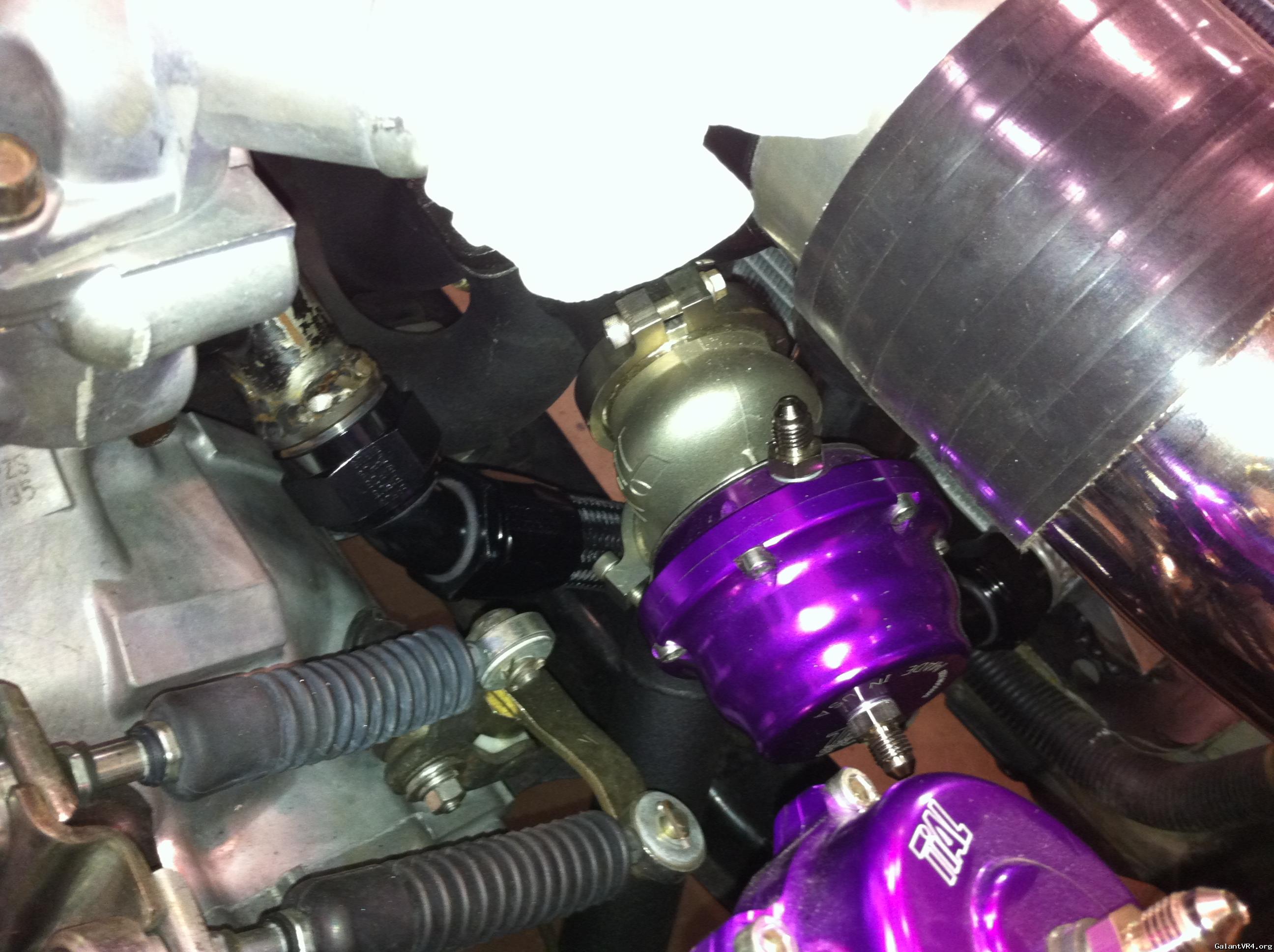

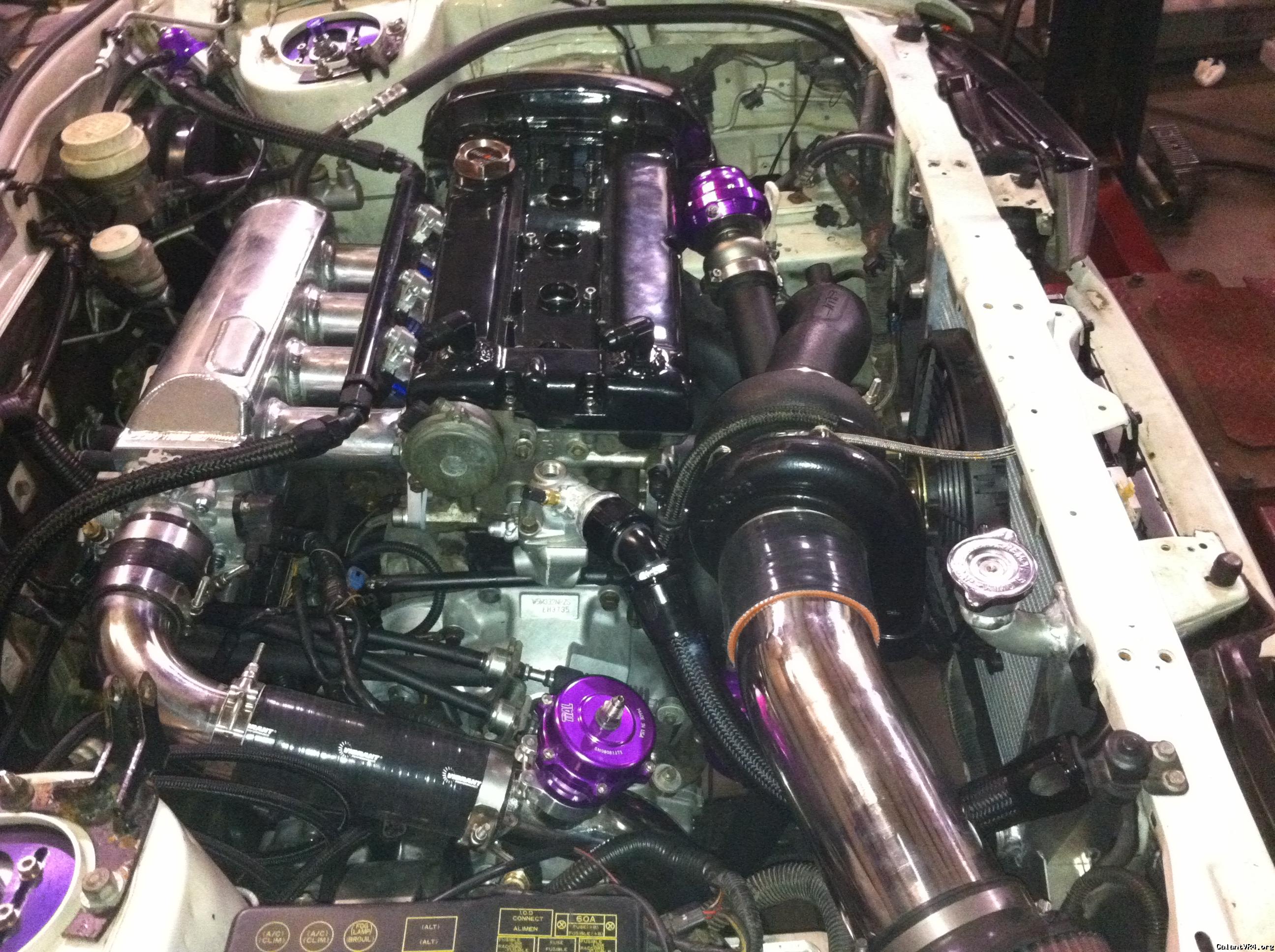

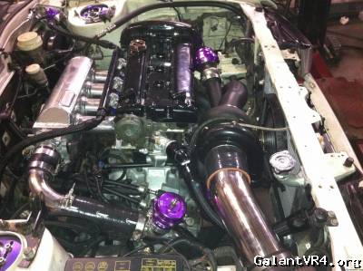

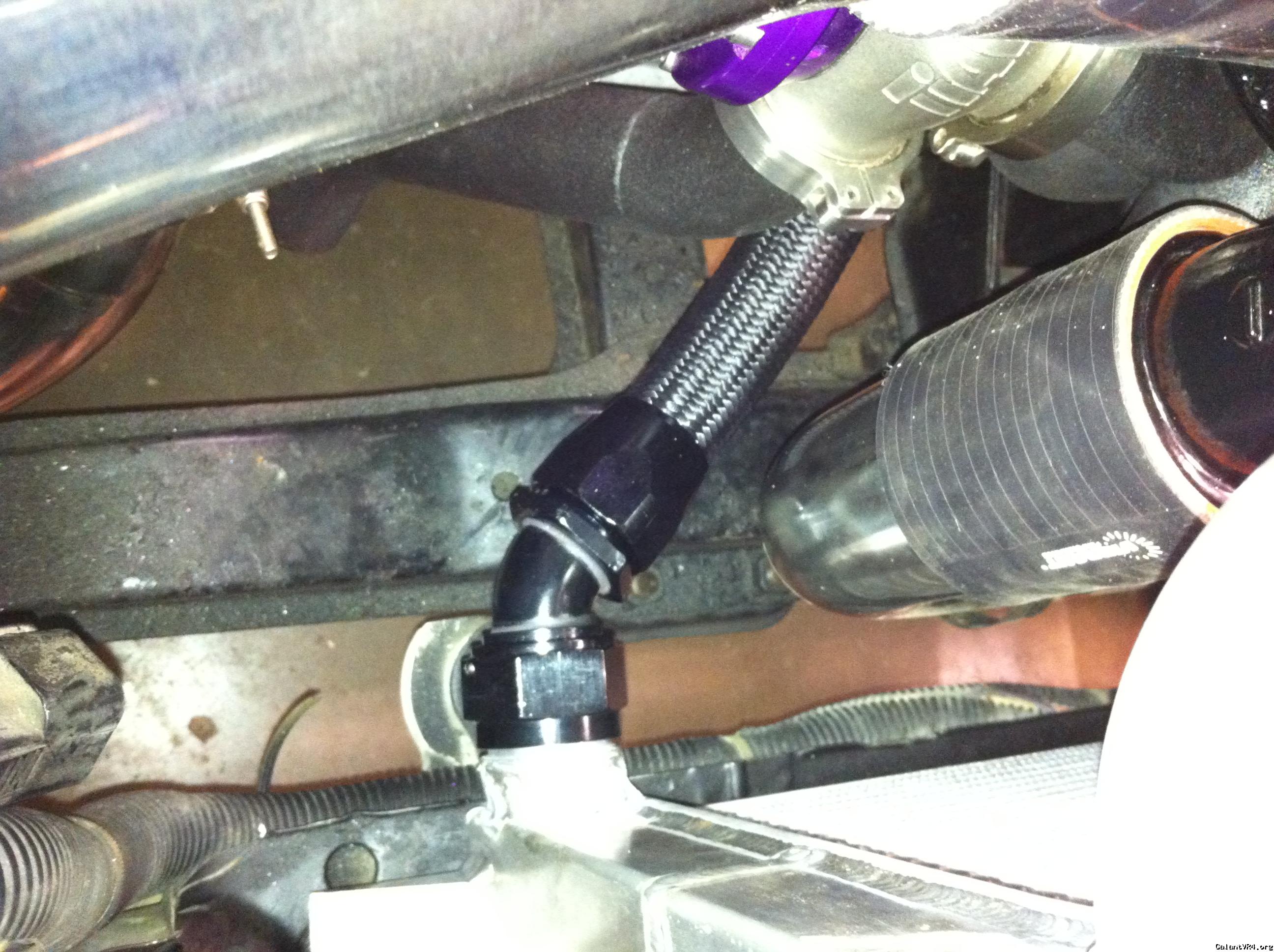

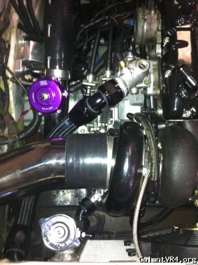

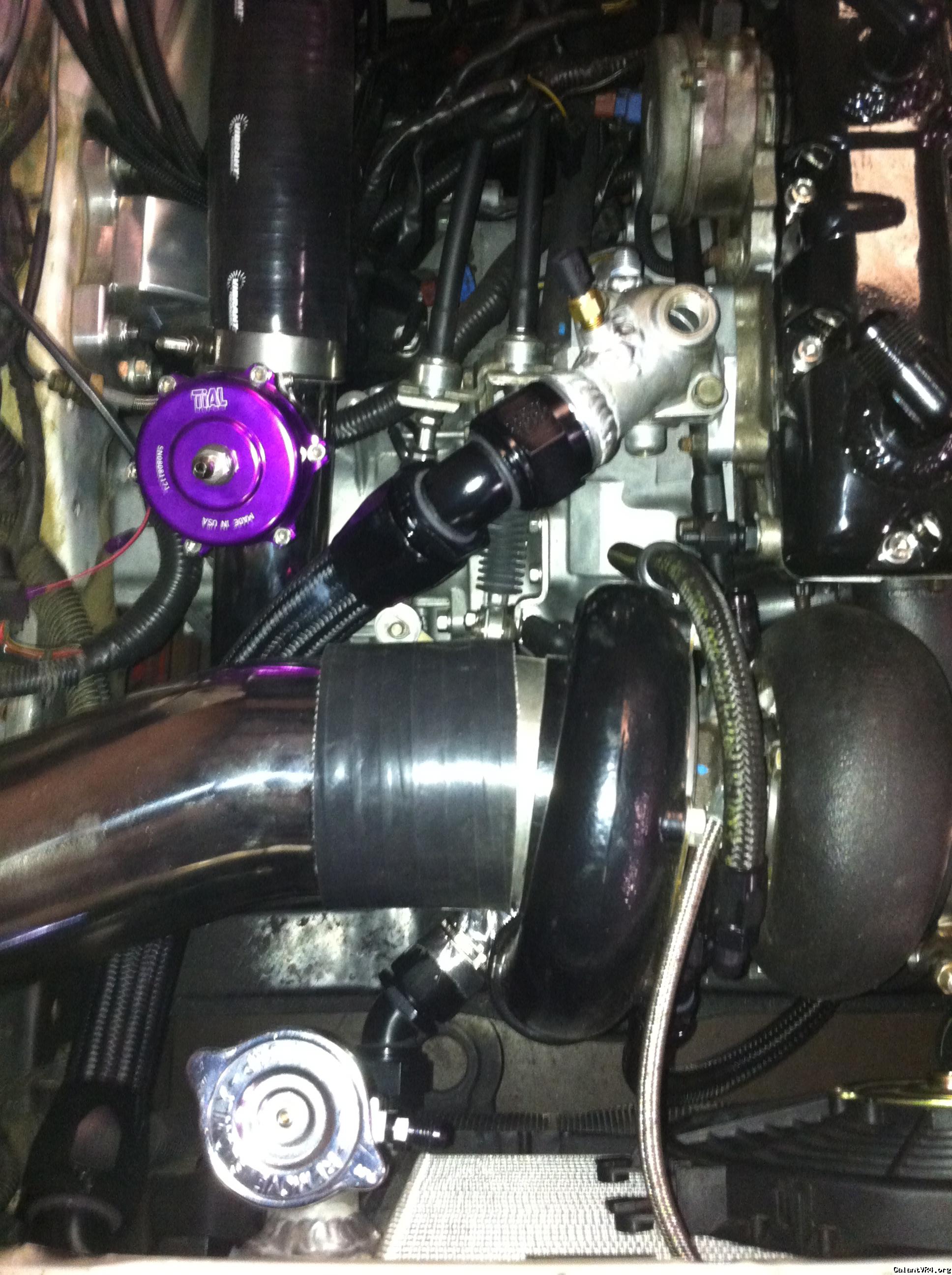

I installed -20an's on 449 because its much closer to the stock line ID. /ubbthreads/images/graemlins/wink.gif
I vote -20an.....But.....rubber hose is much easier to deal with just saying /ubbthreads/images/graemlins/crazy.gif

Price out earls -20an black ano tuff and some earls light weight hose then tell me who's crazy lol
