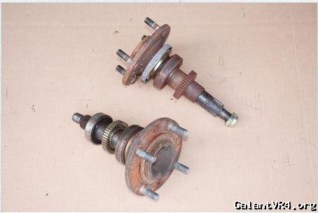

That looks like a FWD rear hub assembly. The AWD assembly has an axle shaft built into it that bolts on the inside of the axle cup. Also, the outer bearing normally stays on it and has to be removed, the inner bearing will need pressed in/out. Here is a pic of them and a link to a set for sale. The bearings and inner seal can be found on RockAuto.
PerformancePartout
10,996
Yes, you have FWD brearings. Looking at Tom's provided photo, you can see that you need to remove the rear axle shafts and get to the 22mm (I believe) nut to be able to tap that complete stub axle assembly out to replace the bearing.
see this thread for good instructions: How to
