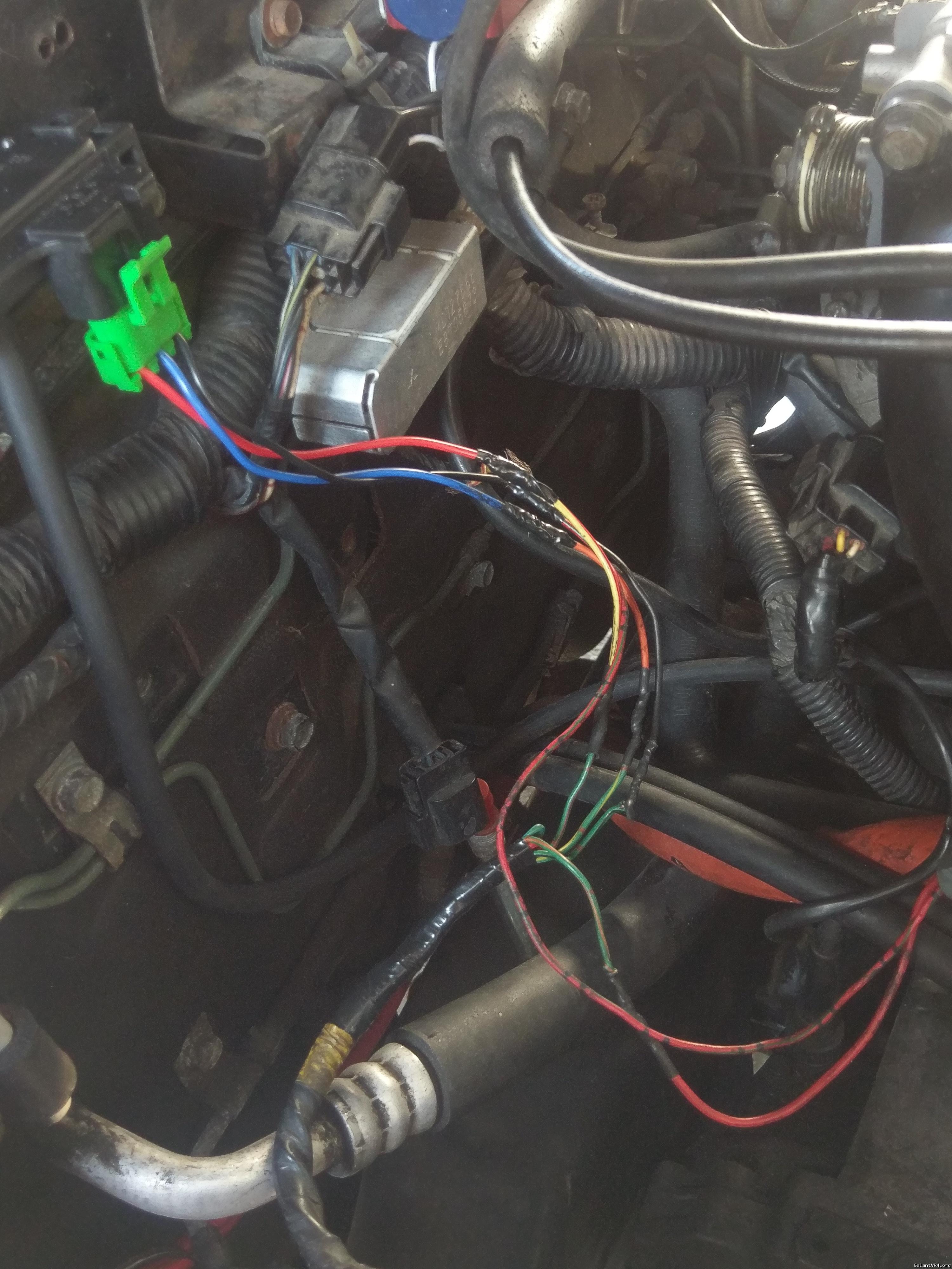

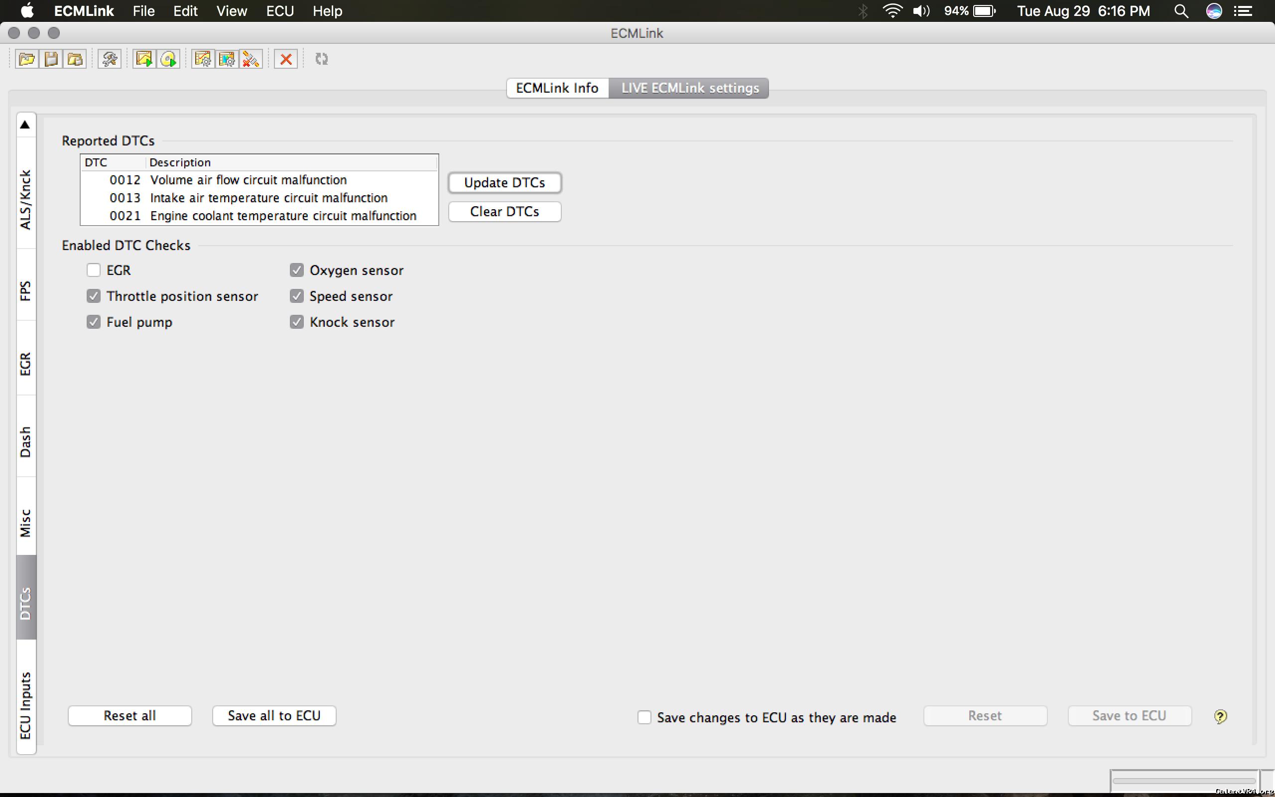

So I recently took off the engine head to get it rebuilt and managed to put it back together. Everything seemed right except for the wiring. /ubbthreads/images/graemlins/banghead.gif I bought a new MAP (omnipower 4bar) sensor and am having a hard time getting all the connections right. I will try to upload some pics tomorrow, but if anybody is nearby and willing to help I would gladly appreciate it. For now, here is the current DTC error codes. I am located in Queens, NY btw. Thanks
3,473
Looks to me like ECMlink is still configured to use a MAF.
How do you have the sensors wire to the car? Did you use the PnP SD harness ECMlink sells?
Also, verify the CTS is hooked up. It will be in a separate small harness alone with the fan switch, A/C switch and a few other connectors that run to the thermostat housing.
Lastly, post a log. I'd bet your configs are dicked up as well.

Jesus f***, what a mess. I'd bet there is your problem.
Step 1, cut all that sh*t out.
Step 2, rewire everything with solder connections and insulated shrink tubing. Use this guide here click and here click
Edit: Your MAP has a blue wire instead of yellow like mentioned in the link provided. Blue goes to the harness baro wire, black is ground and red is 5v.

So after rearranging the wires, the car starts and the only code popping up is 0021 (Engine Coolant Temperature Circuit Malfunction)
The boost light on the dash is for some reason always turned on at least half way
and I have a lot of gasoline being smoked right up /ubbthreads/images/graemlins/banghead.gif

Your coolant temp sensor is either unplugged or ones of the two wires going to it are broken. You won't run right with your coolant temp @ -74 all the time. You will dump fuel.
