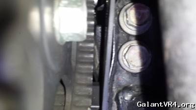

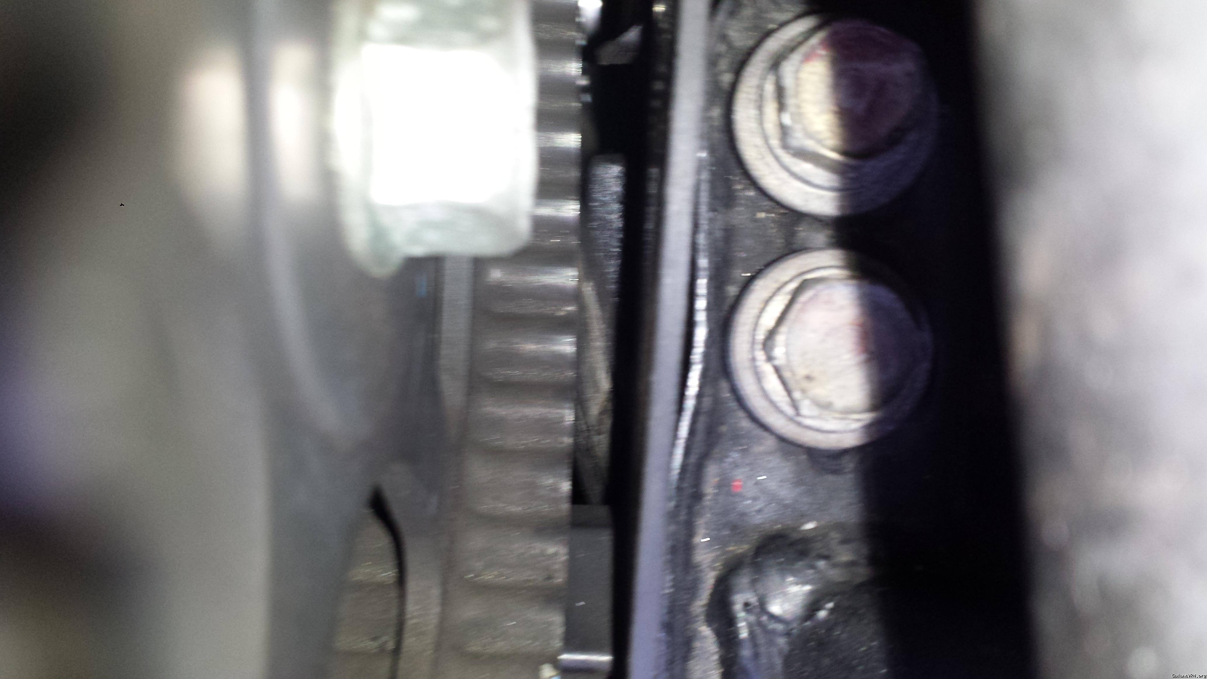

Alright I popped the timing cover off real quick even though it's raining. Condition of the belt seems fine, I didn't notice anything obvious where things could be rubbing, except it seems there is a piece of rubber sitting down atop the engine mount? I can't tell what it is, and couldn't get it out with needlenose. Also I noticed the timing cover next to the coil is missing a bolt, perhaps this is making things rub. I am gonna do some more troubleshooting later this week. I took a photo the best i could of the rubber piece, maybe some of you can chime in on what it could be. Seems like timing cover gasket? I can move it around with a screwdriver.
it's the diagonal aligned piece directly beneath the cam gear. I probably sound like a total noob to you guys but I'm glad you're around to deal with all my dumb questions and troubleshooting and make sure things are done right.

It's a rubber seal for the timing cover. You can't just pull it out with pliers because it goes around the engine mount bracket in a full circle. You need to take the mount off, and top bolts for the cover off and try to put it back on without taking the lower cover completely off. Might work, if not you will need to take the whole cover off to put it back on. Unless it's old and brittle you shouldn't need a new one right now. If you do, I'm not sure if you can buy that separate from the lower timing cover. I doubt it would fall into the belt if it's not brittle, but it could happen and that's not good.
