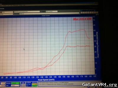

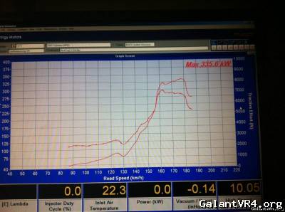

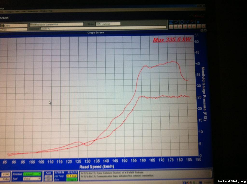

Here is my current dyno graph with the current Cam config which suited the gt35r as it did come on much sooner.

If you had a dyno sheet with rpm that would be very helpful. Why does your car drop off so hard at around 6000 rpm? My 35r pulled to 9 and wanted to keep going, since your turbo is bigger it shouldn't fall off like that... I mean your still making 25 pounds of boost and yet your horse power dropped 50kW... Might want to start by just degreeing your cams again I think that would be step one.
Quoting bazeng:
180 kph is about the 6000 rpm mark

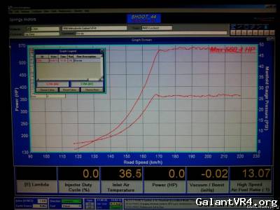

Power band has opened up extremely...
Previous Cam timing = power from 160kph to 180kph.
New Cam timing = power band from 180kph to 220kph.
Plus dry ice = power band from 160kph to 220kph.
I think with the graph, wee are maxing put the cams.
Opinions?

You said you wanted to rev 9k. What's the power curve look like past 7500? I had good luck getting top end out of my car by reducing my overlap a little bit. If your curve stays relatively flat I'd just increase the boost. You could make more power up top with cams at the same boost but your just going to give up more down low. Its a vicious cycle of give and take.
