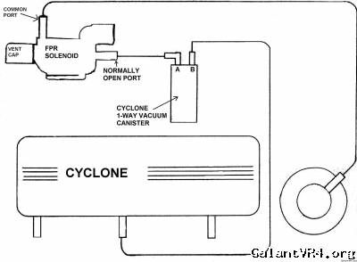

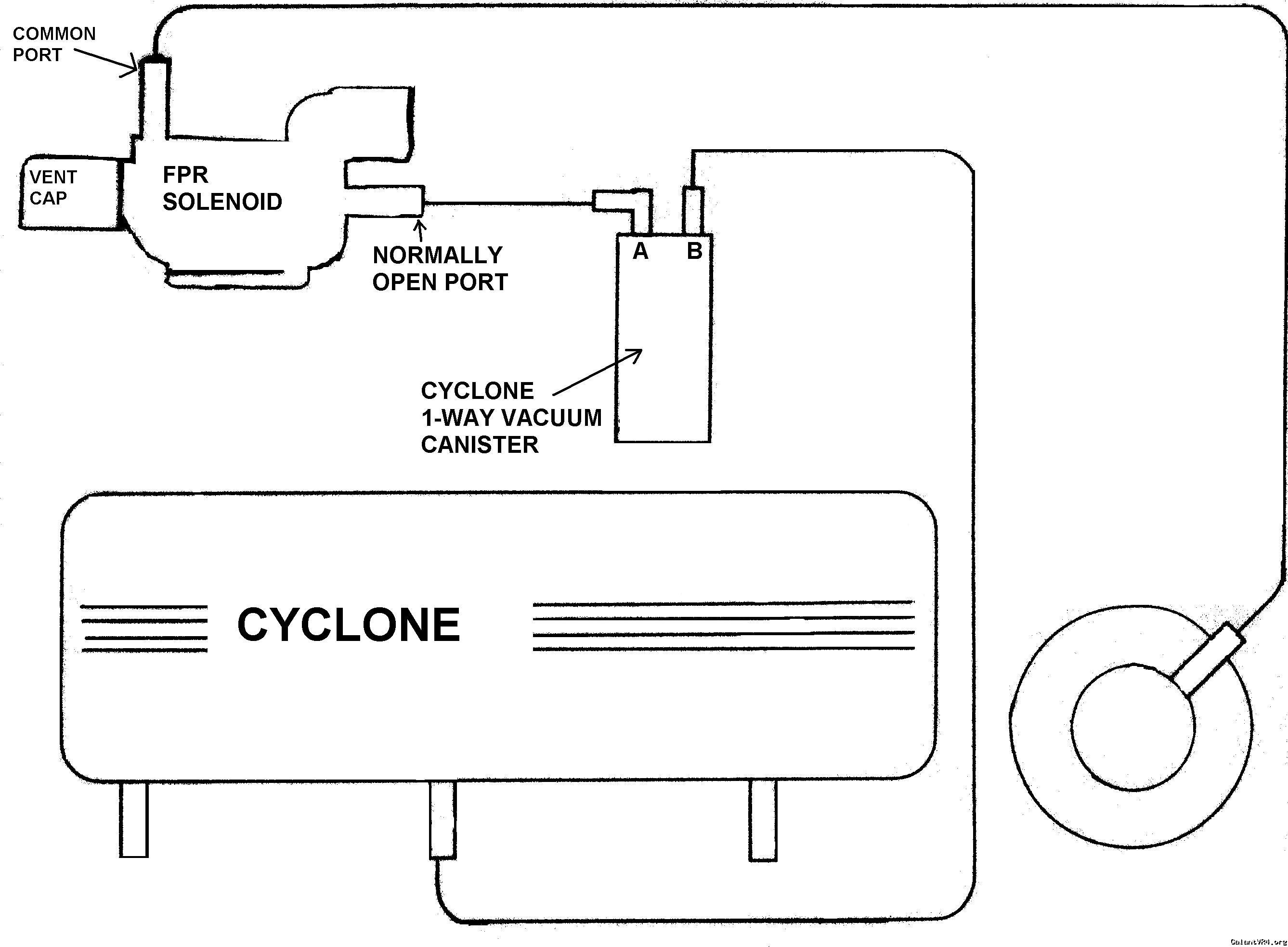

Okay, I'll start with this. I have it setup like this image, I'm using Link to activate through the FPS controls.
Link setup is: start at 1500rpms and stop at 2500rpms for testing. Everthing else is zero'd out.
When I start the car the diaphragm closes the valves so I know it has vacuum, but it won't open when I reach 1500 rpms. Link is showing the FPS is engaging from "0" to "1" when reaching the threshold. Yes, I verified I have the FPS hooked up to the correct plug. Out of curiosity I went ahead and checked the volts coming from the plug and it gets a constant 12v regardless of if I meet the threshold or not. If I'm not mistaking that would mean its staying open the whole time which is not what I want. Can someone verify this for me by either checking your volts at the plug?

One other thing. I can't find anything on the web to confirm this, but I'm pretty sure that the vacuum canister being a one way valve has to be connected in the correct direction. This won't affect your volts but I have a feeling that having it hooked up the wrong way leads to the butterflies being stuck fully open or fully closed (can't remember which). I'm sure you haven't done this but it was just a thought. Sometimes we get wrapped up in complicated things we assume are the problem and miss something stupid.

You are in fact correct, hooking up the canister is different orientations will either leave the valves stuck in open or closed. I do have it set in the right direction, because when I start the car it see's vacuum and closes the valves.

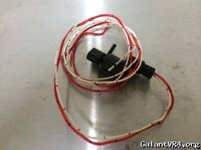

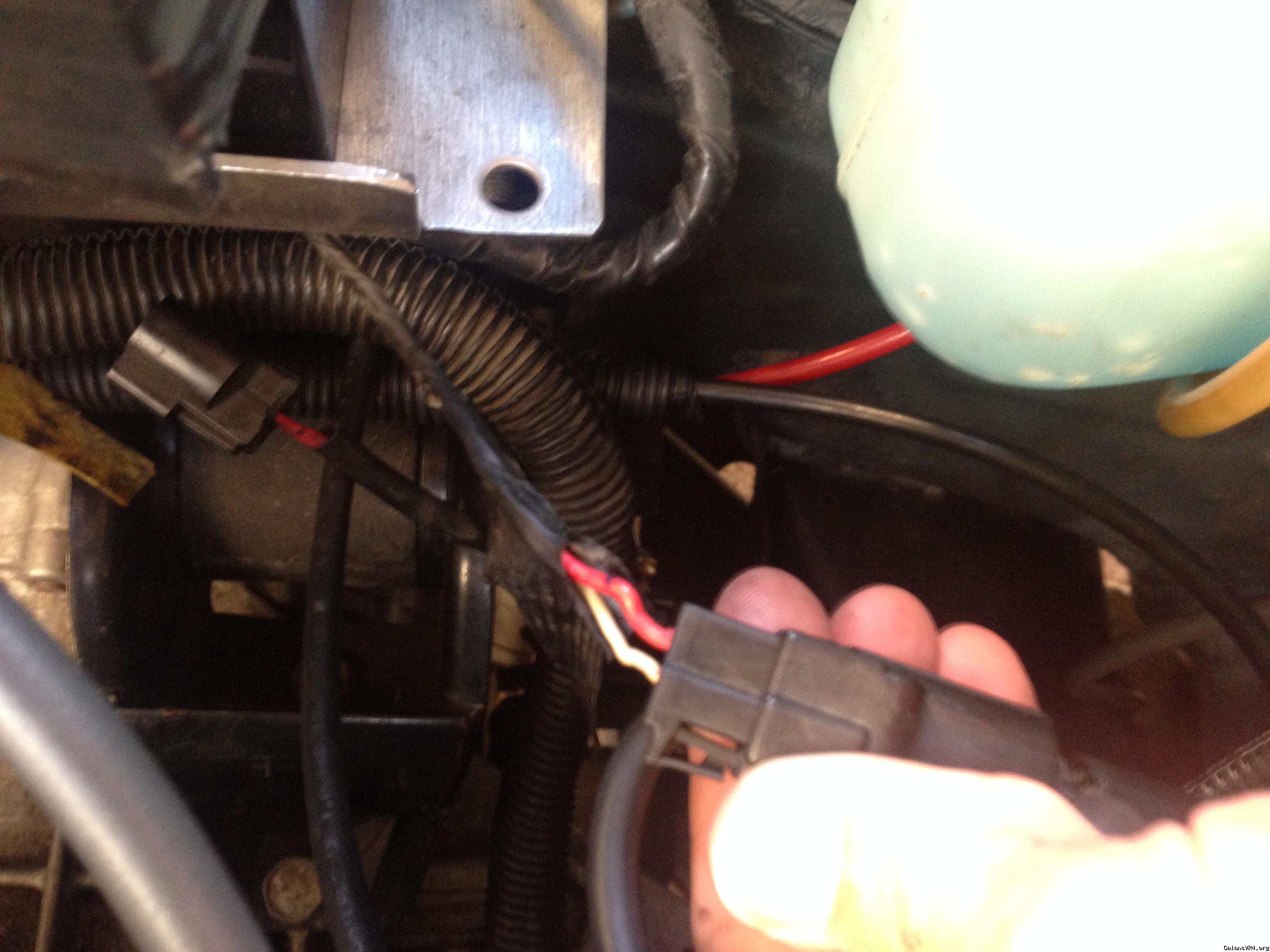

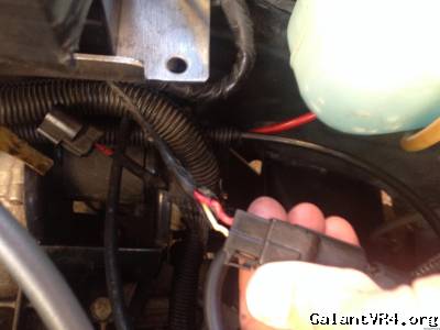

You mean pin 57? to the white one on the plug? That's what I tested. I do in fact gave 12 volts and 13.xx when the car is running coming from the power wire for the FPS. I then hooked up the fluke to both ground and power wire on the plug to see if I get fluctuation when I activate the fps and I did not. Which doesn't makes sense, Ecu is showing it engaging and disengaging, ground wire is good, power wire is getting 12v. I'm baffled. Also to check if the solenoid worked I hooked it up to another plug on the passenger firewall (EGR?) and when I bring the rev up it vents the air and when it drops to idle it'll close the valves again.
This is the correct plug right?
