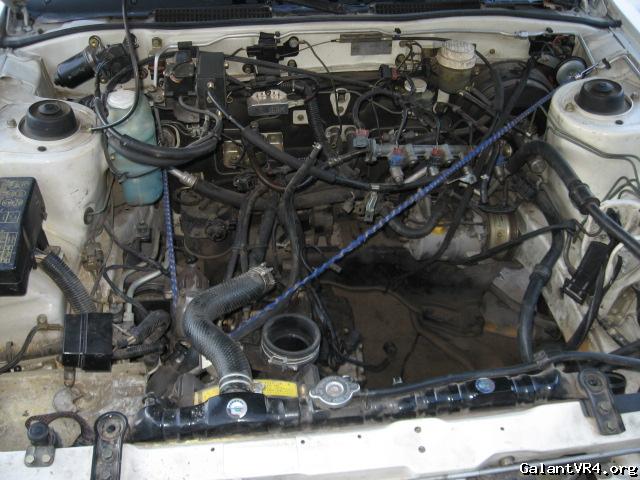

I didn't break the engine down so I'm not sure what the oil pan contents where. I will have to ask. When I got ahold of it there was rust in the internal block and lower section of the cylinder walls, the crank had bit of rust on the main journals. IT is thought the o-ring on the front water pipe at the water pump went bad and that the engine was ran until it stopped running from heat.
Another issue I have run into is wiring. It appears some of the wiring in the engine is brittle likely from being 1. old and 2. exposed to extreme heat.
DAMN this is going to be a bigger project than I had expected.
