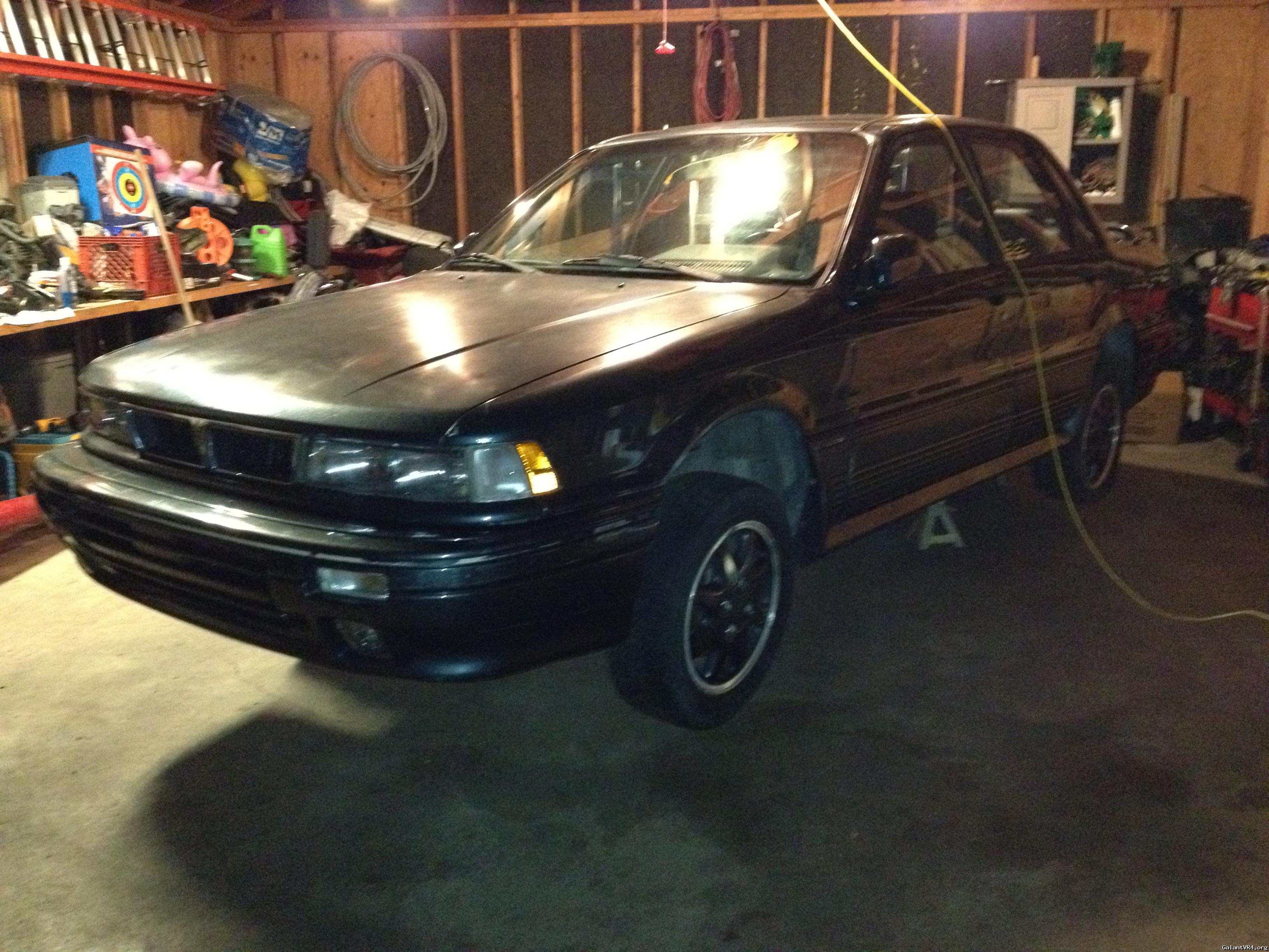

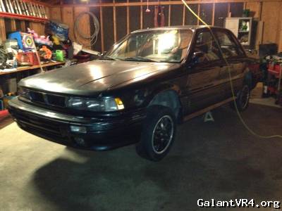

Finally getting the car on the road. Started work on it with my brother on Sunday. Holy crap what a job.
Getting started.

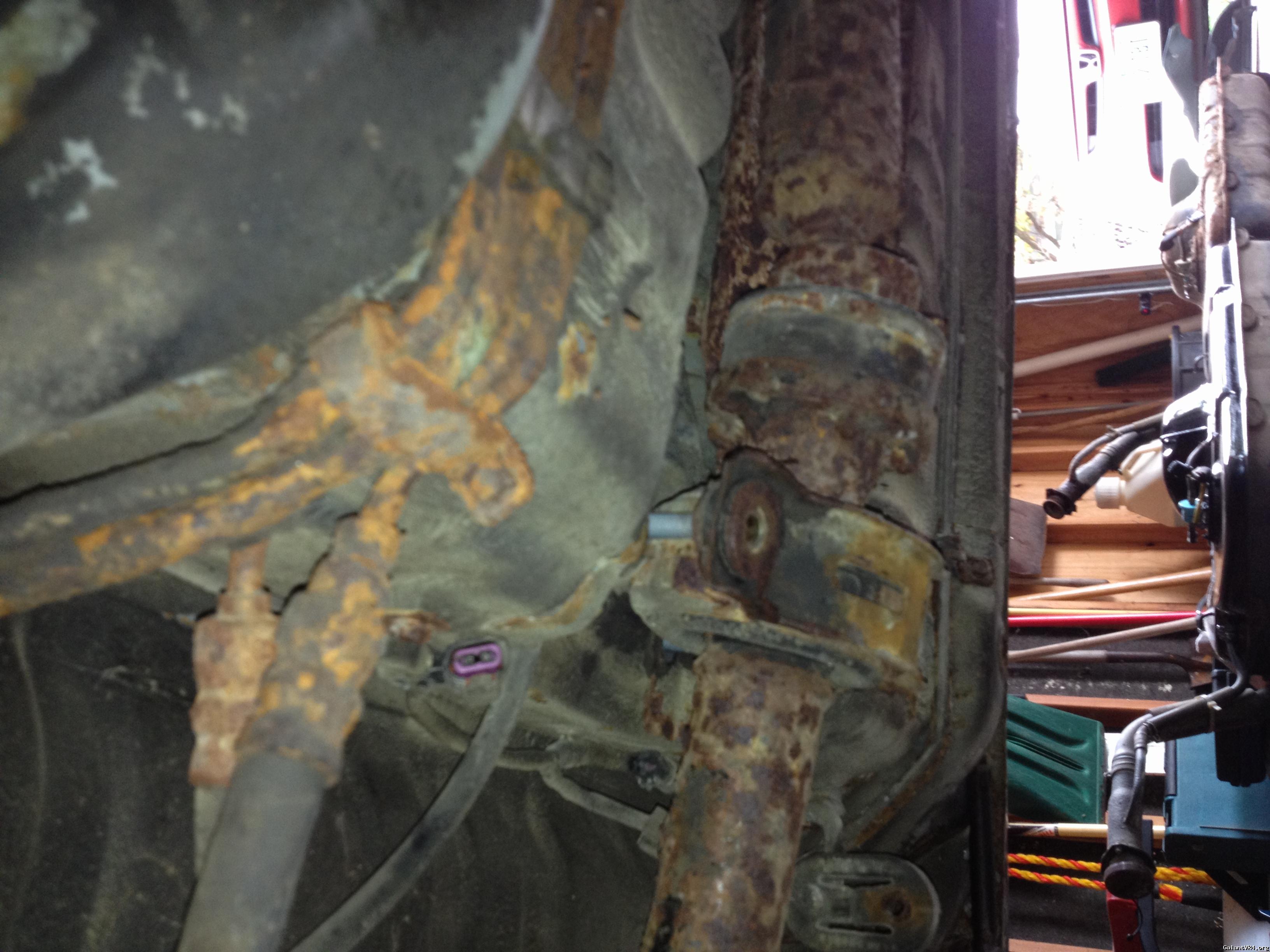

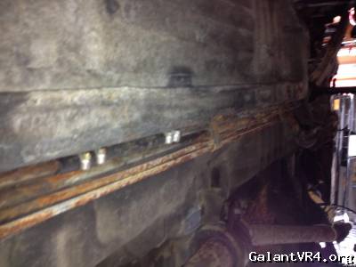

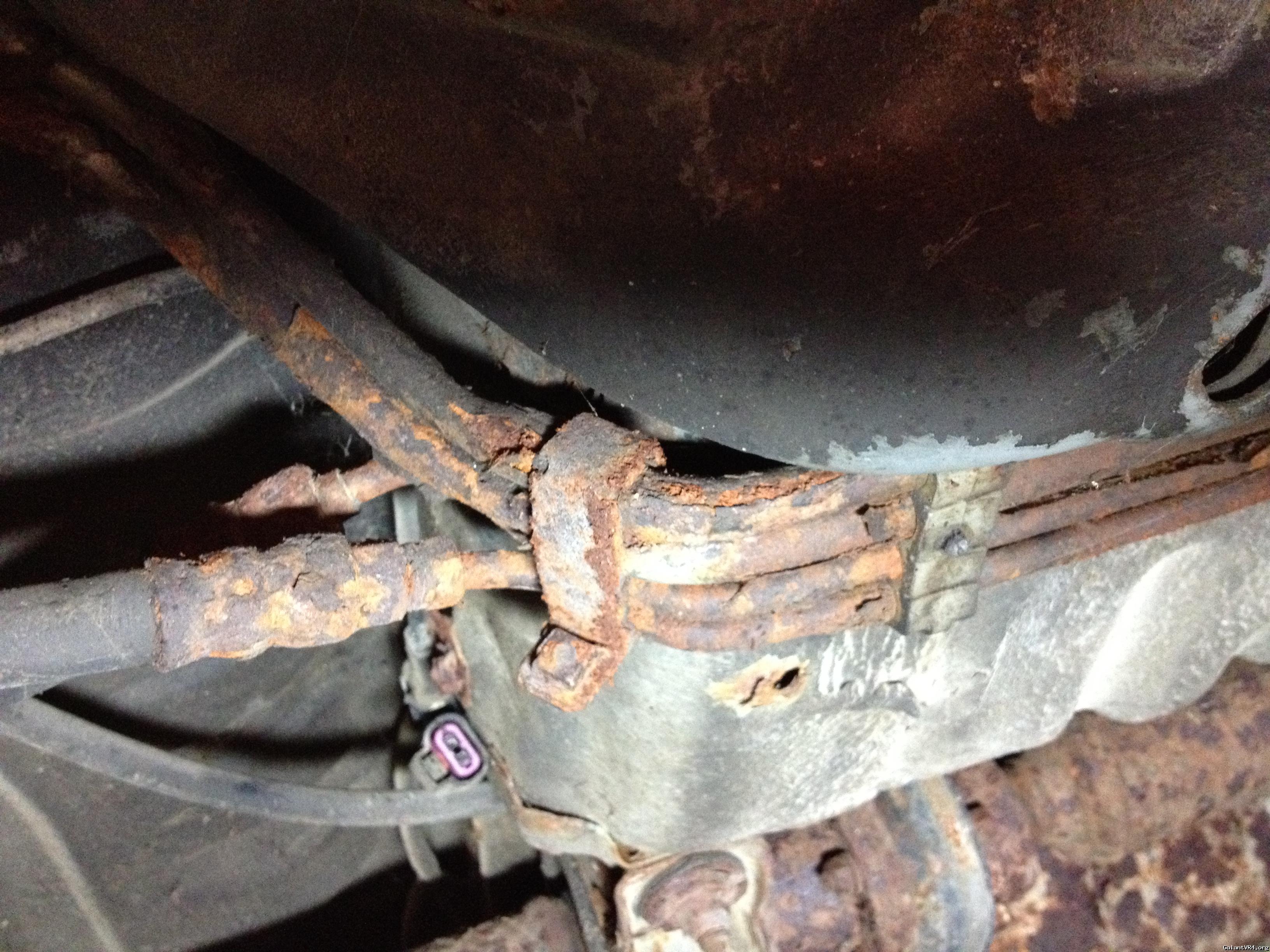

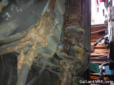

Bad bad bad lines.

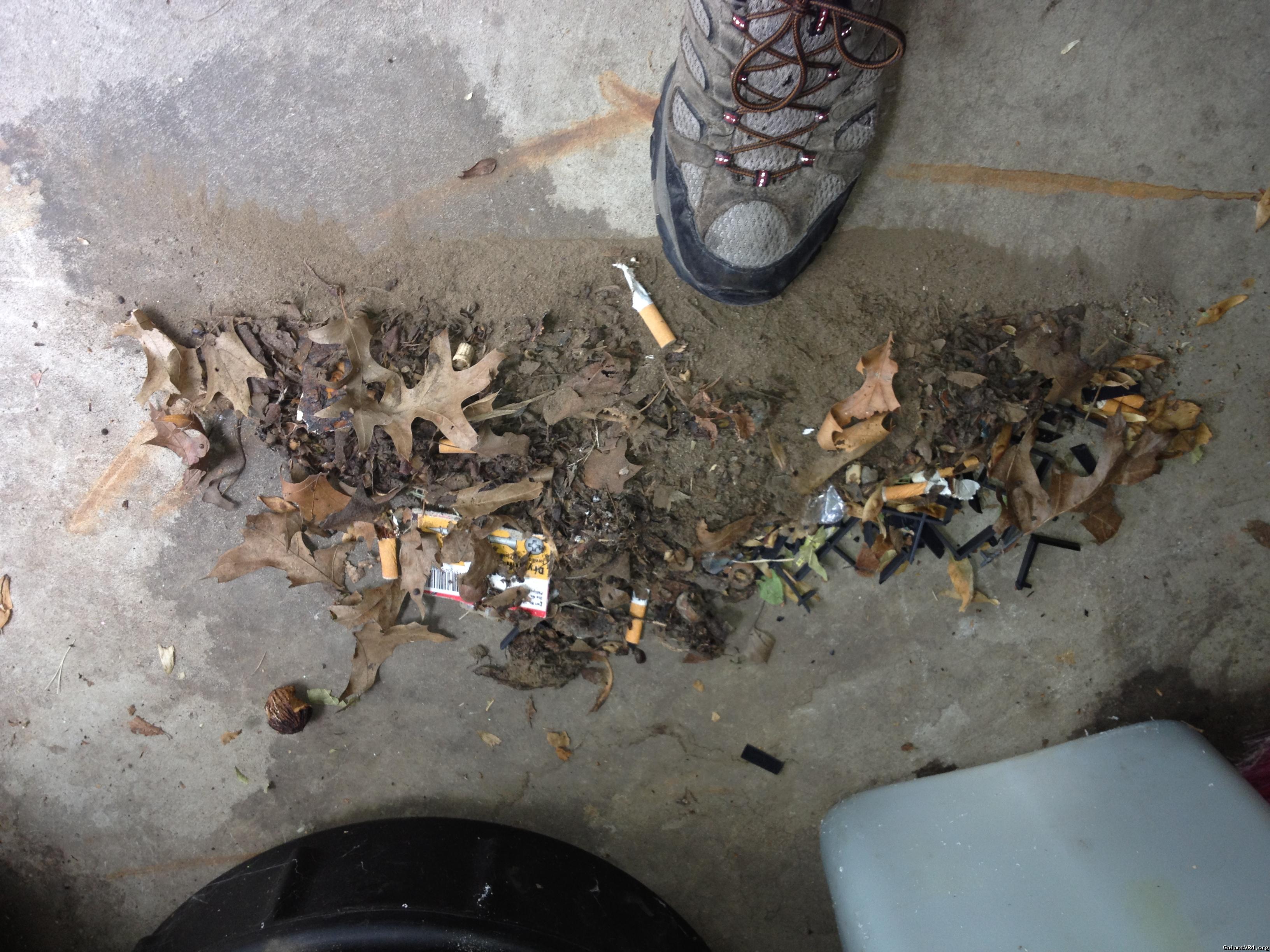

This is what we pulled out of the fenders.

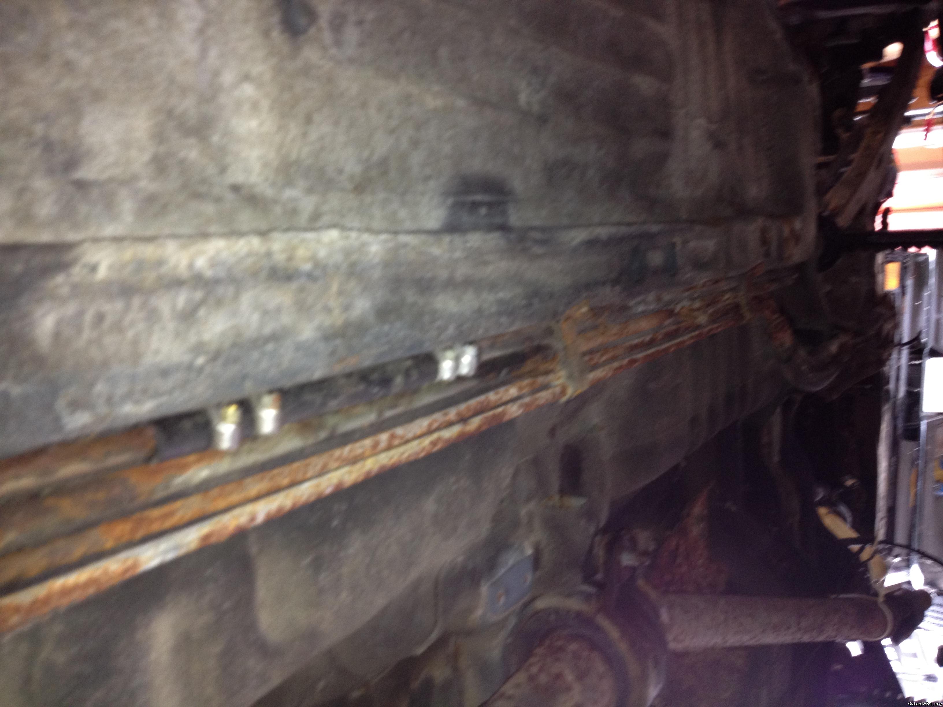

More rust.

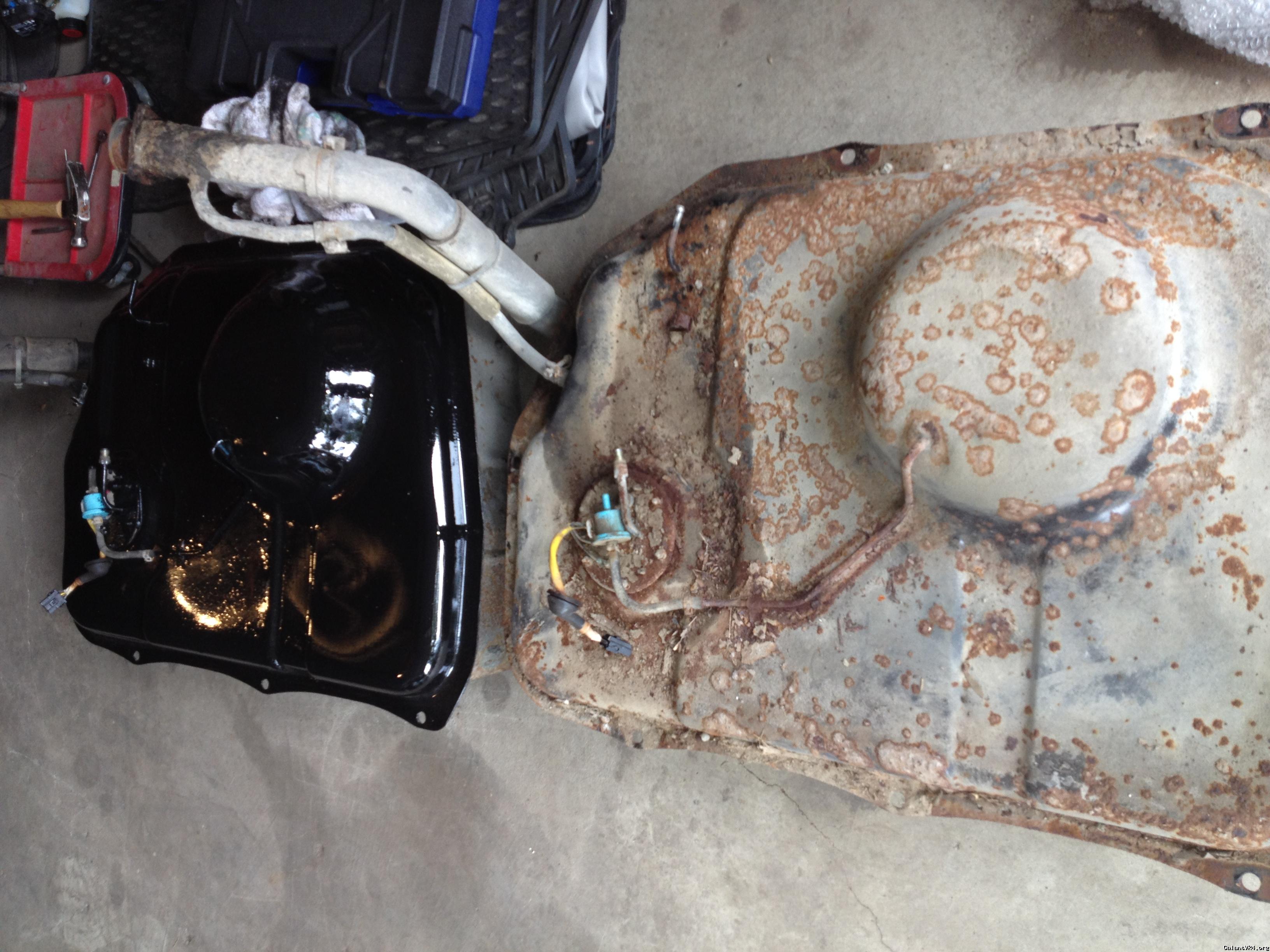

Gas Tanks,

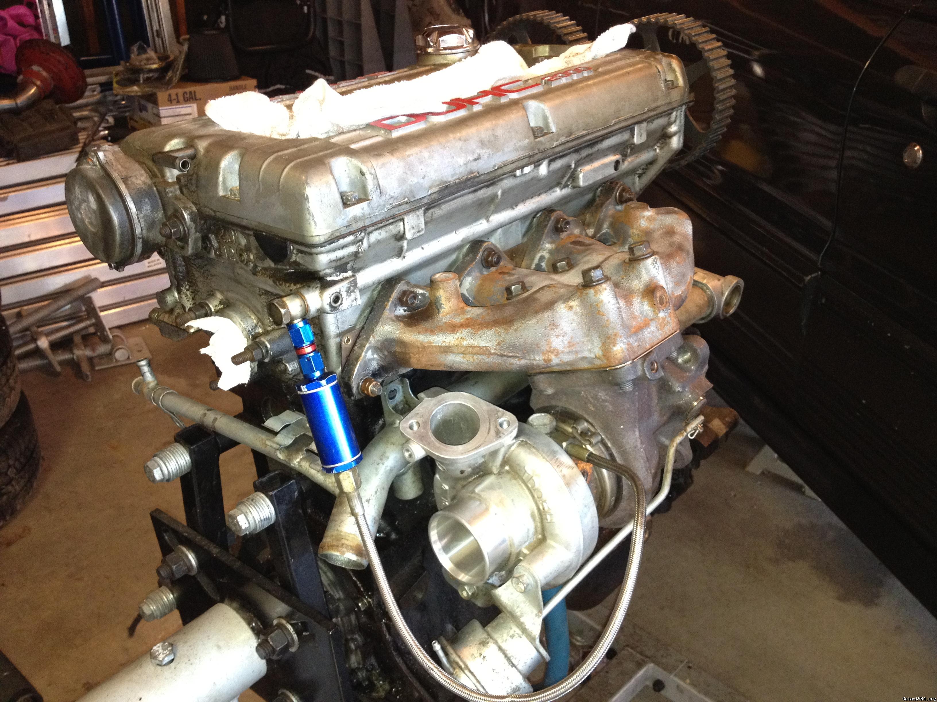

Getting the engine ready. Evo 3 16g

All that rust is basically from sitting in grass for a year or so. /ubbthreads/images/graemlins/banghead.gif
Going to have to make new brake lines and fuel lines. Going to completely remove 4ws system. Need to get new struts, intake gasket, tires, fenders, bumpers.
I am going to drop the front subframe, clean the belly of as much crap as I can and por15 / rustoleum the whole thing.

As for the por-15 and rustoleum. Terry Posten has more experience with the rustoleum. I have only done the fuel tank with POR. I have to say I am impressed with the coverage. That stuff will go a long way. I have mainly talked with people that have used it and have had it on applications for 15 plus years. They say it still looks as good as the day they put it on. For metal that is in very poor shape, you need to prep it correctly. That is about it. Plus the stuff I am using is not meant to be in direct sunlight, but they do make paint that works in sunlight. They also have high heat enamel that will withstand 1200f temps. And they have gas tank sealers that I am interested in.

I had poor luck with the gas tank sealer from POR because it was hard as hell to use in a car-sized gas tank. I think it'd be fine on a motorcycle tank but I'd never attempt it again on a car. That crap has been flaking off for years...
