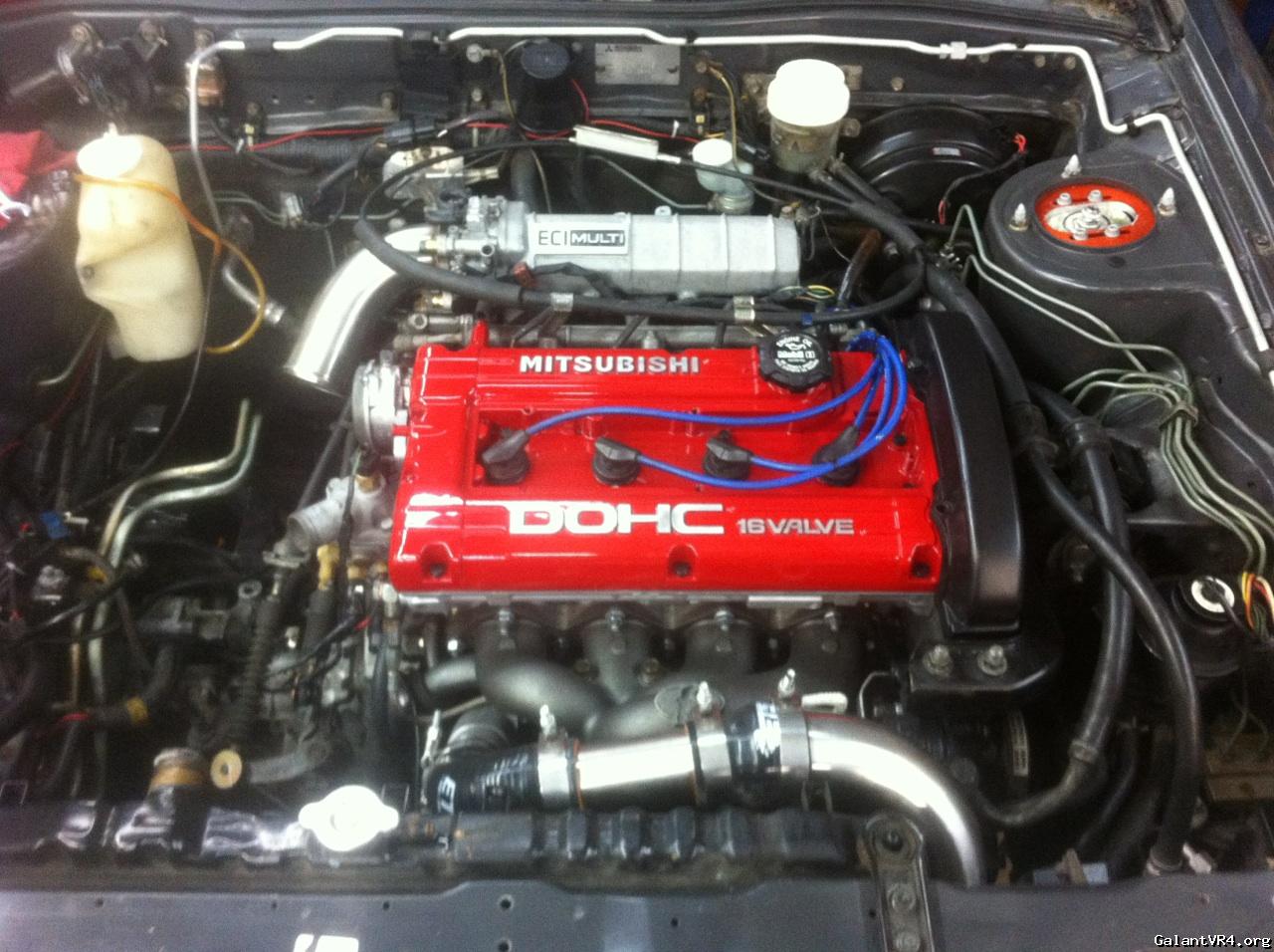

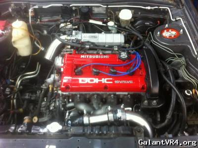

I got my car tuned today and it was suggested to me by Aaron (@ English Racing) that I invest in something to insulate the pipe coming off my turbo from the manifold. The FP racing mani doesn't have heat shield bolts, and the routing of the pipes on the ETS kit can't be changed for a few reasons.
I've used heat wrap before, but I'm wonder if that's the way to go. Anyone care to share their experiences?
Thanks!

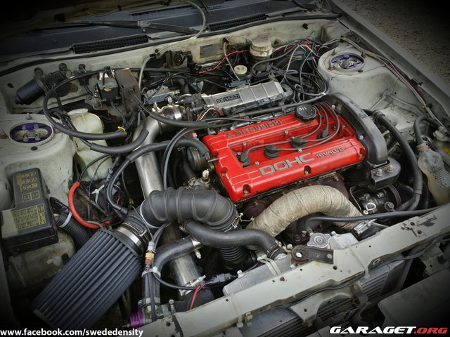

Here's what my wrapped IC pipe looks like:
It's almost touching the FP manifold but temps are very low and i can easily touch the pipe after a run. The outlet side of the IC also feels much cooler after the wrapping.
