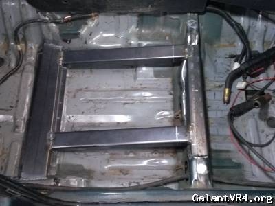

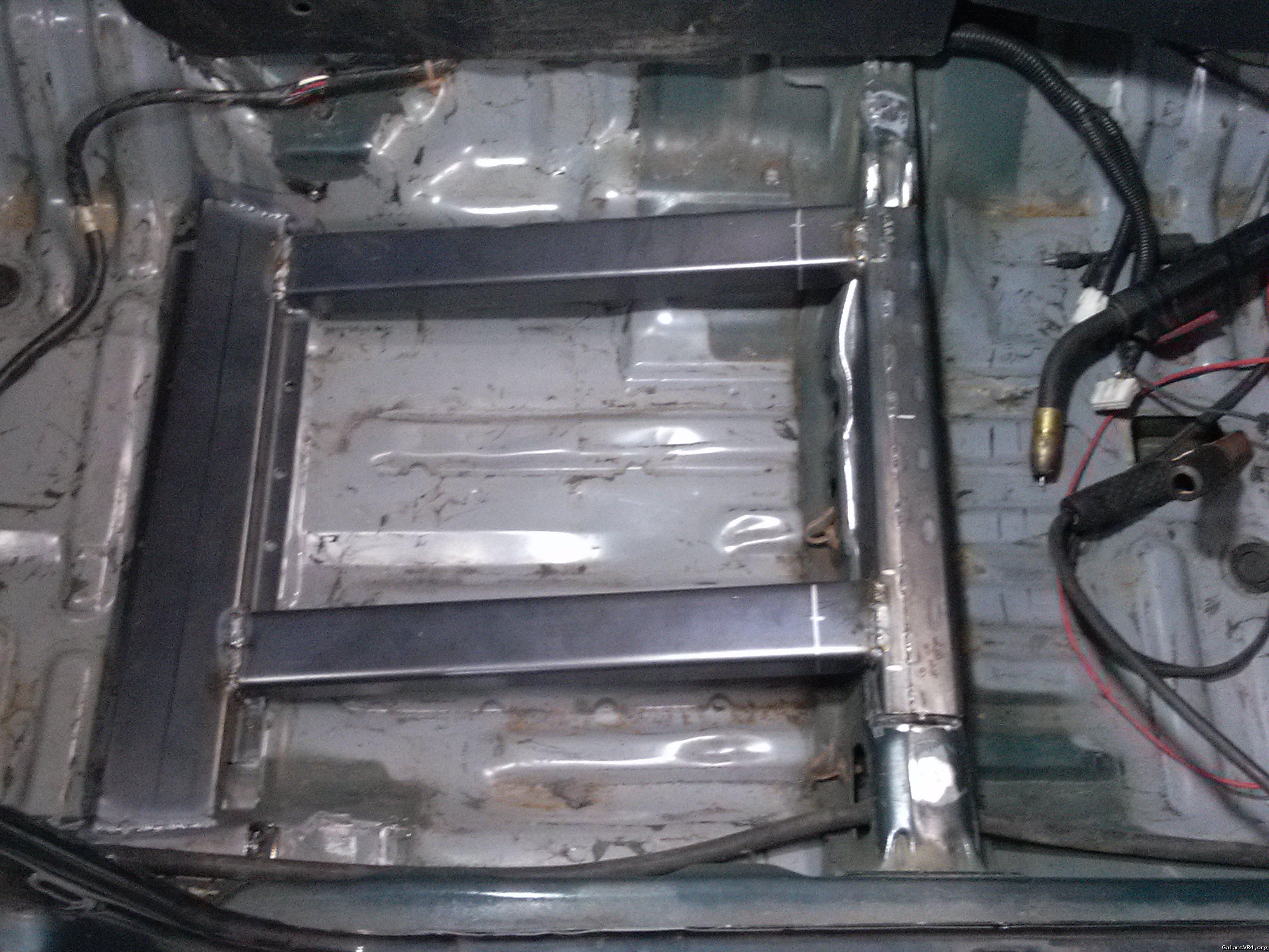

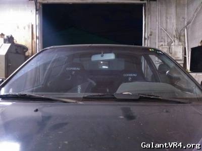

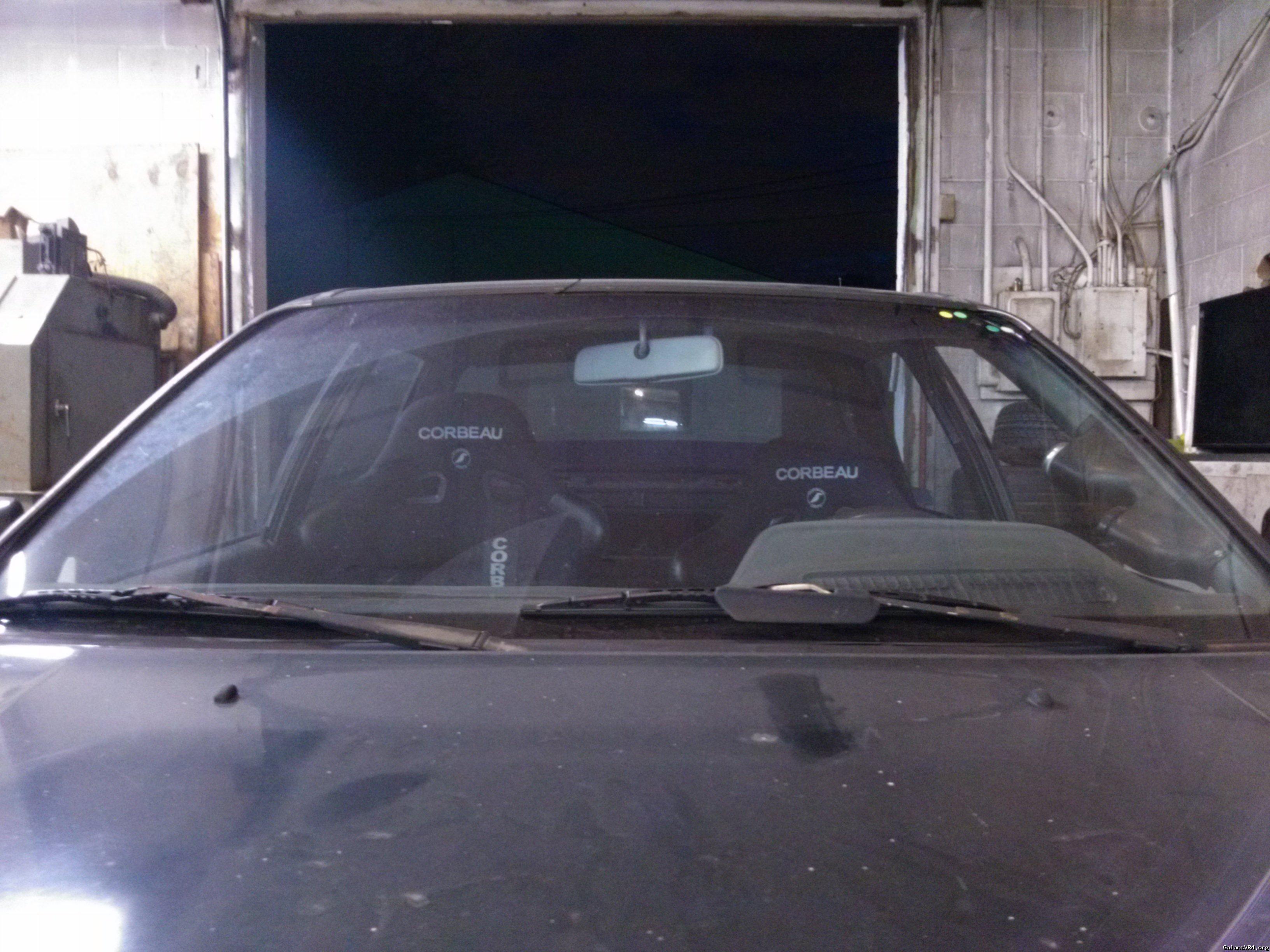

By the time I made brackets and used the sliders my seats sat just as high as the factory seats. I had the same problem with my helmet hitting the roof. I ended up lopping off the rear mount for the factory seats and welding in my own to make the seats lower. I now have about 2 or 3 inches of clearance. It's not easily reversible once done though. You can see the difference between the driver and passenger seats.

I do still have the sliders. I wanted the adjustability as sometimes other people drive my car. I just bent up some channel and kind of cut it to fit where I needed it. The hardest part was getting the sliders in the center of the channel and getting the seat straight. The front piece is just a channel that slips over the void in the center of the stock mount. Then I welded it all in. It actually helped stiffen up the car as well. I was surprised. I added subframe connectors as well. I think once I get the cage it will be plenty stiff. I've debated stitch welding all the spot welds but that seems a bit excessive for what I use the car for.
