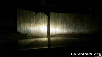

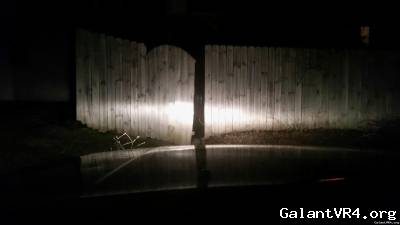

Advantage of using the 9012 bulb over the 9005 bulb is:
9005 bulb: Wattage: 65, Lumens: 1700
9012 bulb: Wattage: 55, Lumens: 1870
So you are still using a 55W bulb in the low beam circuit, but achieving a greater light output.
Below are some pictures I snapped while sitting in the car at my parking slab. Keep in mind the car is parked facing a bit uphill, so the beam where is hits the fence is higher than it would normally be while driving, but still gives an idea of any glare, or illumination, outside where the main concentration of light is.
The first is the low beam 9012 low beams. Second is with the highbeams on. With my yellow high beams it is easy to distinguish the two beam patterns

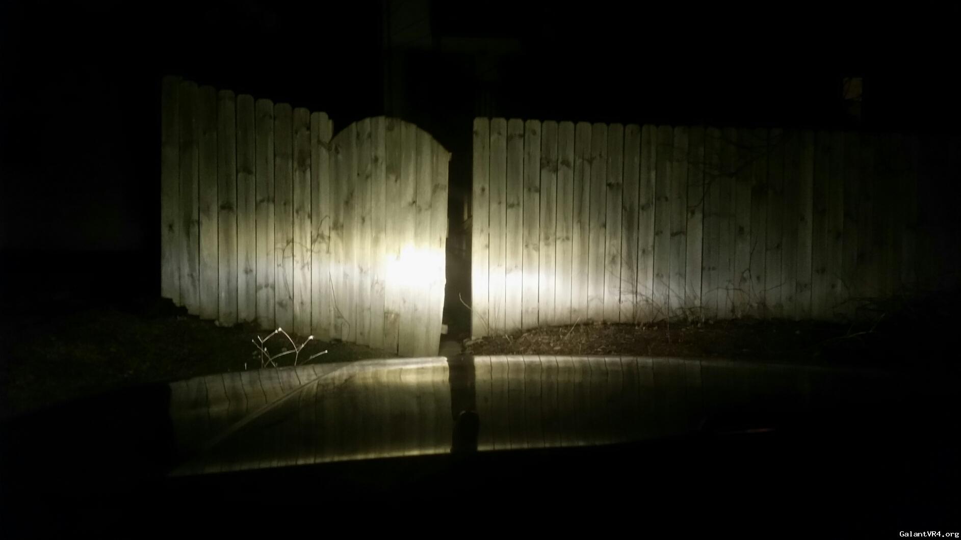

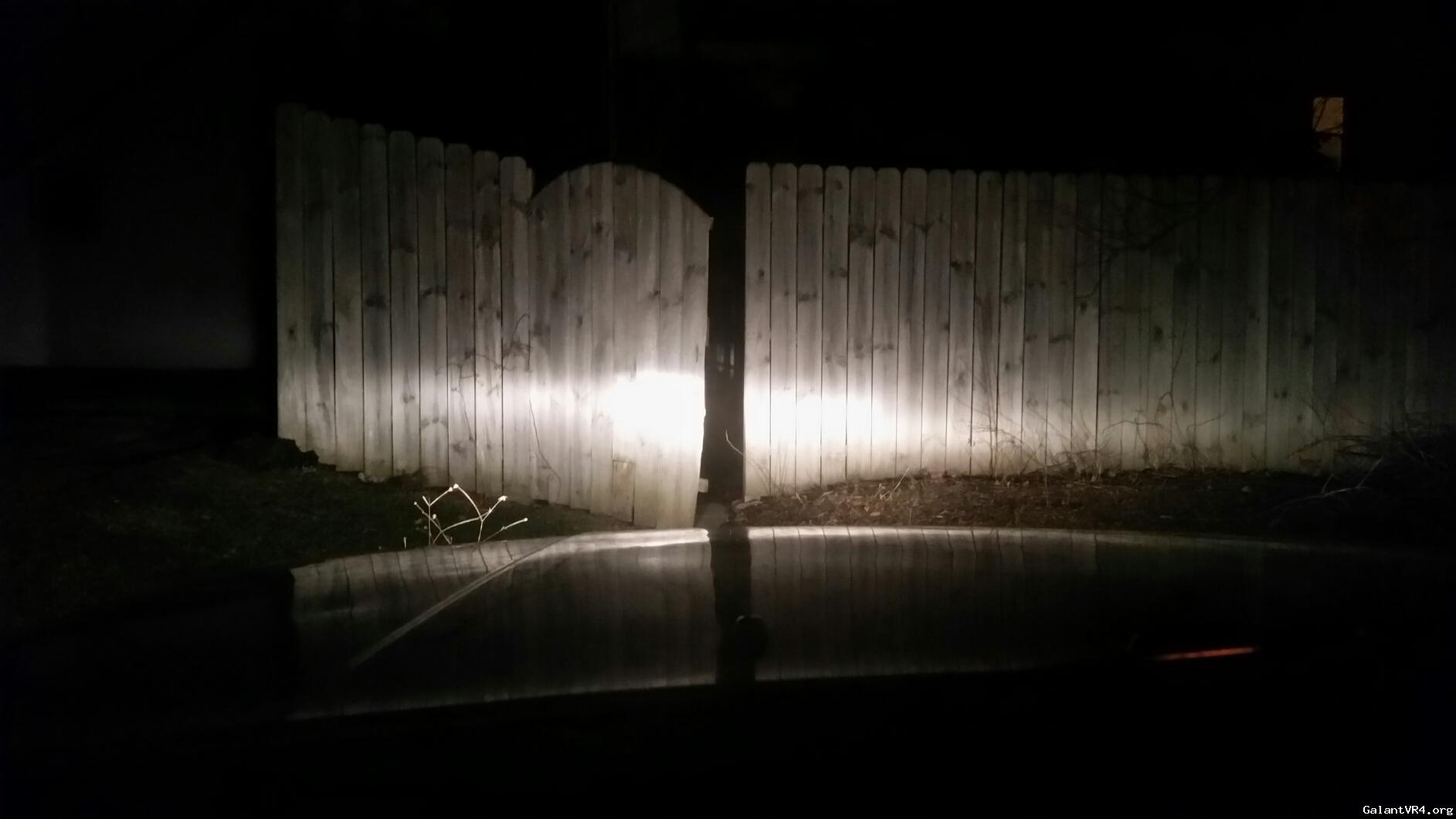

Just installed some 9011 bulbs in place of the original 9005. Got them from Amazon here. These are Philips bulbs even though they are sold as Wagner. Lots of other people have also been saying this on other forums.
Pictures don't show the difference too well, but it's definitely much brighter with more reach than the old 9005. I trimmed one of the tabs a bit too much, so it's slightly loose in the socket, but I don't notice any flickering or movement while driving over bumps. Would definitely recommend to those who drive back/country roads late at night /ubbthreads/images/graemlins/smile.gif
