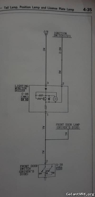

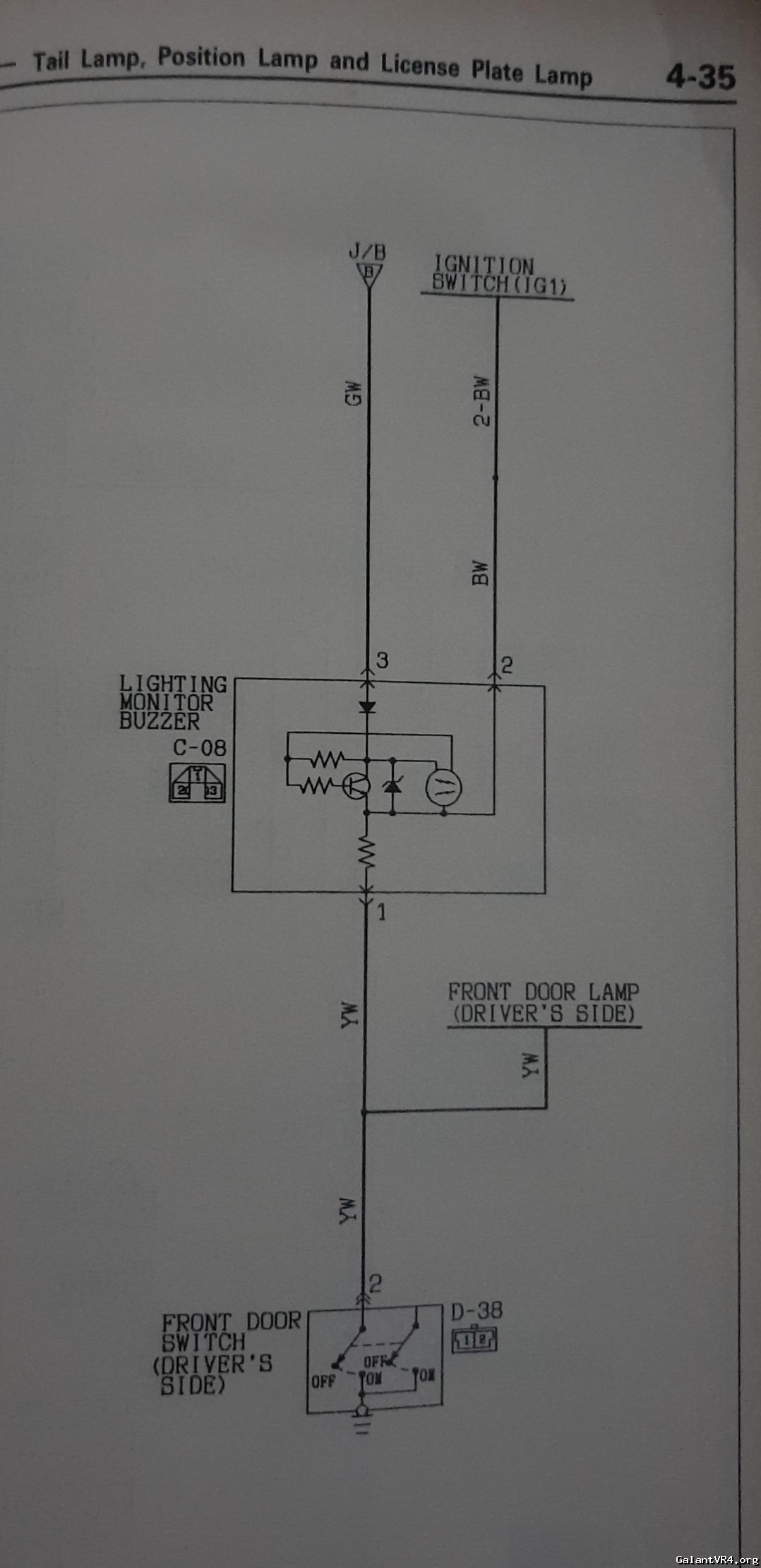

Sorry,I know its a very old Thread, but were is the buzzer hidden? I forget the light sometimes and mine Dont make a noise../ubbthreads/images/graemlins/banghead.gif
AllanL
Aug 4, 2008
298
NV
buzzer sits behind the driver side under dash folding pocket.
C-08 connector on the European models, as below:
