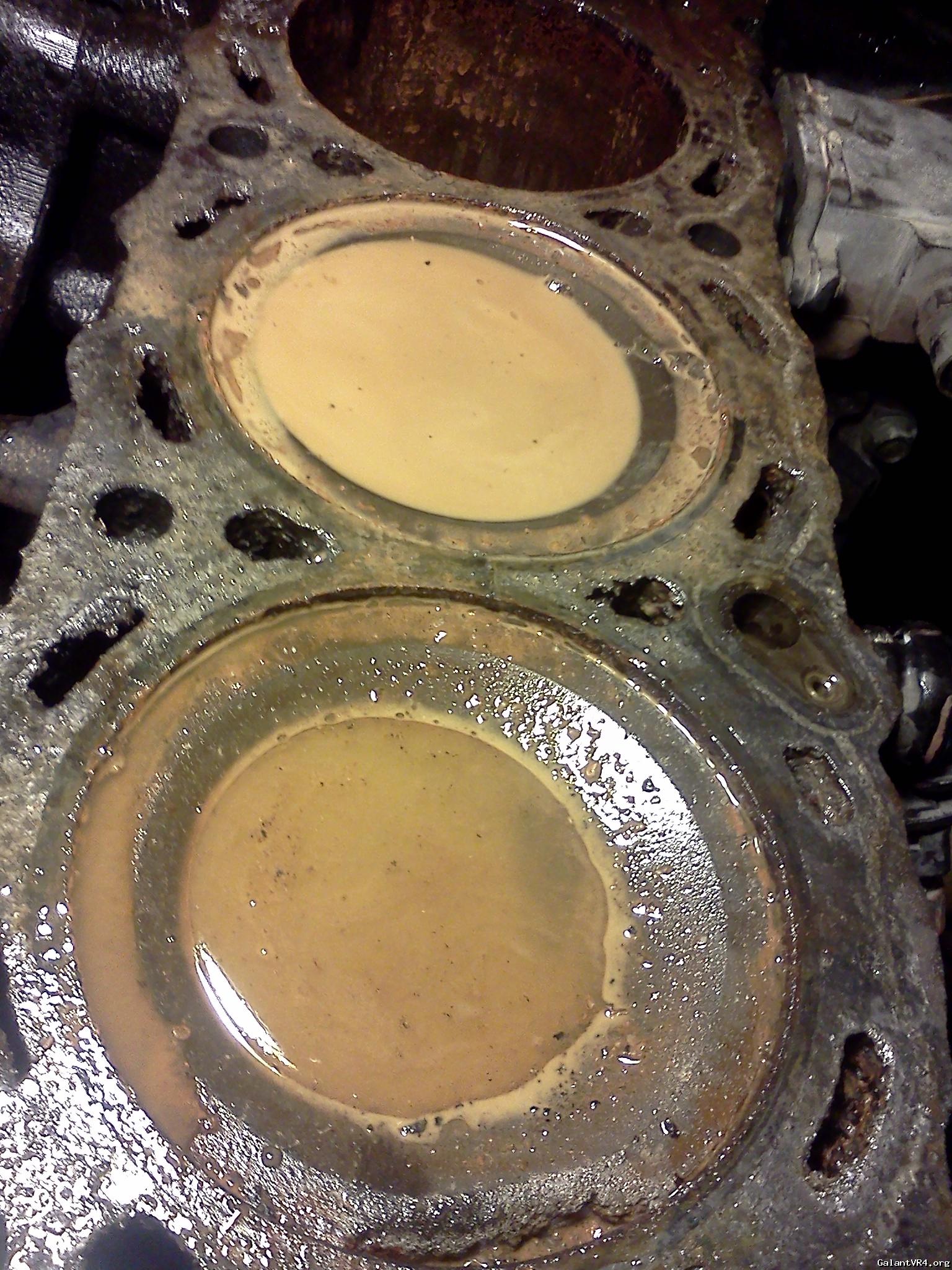

Heres a altima I bought from a friend she over heated it so bad it cracked the piston.
