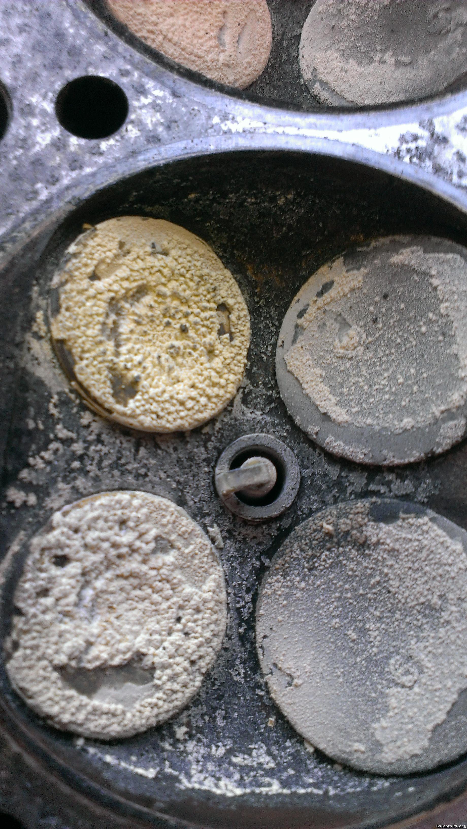

Stock 1g head bolts don't stretch. If they did you need to replace them. Otherwise they are reusable. It shouldn't be an issue. put it back in if you pull the head in the future. Or pull the head now because if your valve stem seals have been leaking a while your valves could probably use a cleaning anyway.
2g bolts are torque to yeild and only used once.
This engine was burning lean from bad injector seals and also suffered from leaky valve seals.
