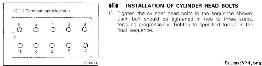

I can't find instructions on using oil or not using oil, just the final torque spec and pattern to use. I was going to go at it in a three step torque process.

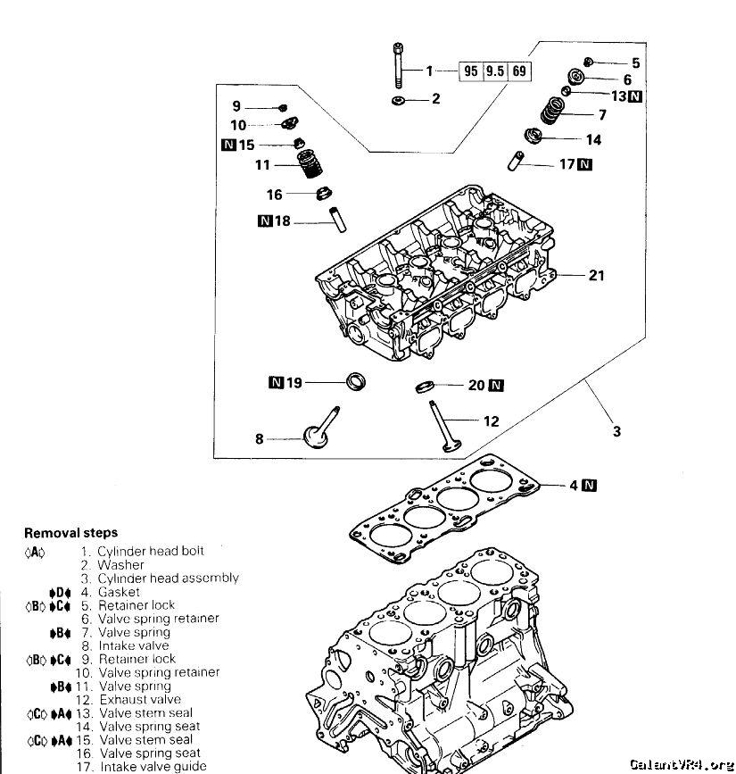

Wtf. Two manuals I read show 65-72 ft-lbs, another shows 80ft-lbs. What the heck is going on? 80ft-lbs is all I remember.
All manuals seem to indicate that threads should be clean and dry. /ubbthreads/images/graemlins/dunno.gif

The scan I found said 80'lbs. I just wanted to double check. Wonder if one of them is a later updated manual. Anyway, I'm not in the biggest of hurry being Easter weekend and hanging out with fam, but the parts came in the other day. I might try and clean things up this weekend.
For now, I'll plan on no oil. I thought the point of oil was to ensure no binding on the torque, but if the manual states dry and clean, then that is what I will do.
