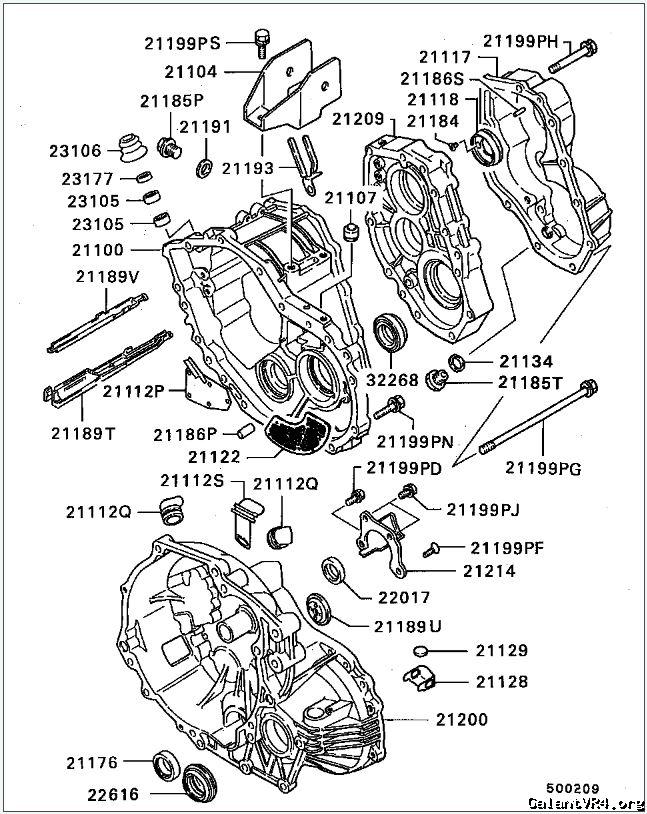

I’m looking for the part numbers of the Axle Joints oil seals (both sides) for GVR4 1992. Mitsubishi CAPS and ASA illustration image is not that clear to me. I really appreciate your support to identify them on the attached snapshot; in order to avoid ordering the worn spears.
One more thing; item 21122 in the attached snapshot is identified as “Oil Filter” on ASA; is really a filter which needs to be replace from time to time or it is just a strainer.

MD719710
MD707184
these two part numbers, these are the seals for both sides where the axles plug into the gearbox.

Thank you very much Bene <img src="/ubbthreads/images/graemlins/smile.gif" alt="" />. Indeed, I’m looking for the oil seals where the axles are plug into the gearbox

That screen 21122 can/should be replaced when the transmission is overhauled or worked on, not otherwise.
