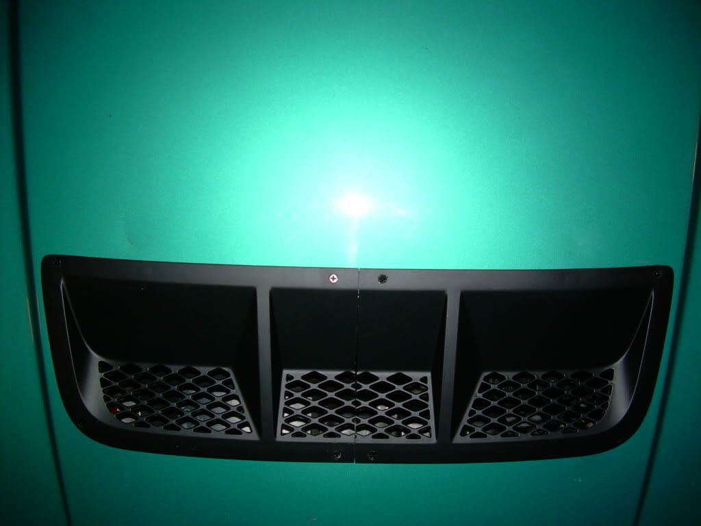

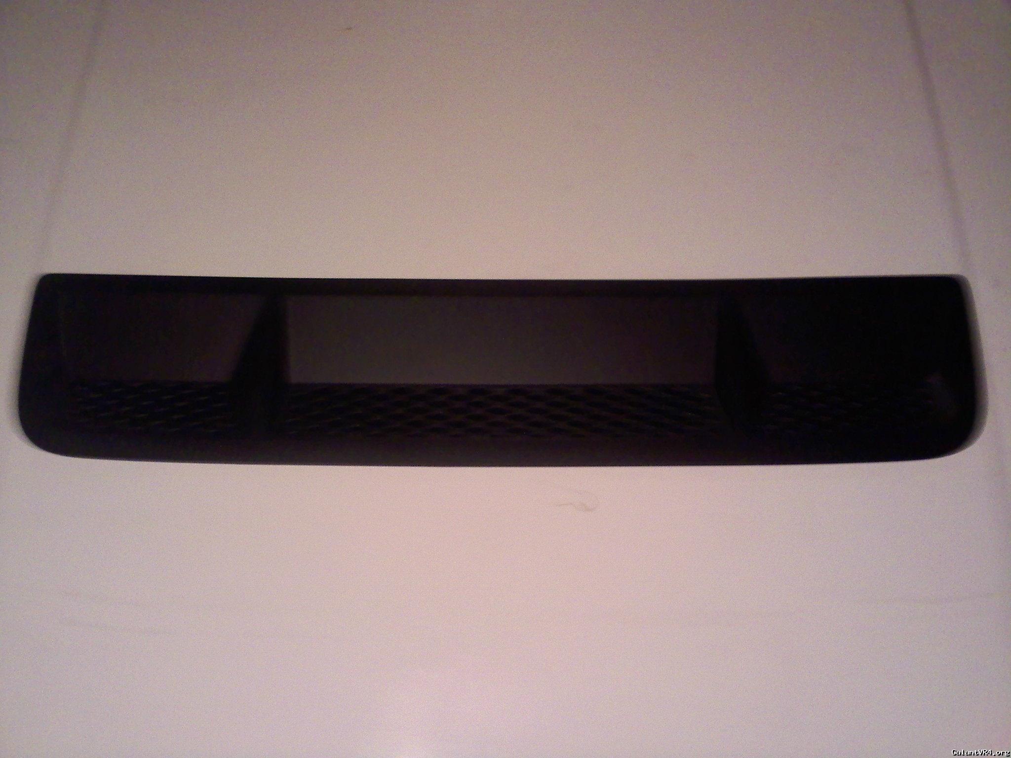

While searching for a solution to high under-hood temperatures I stumbled across some pictures of the OEM hood vent from a 2010 Shelby GT500 and decided to install it in the Galant.
It matches up perfectly with the stock body lines and is surprising cheap at around $70.

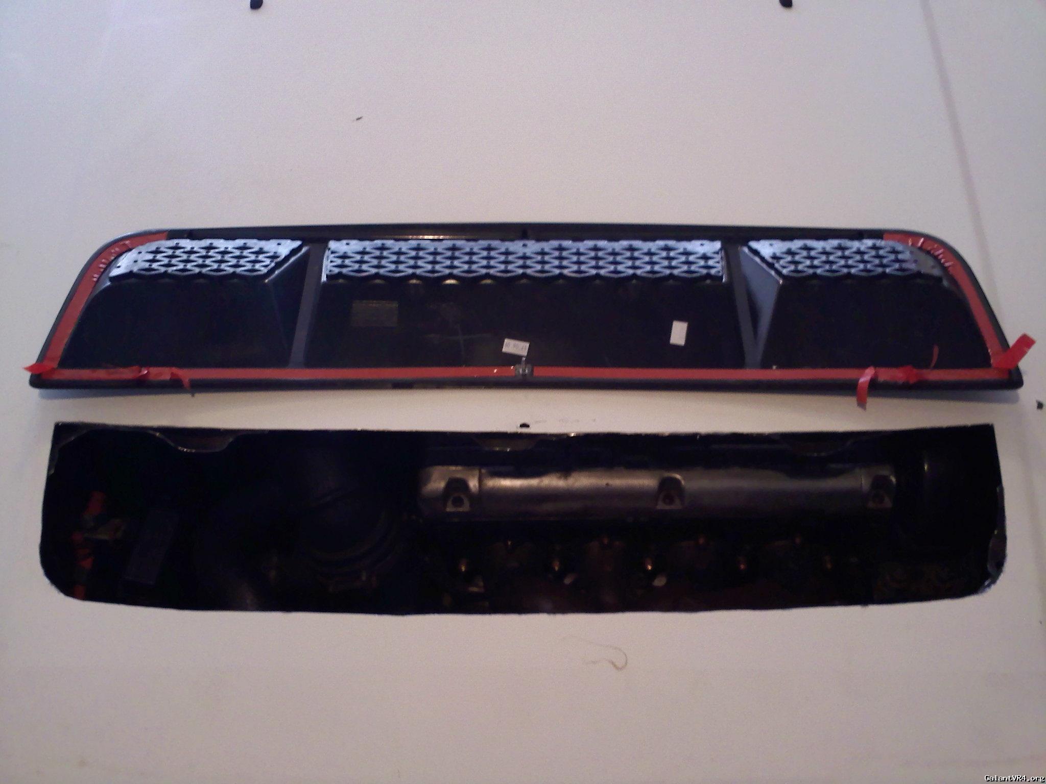

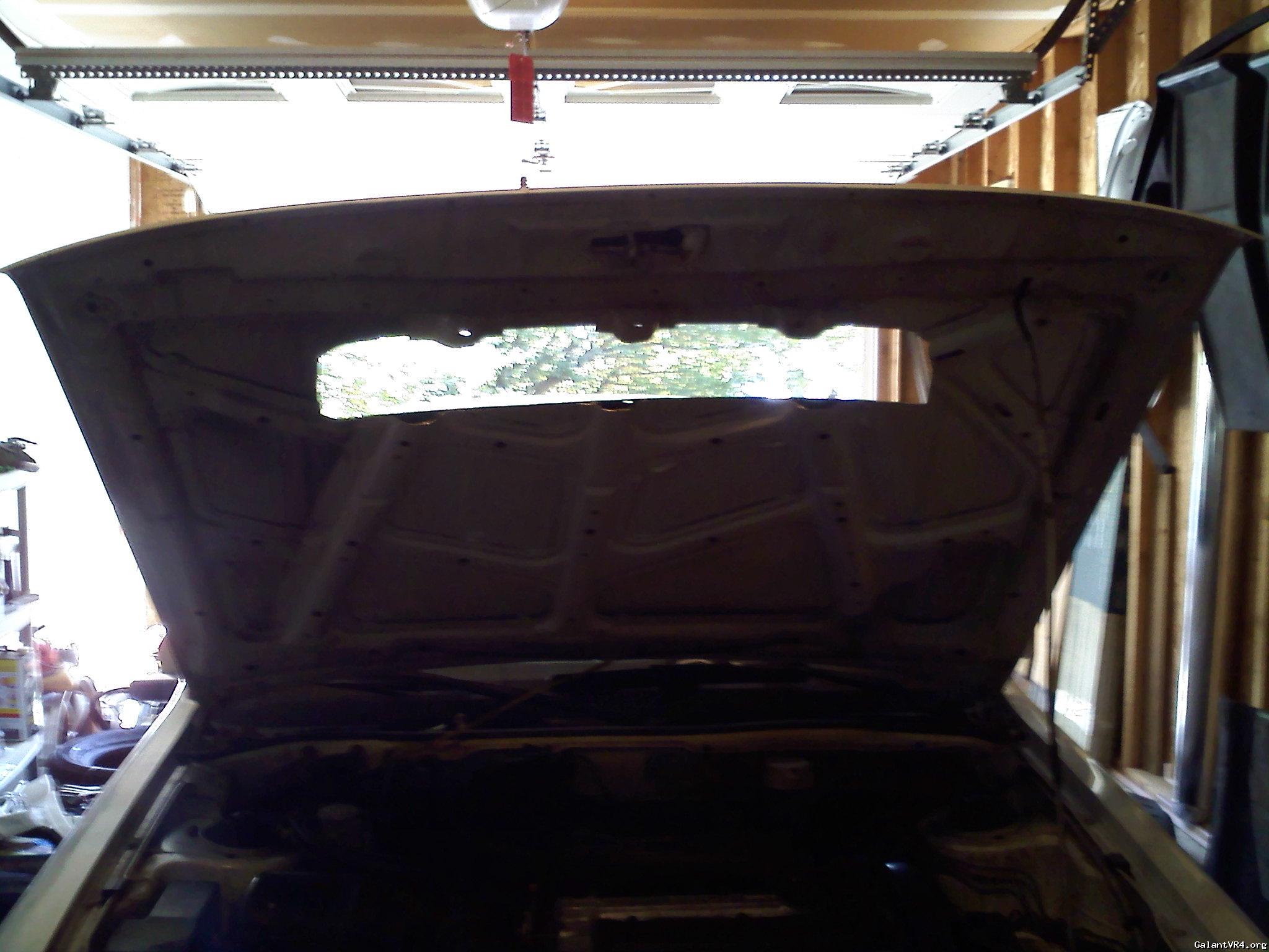

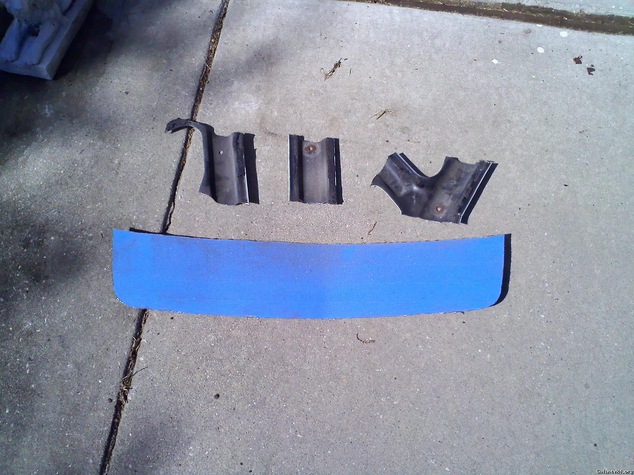

Here is what I cut out:
It may look like the structural rigidity would be severely impacted but I barely noticed a difference:
Test fit the hood vent in the hole and perform any additional cutting. The front of the hood vent will slip over the front sheetmetal edge and the rear is secured by 3M tape and a stud. The hood vent has two pieces in the rear on either side that fit into slots on the GT500 hood. I removed these and added some 3M tape over where they were. Mark the location of the stud in the rear and remove the vent and drill the hole.
Remove all the painters tape and cover any exposed edges with touch-up paint.
While that is drying, grab the 3M tape, hood vent, and razor and add tape to the sides for extra stiction.

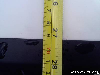

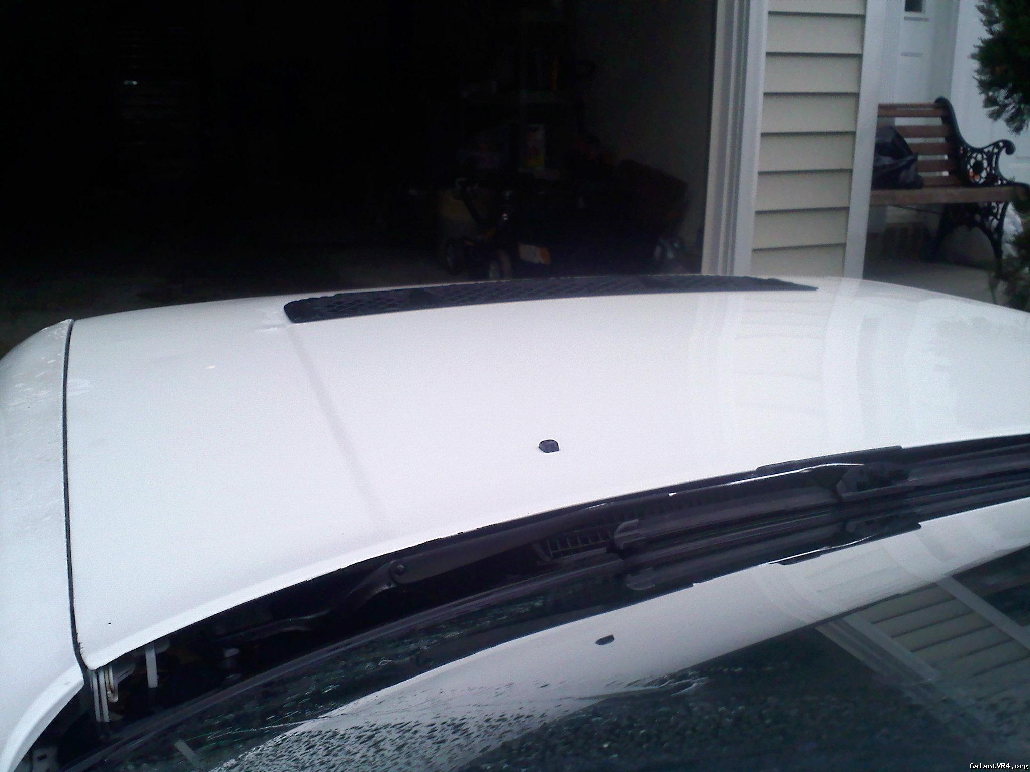

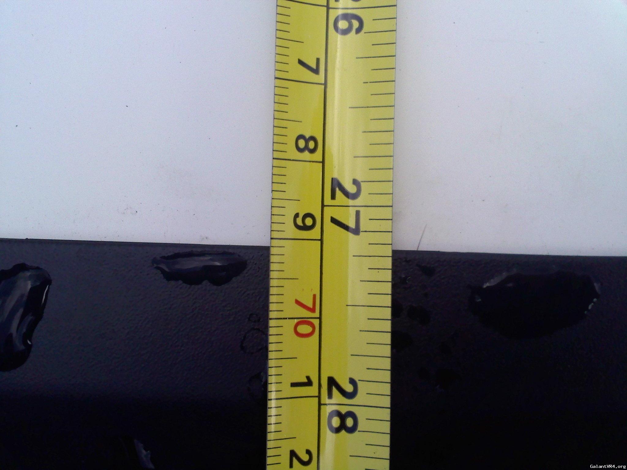

Once the paint is dry, install the scoop in the hood and secure the stud underneath with a nut (you'll need to check the dimensions youself, I had a random nut that was the right size) ensuring you leave the red tape tags sticking out . Grab your tape measure and measure from the back of the hood to the top edge of the vent and get it centered and square in the hood. Once it's where you want it then grab the red tape tags and pull them out. Find something heavy to place on the scoop (I did it overnight) to get it stuck on there well.

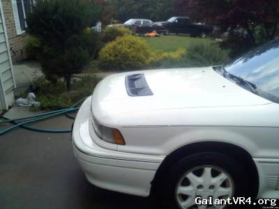

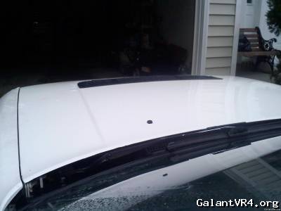

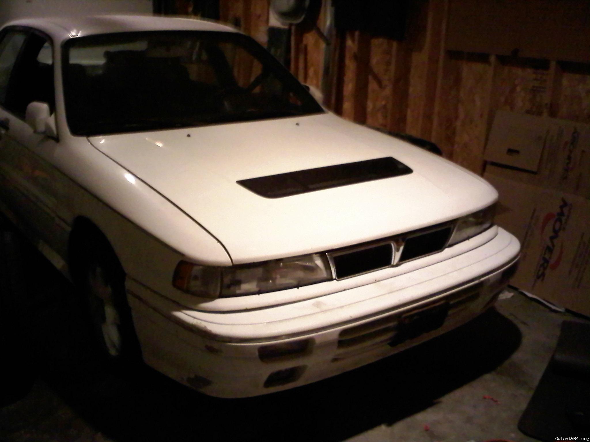

Results:

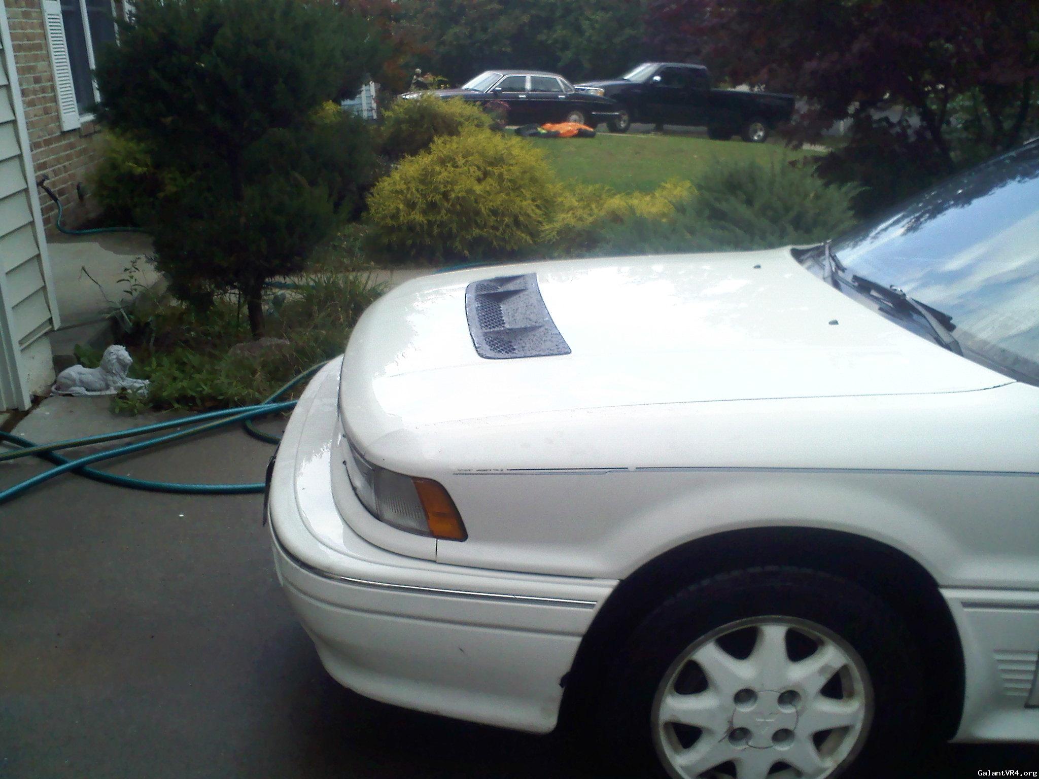

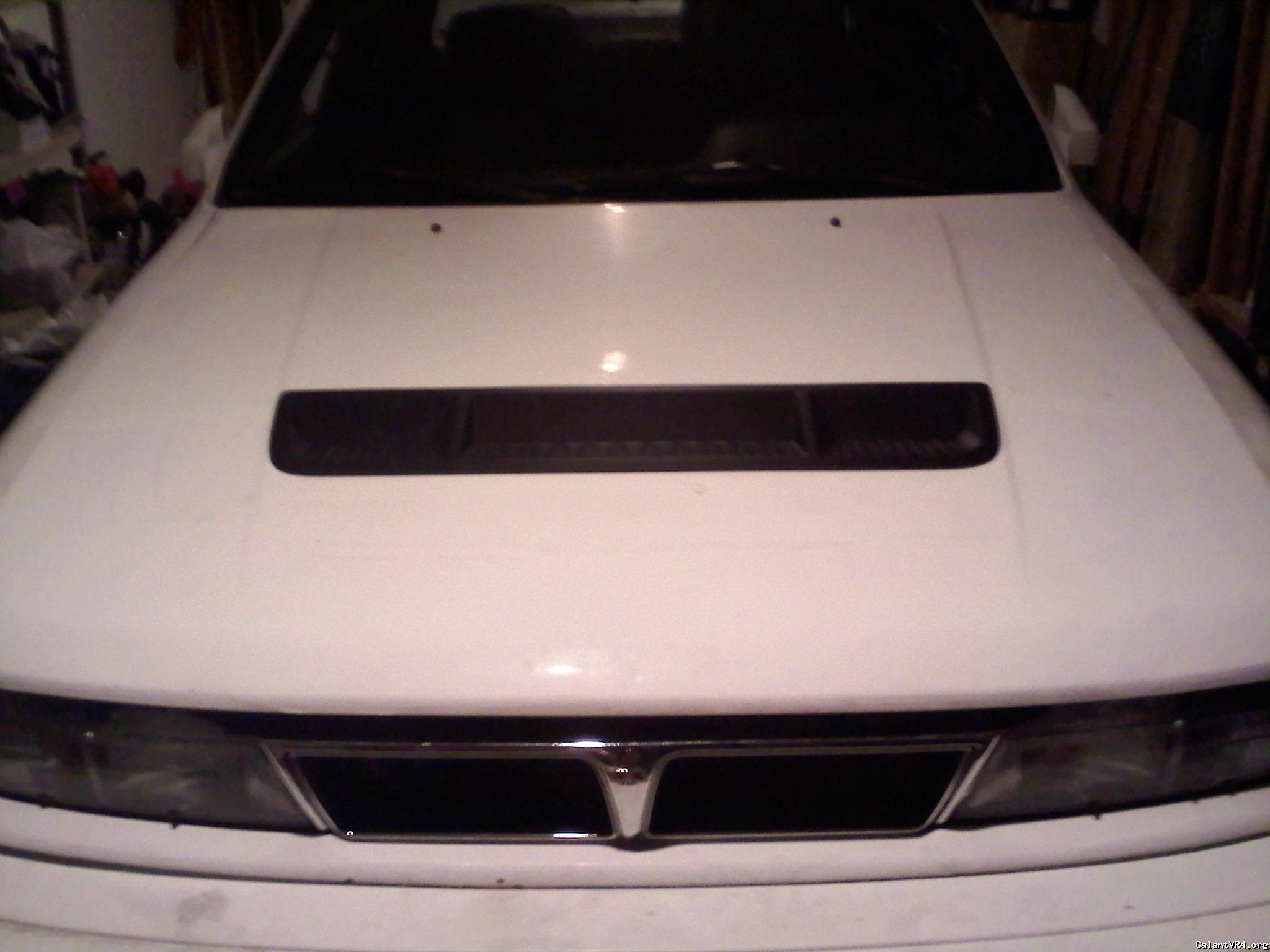

Results:
