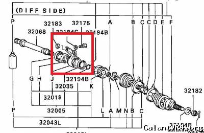

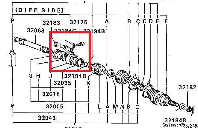

Dan D
Feb 27, 2001
1,175
Brownsburg, IN
I had similar. Thought it was a bad wheel bearing (which was getting a little bad). When that didn't fix it, the only other rotating part I've not reworked at some point was the driver side axle jackshaft bearing - the part bolted to the back of the block. Similar grinding noise. I'd pulled it before while diagnosis the noise and it didn't feel or sound bad spinning it by hand so I left it alone but apparently it was. Made my noise go away.
It's pretty easy to replace. Could probably press it with a rental c-clamp press no problem. Hydraulic press - easy.
