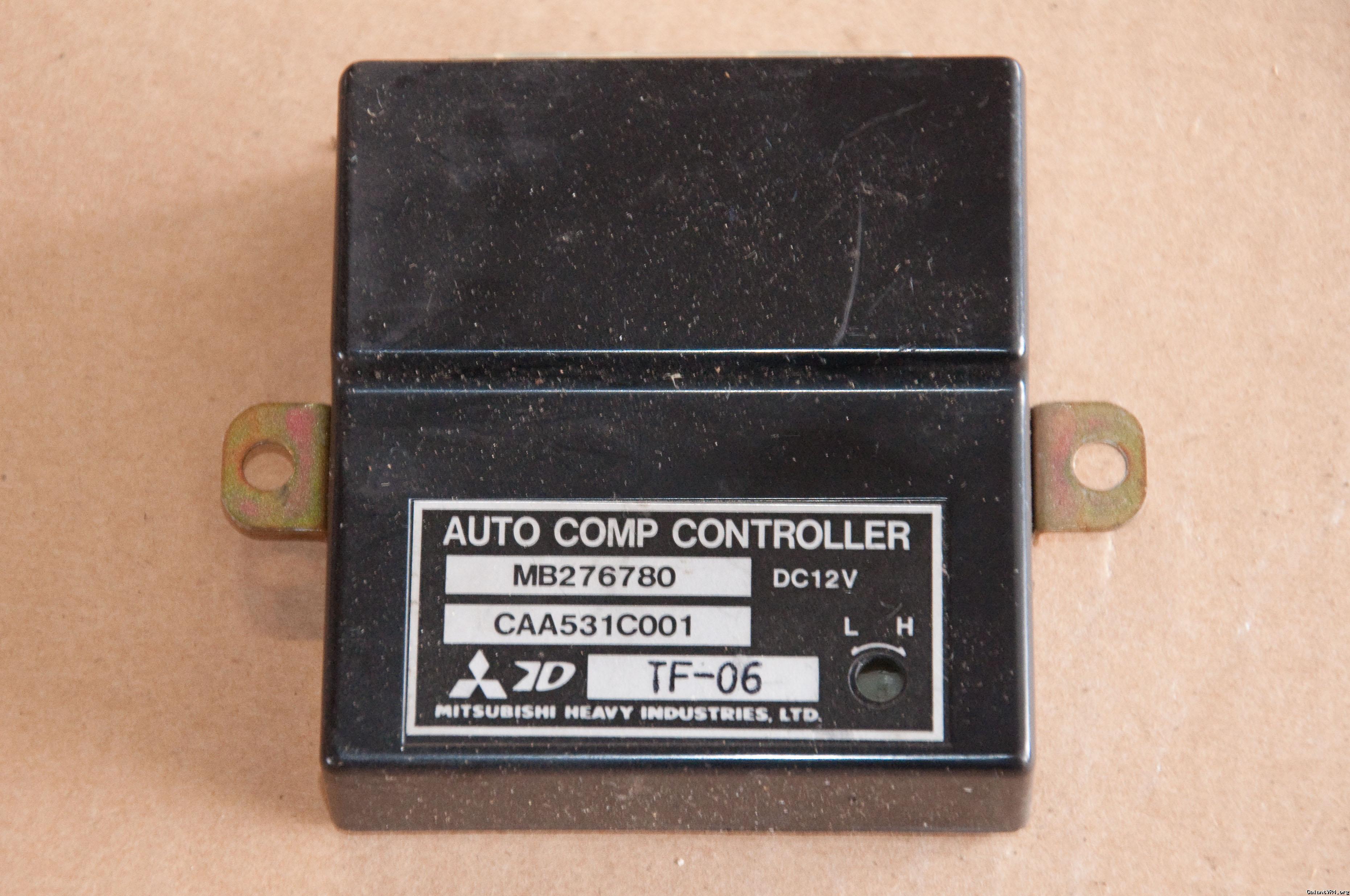

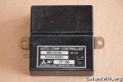

I think its the ac fan control unit do you have a pic?
Does it look like this? Wait you said gold scrap that post a pic of the unit
He said its under the glove box thought the mpi fuse was in the engine bay??????
