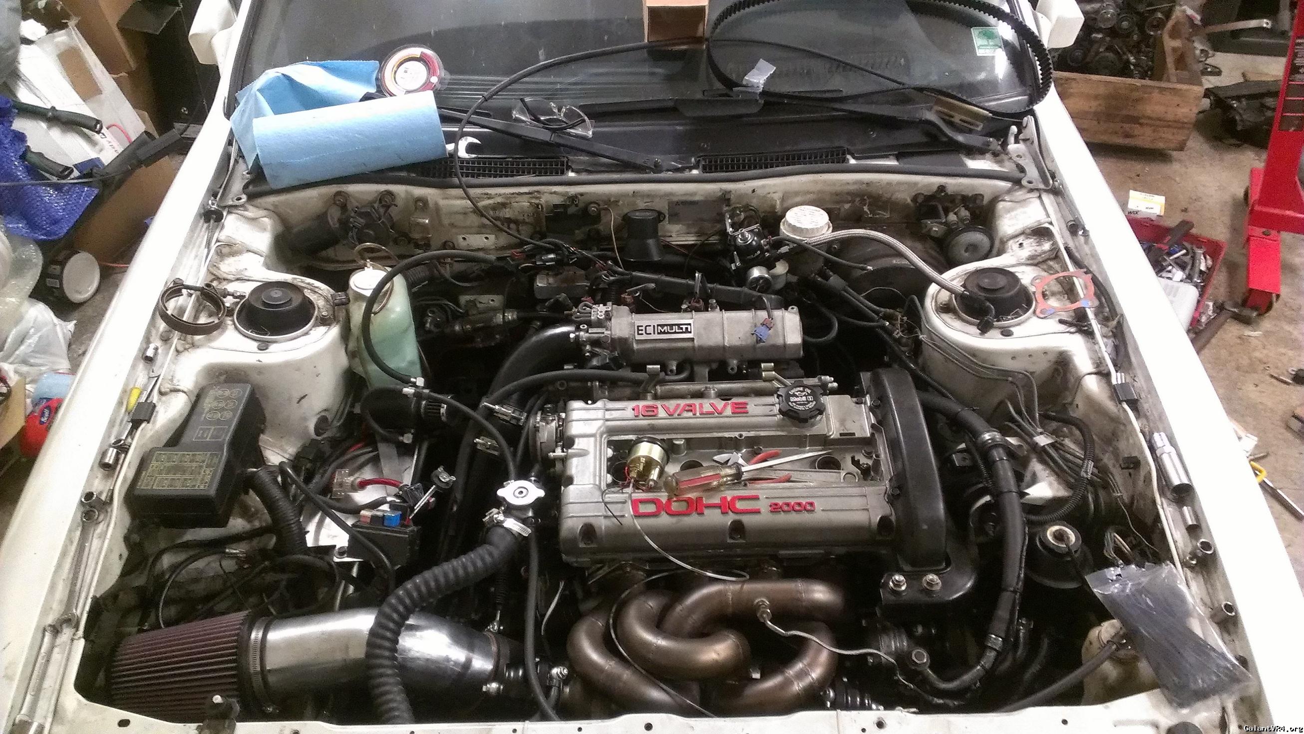

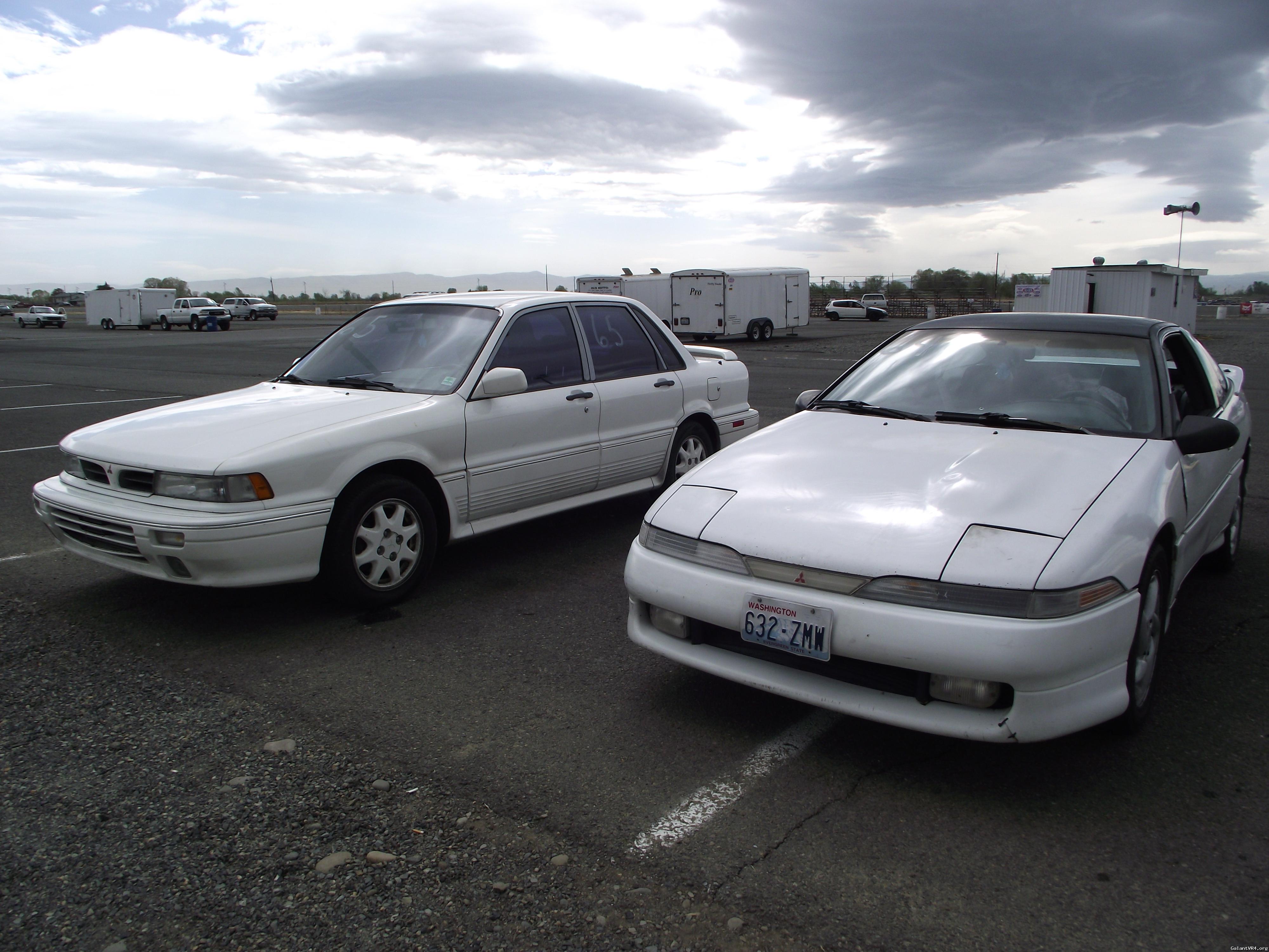

I'm finally getting to take the galant to the track this Saturday in Yakima with the hx35. Its has some idle and cold stalling issues but besides that its driving pretty well. I haven't had a chance to tune the car at all, including the VE table, but we'll see how it goes. I don't have a picture of it finished.

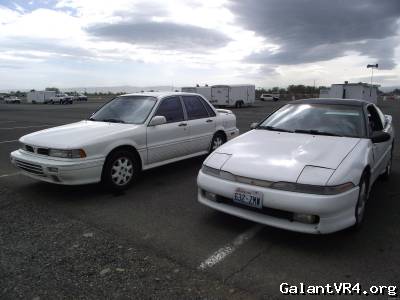

My fiance is going back to Yakima for her bacheloret party, so I figured this is the perfect chance to take both my cars to the track. She is going to drive the GSX to Yakima, then when I get off work, I'm going to take the galant over. Then I'll race both the galant and gsx saturday.

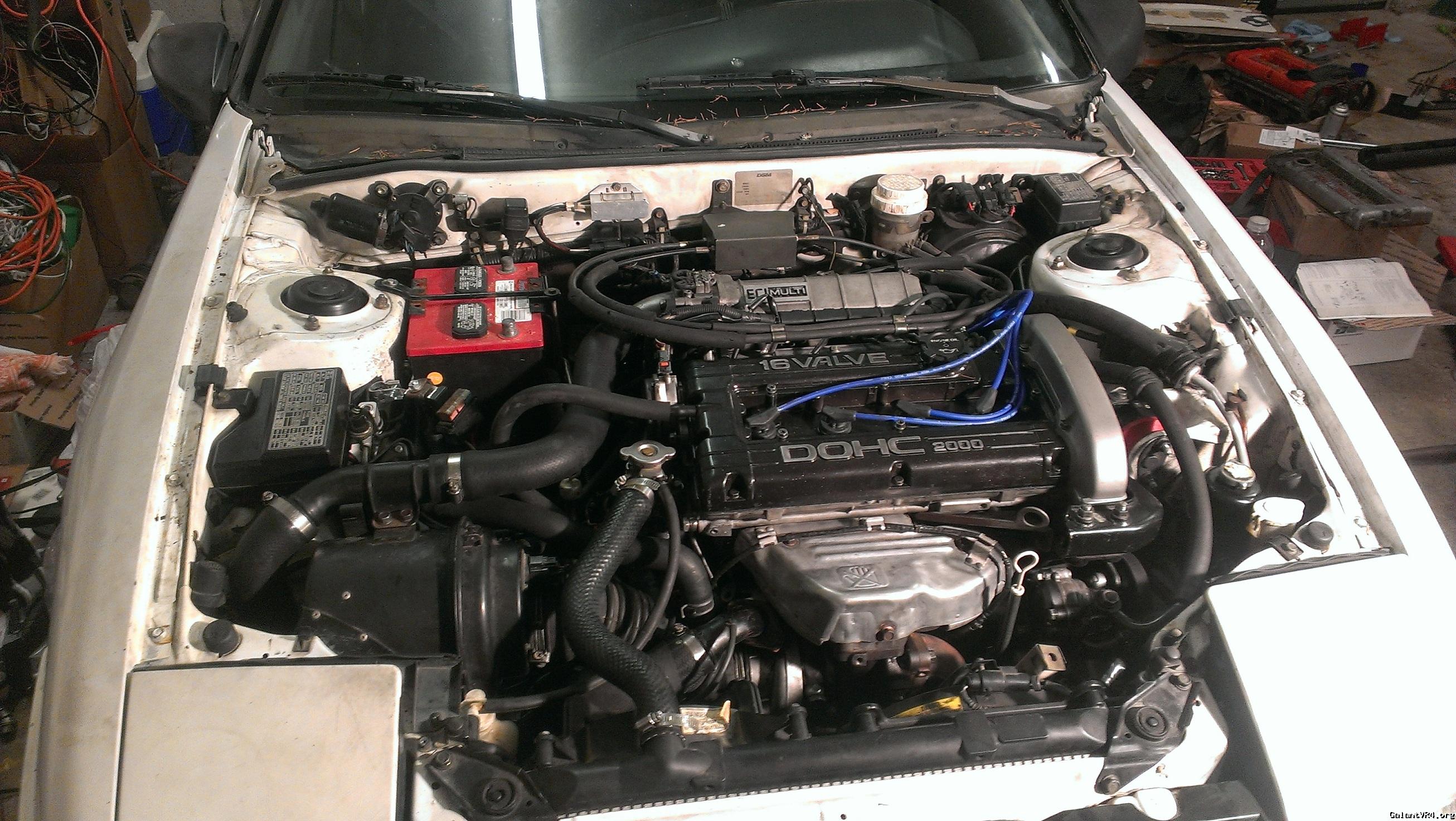

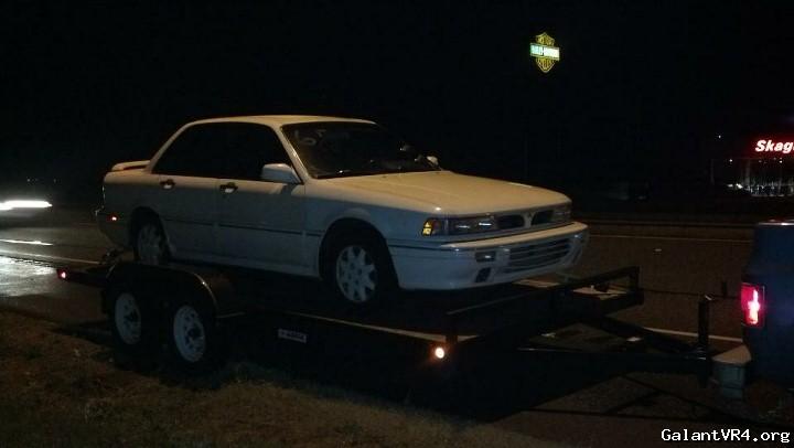

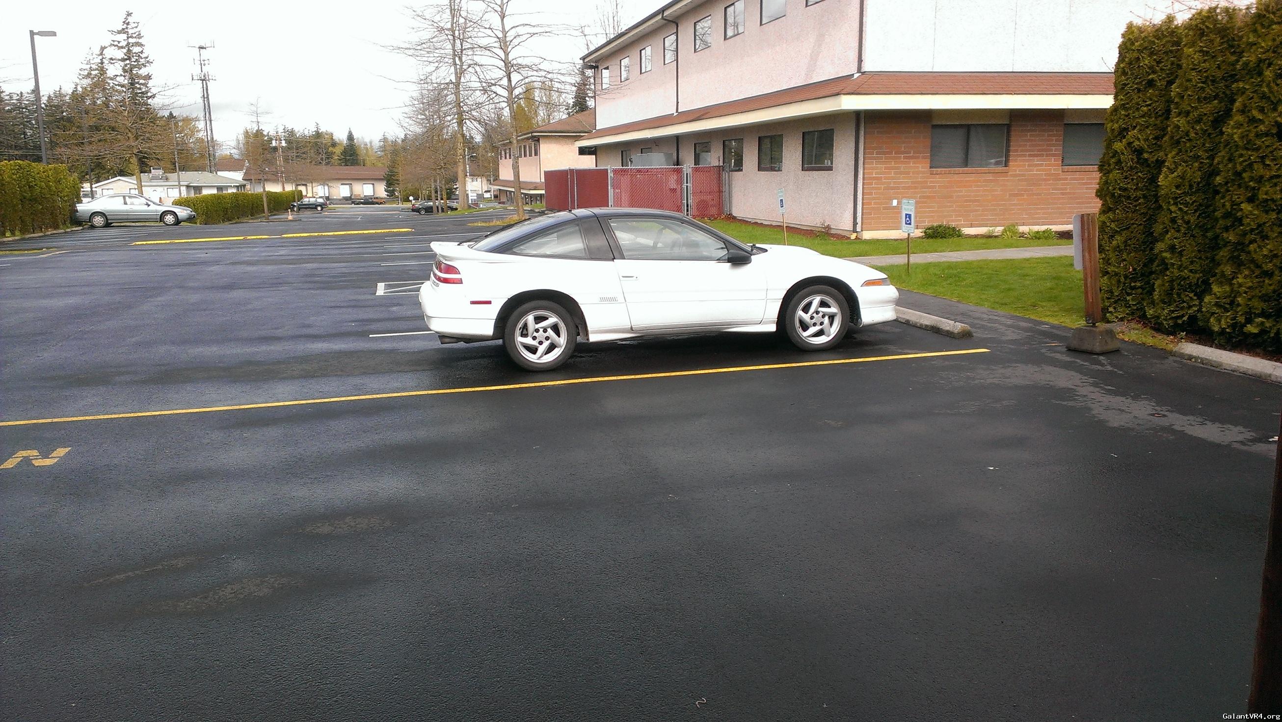

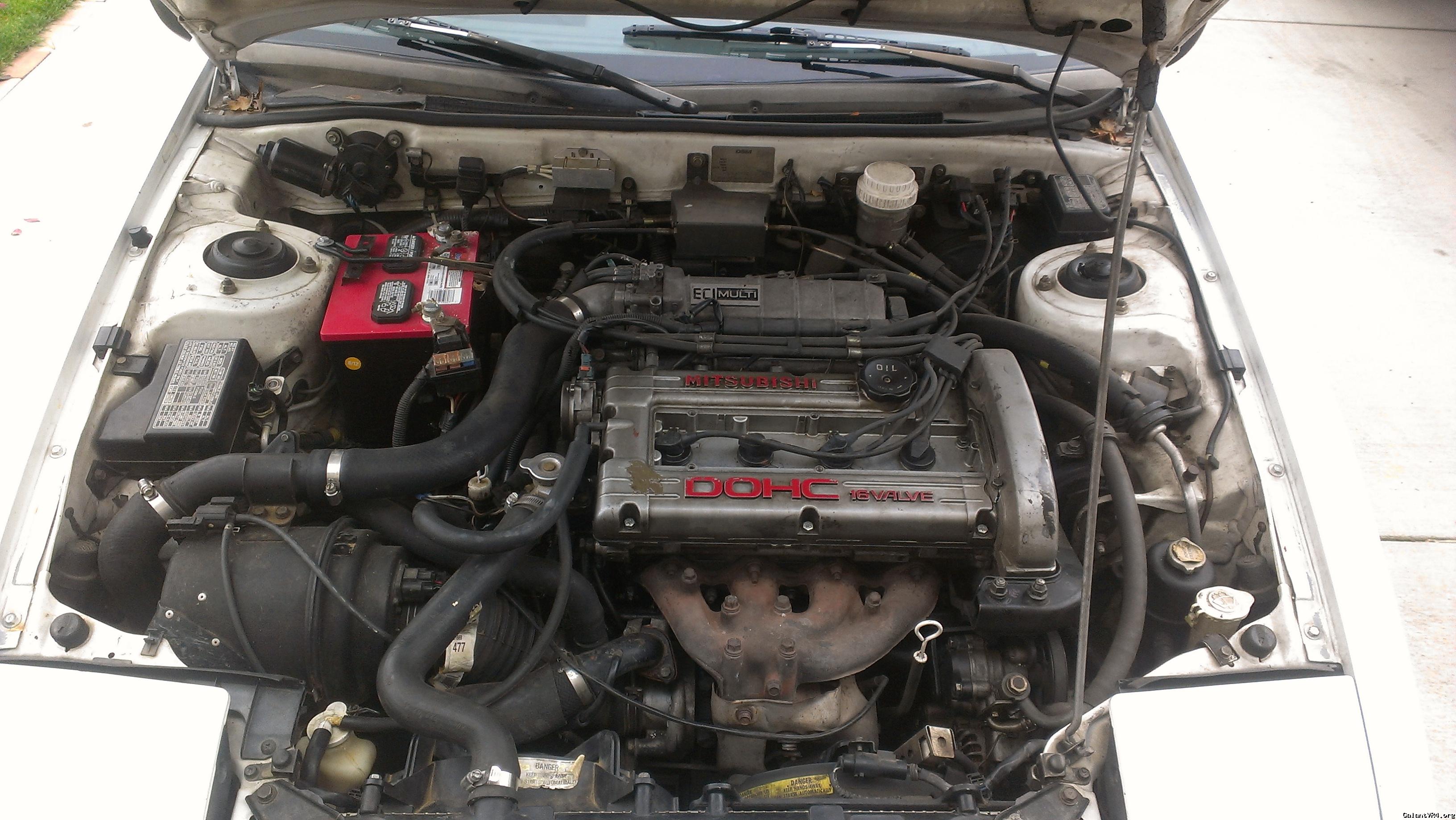

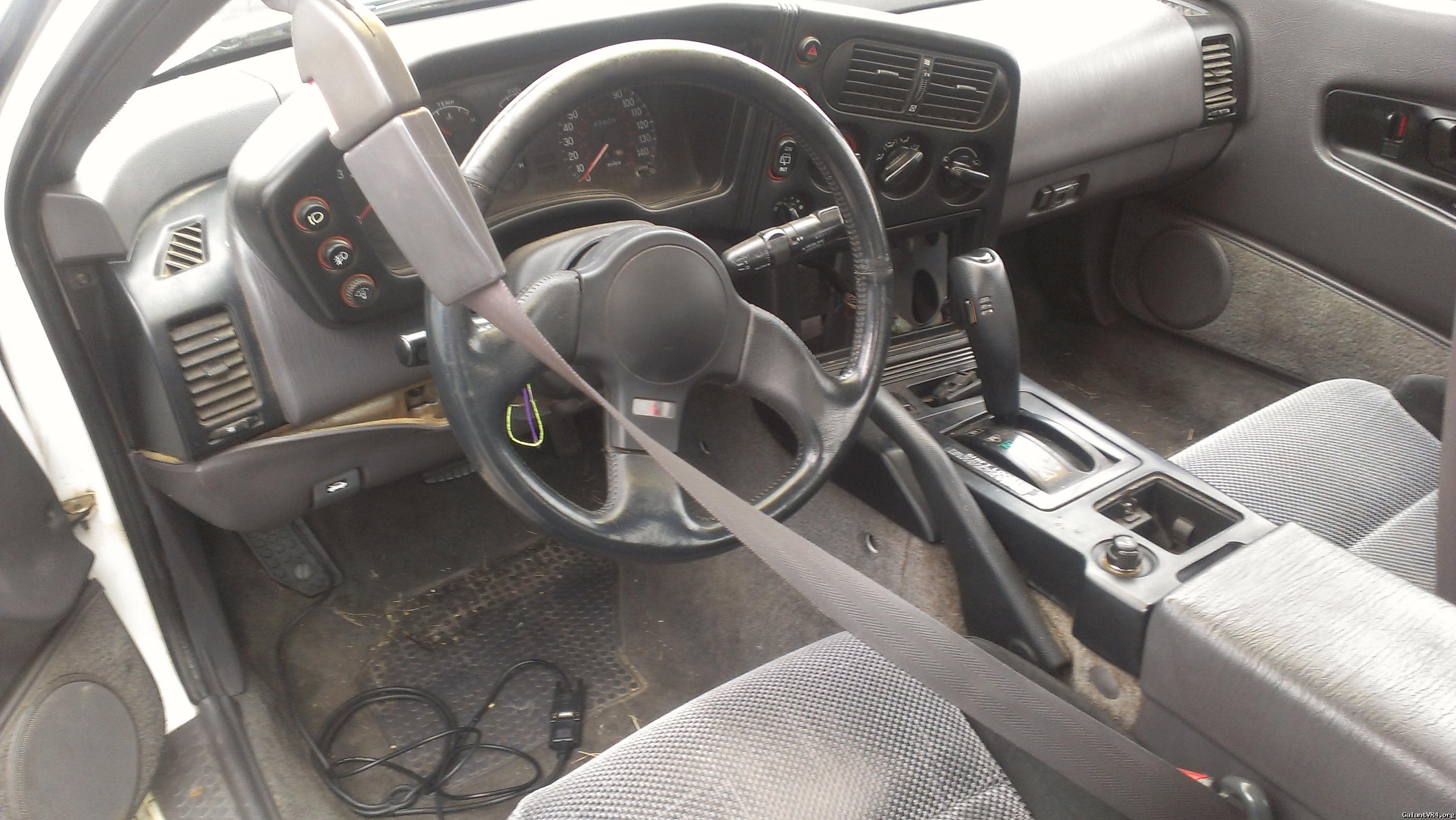

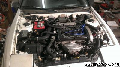

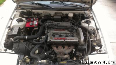

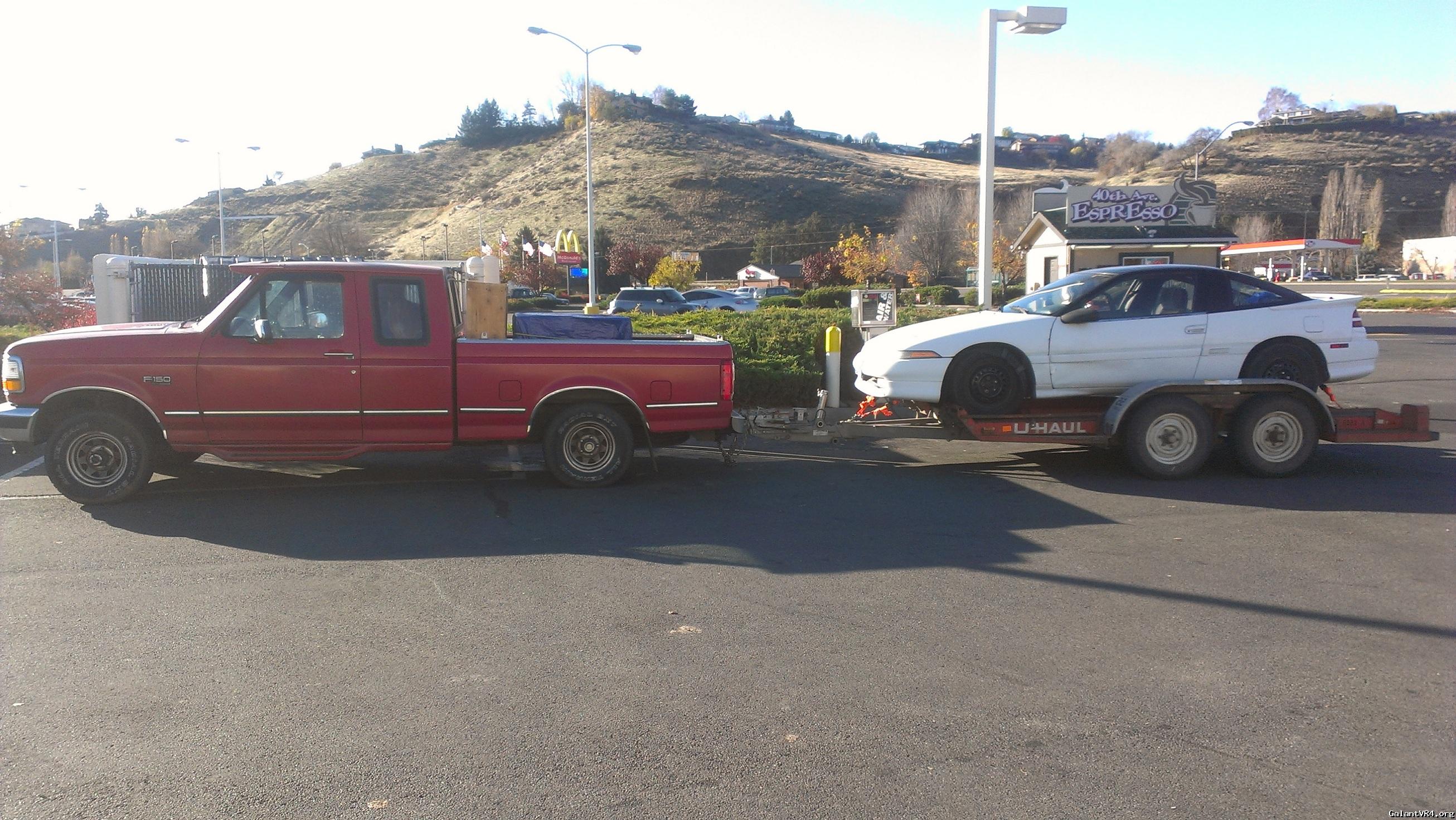

This GSX was a filthy train wreck inside and out before I got it. I had to trailer it home because it would have never made the 4 hour trip. After pulling the engine and cleaning everything, the engine bay looks decent. I threw away the seats cuz they were nasty and picked up some leather ones. I stripped most all the interior plastics and carpet to clean, then put in a new carpet. Now just the exterior is a filthy train wreck.
Before
After

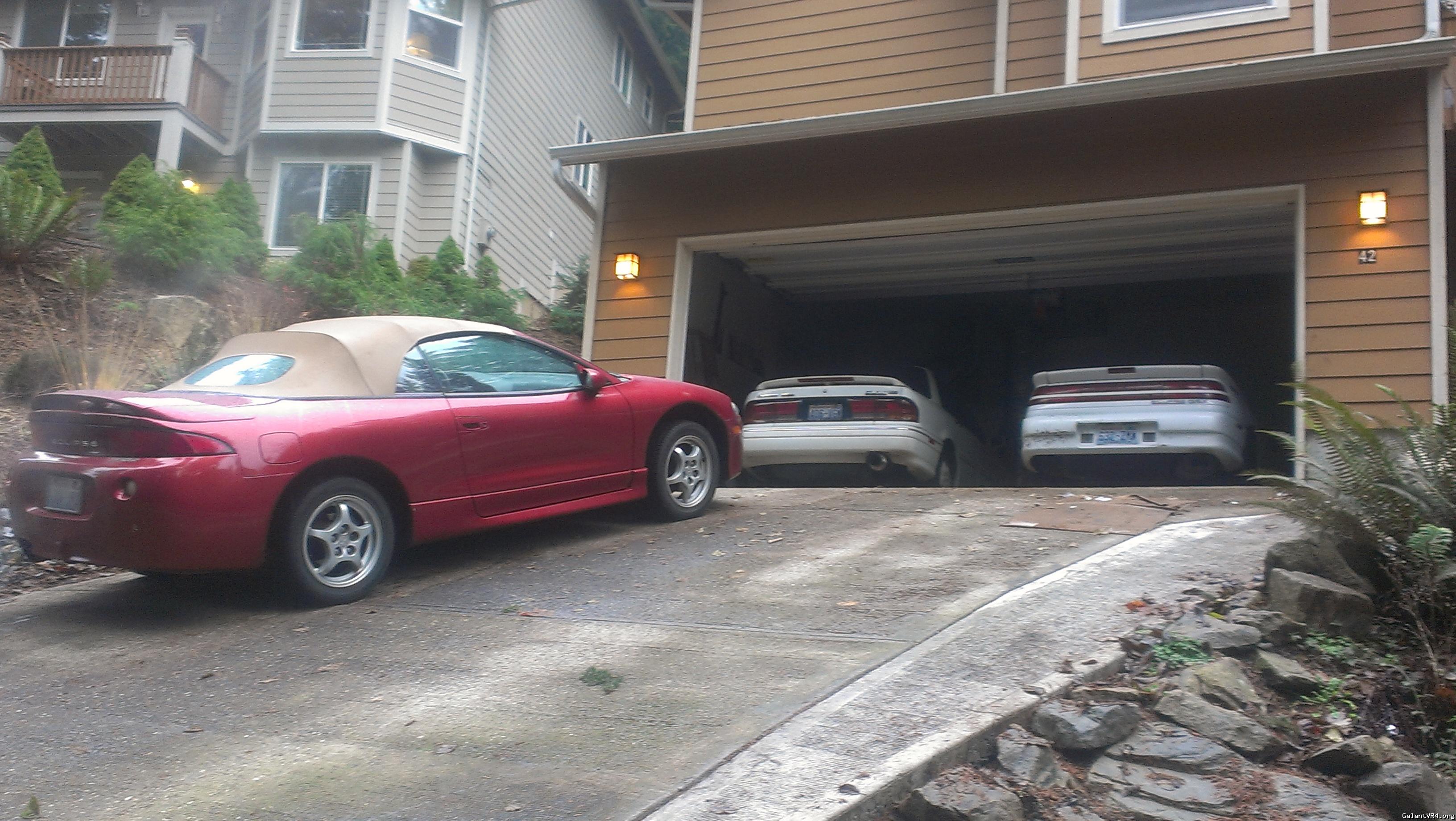

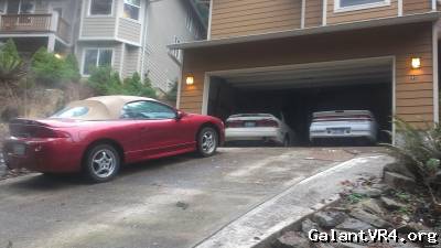

the 2g is gonna rust out in the strut towers anyway, haha. why bother garaging it when he already has 2 beauties sitting in there...

^ why is that? I looked at a 2g the other day and I noticed that. It was from Pa.
Because mitsubishi messed up, if you stick ur hand inside the wheel well and youll see that there is no type of protection, so just everything gets in there and sits.

yeah and there is also the factor of everywhere in my area when winter hits the salt gets tossed on the ground for like 5 months and people who own these cars dont realize the no wheel well covers and they dont clean there cars off after they drive in the salt. there for rust.
I haven't looked at it for rust, but its really clean. It leaks water though, so its normally parked where the galant is. The 1g was getting surgery, so that's why it was in the garage.
I'm closing on a house with a 3 car attached garage, so soon they will all have a spot lol.

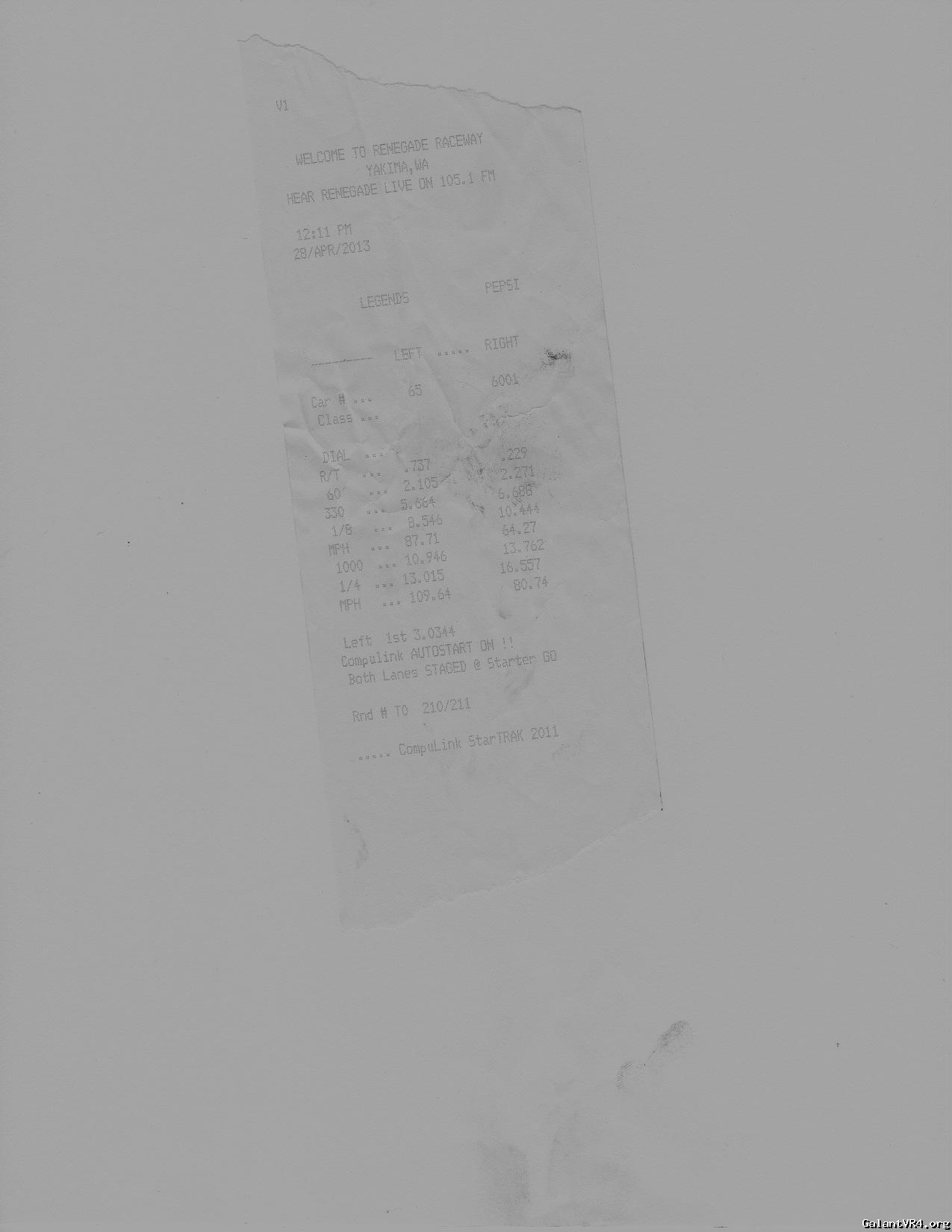

The trip didn't go too well. I only got one pass in with the galant before it broke. I bogged the launch badly but after that it pulled perfect. Completely untuned it ran 13.0. The stock GSX, terrible compression and all, ran a 16.5, 16.2, 16.0 and that's all I got to do.
Here's the pull. Click
GSX versus my friends laser. Click
