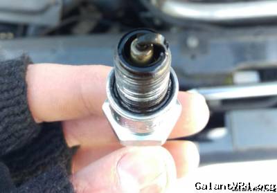

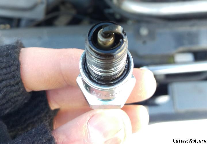

I verified spark on all cyl's and while #1 didn't spark to the head as enthusiastically as #2-4, it was sparking. I shut it down and pulled the #4 plug. It was loose, but I couldn't see any evidence of blow-by. Still, I was cautiously optimistic. The plug came out smelling shiny, smelling of gas and covered in oil.
That's not good, but a loose plug could likely cause all sorts of things to look terrible. I put a new plug in and things seemed ok for about the first minute of idling. Then it leaned out and went to sh*t again. I could actually idle fairly stable by just killing injector #4 in link, so I did this and let the car warm completely up, hoping that something was frozen and the engine heat would help it thaw. No dice. Still super-lean and misfiring.

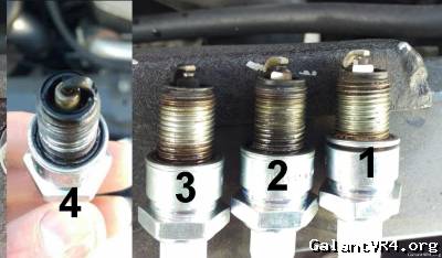

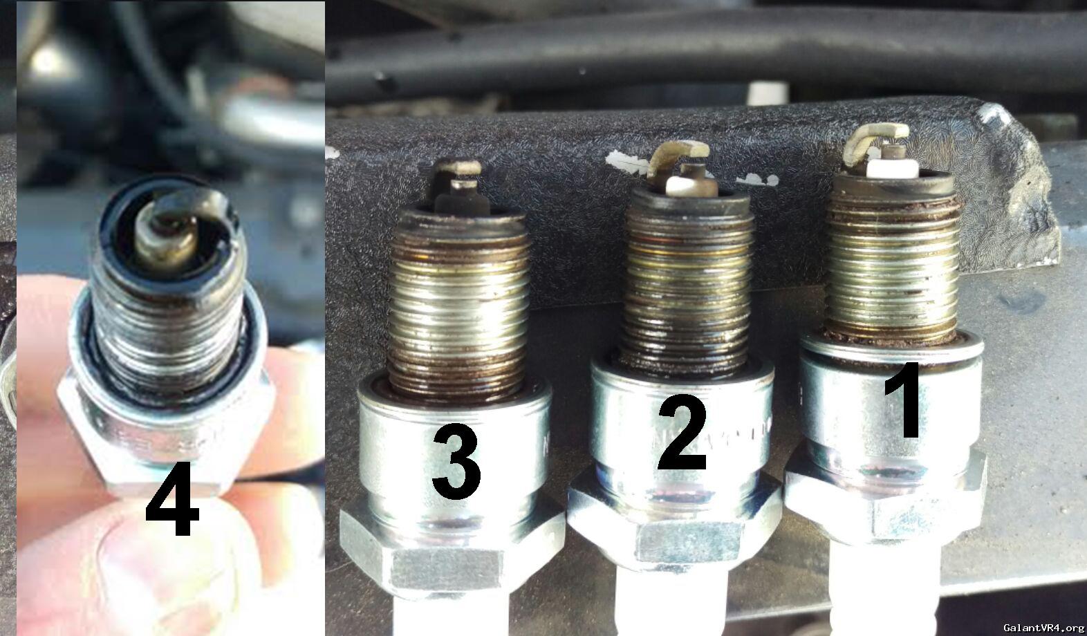

I pulled all the plugs and what an ugly sight...
That's cly 3,2, and 1 from left to right. #3 looked fouled by oil, and #2 and #1 were fouled on one half, and white on the other.

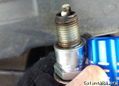

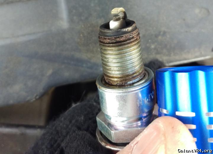

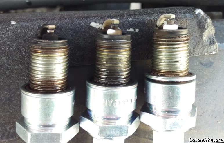

closeup:
My best guess is that my coolant froze and lifted my head on the transmission-side of the motor. I haven't tested it yet, but I'd bet I've got little to no compression on #4, I'm blowing oil into #3 and have questionable compression there, and that #2 and #1 are showing symptoms of rich idle, lean revs due to the clusterfuck that is #4 and #3 being screwed up.

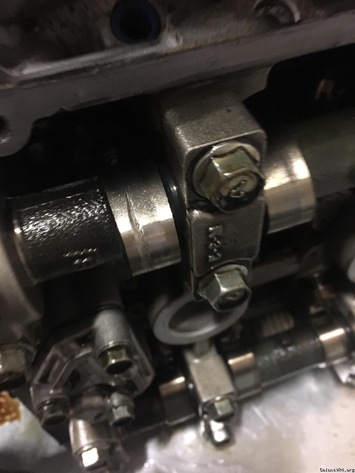

So we found the rockers. All were hiding in the head. We also found that one had grooved the intake cam when it decided to slip this mortal coil.

This actually fit with my suspicion that the head had only lifted a little bit from the side where the thermostat housing attaches to the head. it seemed to me that this would be the first area to freeze if something did freeze. I got this from looking at the condition of the plugs when I pulled them out. #4 was fouled with oil and gas, #3 was carbon-fouled, but dry, and #2 & #1 were half-fouled, and half-white (rich idle/lean rev).
