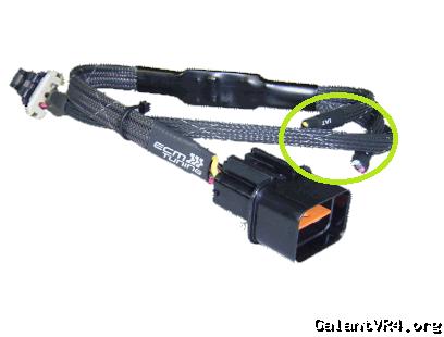

Quoting ECMLINK web site:
The GM MAF cable is actually a little more than just a cable. It incorporates a small PCB built with high quality surface mount components to provide signal conditioning required to feed the GM MAF signal to the ECU.
I guess a bit of magic happens inside the cable. /ubbthreads/images/graemlins/grin.gif

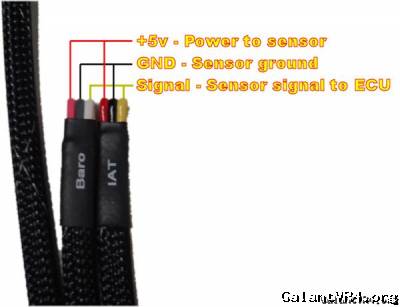

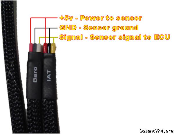

I pretty positive that the GM MAF does not get connected to the intake air temp and the baro input to the ECU. If you look at the new cable that ECMLink provides, it leaves those input out and exposed for you to hook something else into it, perhaps for dialing in speed density which does utilize those two inputs. I'm not sure how you hard wire it in though, I just decided to keep it simple and ordered the cable two nights ago.
If you look in the details paragraph for the GM MAF Cable from ECMLink, it verifies the baro and iat breakouts in their cable. GM MAF Cable

There is a post on ecmlink forum you can't hardwire because their cable has a mini PC board inside the change the signal to some the ecu can read.

I plan on using the baro break out for running my AEM WB (white wire), but it looks like the white wire for the baro is the same white wire for the gm maf?!?!
