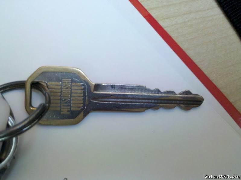

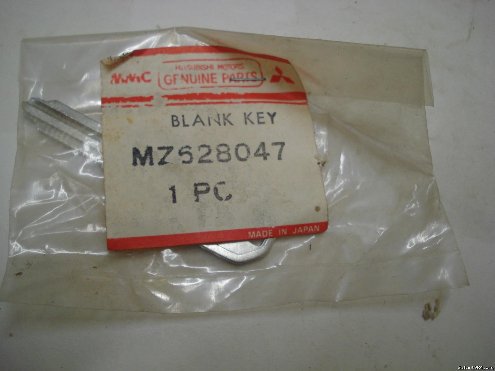

Valet key is ONLY good for the ignition and door (same way on Nissans) so that your punk kid valet can't rifle through your trunk, glove box etc.
Another bit of info for good measure is this:

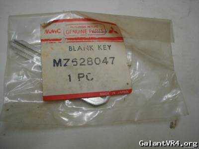

Master Key: MB543949
Valet Key: MZ628047
The valet key is actually missing the "tip" of the key which you can kind of see in these images.

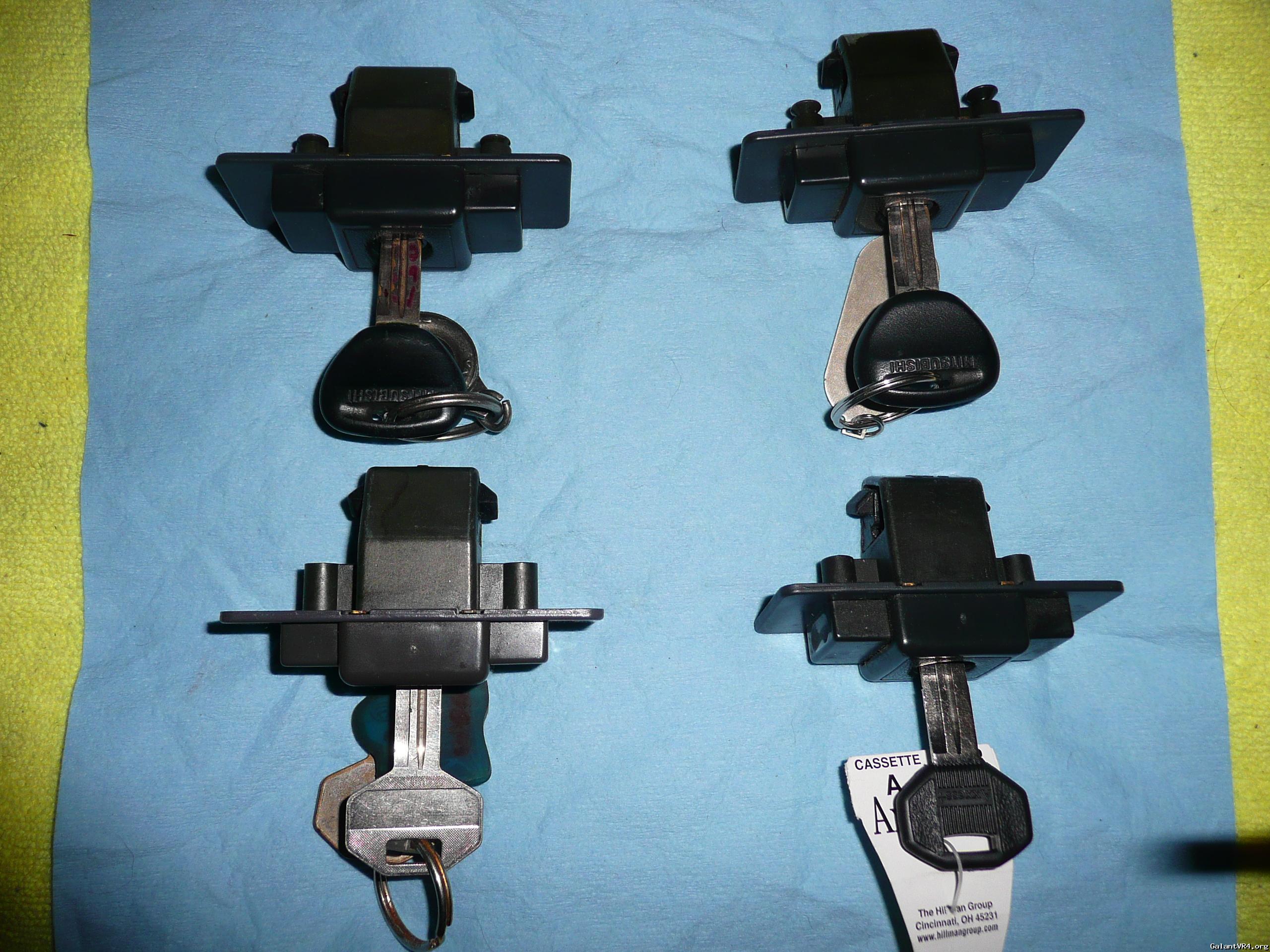

Got four glovebox lock sets here (3 vr4, 1 dsm)
... all four with the "master" key
All open the trunks, but only one (the one from a 92 dsm ... of course /ubbthreads/images/graemlins/banghead.gif ) opens the glovebox as well.
Looks like the vr4 glovebox locks I have are all borked. /ubbthreads/images/graemlins/banghead.gif
I had a new key cut for the nicest lock on the advice of my locksmith buddy. He said that the tumblers in the glovebox lock probably hadn't been cycled much, and a new key would probably do the trick. (Kinda suprised me he would say that as the new key is cut using the old (worn) key as a pattern, but hey, I'll try anything once.)
... didn't work ... /ubbthreads/images/graemlins/banghead.gif

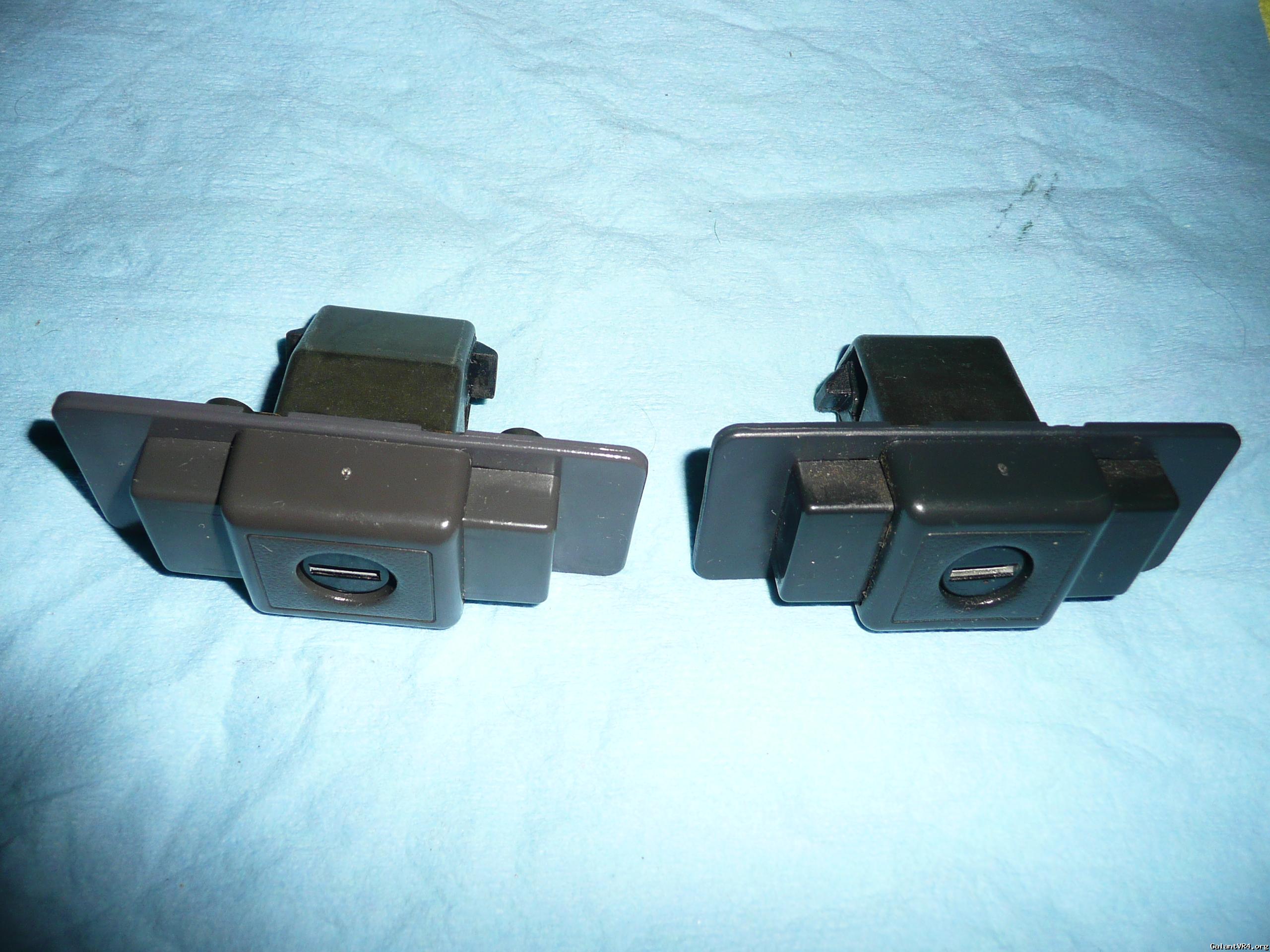

I did notice the dsm lock is dimensionally the same/fits/works in a vr4 glovebox, but the color is wrong
dsm unit on the left is grey, vr4 unit on the right is black
Don't want to send the young man the wrong color, so now I have a different task.
... figuring out why these lock cylinders won't cycle
Anybody got any ideas on this front?

Just a few more things to add to this thread.
1. The above photo is not my cars valet /ubbthreads/images/graemlins/tongue.gif, actually it's from another thread on this site!

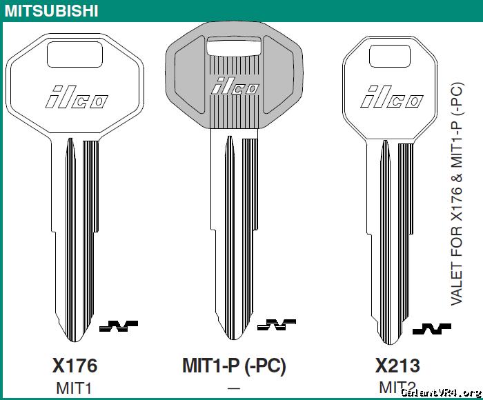

2. Here's one more pic to explain what I was talking about. You can see two regular 1/2g keys, and then the valet with it's missing "tip" /ubbthreads/images/graemlins/smile.gif

10,992
The lock cylinders should be removable from the latches. I don't recall exactly how to do it, but there is some method to release them. Perhaps in the service manual. Then you can examine the cylinder operation and/or switch them? I have a vague recollection of a paper clip inserted somewhere... /ubbthreads/images/graemlins/dunno.gif
The illustrations above show what I meant about the shape of the valet key, so thanks for providing the clear visual support for my muddy verbal attempt.
