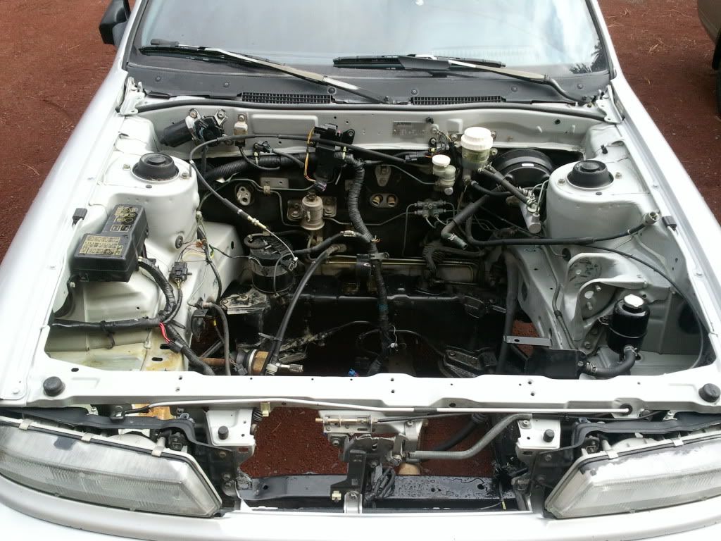

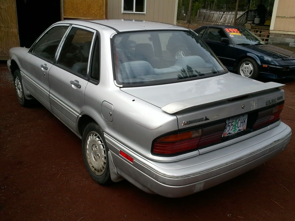

This is a 1990 Silver GSX i bought for 300 because the balance shaft belt broke and skipped the timing belt and mashed some valves! the car has 130k on it and the body was in great shape other then having a bunch of semi unknown band stickers on it and about 20lbs of trash! on the up side kinda it had about 4 fuel filters in the trunk and 2 sets of new champion plugs. too bad the plugs are pretty much worthless! So i bought a 92 Eclipse GSX for my donor car that was munched in the side pretty good! the car was in unknown running condition because the throttle body was missing, all the underhood relays were gone and so was the BOV.

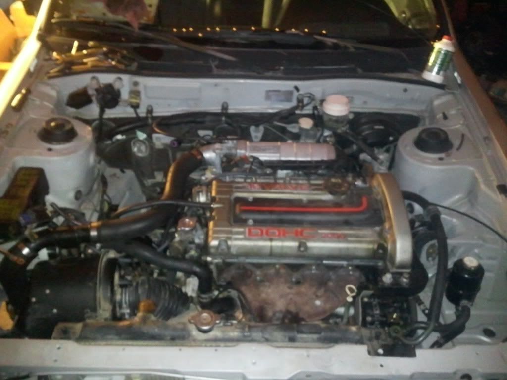

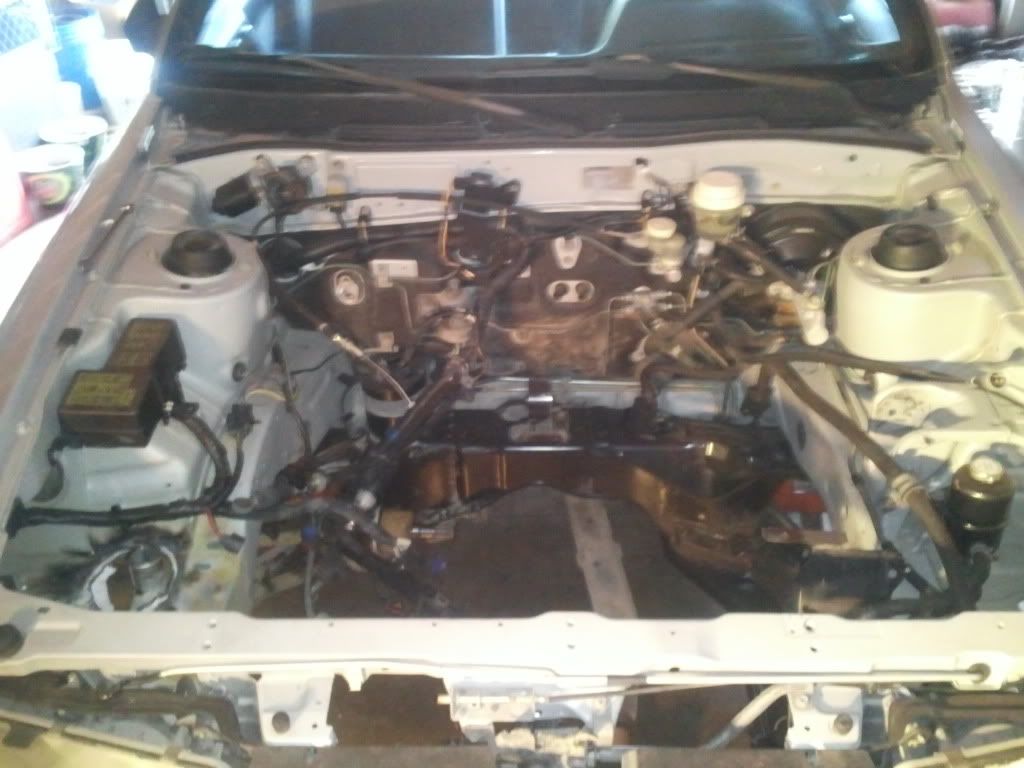

So first thing was first. Pulled the Non turbo 4g63, rear diff, exhaust and driveshaft and cleaned the engine bay!
Harness swap, and Rear end to come next stay tuned.

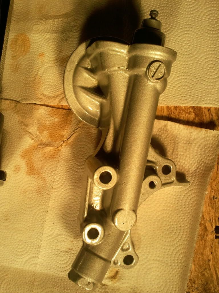

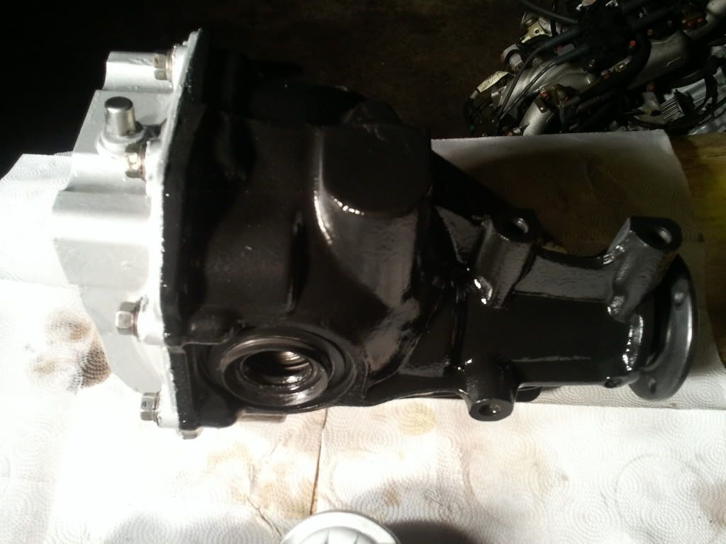

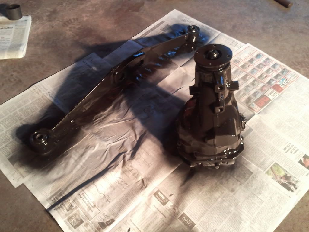

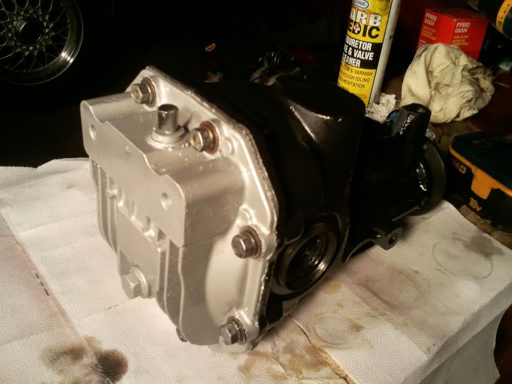

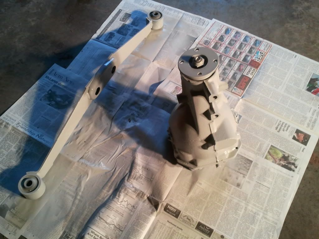

So i went ahead on worked on getting my LSD rear end cleaned up and my mustache bar here are the results:
Cleaned and primer-ed
Painted and cleared, did not do an amazing job but pretty good
Final result:
Did my Oil Piece too since it was right there and i wanted to see how it would come out

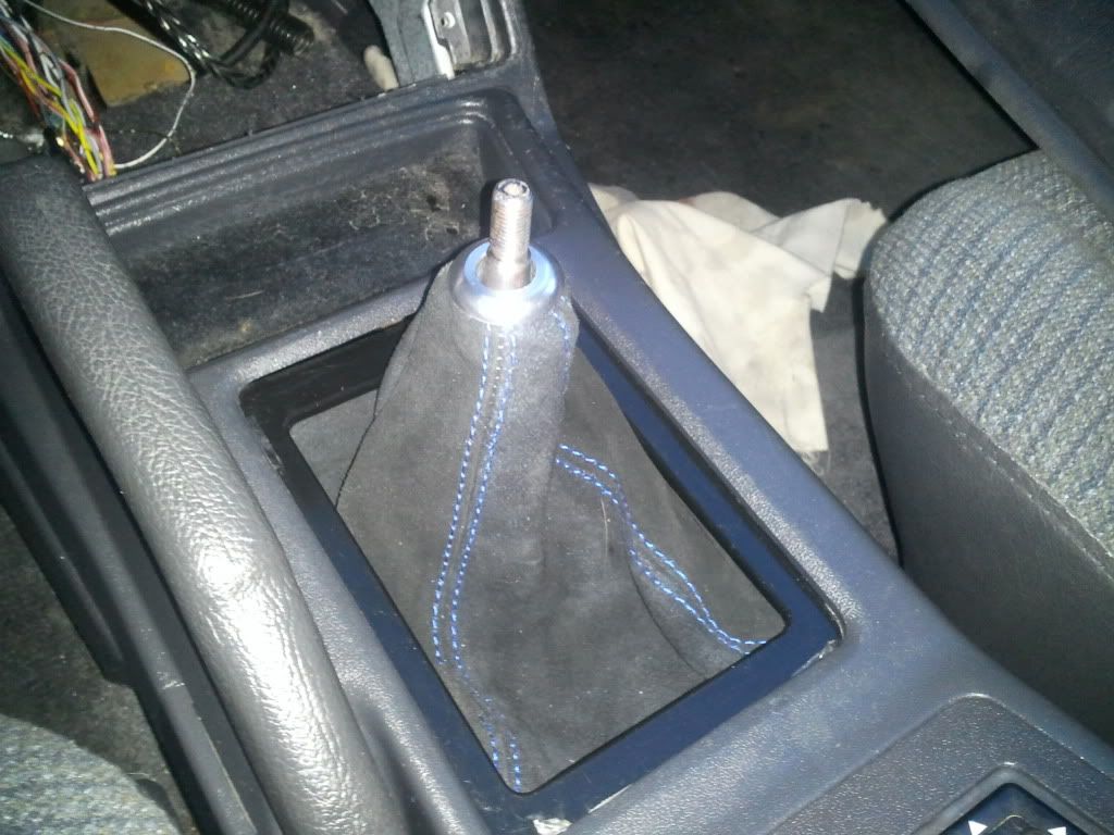

im just adding wires.. i was going to swap the harness but then i thought to hell with it. there are VERY few differences but thanks! ill have the 5 lug on it tomorrow and i pick up my block and head from the machine shop Wednesday. I put in my 1g shifter and converted it to a boot, just waiting on my shift knob to get here now and i got an evo IV wheel.

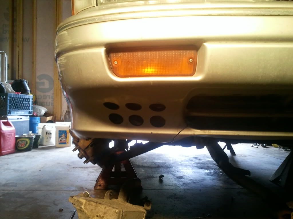

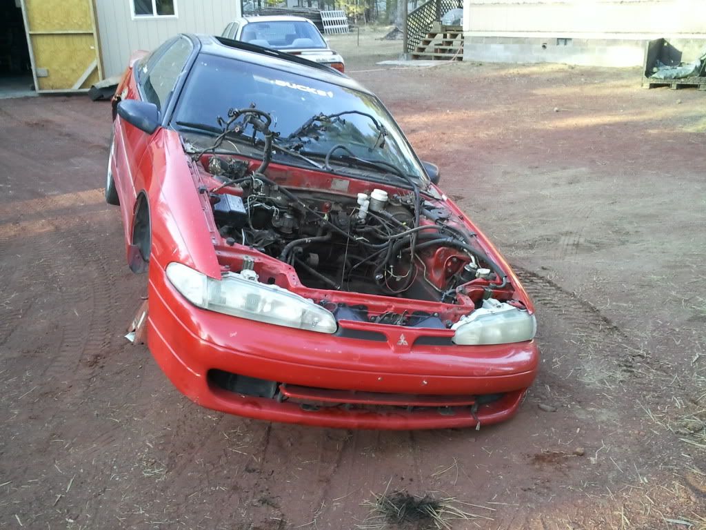

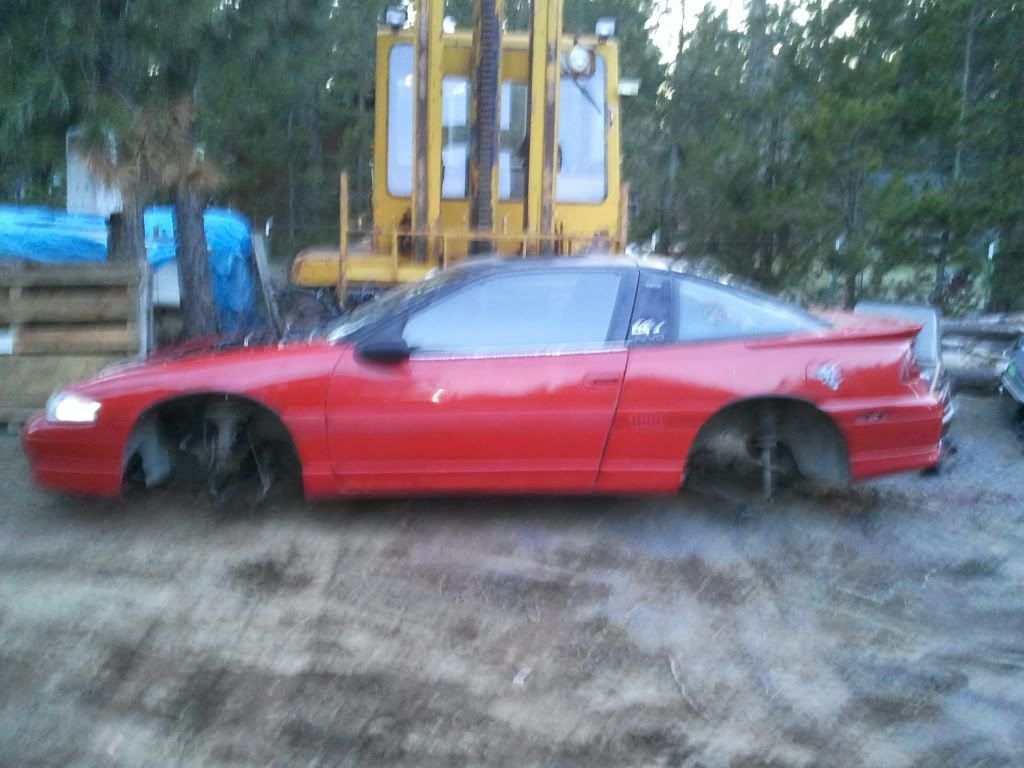

So i Molested the parts car today and touched it in places noone has ever..... and i got to put it on the redneck lift today and got it cleared and ready to get hauled off to the crusher. here are some pics

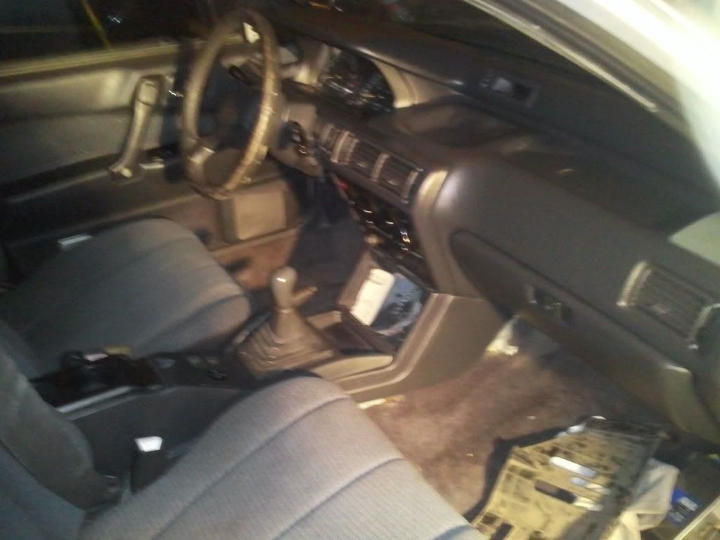

Did 1g shifter and boot waitng for knob
boot = ebay 9 bucks shipped search for suede 3000gt boot.
yeah i put it under because i thought it would look better...

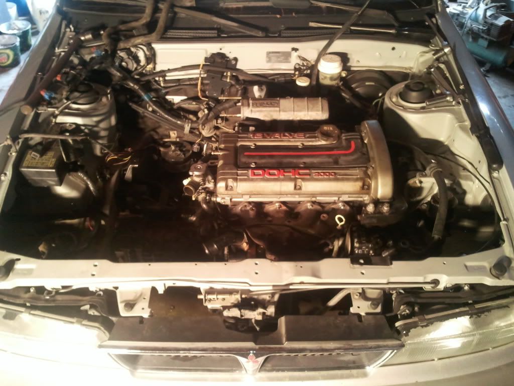

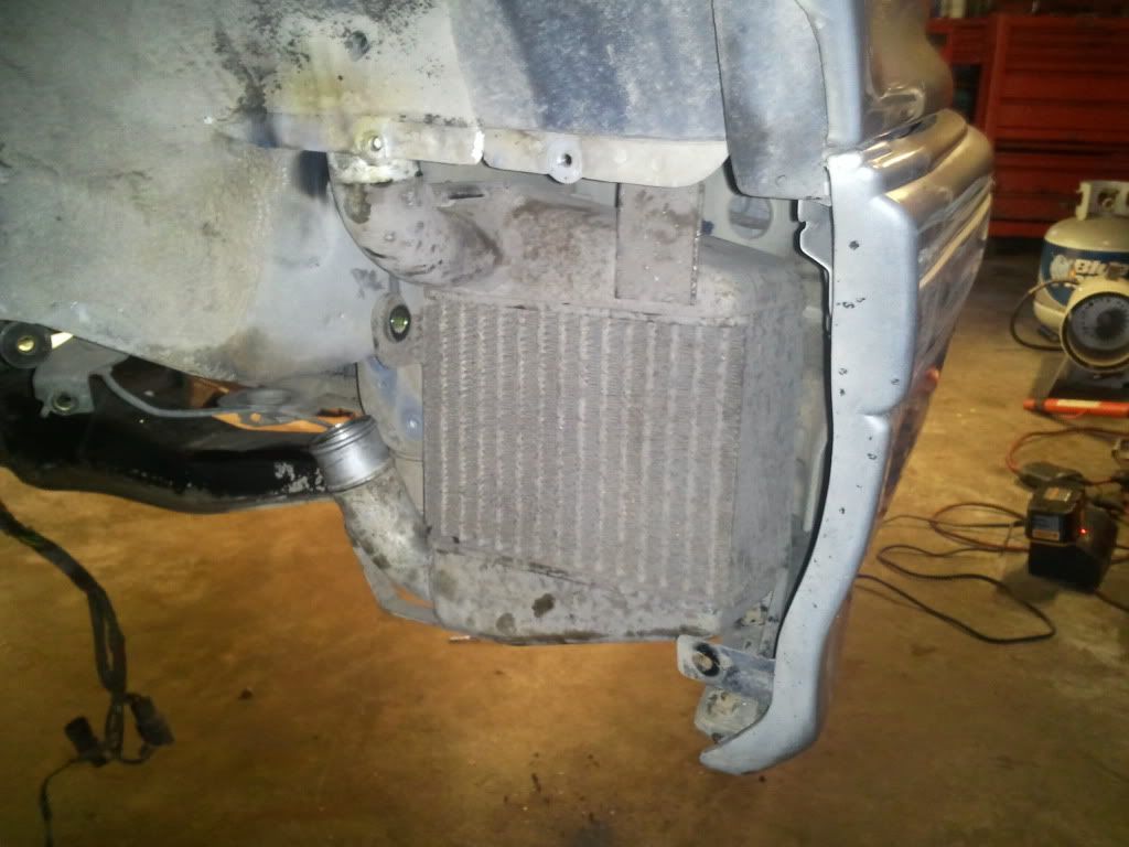

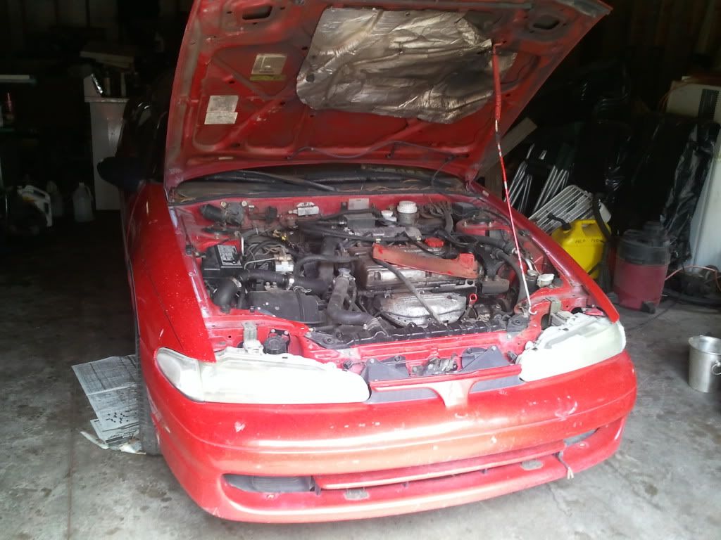

So i havent updated this for a while.. and well i got a hair up my ass today and just about finished it. not as grand as i planned but i think im just going to sell it. i ended up just using the ggsx trans and diff with a new clutch. and just added the needed wires to the harness and moved some things. i actually just used 1g piping and sidemount instead of gvr4 stuff. so it was interesting to do. i am just about finished tho. maybee another 2 hours here are some pics!
bout 11am
bout 1pm
sidemount action and had to make some air go to it. not fancy or super efficent but will do the job.
almost done!
inside all back together almost
let you know how it runs on wednesday or something when i get back to it.
