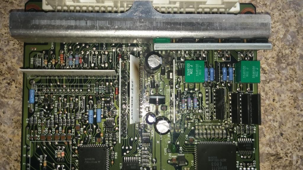

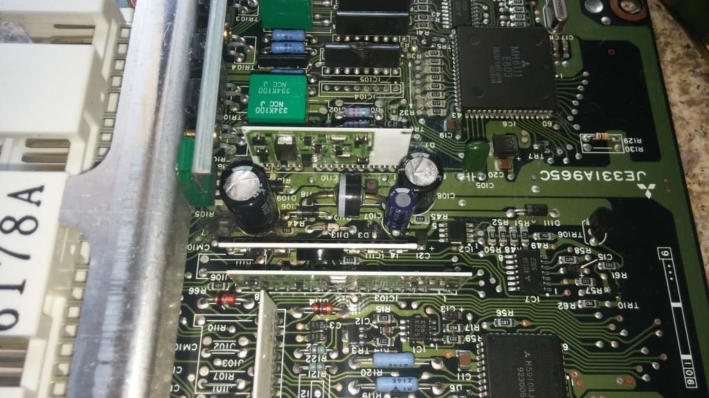

I'm on my phone and can't see the pic too clearly, but i'm asuming by the comments that the caps smoked? Since it was still working some what you can try to solder in new ones or just get a DSM unit and sawp the case. All 94 nt DSM units have eproms but also California emission. You should solder in new caps for what ever ecu you use if it was not already done.

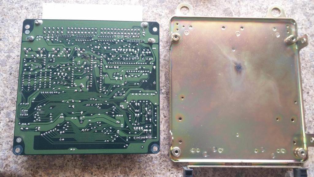

Yeah, bro. A lot of smokage goin on in this ECU. I sent the pics to Thomas and he is gonna hook it up for me. The car ran, just drank gas like crazy. I want to DD it while I build the turbo motor for it so it was annoying

that big capacitor by the green transistor is dead.
happened to an ecu i was socketing...
cleaned it with carb cleaner sprayed on q-tips to clean u the area at first...
