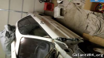

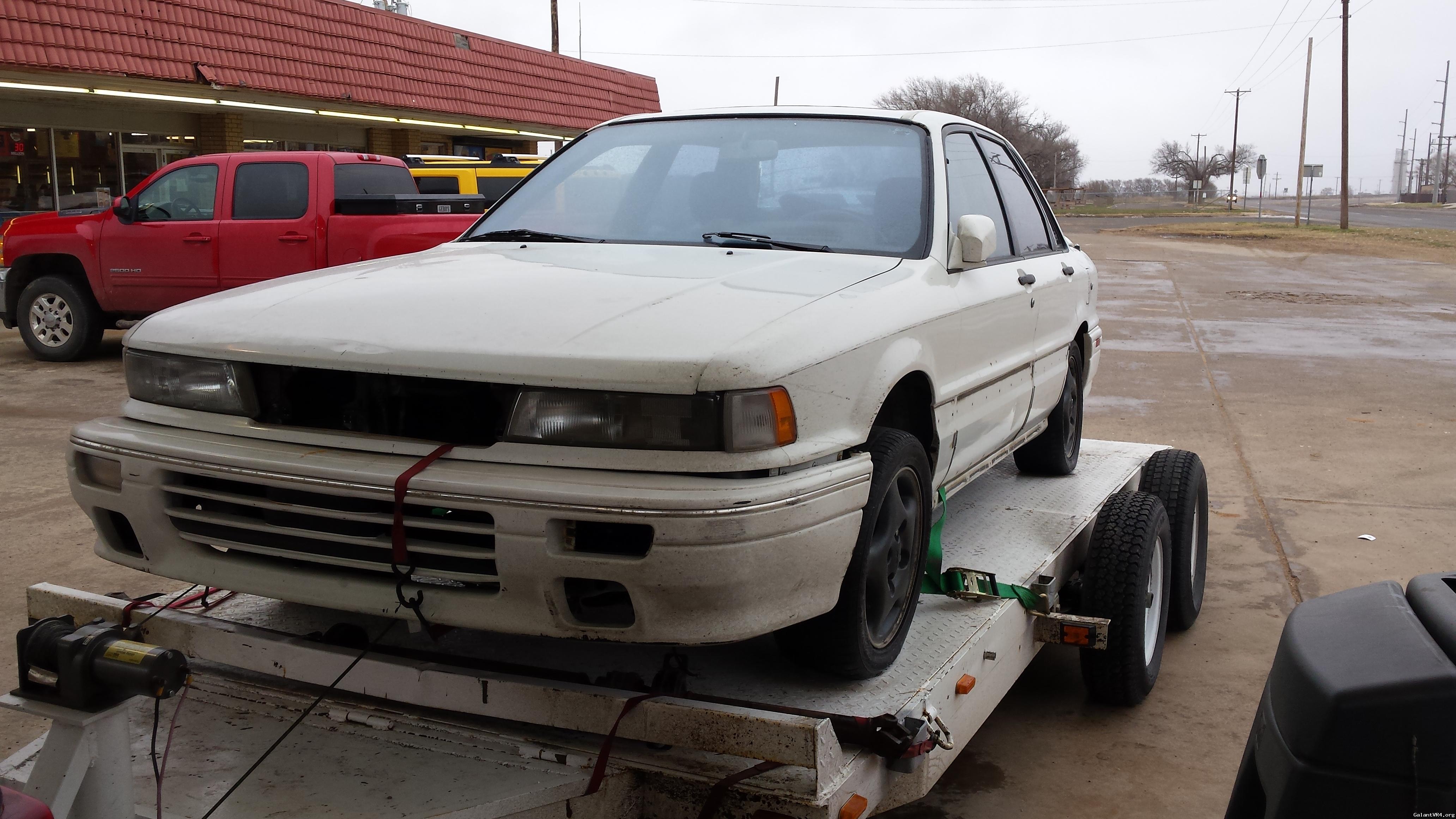

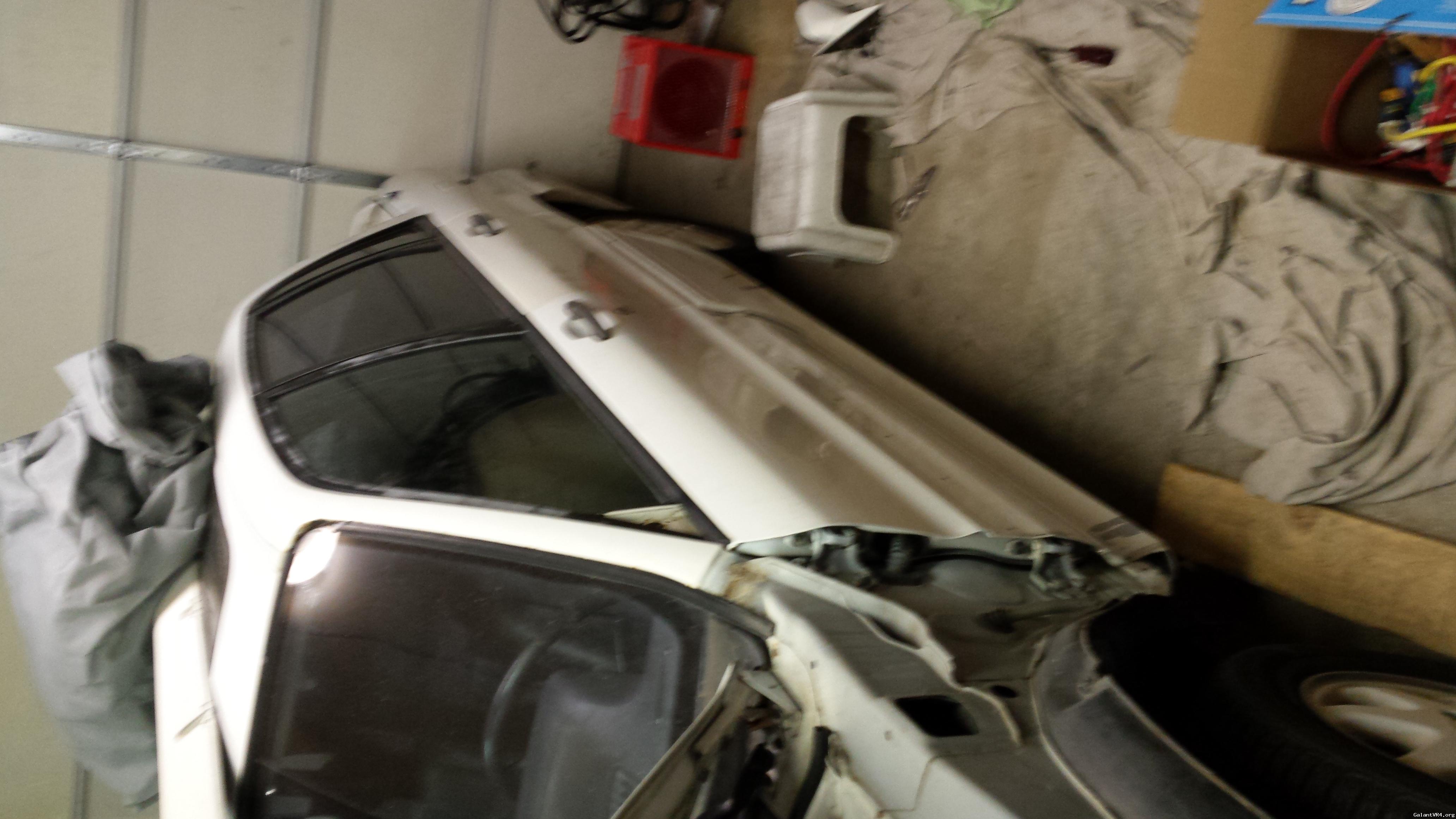

I figured I should probably post up the progress of 577/2000 as I go along. I bought her back in Jan 16 out of Texas as a partially stripped shell and have slowly gotten the parts etc... together to get her back on the road. Here are a bunch of pics from when I got her to now.

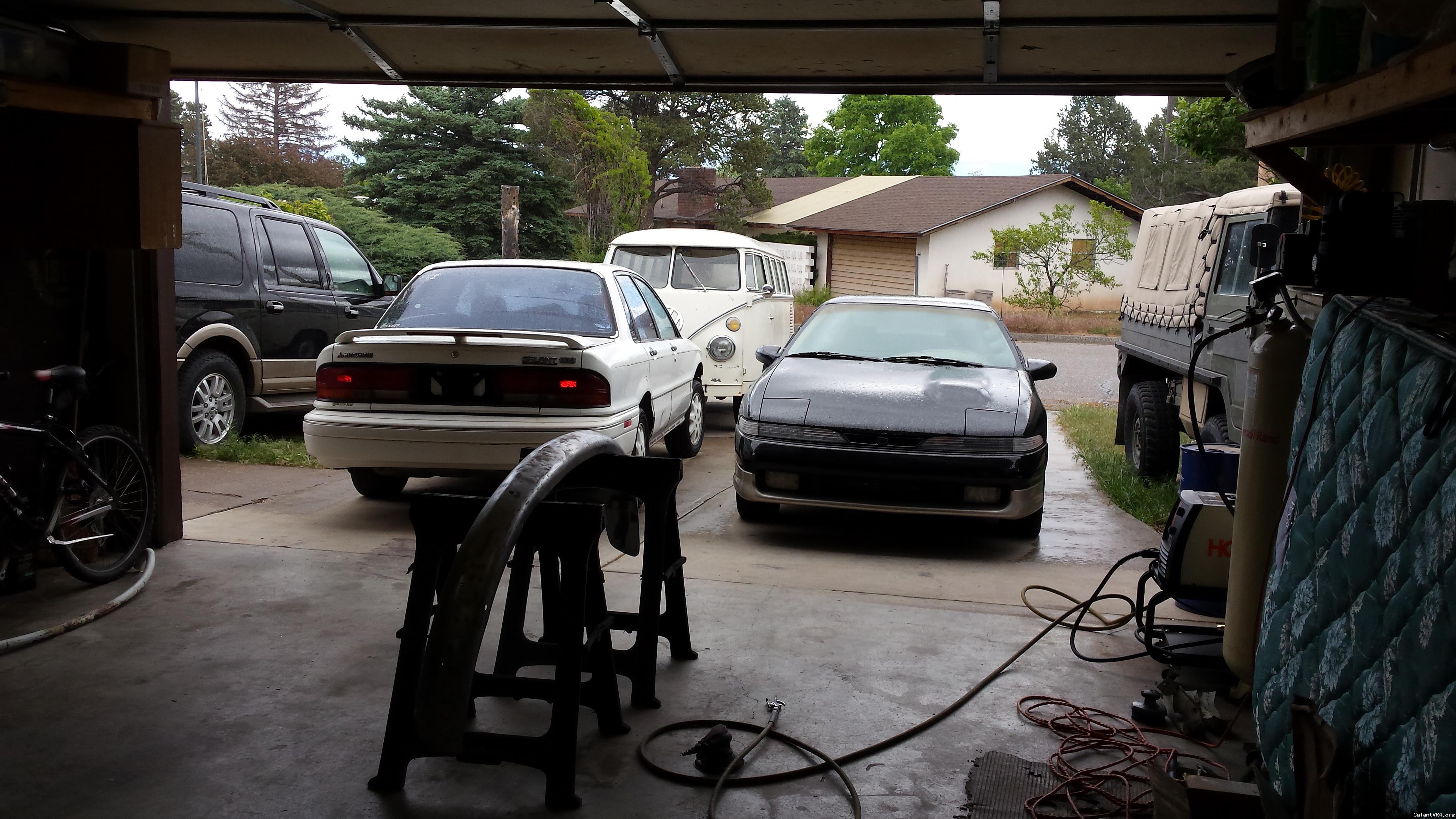

Wasn't much of a looker when I got her.
With the distant cousin, lol.

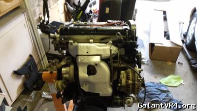

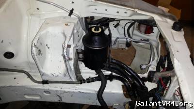

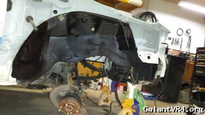

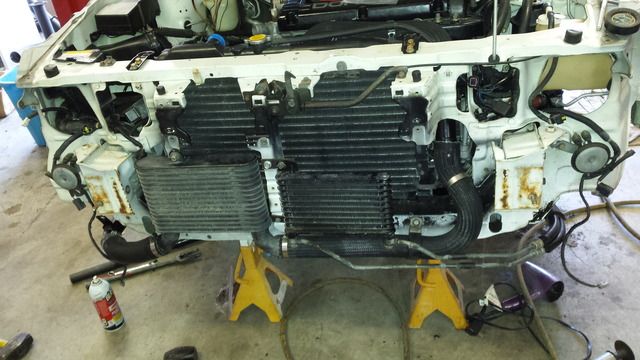

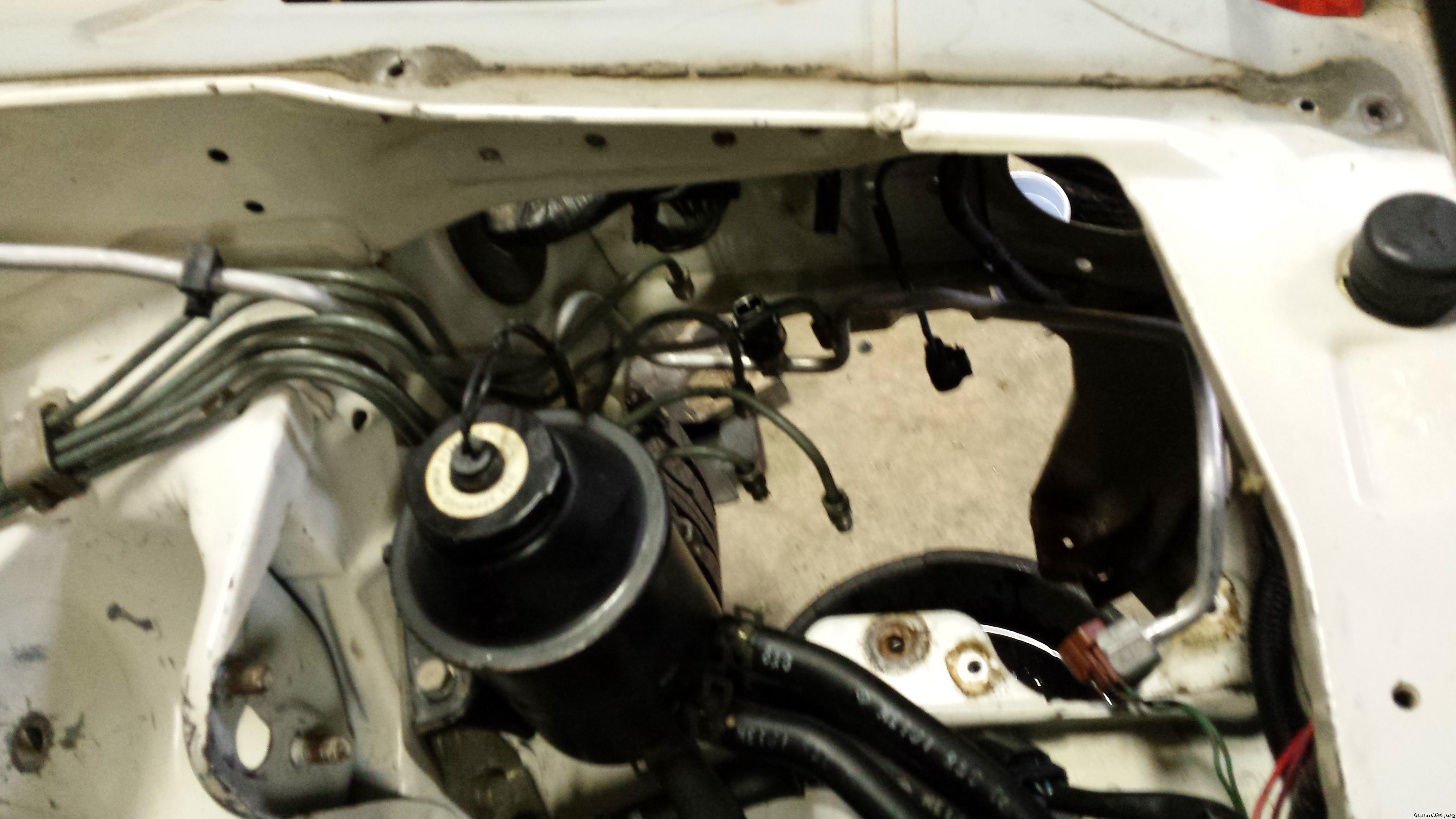

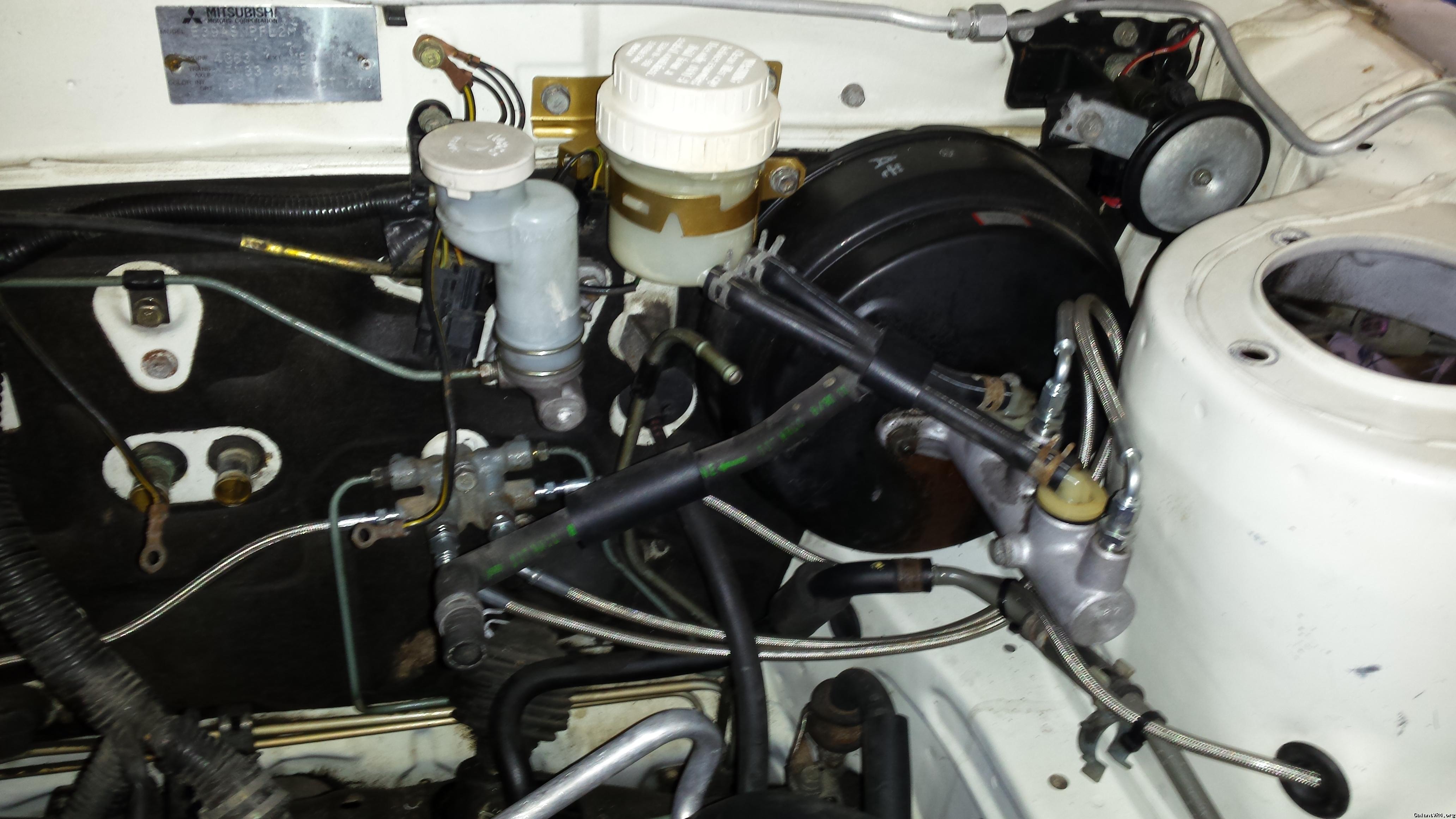

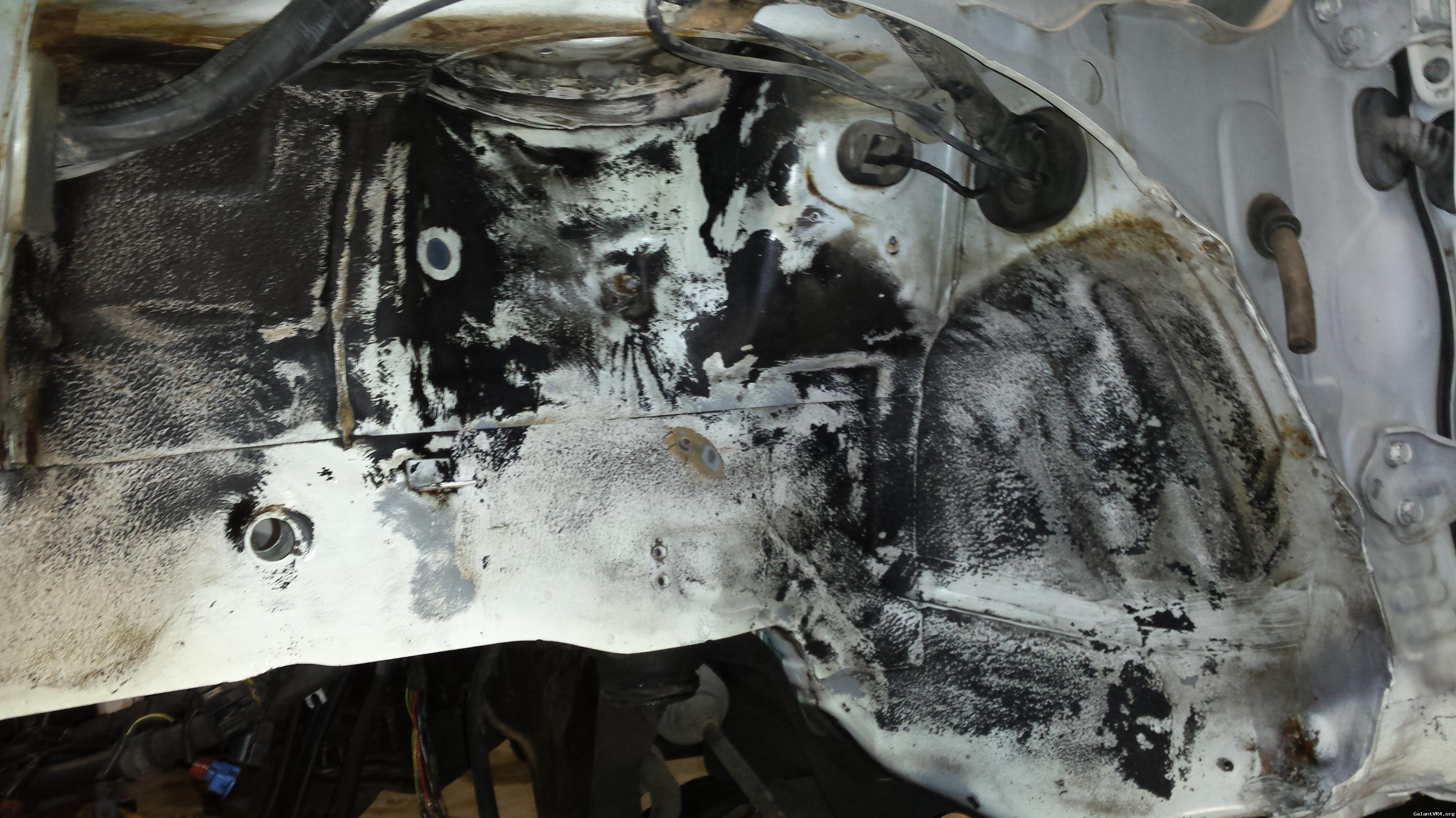

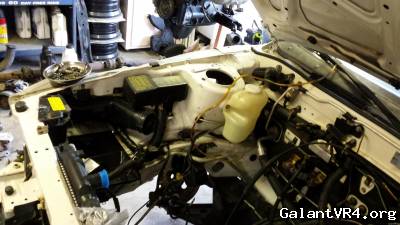

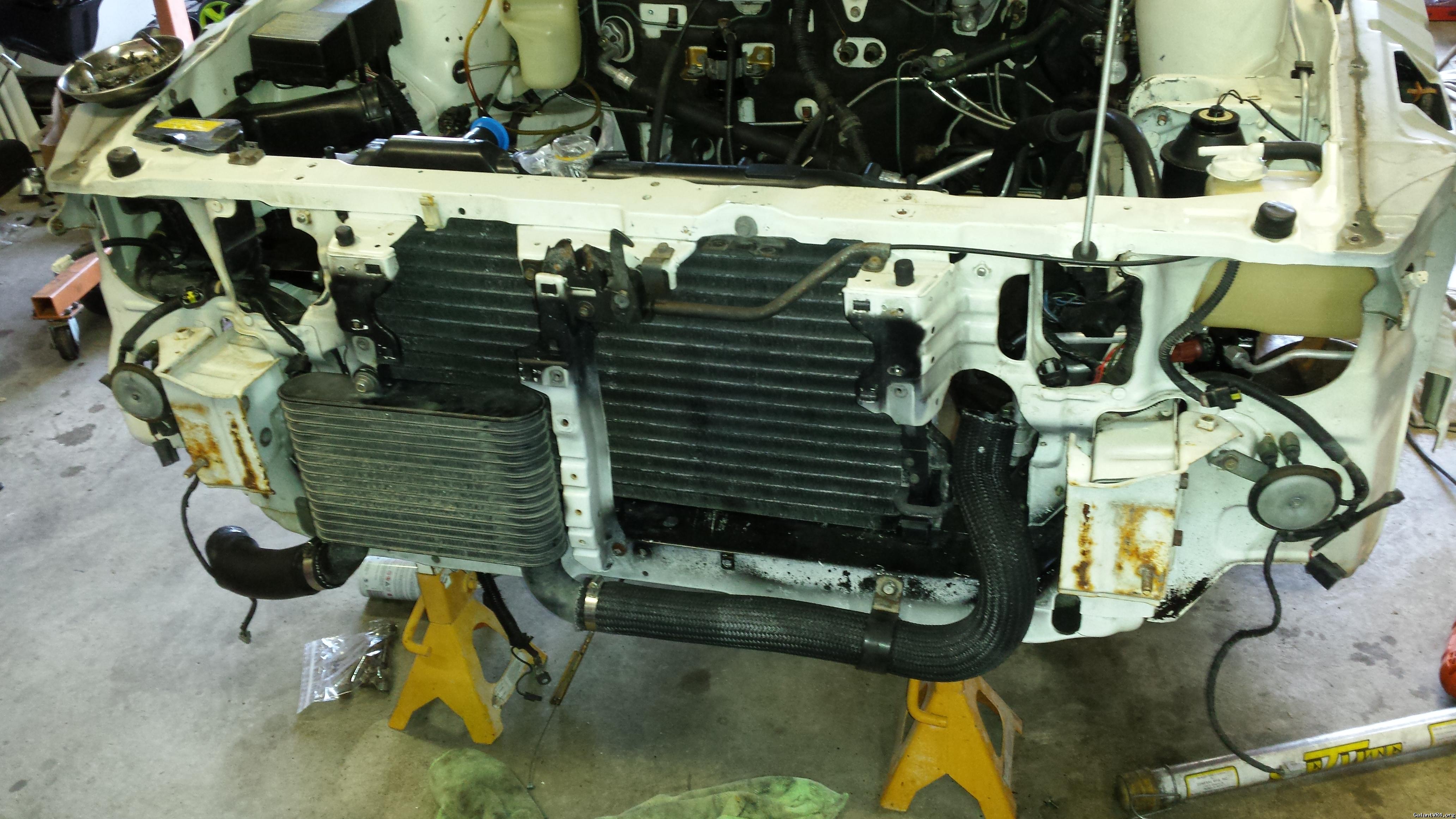

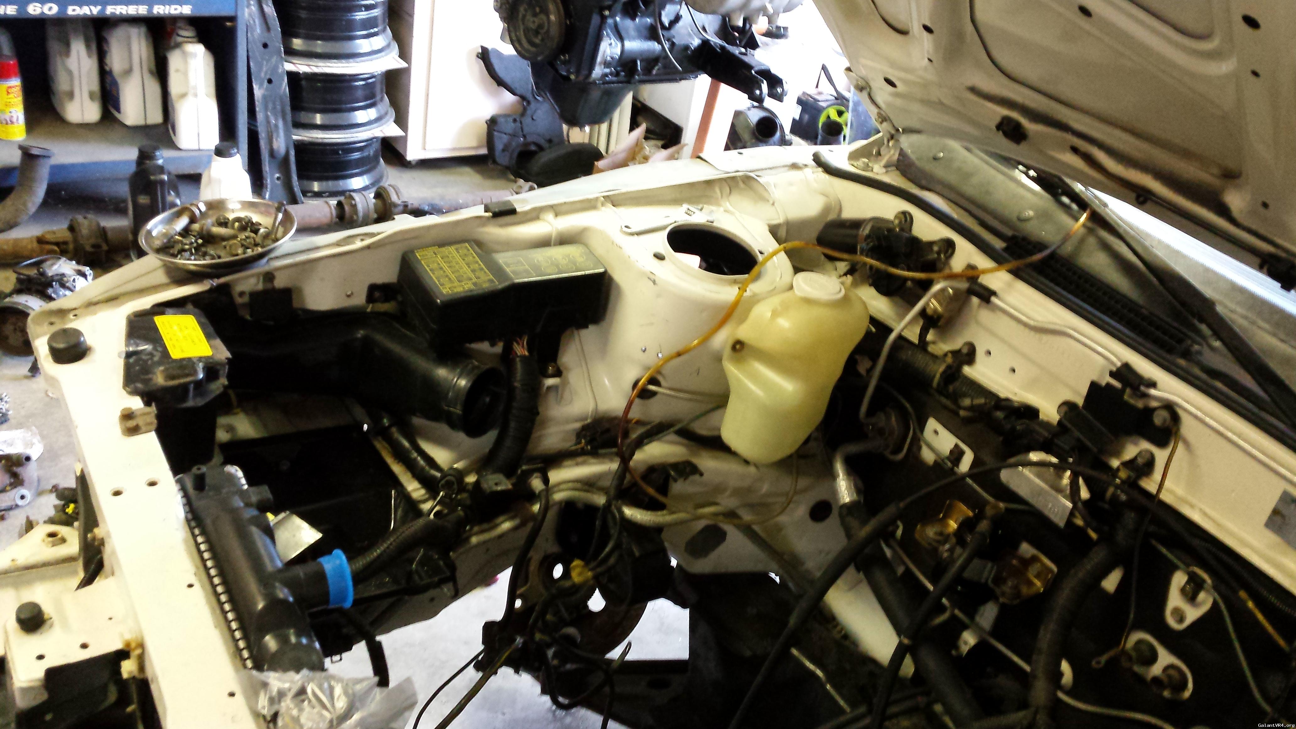

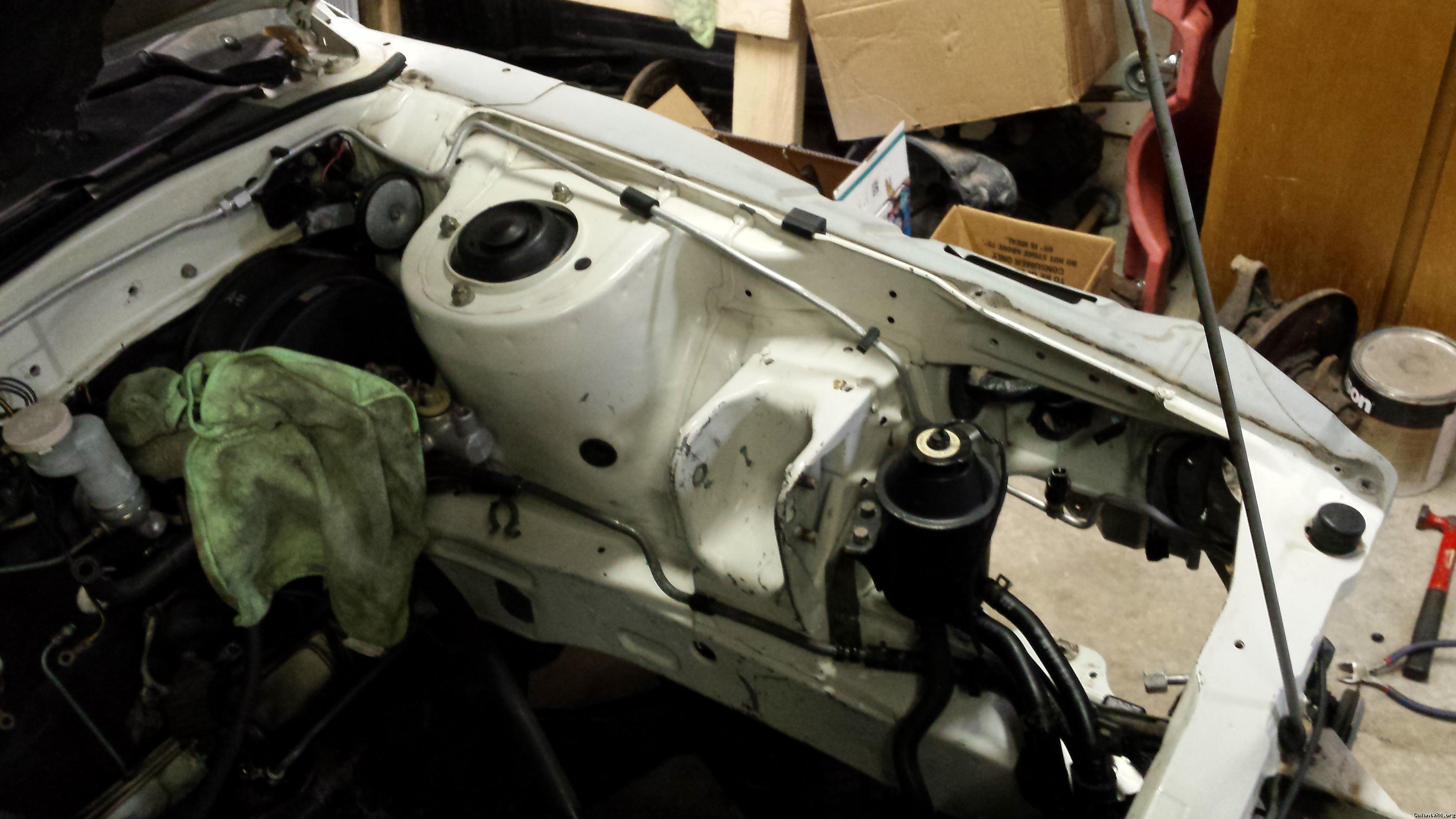

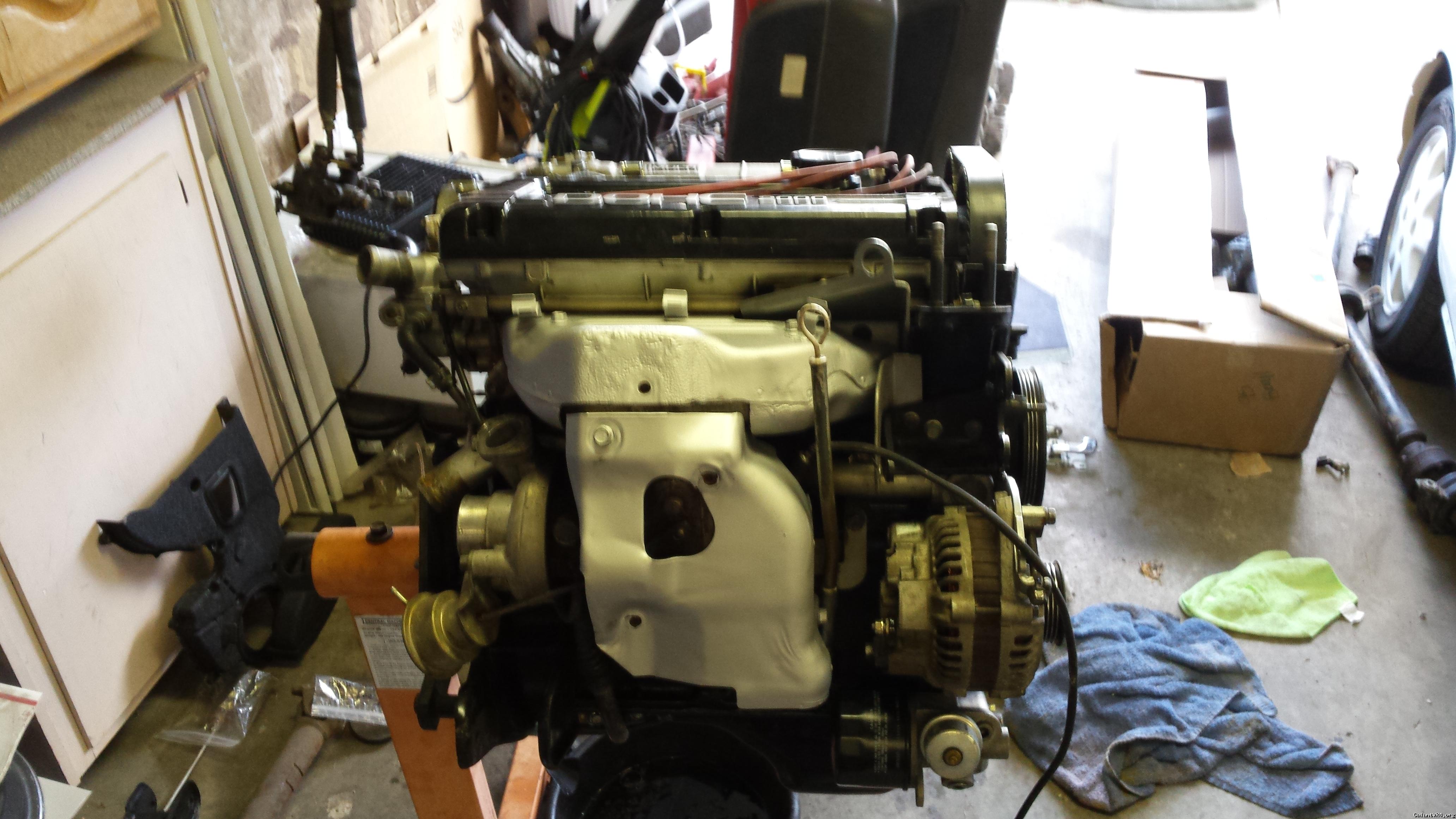

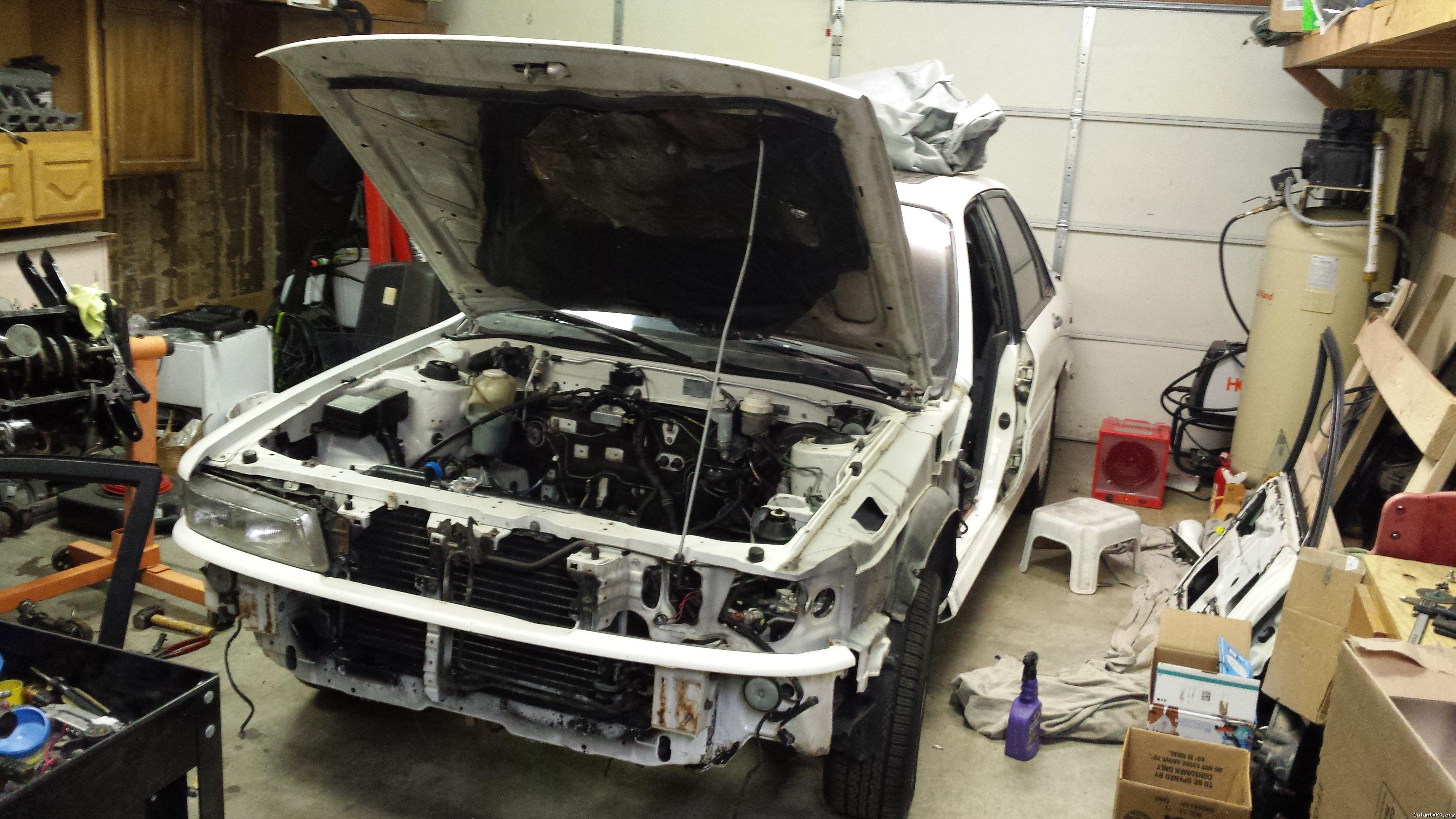

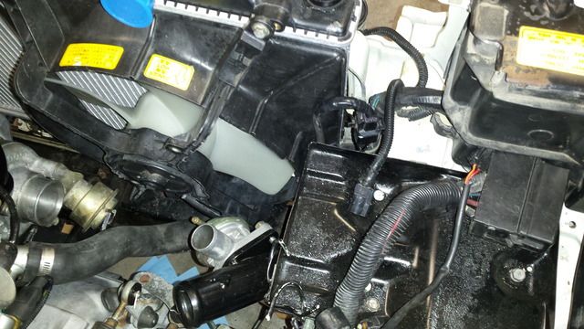

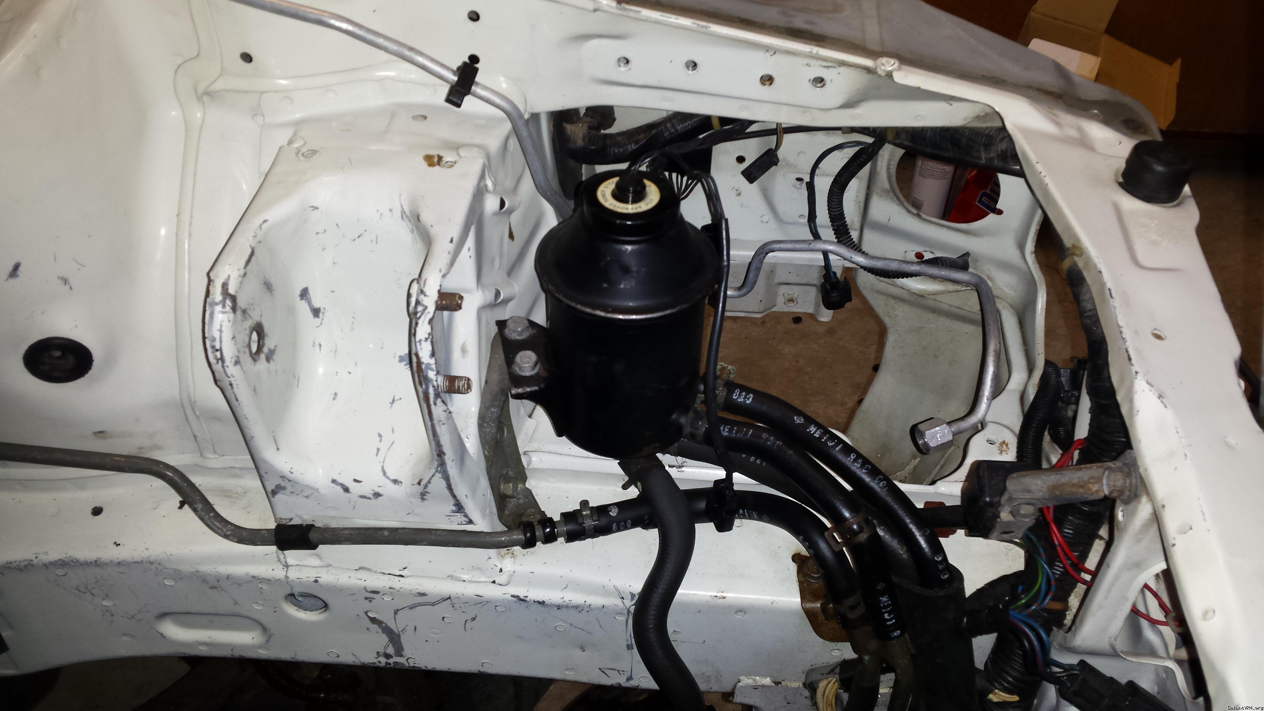

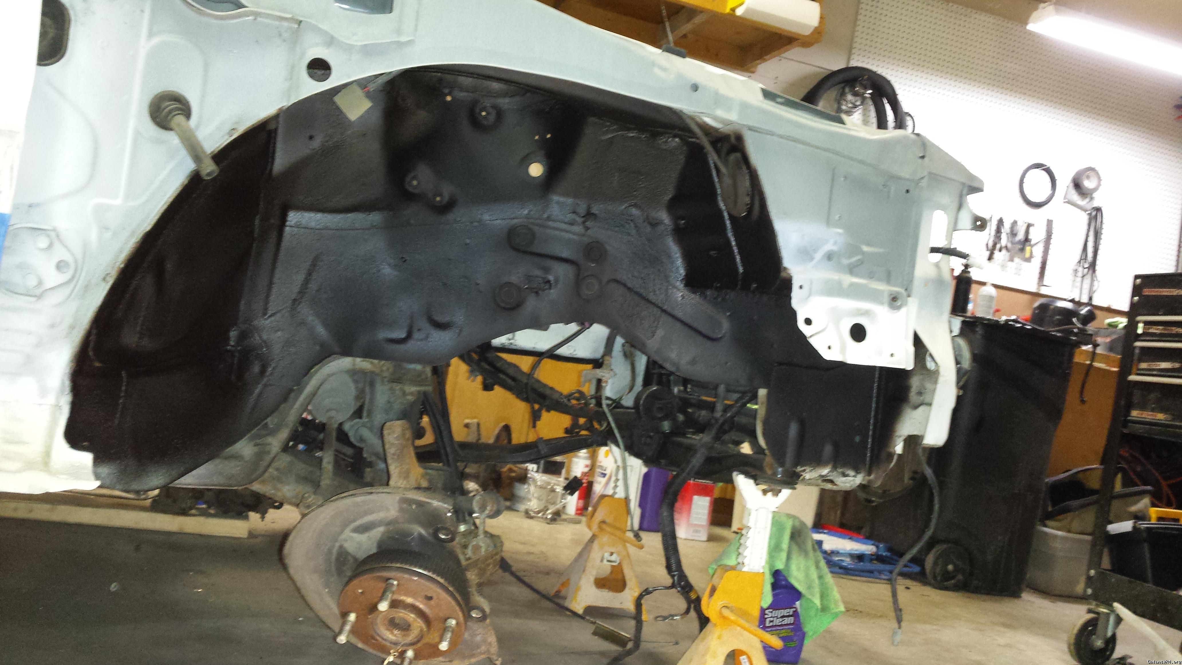

Here are a bunch of pics from the last couple of weeks getting the engine bay and front wheel wells all cleaned up. Also getting the 2.0 out of the Talon ready to get dropped in.

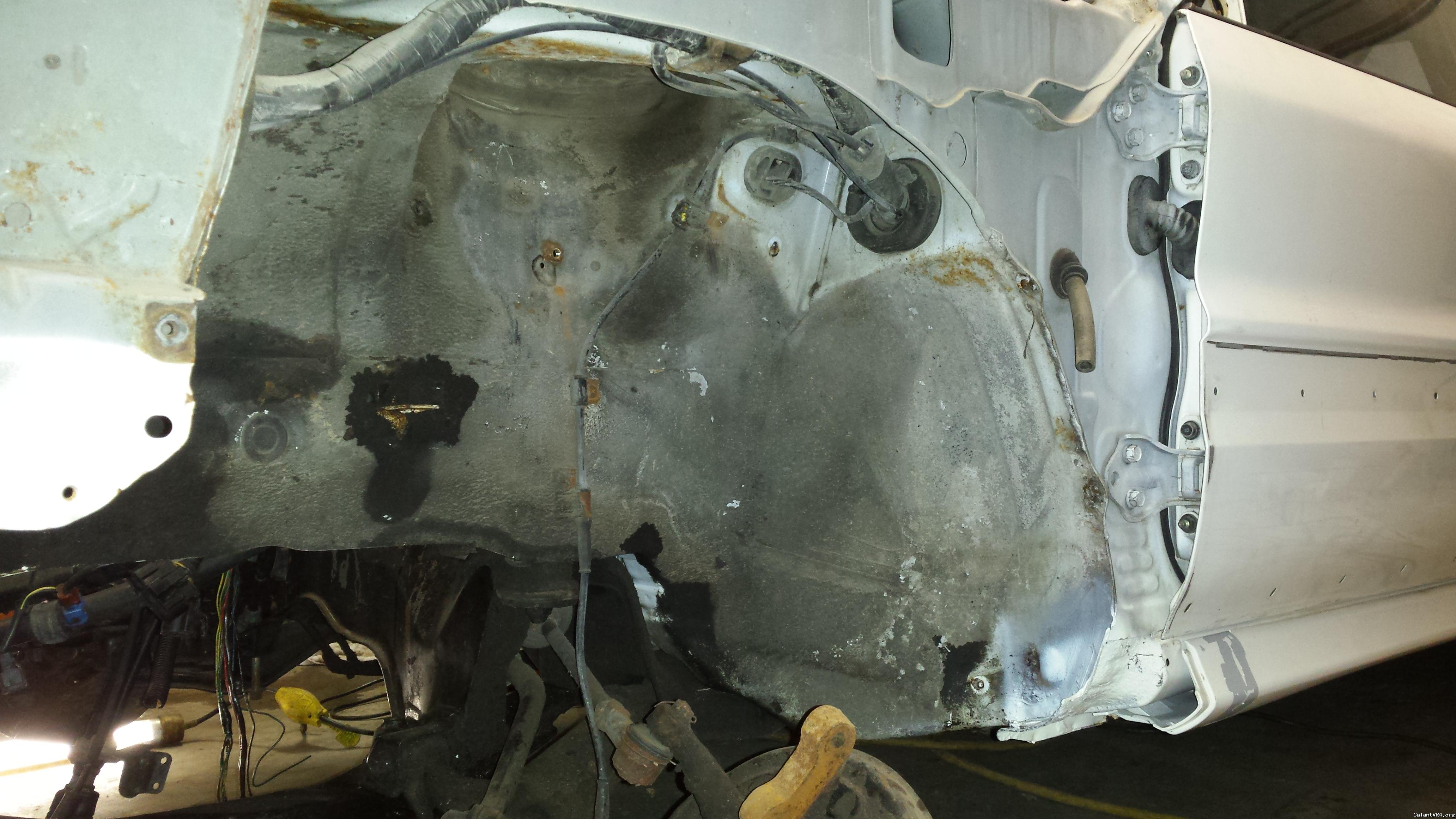

The bottom of the drivers door was rusted out so I sourced another Summit White Door and swapped out.

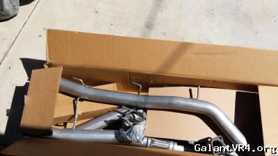

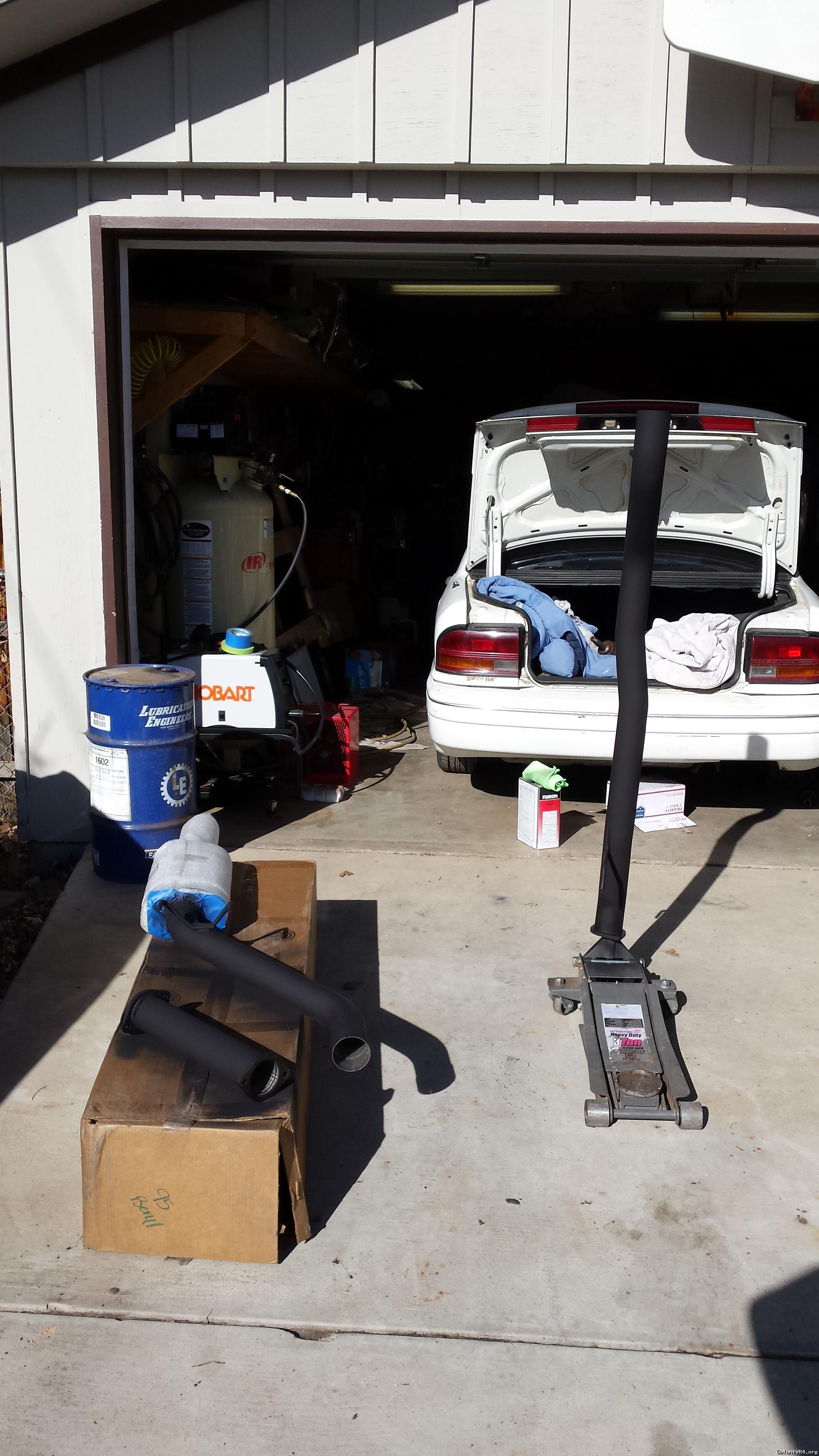

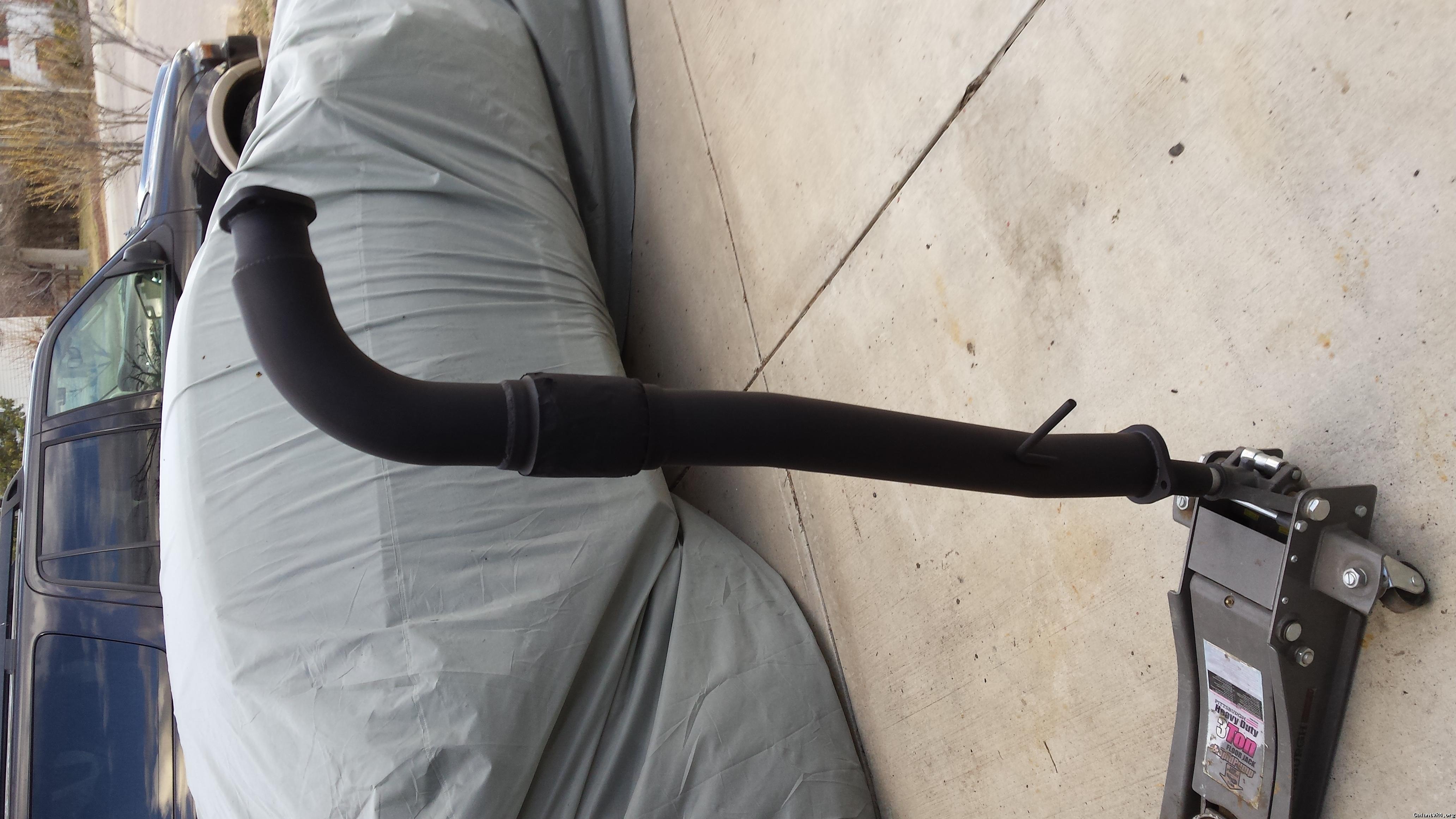

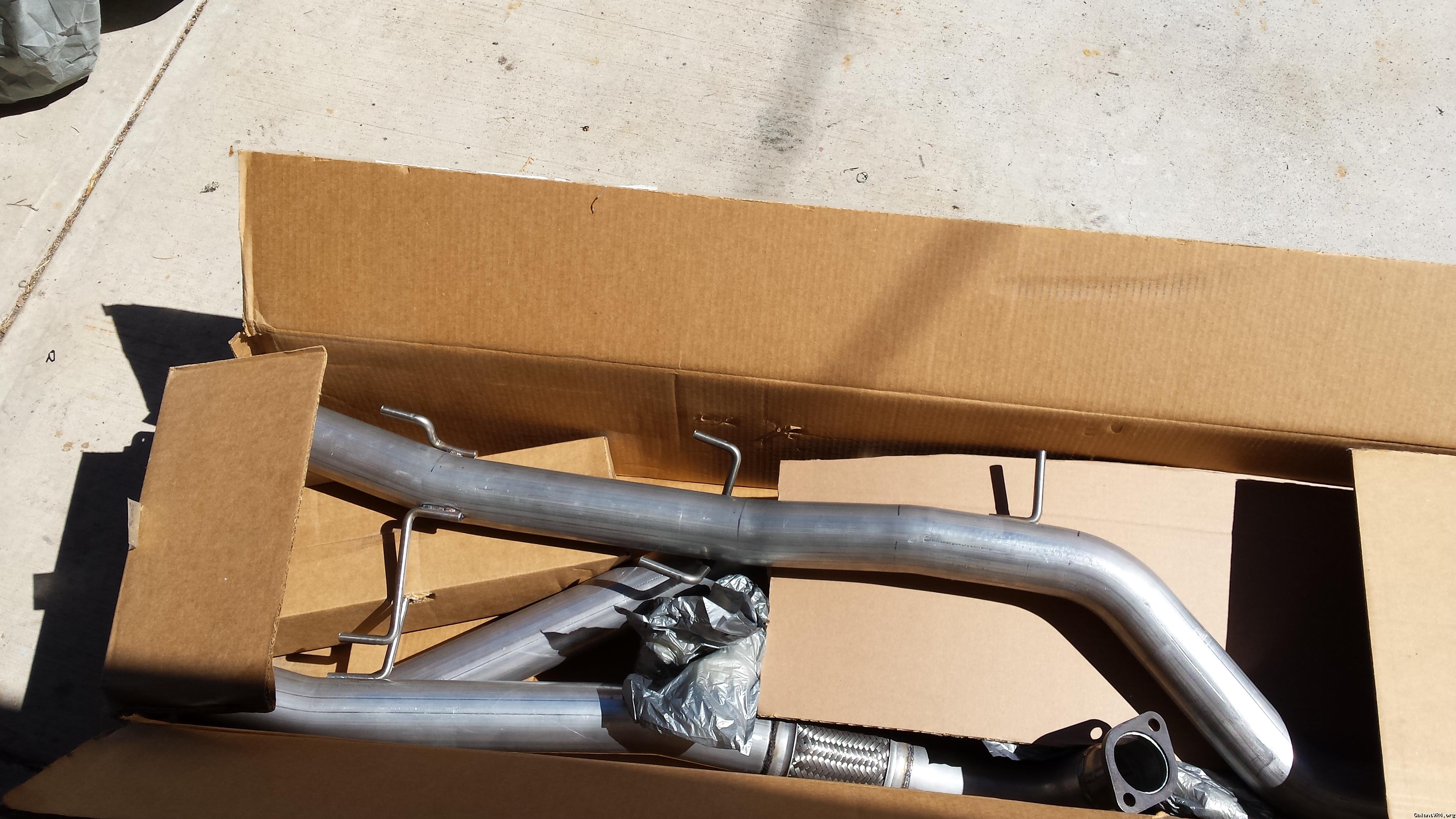

My CM exhaust showed up on Friday, got the down pipe painted yesterday. I went with aluminized for cost and I'm not a big fan of stainless steel. So VHT header flat black is what I paint my exhaust.

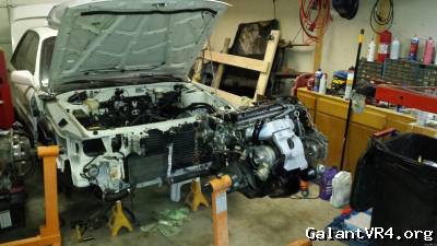

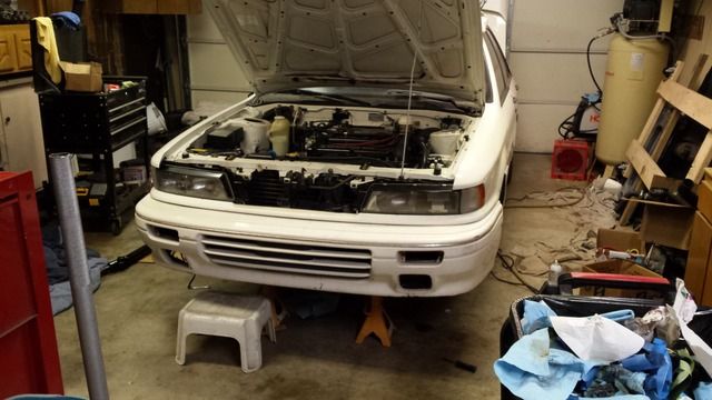

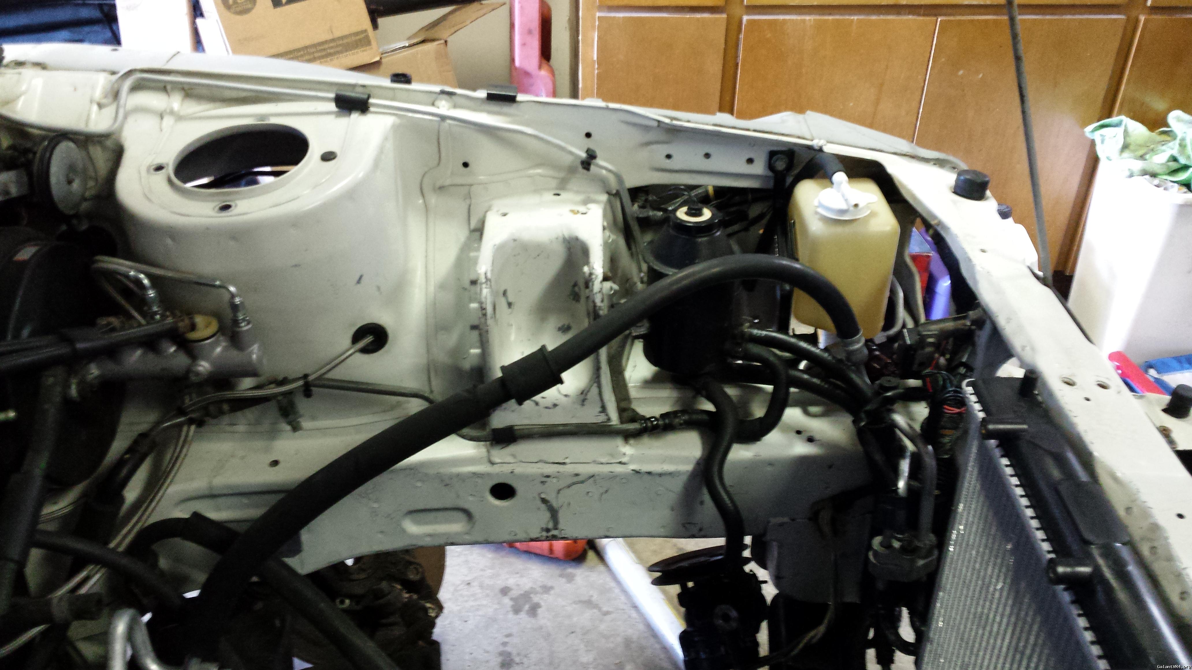

And here is where I left her last night, I'm waiting on a few pieces before I drop the motor in.

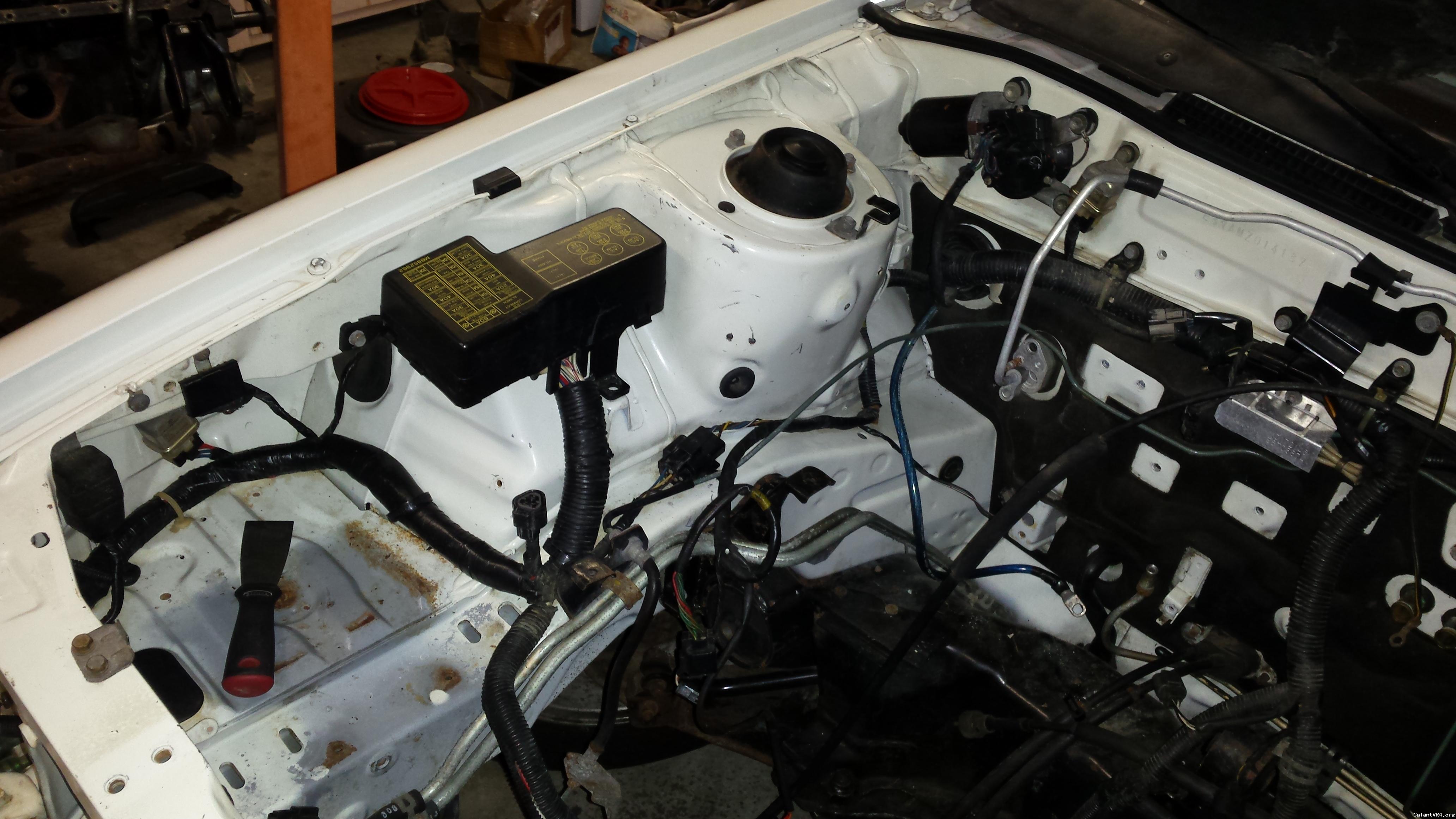

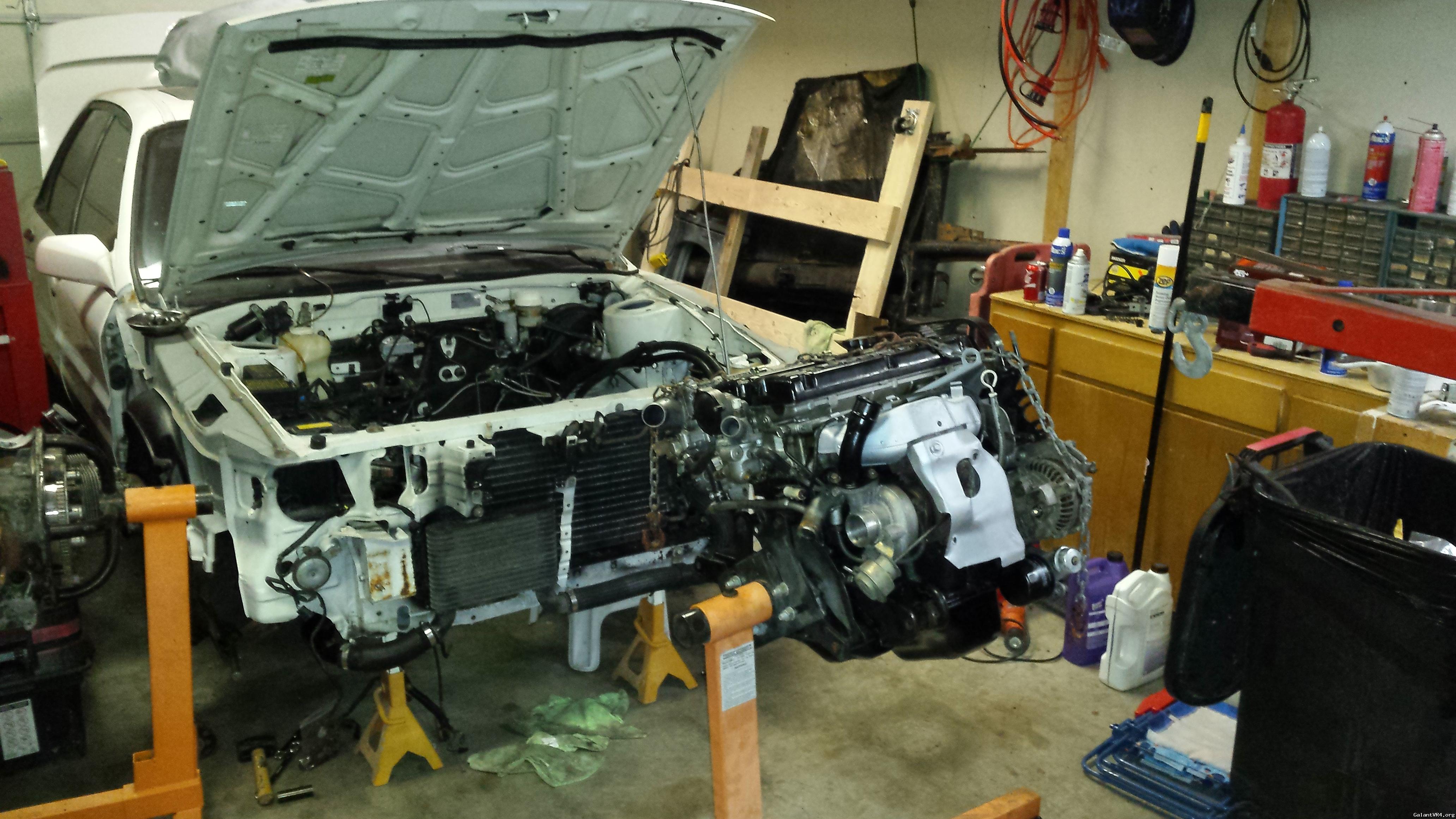

Quite a bit of work done over the last few days.

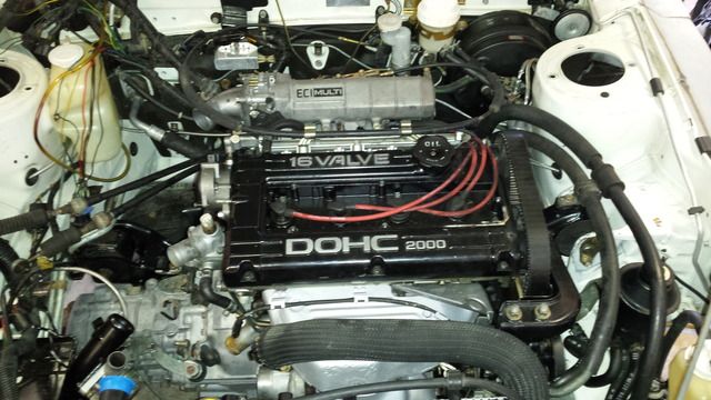

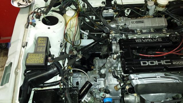

Got the motor and transmission in.

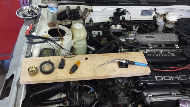

Had to fix some wiring issues.

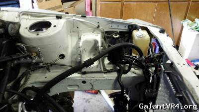

Getting things buttoned up.

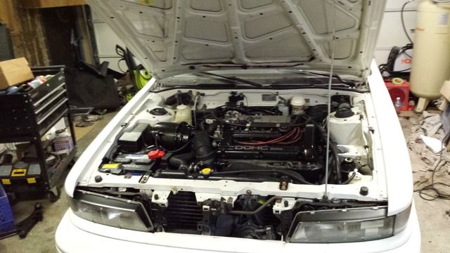

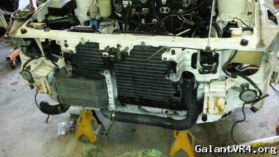

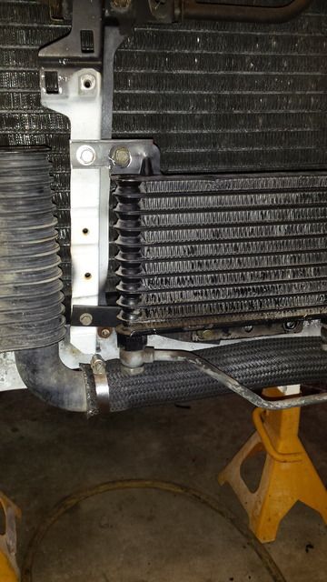

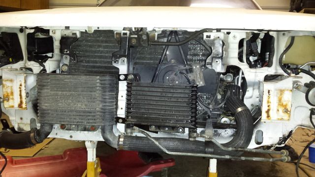

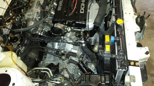

Had to make a couple little brackets to mount the '90 oil cooler.
I was finally able to find the A/C fan and put that in.

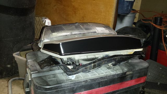

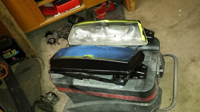

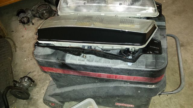

Cleaned up the headlights and redid the black on top.
And finally I am able to put the nose back together.
Hoping to get the rest of the parts in that I need to put the front suspension back together, gotta love waiting.

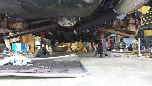

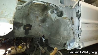

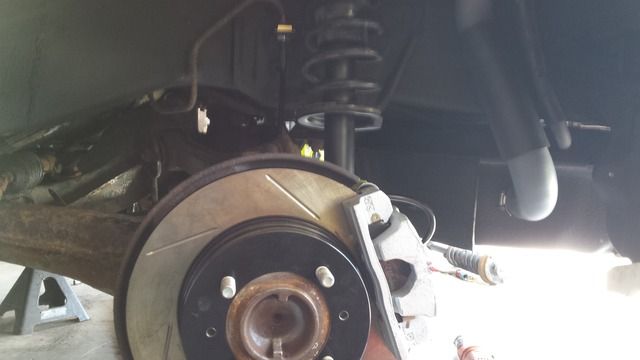

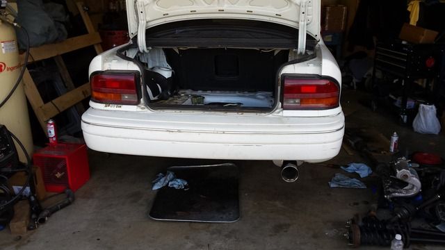

Slowly but surely been getting the car put together and of course finding other things that need replacing. Had to find a rear brake caliper because one was to far gone.

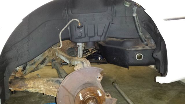

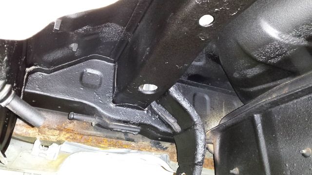

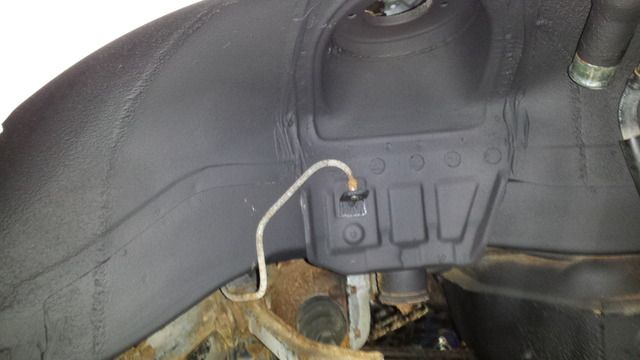

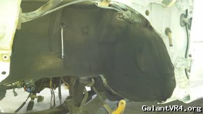

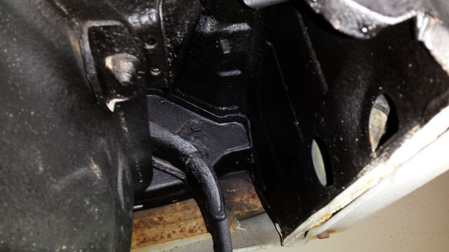

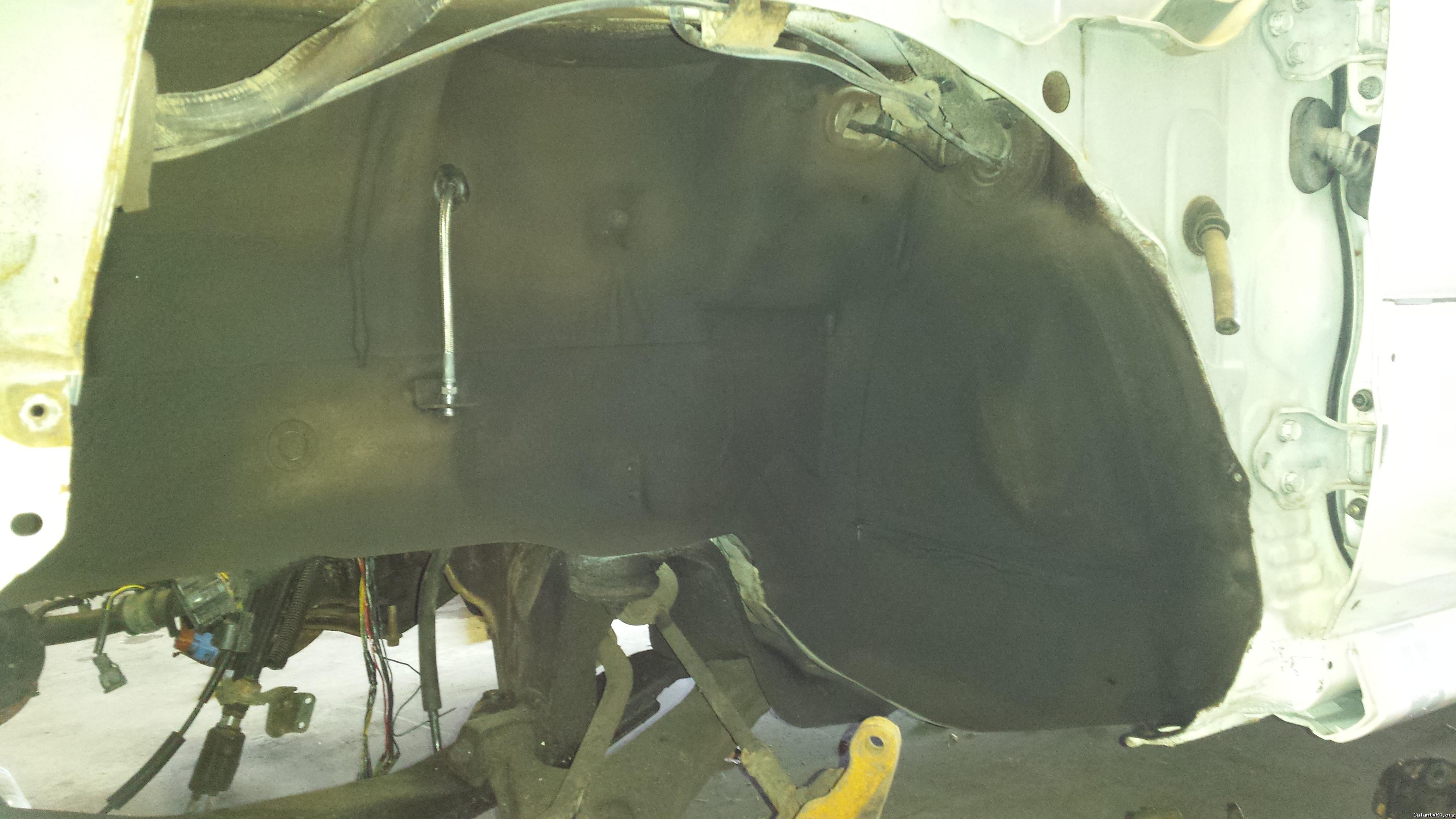

Alot of wire wheeling and cleaning later, I was able to get the rear wheel wells undercoated as well as the area just behind them, it's amazing how inadequate the factory undercoating was.
Also had to replace the fuel filler hose as it was rotted out, thanks JNZ for still having some of this stuff.

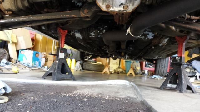

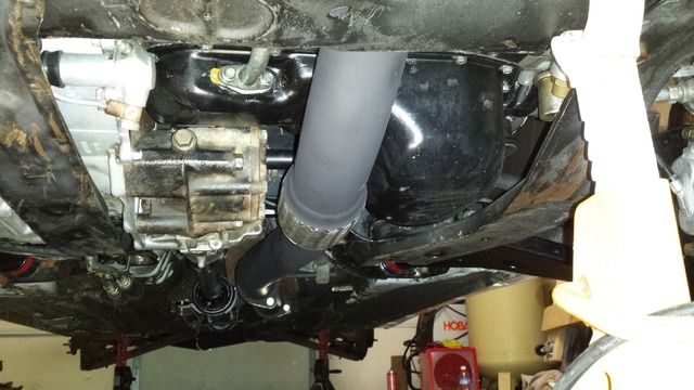

Finally I was able to get the driveline and exhaust in. Waiting on a the caliper and fuel pump hanger to get this car running.
At some point I really need to drop the rear subframe and restore it, but for now I really just need to get it on the road.

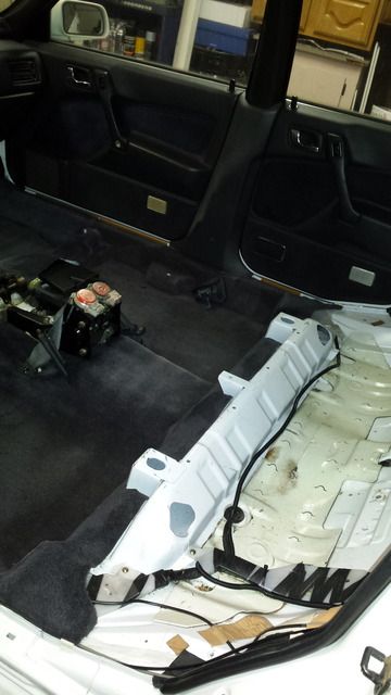

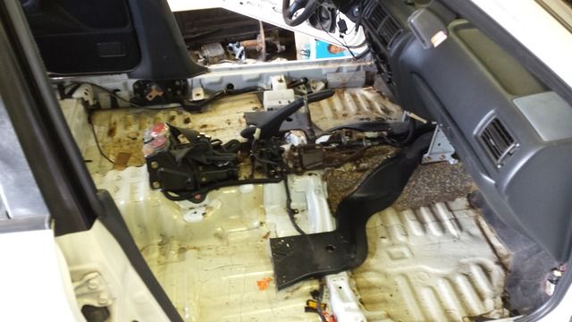

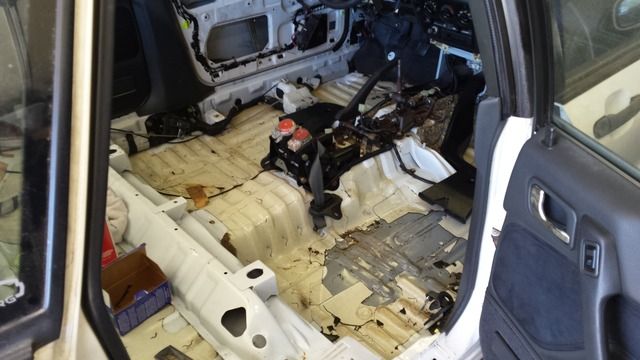

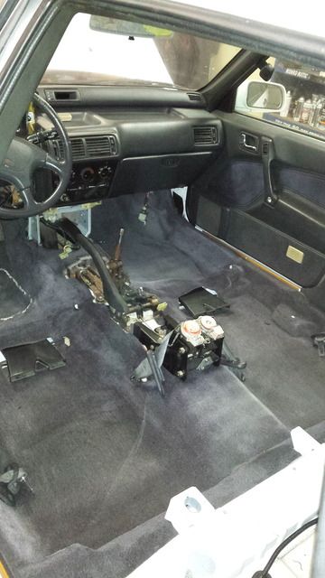

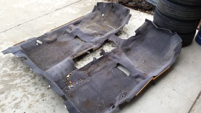

Obligatory update, figured I would tackle the interior while I wait on a few parts. It was hell of grimy in there.
That is 26 years there on that carpet!
After cleaning the floor and banging out a big dent in the passenger rear foot well area.
After a few hours of pressure washing.
Came out pretty good, I also rewired the fuel pump while I had it all apart.

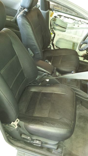

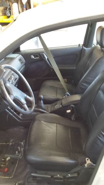

Front seats came out nice, they will need periodic conditioning as the leather is pretty stiff.

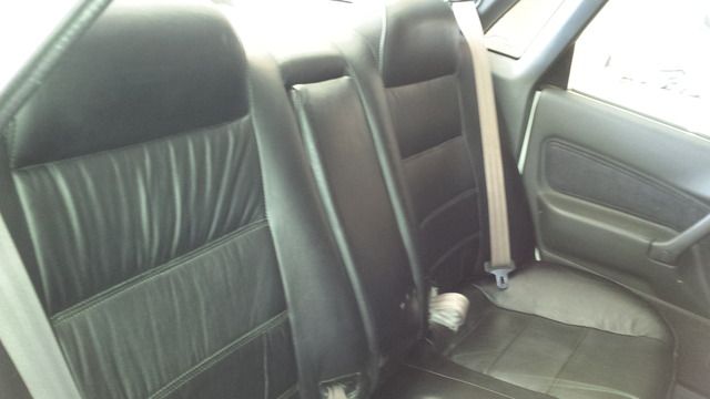

Rear seats done and in.
