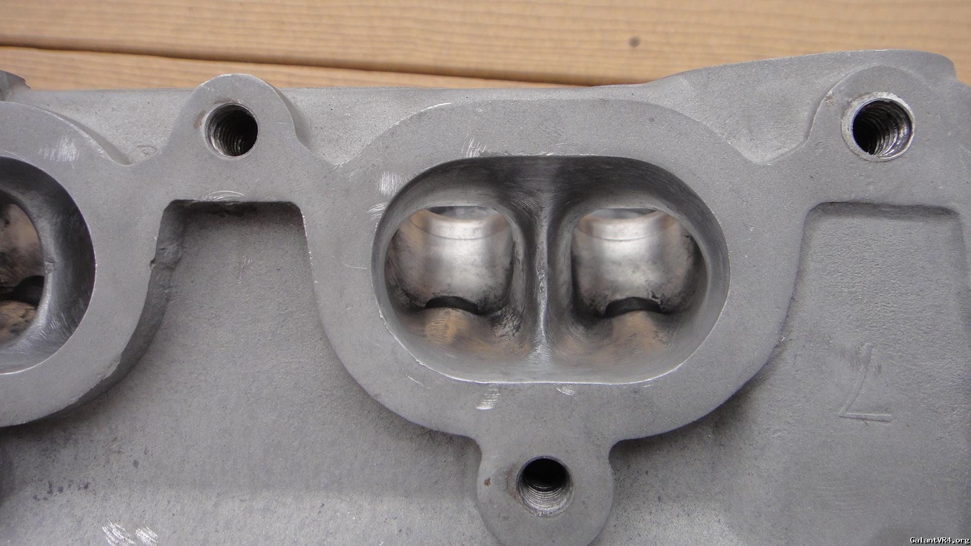

I'm trying to decide if I'm going to run a head I bought. It was a great deal and I got it for less than the parts alone would have cost. But, the exhaust ports were matched to the size of the gasket.
In some of the reading I've done it seems it's best to leave the port floor alone. But, I have found a few threads where people opened up the exhaust ports on 4g63s. Unfortunately, no before and after results were available.
Any thoughts? Should I gasket match the exhaust manifold and run the cylinder head? Or grab a spare head I have, clean the ports a bit, and have everything installed in it? Any experiences, theory, and opinions would be great.

He's talking about having to start hacking away at the port floor in order to get the port to match the existing gasket/manifold. A lot of people have stated that once you port the floor of the head side, the head is essentially junk.
Edit: Actually I just realized he is talking about exhaust side ports in which case I concur, I can't really see any negatives here. Arguably some loss of velocity which might affect spool up and bottom end but more flow equals better top end. Depends what you are looking for I guess.
Just to be clear, I am talking about if the gasket matched exhaust ports in the cylinder head will affect anything. The cylinder port floors had to have material removed to match the gasket.
I mentioned the exhaust manifold because I will need to gasket match it, so it won't block the ports in the head.
As far as mods go, there are a few. Click the link in my sig for modifications.

Having the manifold larger than the exhaust ports creates a step to prevent reversion. I would personally gasket match the exhaust manifold but not run a head that has the floor ported.
You can refer to Corky Bell's "Maximum Boost" for more on the topic of reversion.

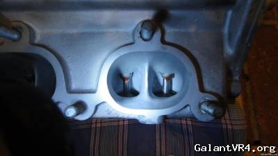

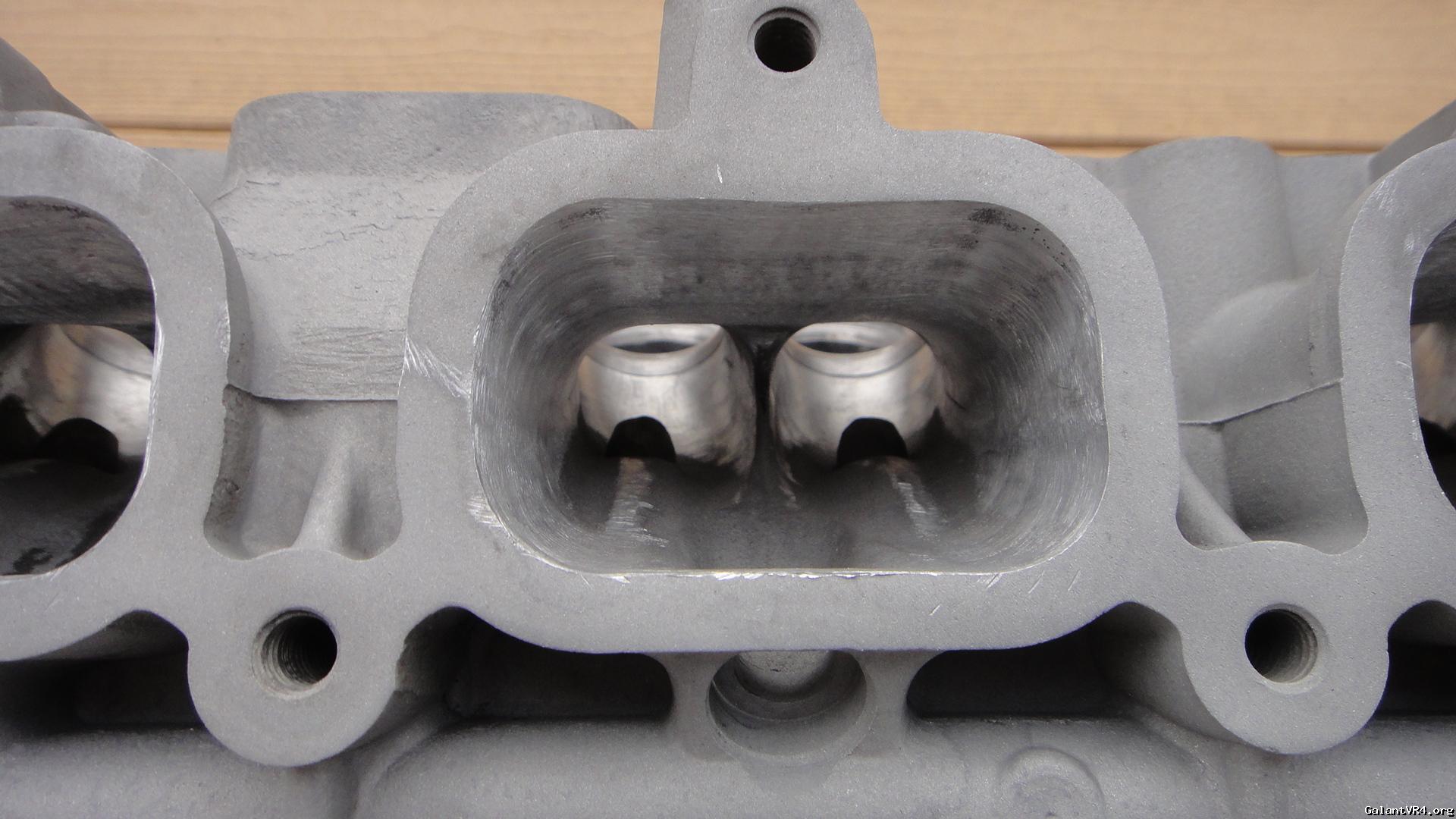

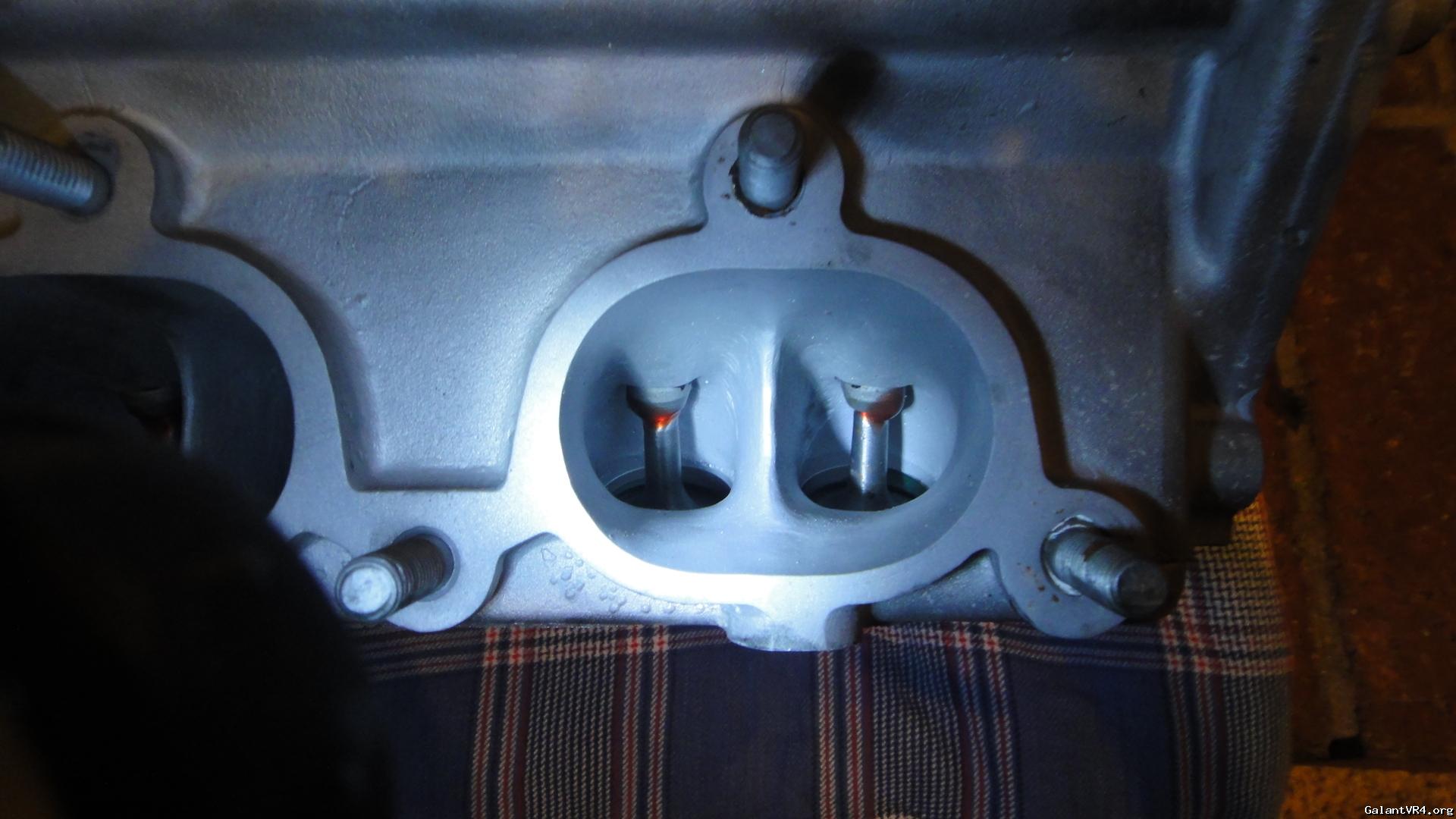

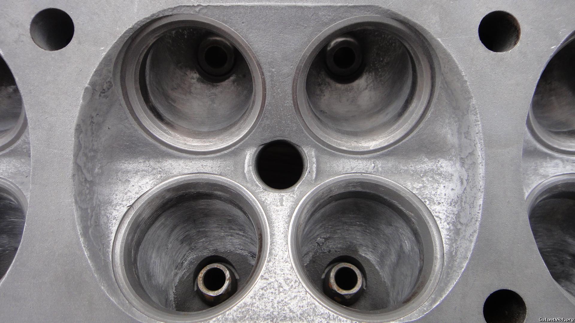

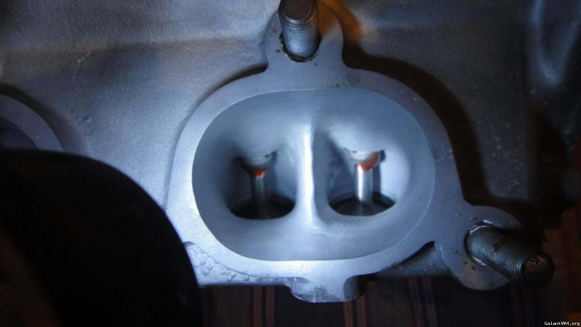

Well, I've found that gasket matching is a bad thing.

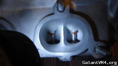

Here's the head I'm going to run now. I didn't even use a cutter on it. Just cleaned things up with some sanding cartridges. I left alone any surface that was fairly smooth and didn't have any casting goobers on it.

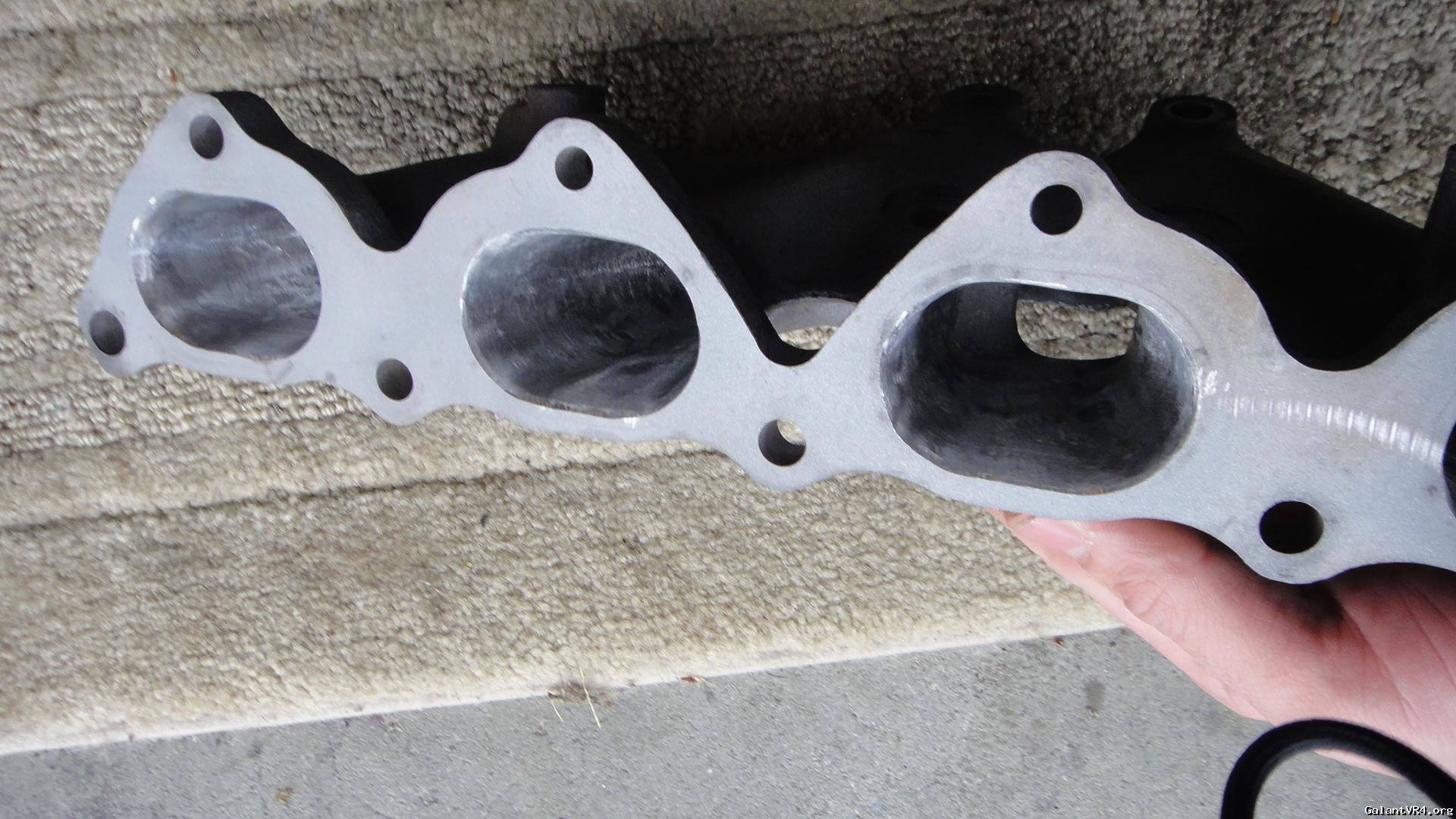

I also opened up the exhaust manifold to be about 2mm bigger than the head ports.

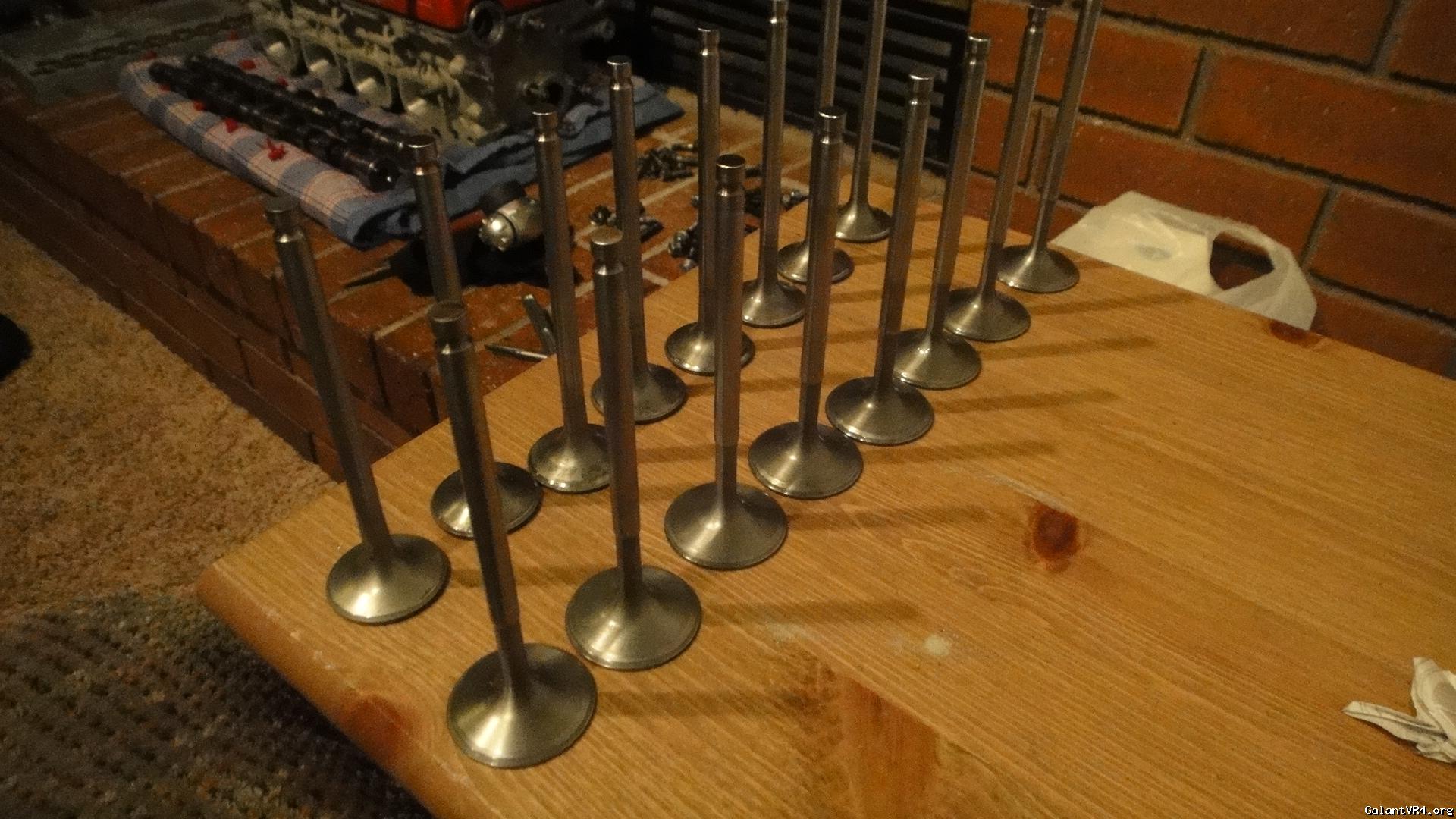

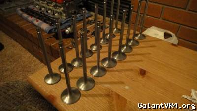

And the beautiful stainless valves from the overly ported head.

Nice work, bkatter. That's the way i know (from working in a machine shop) to do a head properly in order to help and make sure you will not hurt things. That looks good.
Good guides are cheap. Check out engnbldr on ebay. He's well known to provide good head parts. What valves are those? The intakes look to be backcut, but not the exhaust. Is this correct?

Thanks man.
I definately was trying to help without hurting anything. I think the other head would have hurt the low end a lot. Hopefully I'll get some new found efficiency without hurting my powerband at all.
I didn't know engbldr did guides. Looks like around $60 for bronze ones. Not bad at all. The valves are Ferrea and they are backcut on the intake side.
