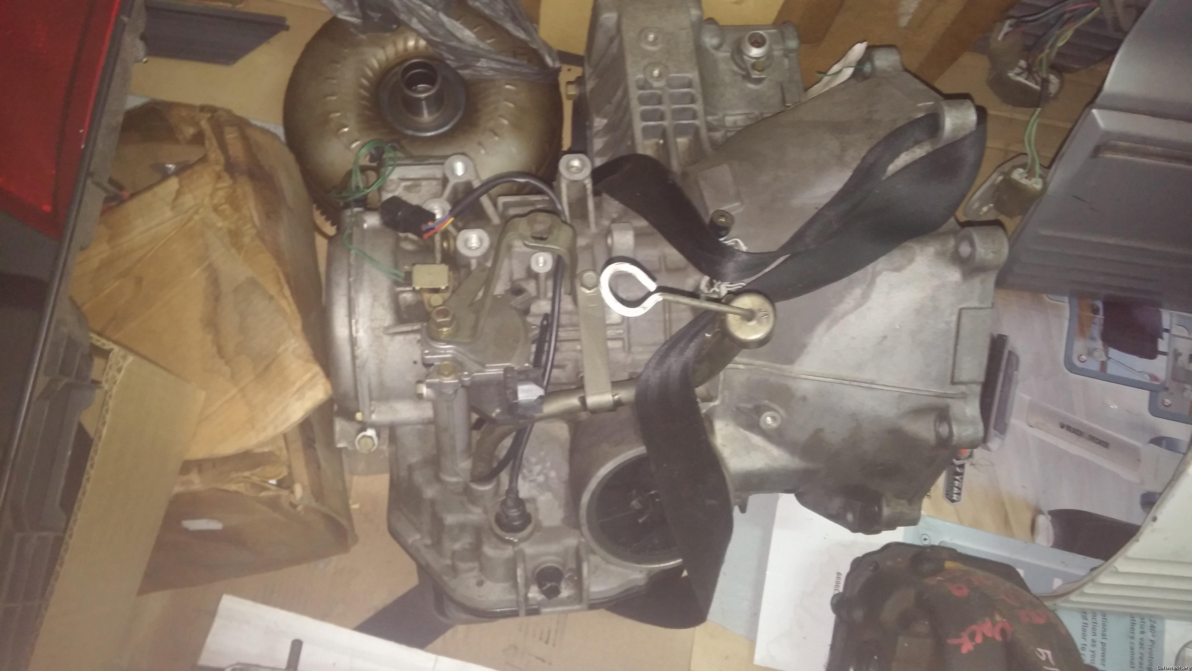

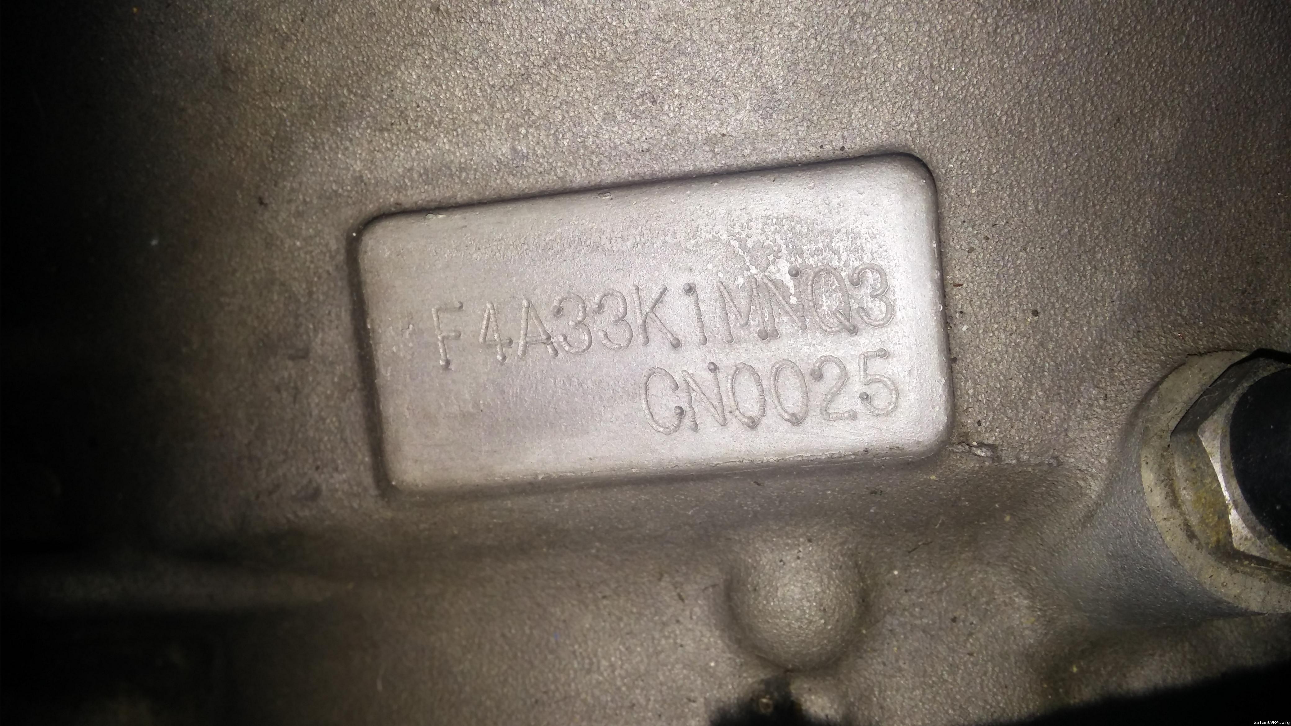

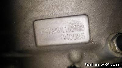

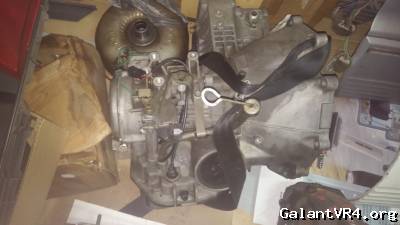

I have found a F4A33 gearbox but not sure how it will bolt up.
The starter motor is at the front of the block (where the manual clutch slave cylinder goes).
Is this normal?

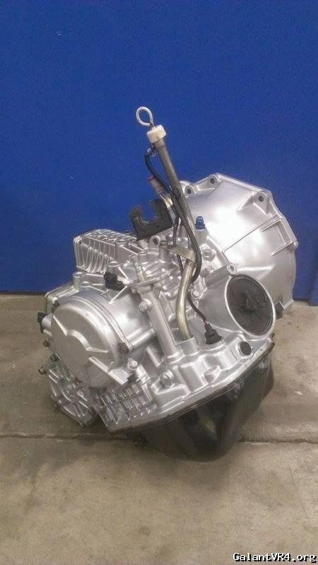

Here is what I need.

Quoting bazeng:
Is this normal?
Here is a photo.
That transmission is from a V6 - looks to be 1st gen 6G72 3.0L (magna) as the roll stop mounts are on the engine block as opposed to transmission (like the 6A12 F4A33 from HJ Galant).
