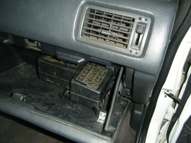

Here's mine:
I had to add about 14" to each wire. I'm going to do it again here soon. The wiring harness wraps around the radiator support and then back in. I hope to run the harness directly across the firewall under the dash to eliminate all that wire in the engine bay.

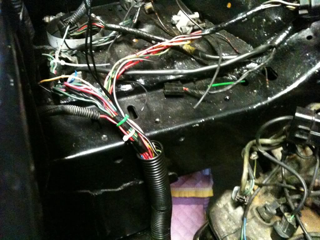

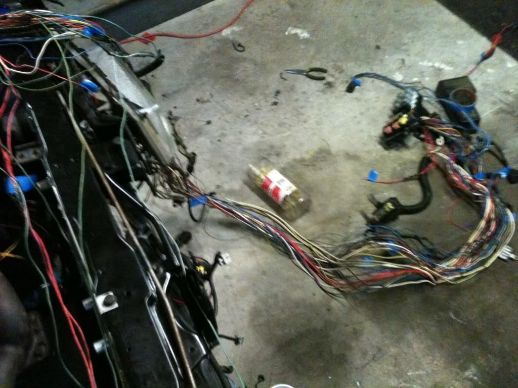

Here is the mess that was the stock harness pulled mostly out the engine bay.

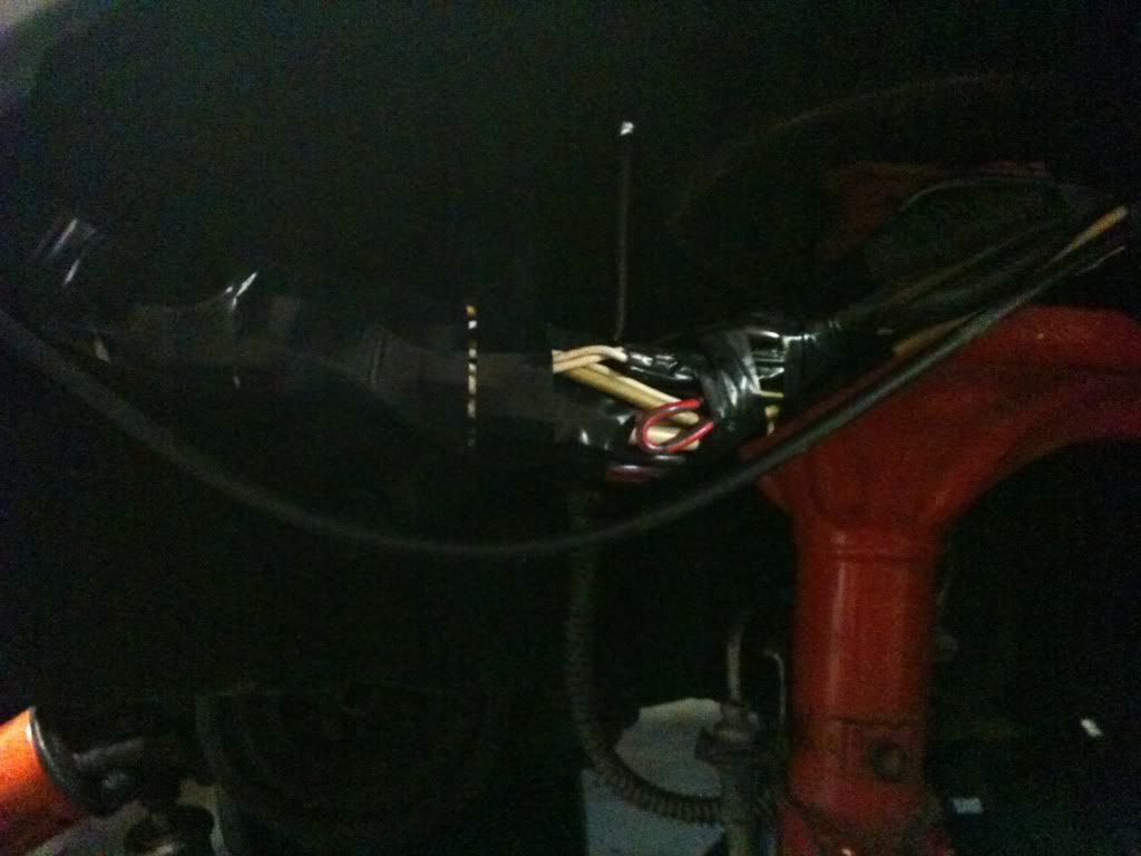

Then I place the fuse box where I wanted it and pulled the extra length of harness into the fender well, LABELED and cut the wires. I instantly regretted that choice.
Here is where it sits now.

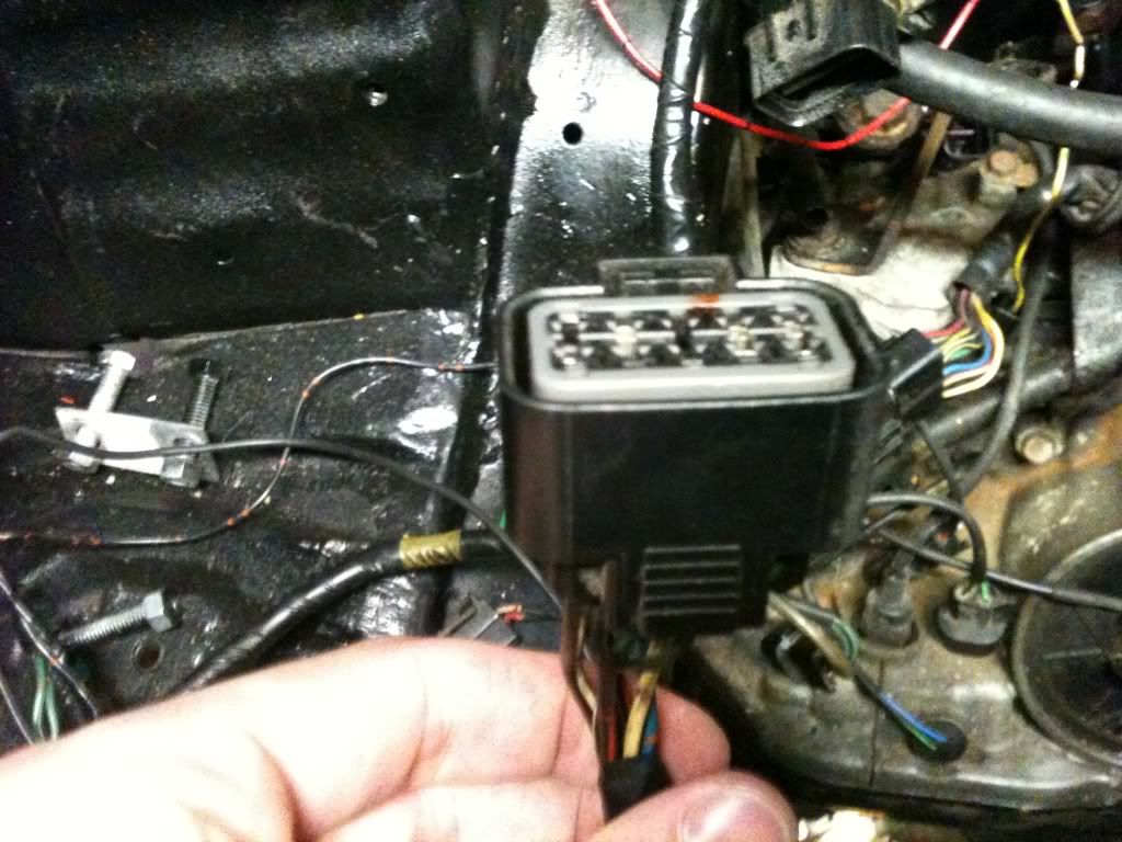

This is the plug I was talking about that has 6 wires running through it and I had to extend.

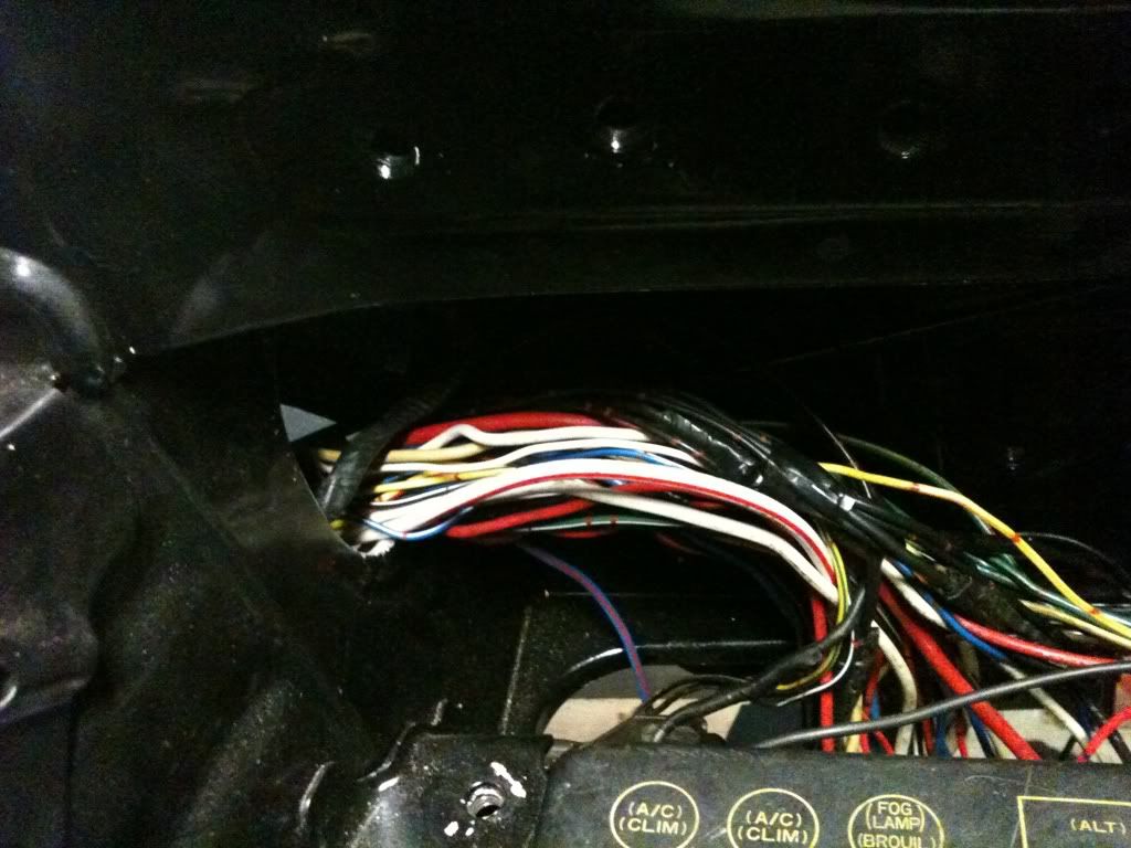

These are the wires that actually need to be run across to the pass side.

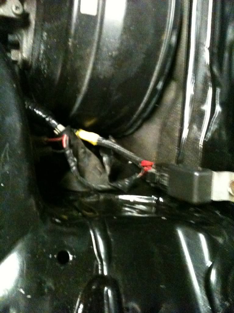

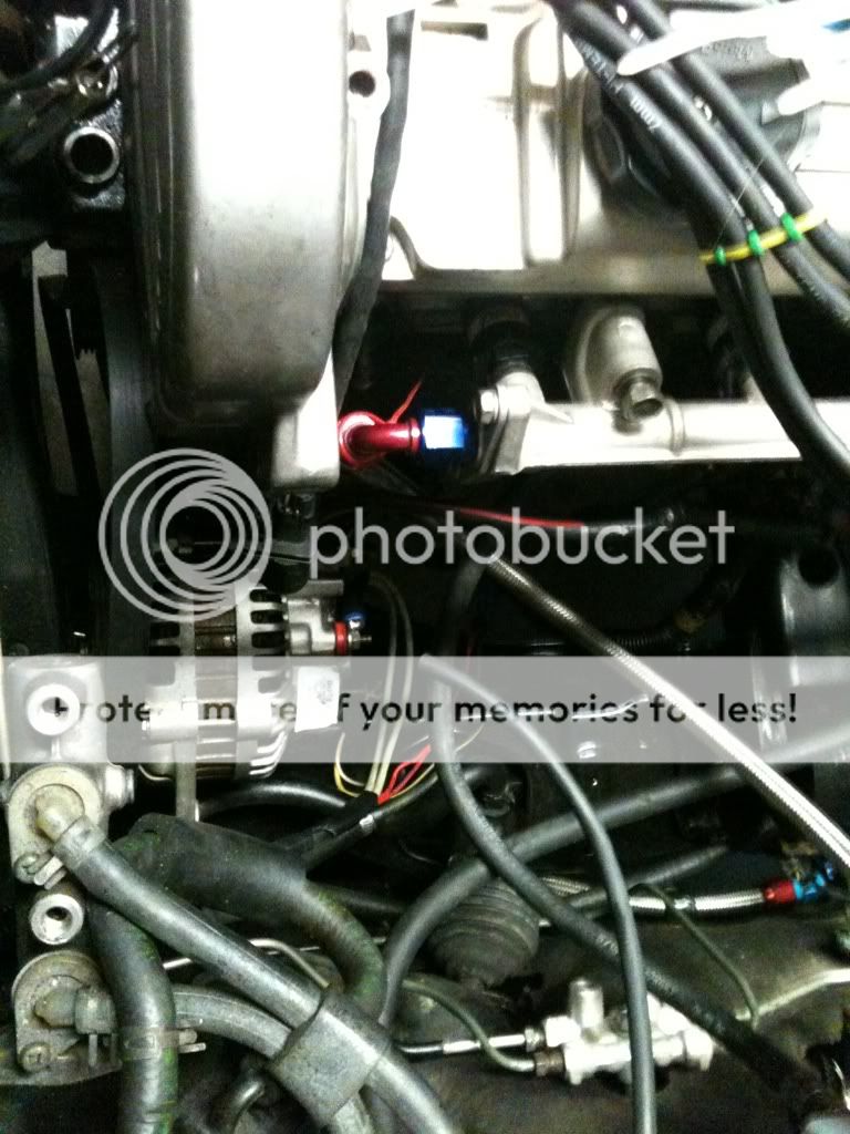

Relocated alternator
I used the grommet that is next to the brake booster to run my wires for the starter and alt.
