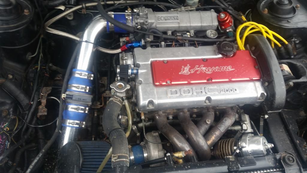

Okay, I inspected the situation. It is still leaking but not as bad. The red thing to the right side of the rail is the fpr? That is not mounted to anything. It is connected to the fuel rail by a blue colored elbow. That elbow where it connects to the rail is what is leaking. If anyone has any idea what elbow brand/part that is I'd like to order a new one and see if that solves the problem. If that doesn't work I will remove the rail and order a new setup. I will then weld the old rail to that elbow and have a spare rail haha. I will have to do some research on the injectors and rail. It was not very apparent on how to remove those injectors. I'm guessing they are pretty secured in that rail. I want to use my old injectors if i do get a new rail.
3,473
First, don't operate the car at all whatsoever until this is fixed. If that catches on fire, you'll be fucked. If you want to test for leaks, use the fuel pump activation terminal to activate the pump with the car off. The test terminal is located on the firewall near the back of the intake manifold. It looks like this:
Second, whoever put that together is a moron. You have an Aeromotive A1000 adjustable fuel pressure regulator (AFPR), same as I have on my car. The regulator needs to be mounted with a bracket somewhere in the engine bay. Preferably, away from major heat sources. The elbow that connects it to the rail isn't meant to support the weight of the AFPR. Since whoever put that together thought it was, you're left with a leaky connection.
What you need to do is relocate the AFPR properly. Make a bracket and move it to the firewall or something similar. Then, buy some hose to connect the regulator to the rail. If you need help putting together a parts list, let us know. To give you an idea of what I'm talking about, here are pictures of where I mounted the regulators on my last two VR4s:

I need to see more pictures of the rail. Typically, theres a bolt-in fitting that gets inserted into the rail where the stock FPR would have been. Is this what you have?

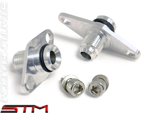

That set up makes me gringe. I have a stock fuel rail you can have if you cover shipping (about 20 bucks). Otherwise any DOHC turbo or not will work. After that I recommend using the fuel rail adapters with a new line.
These guys.
Where to buy
Then you'll need a 90* -6 fitting some -6 fuel line and a couple other fittings. I'm not sure what size threads that regulator uses, perhaps someone can finish what I listed.

Yours looks like it is a stock rail. Apparently someone just tapped the ends for the fittings they installed. Prove it offered you a replacement and info on the adapters. If you don't have experience with this type of stuff, those adapters are a start.

The new line I'm referring to is about a 2ft chunk of -6 fuel line. Google AN line building. Start with a little video demo of how to make lines so your more familiar with what you need to do.
