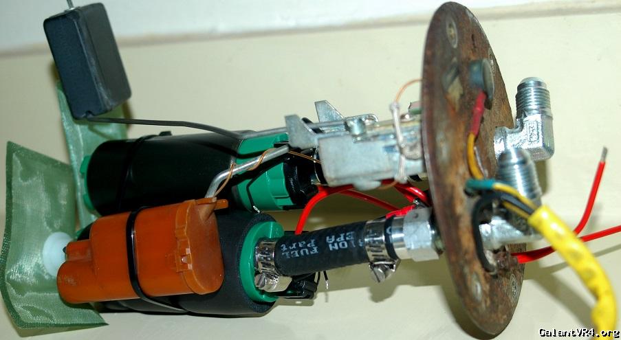

You will be more than happy with a in-tank mounted 044.
I have ran mine like that for many years. Removed the check valve and mounted a straight piece in place. Starts right up on every crank.
Running 47 PSI base pressure on my RC 1000's with max boost of 2 bar (30 PSI). Never once have I seen a rising AFR due to the pump not being able to keep up.
Pump sees gasoline, E85 and mixtures inbetween in cycles many times per year.
I went through two Walbro pumps before switching to the 044. Never looked back.

The AEM 320 pump would be the best for a single on gasoline. Compact and easy bolton. I can tell you right now it works great at 90psi line pressure. /ubbthreads/images/graemlins/tongue.gif I have two in #476. I have also used the Bosch 044 in my old car and that worked great too.

diambo, any issues with a wacky fuel gauge? I had 2 255HP's in #108 for a little while and while driving on the highway for extended periods of time, the gauge would start to drop because I assume the pumps were sucking the baffled section in the tank down faster than the windows/pipes that feed the baffled section could refill it.
diambo4life
Jul 7, 2013
321
Edmond, Oklahoma
Yes, I have fuel gauge issues but I suspected it was going to happen since squeezing that stuff into the tank is extremely tricky. My Galant almost rarely has less than 1/2 a tank of E85 in it anyway so I don't worry too much. The pump(s) work phenomenal. From my experiments, don't go over 95psi. I think there's a bypass set there. But again, with 43psi base, that's 52psi boost. /ubbthreads/images/graemlins/rofl.gif /ubbthreads/images/graemlins/jawdrop.gif
