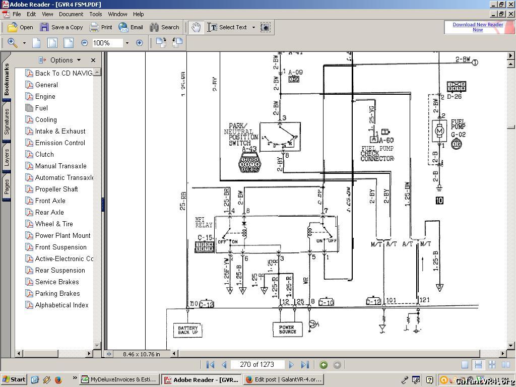

Pin seven is power, not ground! Pin six is wired directly to ground point #3 and pin seven gets POWER from the starter relay when you crank the engine. After that, pin 108 from the ECU takes over supplying the 12 volts to pin seven of the MPI relay.
Pin six is always grounded, so whenever pin seven sees power, it will close the circuit between pin #4 (power from sub fusible link #8), and pin #1 (fuel pump +12V supply & fuel pump check connector), allowing power to flow from fusible link #8, through pin#4 across the relay out pin #1 and to the fuel pump.
So what you should see is positive voltage to pin seven from the starter relay during cranking. After that, pin 108 from the ECU will provide power to pin seven of the MPI relay. In the event that the ECU fails to see the signal from the camshaft angle sensor, the ECU should shut down after about five seconds, and stop providing power to pin 7 of the MPI relay. The fuel pump should stop at this point.

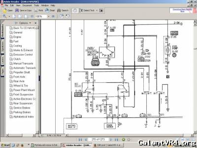

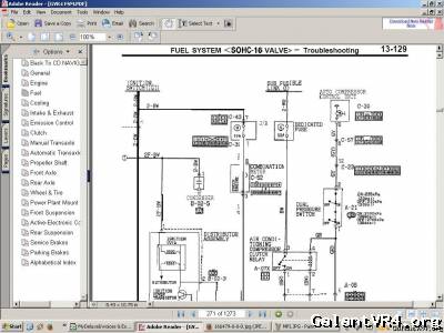

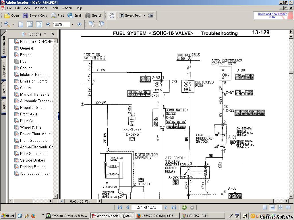

And nevermind the part about pin 108, because the FSM is different than it was last time I looked at it. Pin #8 from the ECU now triggers the pump section of the MPI relay, and it does so by providing ground to the MPI pin #5. Power then comes in pin #7 from the ignition switch, and exits pin #1 on it's way to the pump.
Hopefully this image will keep the lines from moving around on the page LOL.
Here's the continuation of the BW wire from pin #7 where it comes from IG1 (ignition 1)...
