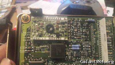

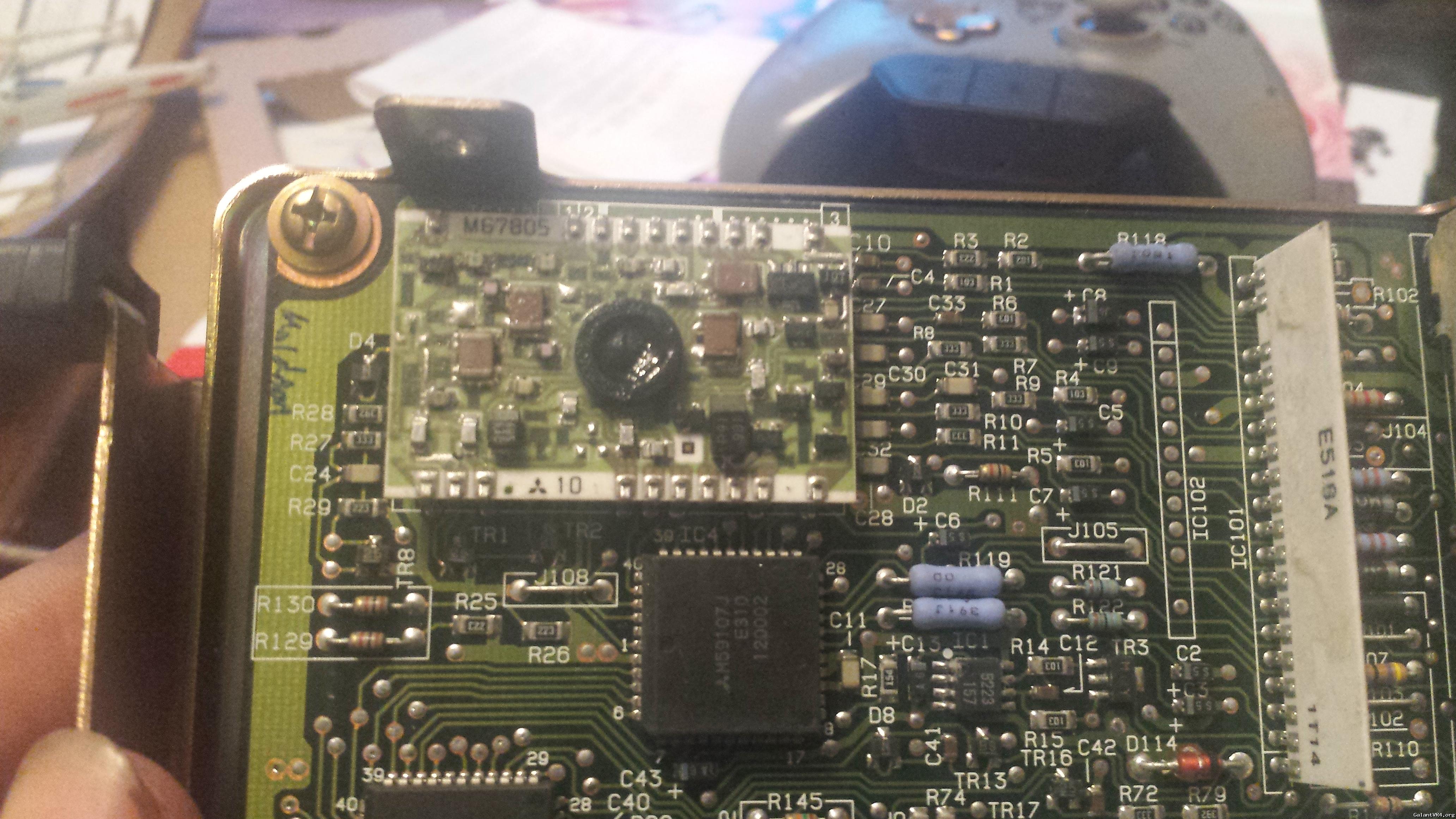

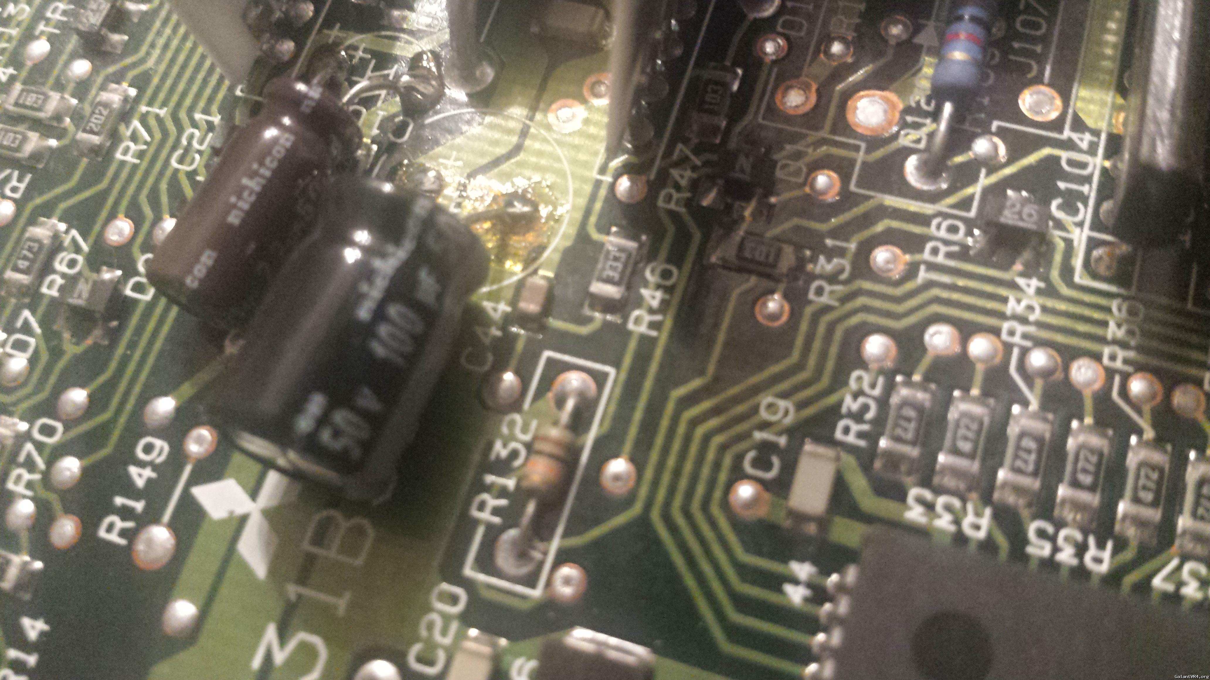

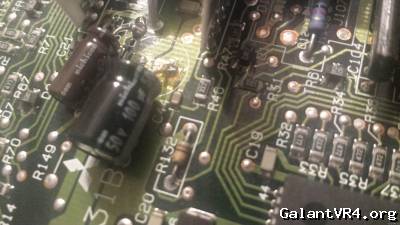

So driving yesterday on the highway my car suddenly "dies"((rpm dropped to 0 and then came back up)). At the same time I heard a clicking under the passanger side dash. I believe it's the MFI/MPI but I was wondering, what if my fuel pump is going out or filter is clogged could it cause these issues and the mfi/mpi to click?
3,473
Classic sign of the ECU taking a sh*t. Pull the ECU and open the case. Look for burned drivers, and leaking capacitors. Look at this thread, as well as the ones linked in the very last post: click

Ok put it back in and now it won't start at all. I have to assume it's a loose wire since all of this started after I pulled it the first time. But I feel so overwhelmed with all the wires and I don't know where to start.

I went through this same experience and it was my ECU. When you were messing around with the ecu I bet it moved something on the board. A lightly cracked solder joint or something could cause this. You have to dig through a wiring diagram to find out if the ECU is providing ground to the MPI relay. I forget which pin it is but this is what led me to replacing the ECU.
