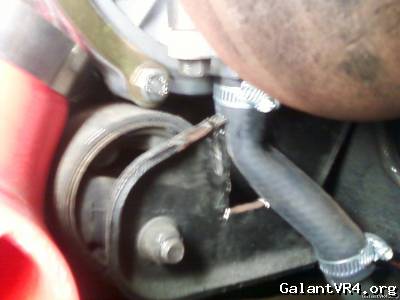

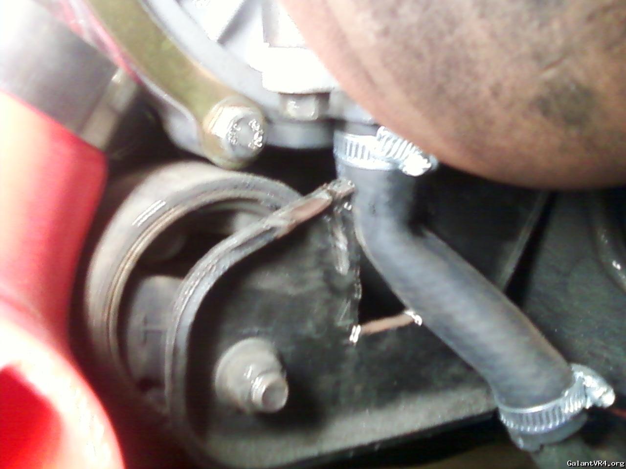

I had to cut mine for my 60-1. From what I understand you can cut an entire side off and it would still work, not that it's recommended. I just notched mine enough for my oil return line. Here's the rough draft...
* I have since fixed it so it doesn't hit the line, and will be running a -10 line to the oil pan...

I had to cut mine more than that but you can also just take the oil drain flange off and cut out the threads with a carbide burr then take the -10 fitting and chop off the threads and angle sand it and weld it to the flange about 30 to 40 degrees to the side and about 10 degrees back.... might save you from hacking up the mount. All depends on which turbo, which manifold and wear and tear on the other mounts over the years but I have modified flanges for some locals so they didn't have to cut at the mount on disums.

I've had to do the EXACT same thing with my PT-60-1
Quoting 524of1000:

That being said, mine is also notched to accept my (bullseye?) 60-1 (dsm-style turbine housing), but mine also has a section of 3/16" steel plate welded in around the notch for continuation of support (peace of mind).
sry no pics to show /ubbthreads/images/graemlins/frown.gif

I had to notch mine w/my Holset HX35 w/Bullseye housing to clear the -an SS oil drain line. No problems at all in 5 years.
I actually cut the notch and 'folded' [hammered] the flap down to clear the oil line.
And had to rotate the Holset just a alittle.
You should be fine 'notching' it...
