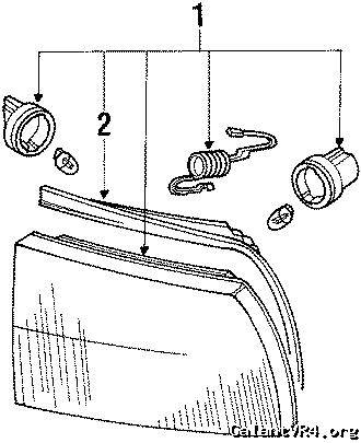

the whole assembly is MB529058
here you can see how the second socket gets powered by the main light

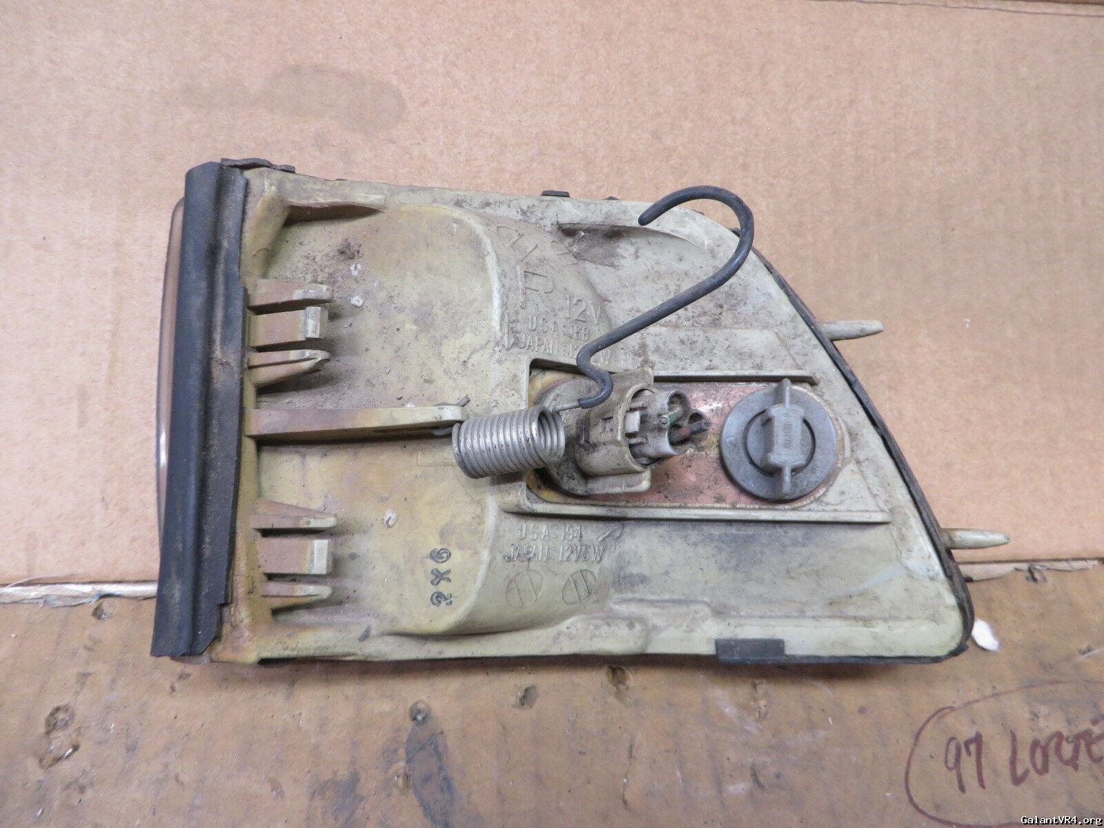

Andrew,
In your actual picture isn't the amber plug just that, a plug. It isn't an receptacle with wire leads, correct?
That's what I was wondering what it is used for.
Since I'm replacing and messing with turn signals, which the LEDs I just got for them need a resistor for the turn signal to slow down, I was going to run a lead up to the corner amber to light that one up. I just need to find a few bulb holders with leads off of them that are a little longer than the ones in your picture. /ubbthreads/images/graemlins/smile.gif

what thom's saying... the holder has contacts on it, and it pulls power from the other light bulb. It doesn't have it's own individual leads.
