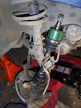

^ you shouldn't have to take the axle nut off at all (again on AWD) if you're keeping the axle. Go to VFAQ, drivetrain, 1g clutch and it's probably halfway through. The axle spindle stays on the hub, the hub pivots out when the strut is unbolted, and you have enough wiggle room (barely!) to work the axle out of the trans and fully into the well. wait, here's the pic.

The only diference with the Fwd is the left hand side, instead of the drive-shaft being in two short parts it's just one long one from the hub to the trans.
