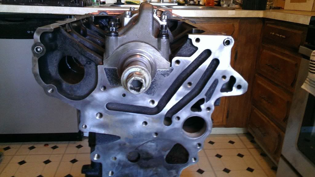

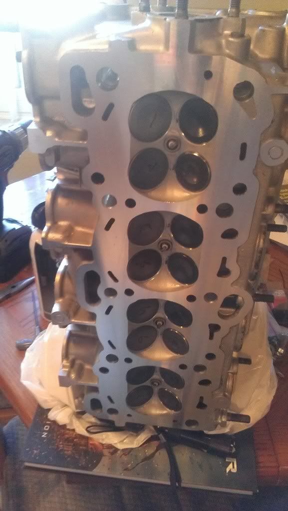

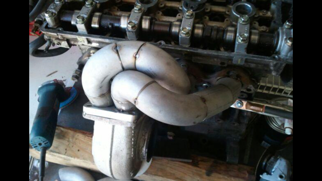

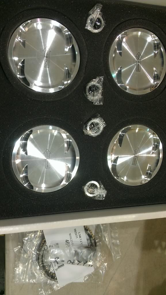

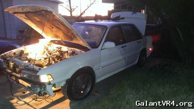

Small update, Unk has had her rotating assembly returned to me. Assembly, of the Assembly will begin soon, but I am in the process of retuning my beloved 91 Black cherry Talon to stock, so i can sell her to make driveway space for UNK. I am attempting to sell all of my DSM's and focus soley on the UNK GVR4.
As far as The GVR4 goes, I have been having parts shipped to me from all over the country. And i mean a lot of parts. I think this is why she went through so many owners, for so many years. Honestly I didnt realize how much of a basketcase she was until i saw how far my bank account shrank /ubbthreads/images/graemlins/rofl.gif95% of the parts have been acquired for her though and are slowly going on. Here are some pics /ubbthreads/images/graemlins/smile.gif

Good choice on engine/turbo setup. I wish I would have gone with a higher CR when I built my engine since I almost exclusively run on E85.

Thanks, Im pretty excited about it myself. We are over a mile high here, so i figure i can run a little higher static CR. I would like to stay away from E85 if possible (V3 for tuning), but i may have no choice with that CR, we shall see! Goal is reliable 11's at this altitude, and going fast, with class. And yes, it will be expensive /ubbthreads/images/graemlins/rofl.gif

That head looks like it was machined quite a bit, at least from these pictures it does. Also, did you have the block line honed for those arp mains?
snailspool
Dec 13, 2012
123
Albuquerque, NM
That head has been machined a decent amount. It is ported, and so i have hung onto it. Block was line honed.

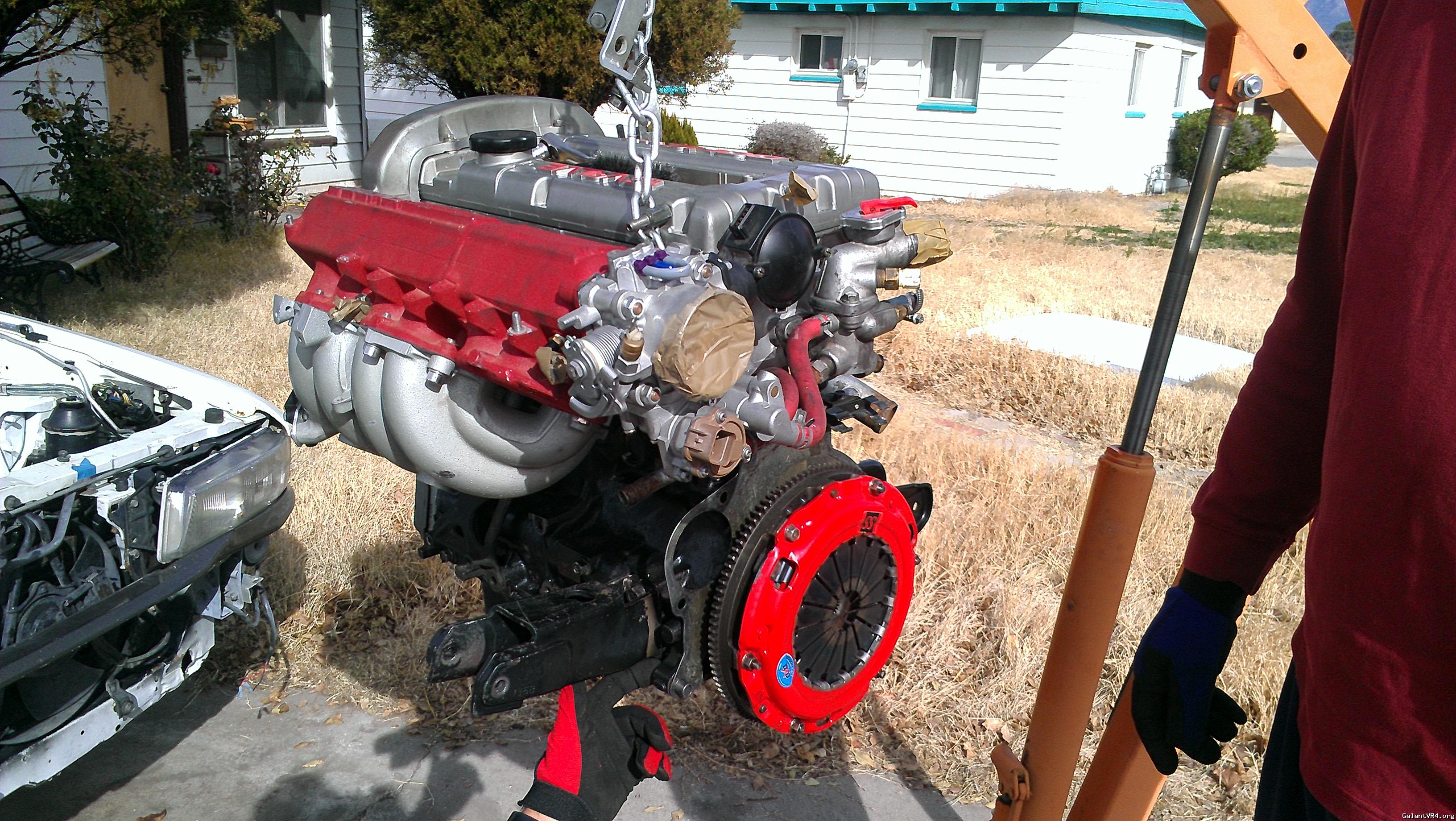

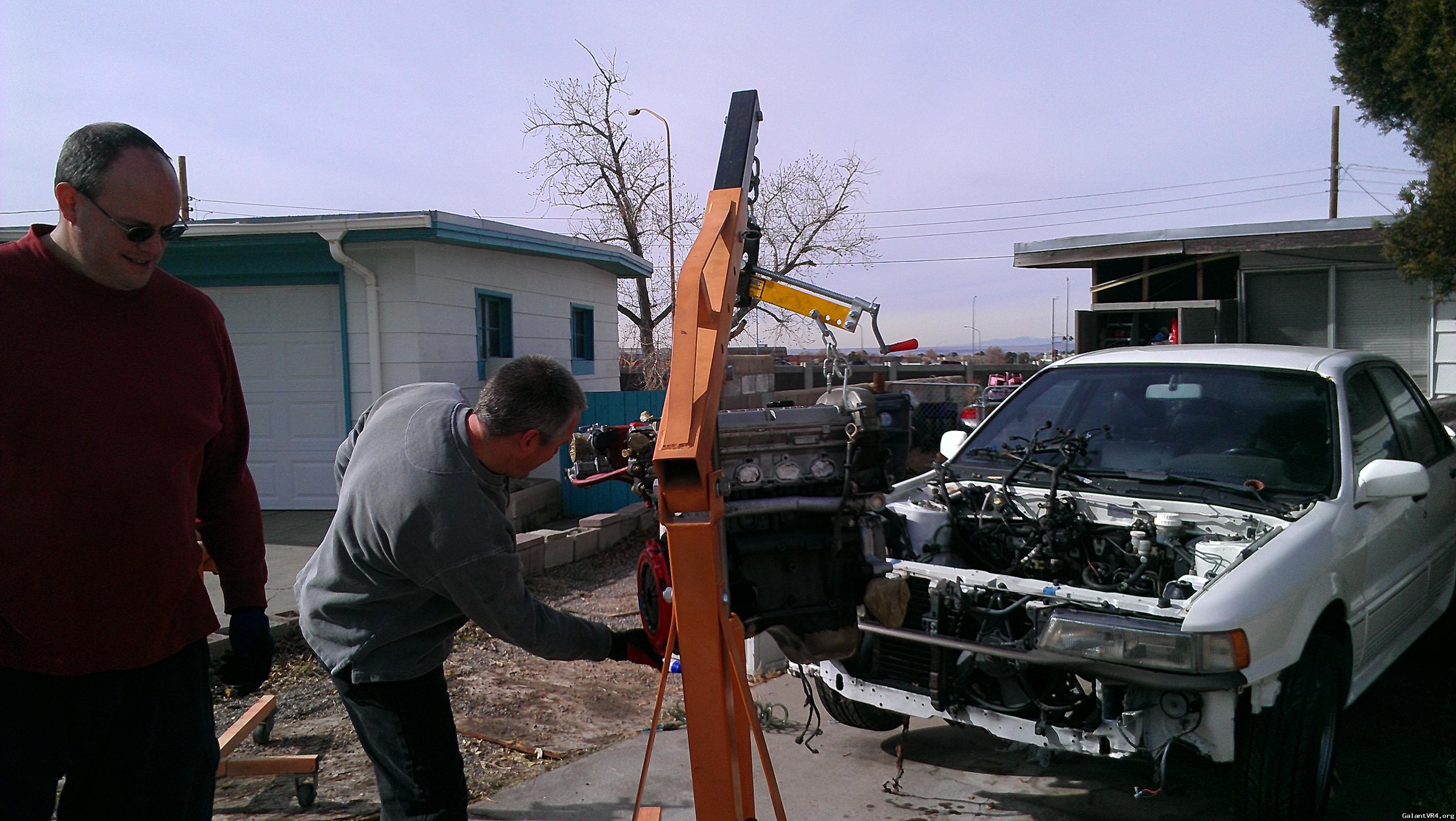

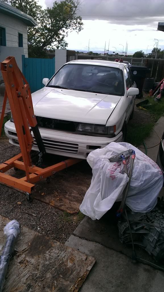

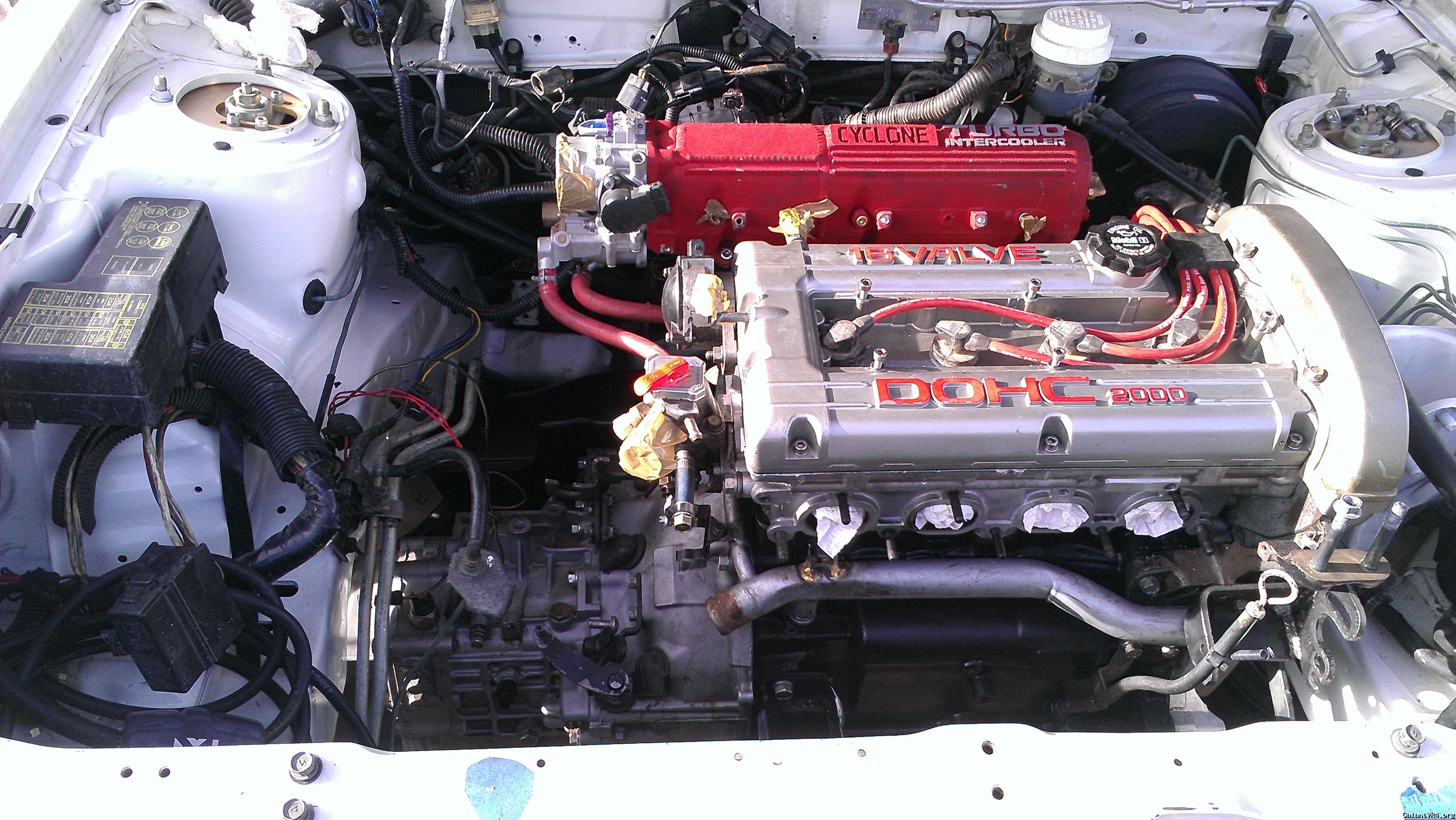

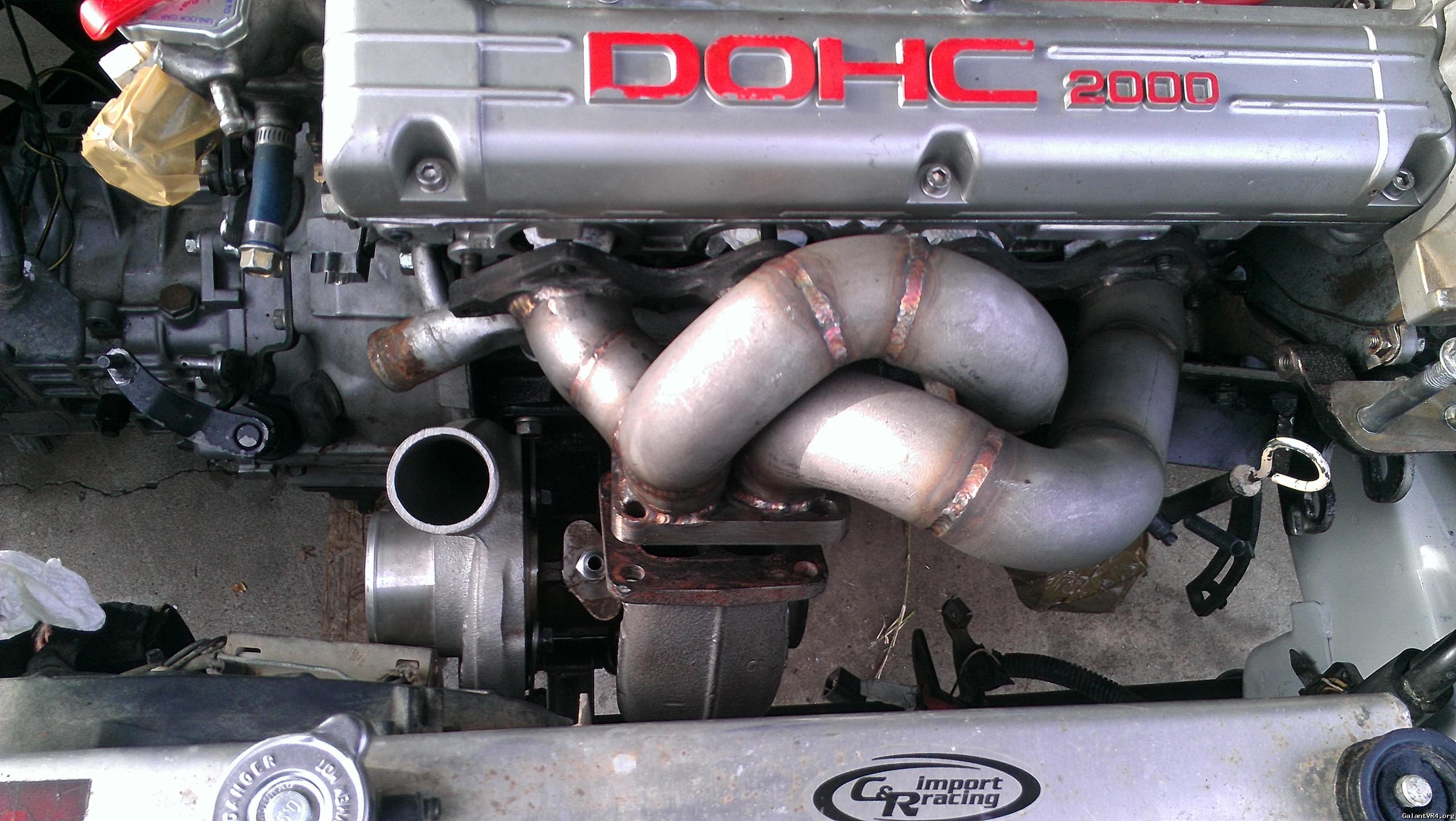

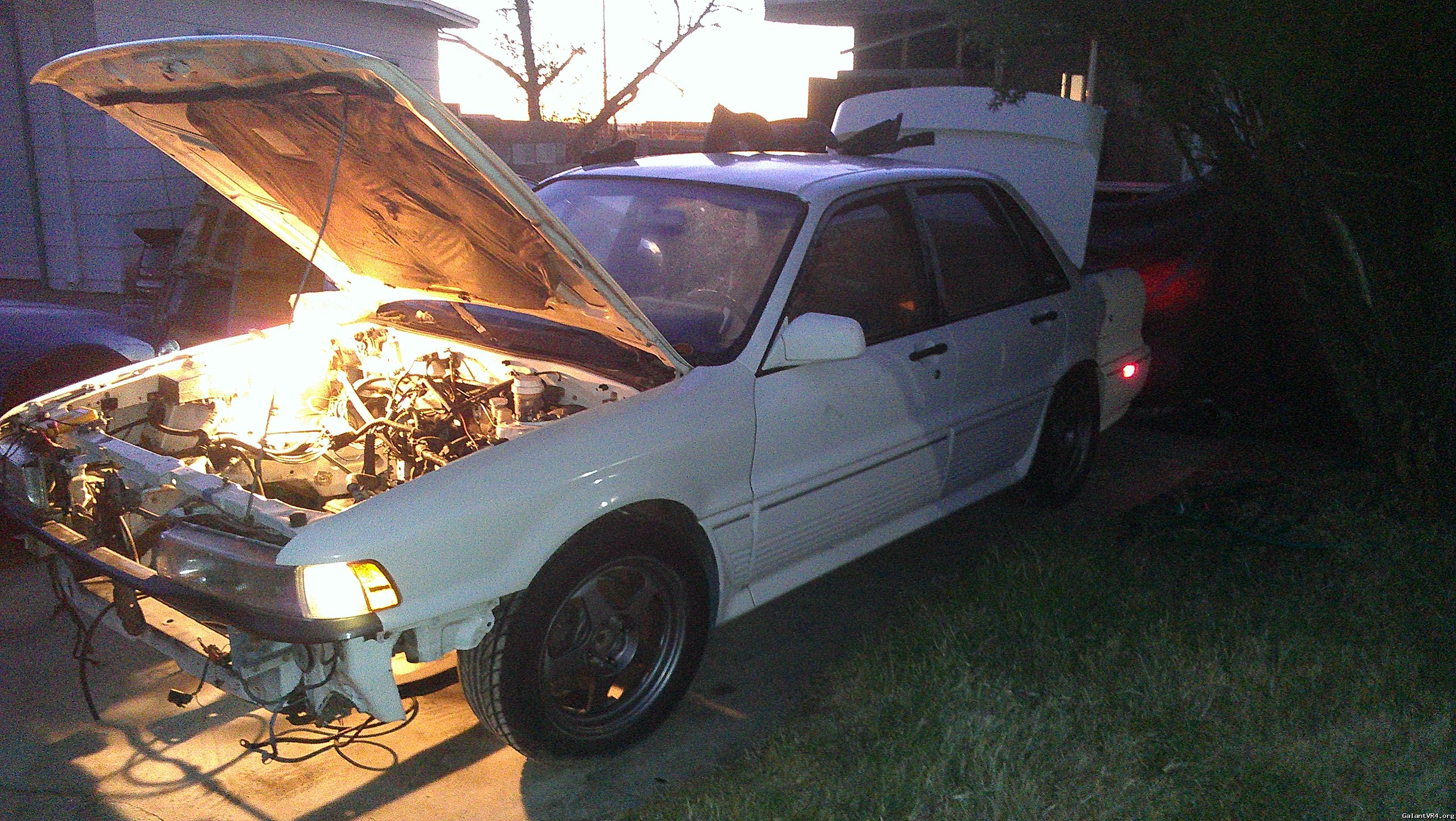

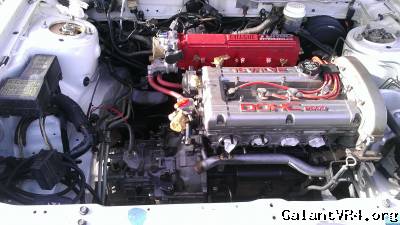

Relocated the battery and got the electrical working (including the stereo!)
Waiting for the drop with my two friends psiaddict and Ktmrider Thanks for the help!
In its new home!

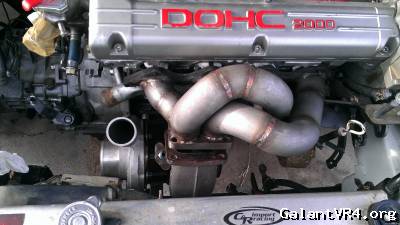

Turbo mock up

Looks great! any info on the cyclone/intake manifold? or is that a secret? /ubbthreads/images/graemlins/devil.gif
snailspool
Dec 13, 2012
123
Albuquerque, NM
Nah, no secret. Extra manifold plenum welded on to create a larger displacement plenum. Since the engine is a 2.3 and not a 2.0, as the cyclone was manufactured for, I felt it was helpful. Worked great on the old talon.
