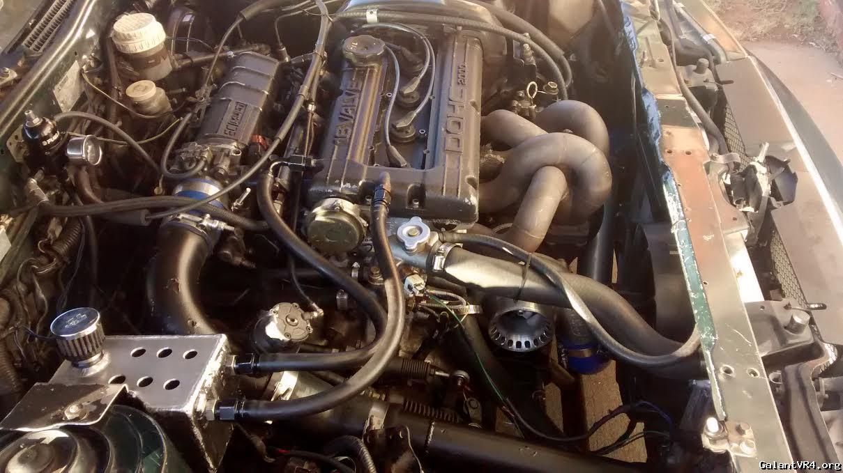

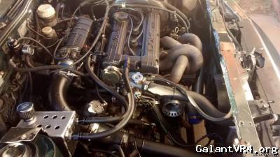

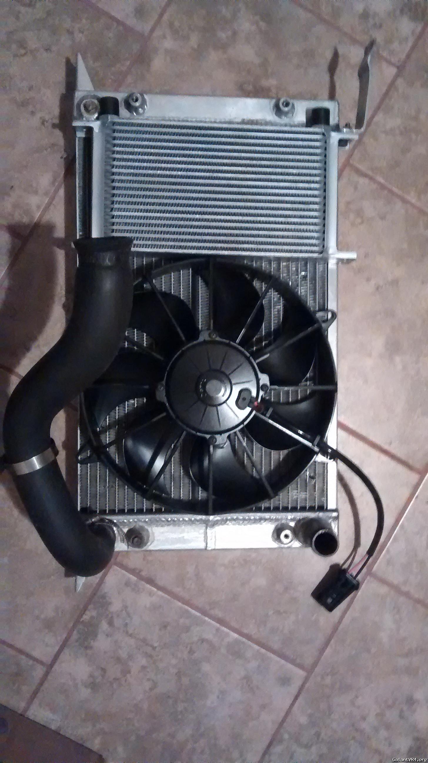

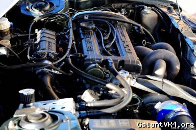

So, I got tired running useless low flow slim line fans and I think I have found a good fan that can handle the VR4's cooling requirements and still fit the AFCO radiator. This fan can only be setup as a puller but should leave room for your typical T3 or T4 bottom mounted turbo. It's the SPAL 30102800 11* HO fan.
If you shop around, you can find it cheaper. This sits perfectly on the AFCO radiator's core. I suggest fabricating mounts for it. It's beefy as hell, makes my old slimline look like a toy. It's heav(ier) and relatively thick. I already had the fan mounted on the radiator (engine was out) and doing quick math and crossing my fingers, the engine dropped right in and I had maybe 1/2 an inch to spare. Closest distance being of the fan motor to the compressor housing of my PTE turbo. I apologize for the low quality photo from the cell...but you get the idea. The setup is also staggered so I don't have to worry about too much about heat from the header.

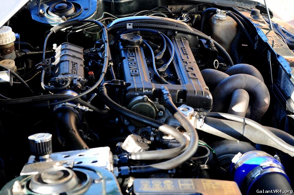

quick question, whats up with your fuel set up, are you running the rail backwards or is the FPR ran between the filter and the rail??

Looks like just the opposite of stock. Surprised more guys don't do it. Opens up a little room on the driver side.
It's backwards. The feed is on the driver side. The car was set up like this when I bought it and didn't find a reason to change it. Works just fine.

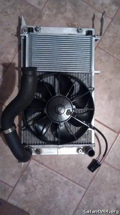

12" may be a little big. This fan fits exactly the dimensions of the AFCO rad "heightwise" and it is an 11" fan. (See my photo below) This fan pulls 14-16A. I had to fix a short over the weekend and in the process, rewired the fan and measured the current draw. I also installed another thermoswitch since the previous one was making the fan run all the time. I can now say that coolant tempts stay right between 170-180* with normal operation according to my analog water tempt gauge. With the fan running all the time, it was running almost 10* cooler especially in the sub 50-60*F weather. Very happy with this mod.
