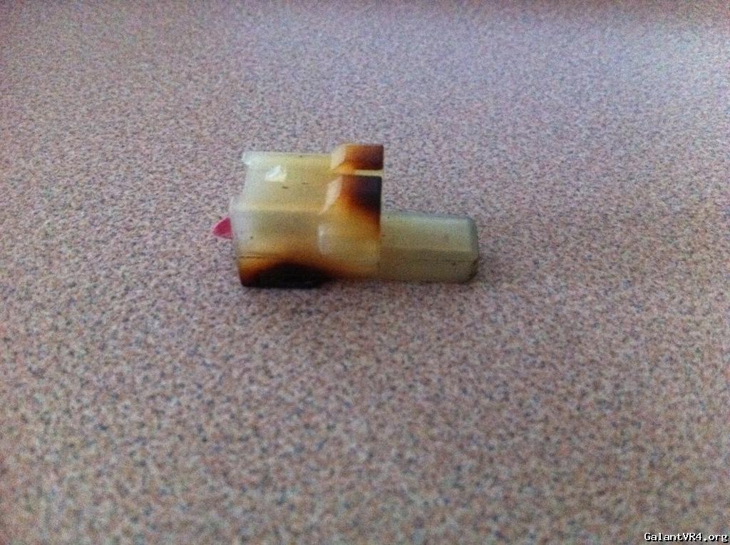

Foglights have not worked since I pulled the bumper. I double checked that they were plugged in, swapped out one of the bulbs, and replaced the relay. Is there a fuse somewhere I don't know of? I also pulled the plug and checked the connector and looks like it fried(pic included), so I snipped it and put another plug on it and still no go. What do I do now?

Did they work before you pulled the bumper? Are you sure you didn't pinch the wires going to the lights between the bumper and frame?

Yes they did work before I pulled the bumper thats why its bothering me. Don't think the wires got pinched inbetween but guess I'll just need to pull it and check.
