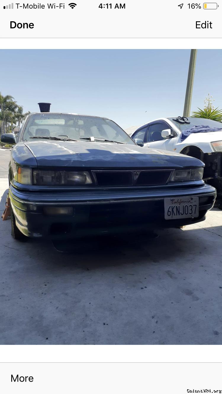

So I’m paying a local DSM mechanic to do the work,
The car has been sitting for 7 years, was a fresh motor before I shut her down.
Main things it needs are the
-Fuel rail bolts drilled out, ( because I broke two of them off)
-oil pan resealed
- shifter bushings / clutch pedal adjustment ( horrible getting in and out of gear)
- Flush all fluids
- boost leak test
Said he could do it for $5-800 I told him I wanna spend up to 2k so hopefully I’ll be up and running soon. Meeting on Tuesday with car. Wish me luck

So the car is almost done, he noticed the fuel filler hose is leaking anyone got one from JNZ available? I just called them and they sold the last one a couple years ago
yeti
Oct 13, 2010
803
san diego california
So the shift linkage is blown, anyone got a pair laying around for sale? Found a pair but the guy doesn't know if they are from a 90 or 91
Also got the front mount properly mounted, first time in probably 15 years the front bumper is not sagging.
She’s up and running, the shift linkage is the only thing stopping me from getting a tune. Let me know if anyone can help 🍻
