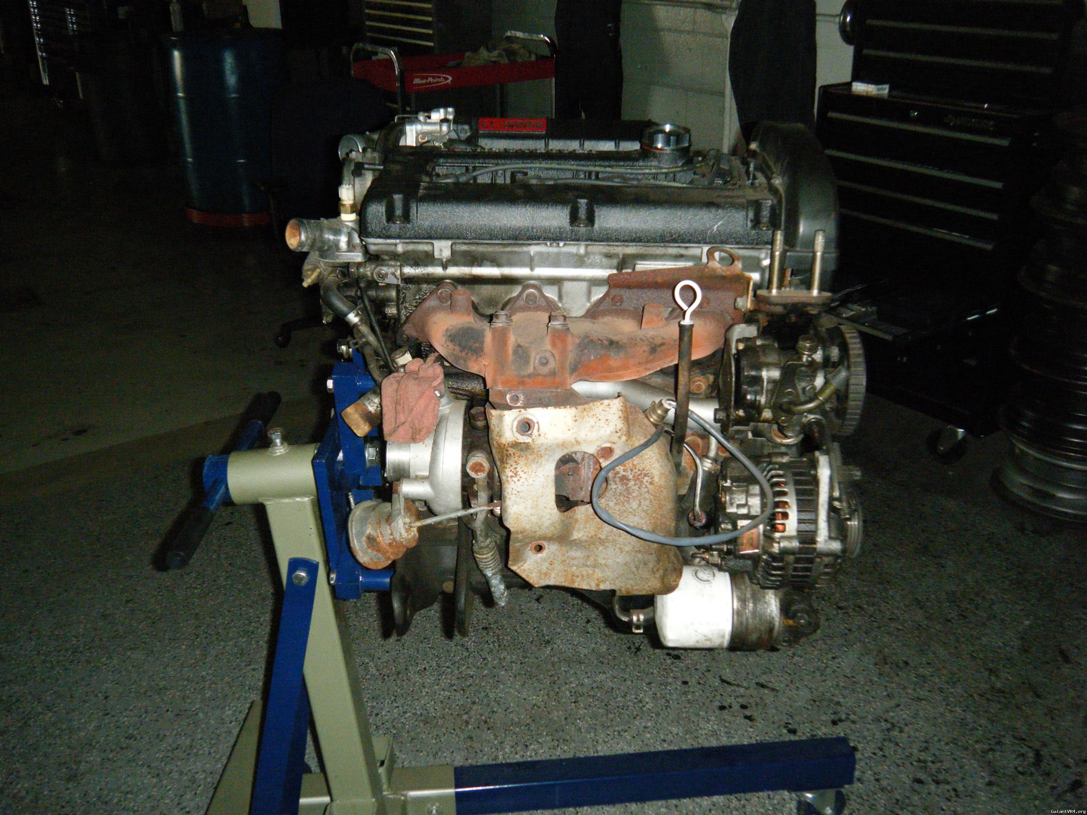

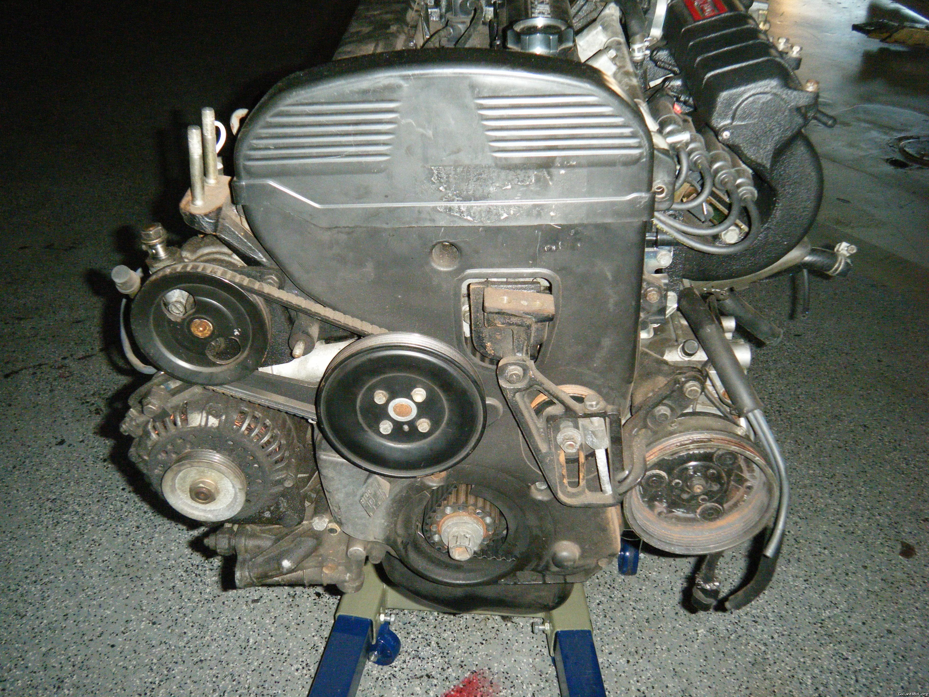

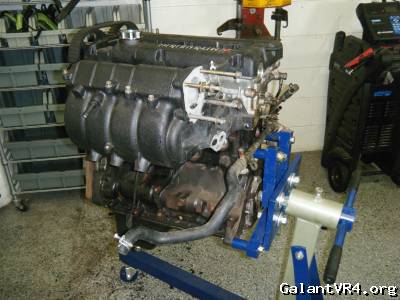

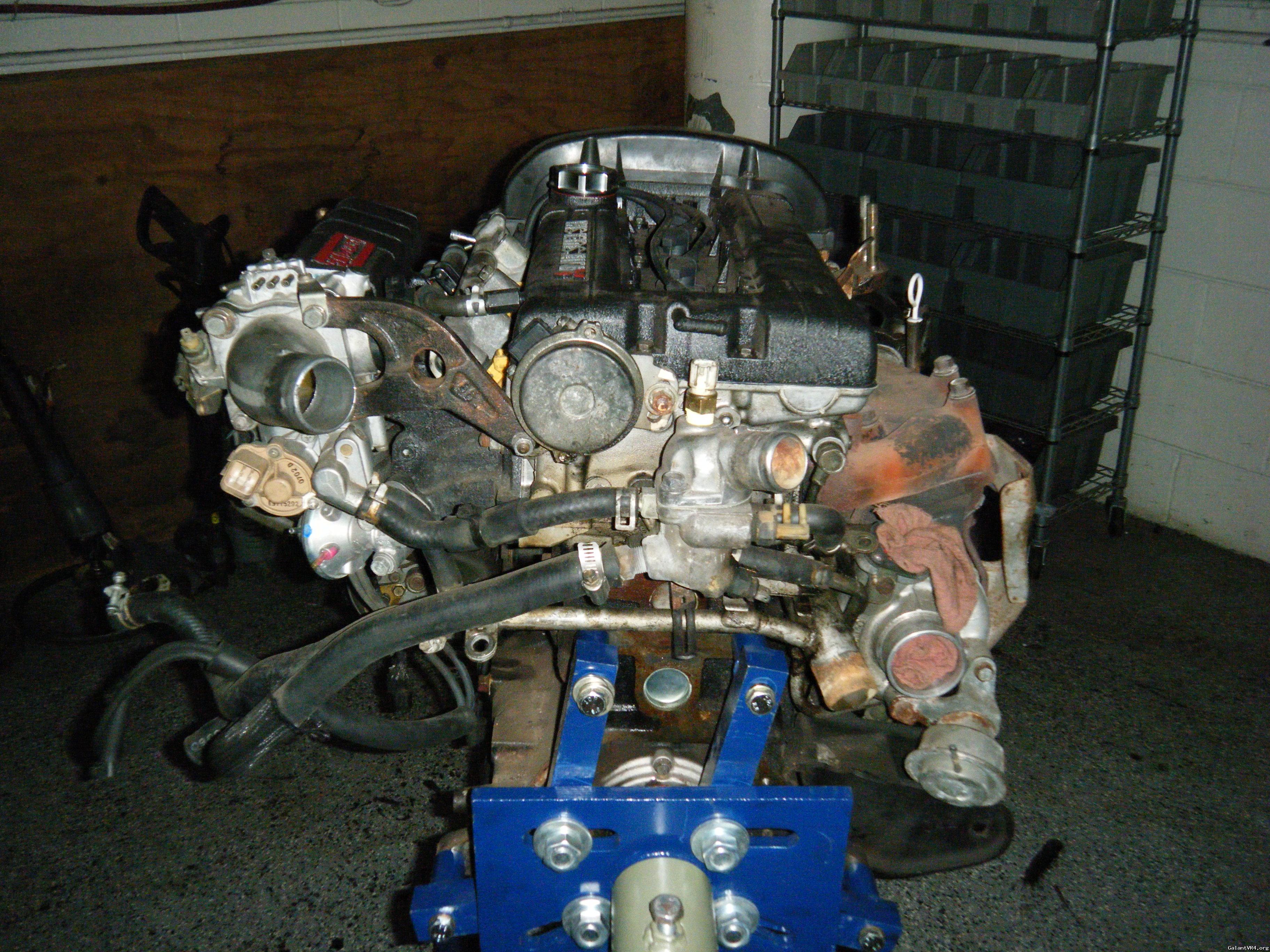

So finally getting around to it.
Engine was pulled a little over a year ago. 1991 gvr4.
Completely stock. Bought with 98,000 miles. It was driven from atlanta to illinois without issue. Some noise from a/c compressor. But hey that is not an issue.
Basic idea here is I want to rebuild this car as close to just rolled off the assembly line. Now keeping in mind I have wanted one since I was a much younger man, Not forgetting that go fast is addictive. I am interested and looking to make this as near mint as I can and do some minor modification's along the way. Best guess is 300 hp would suit me just fine. But. Now I say again BUT I can also see the appeal of going bigger. You know because the people you know and work with think they have the fastest car. Let's show them the glory of the galant...
Enough babble.

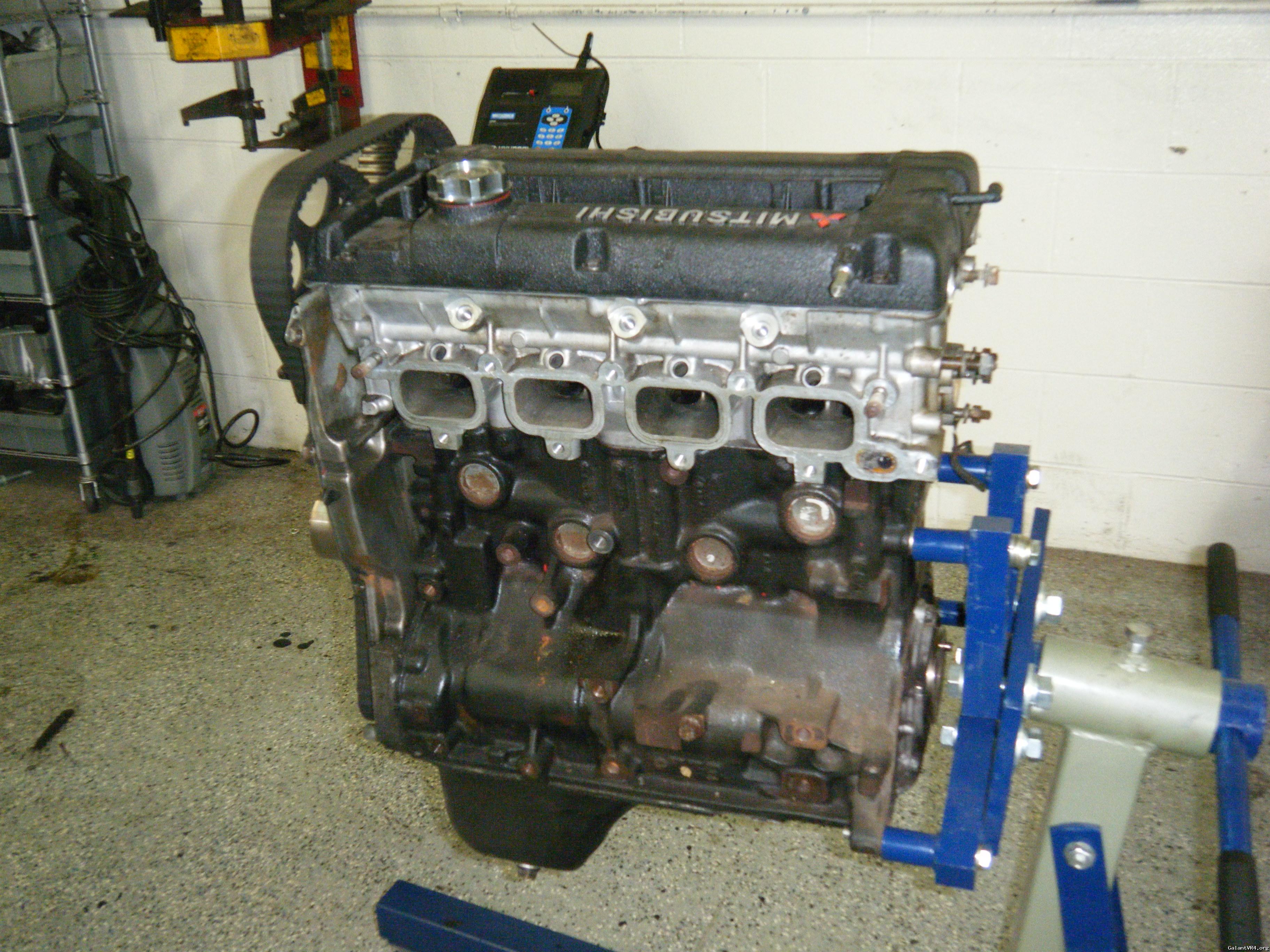

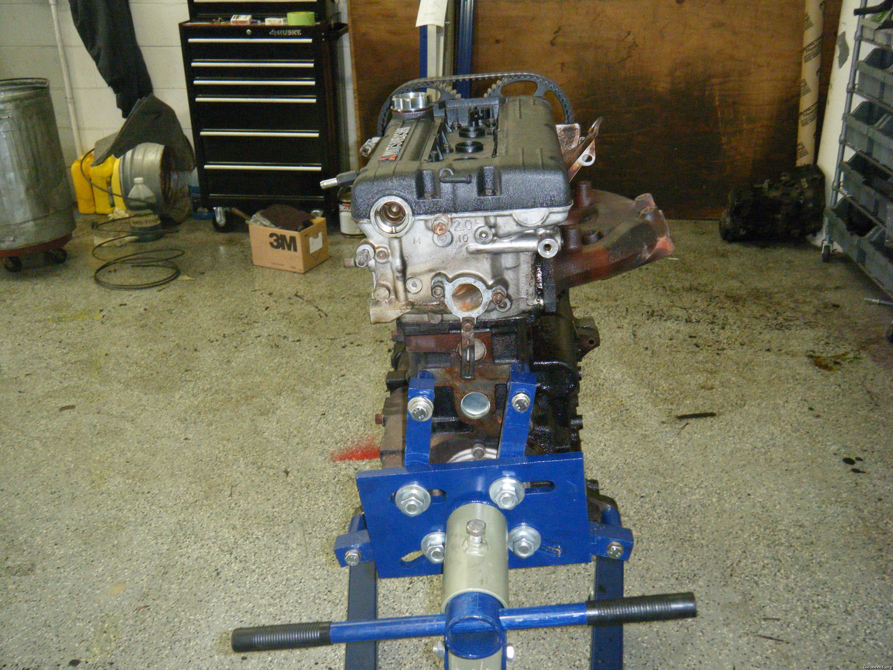

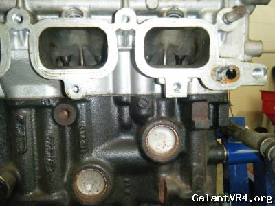

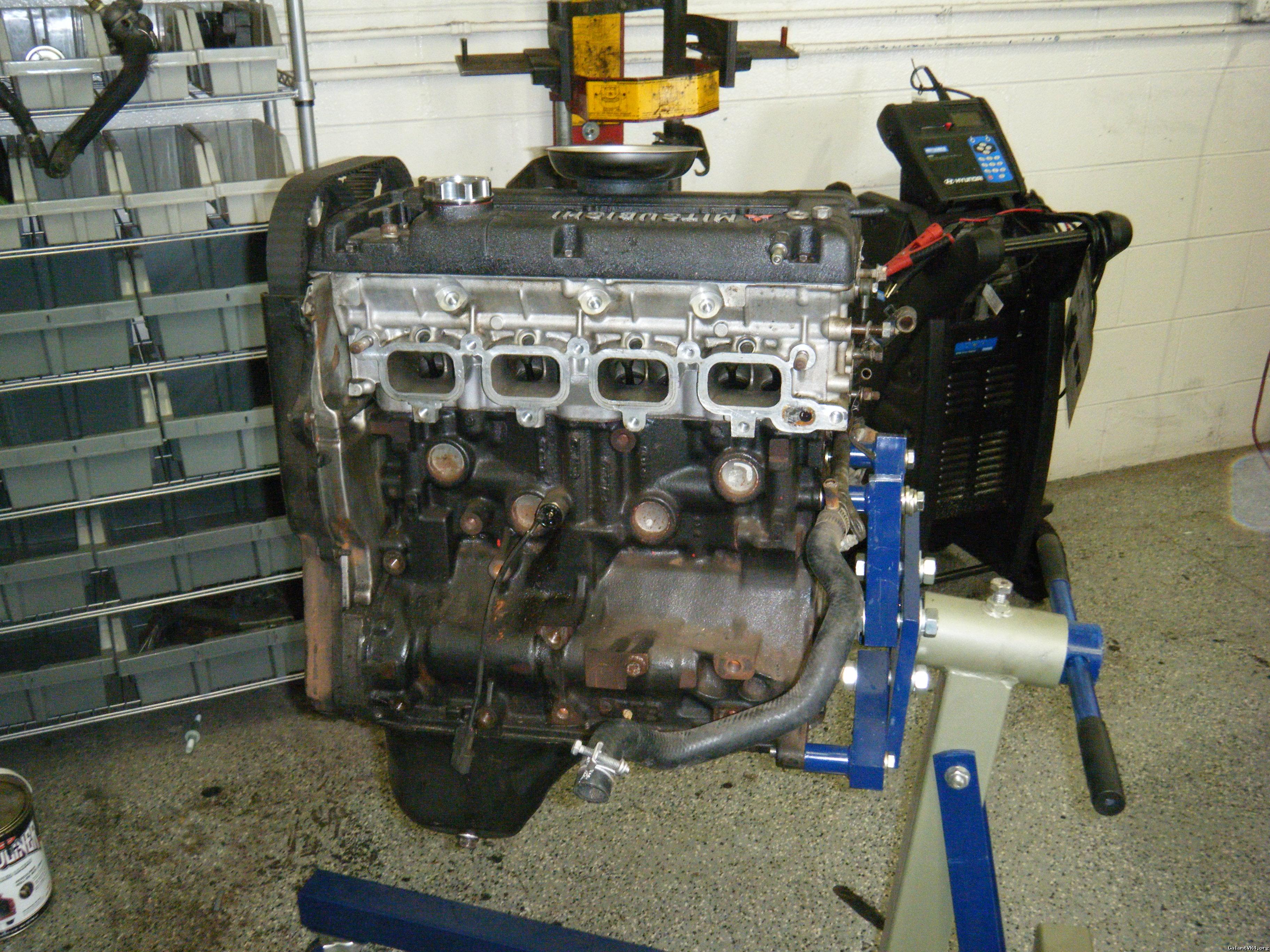

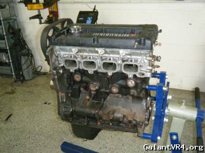

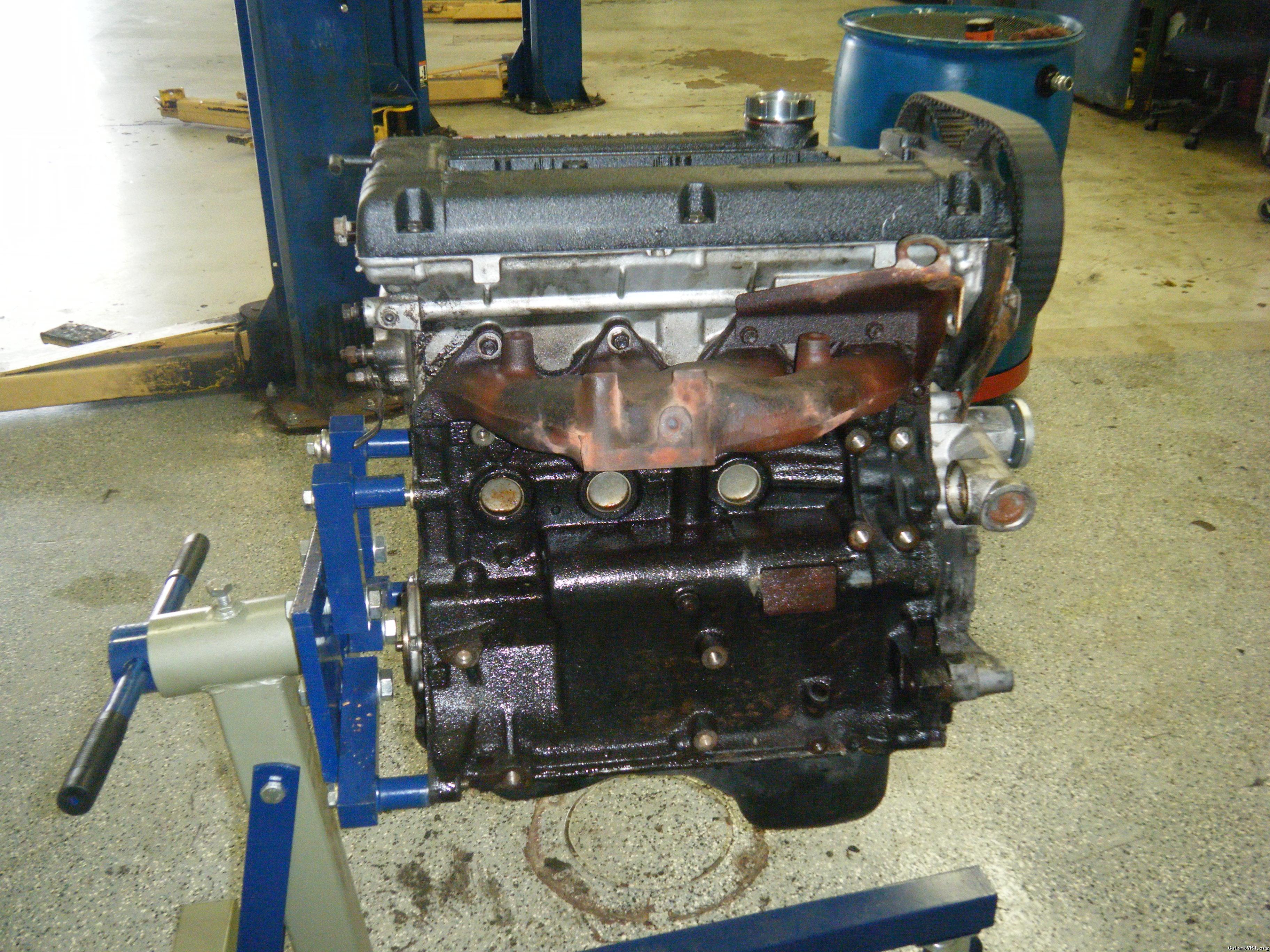

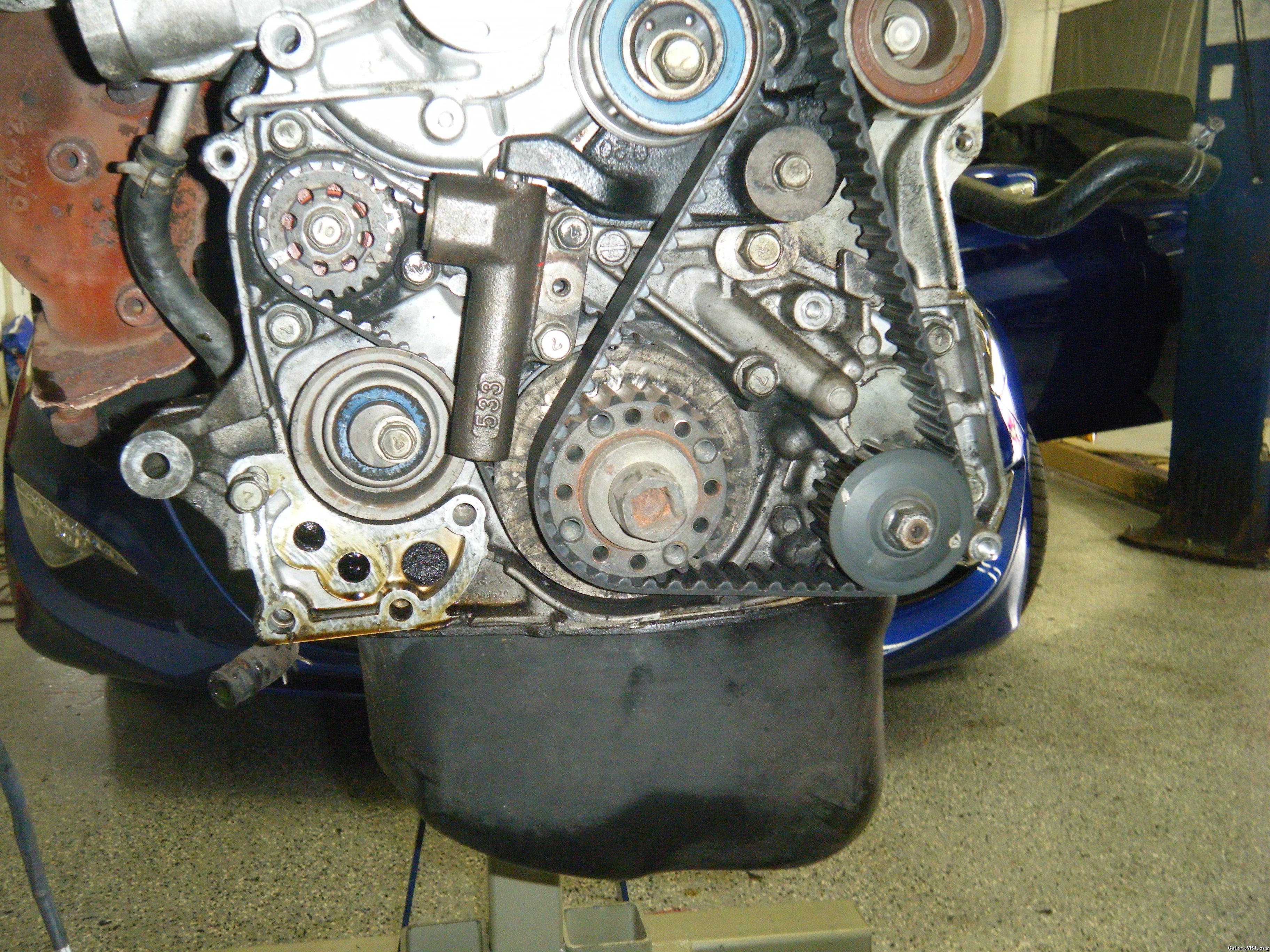

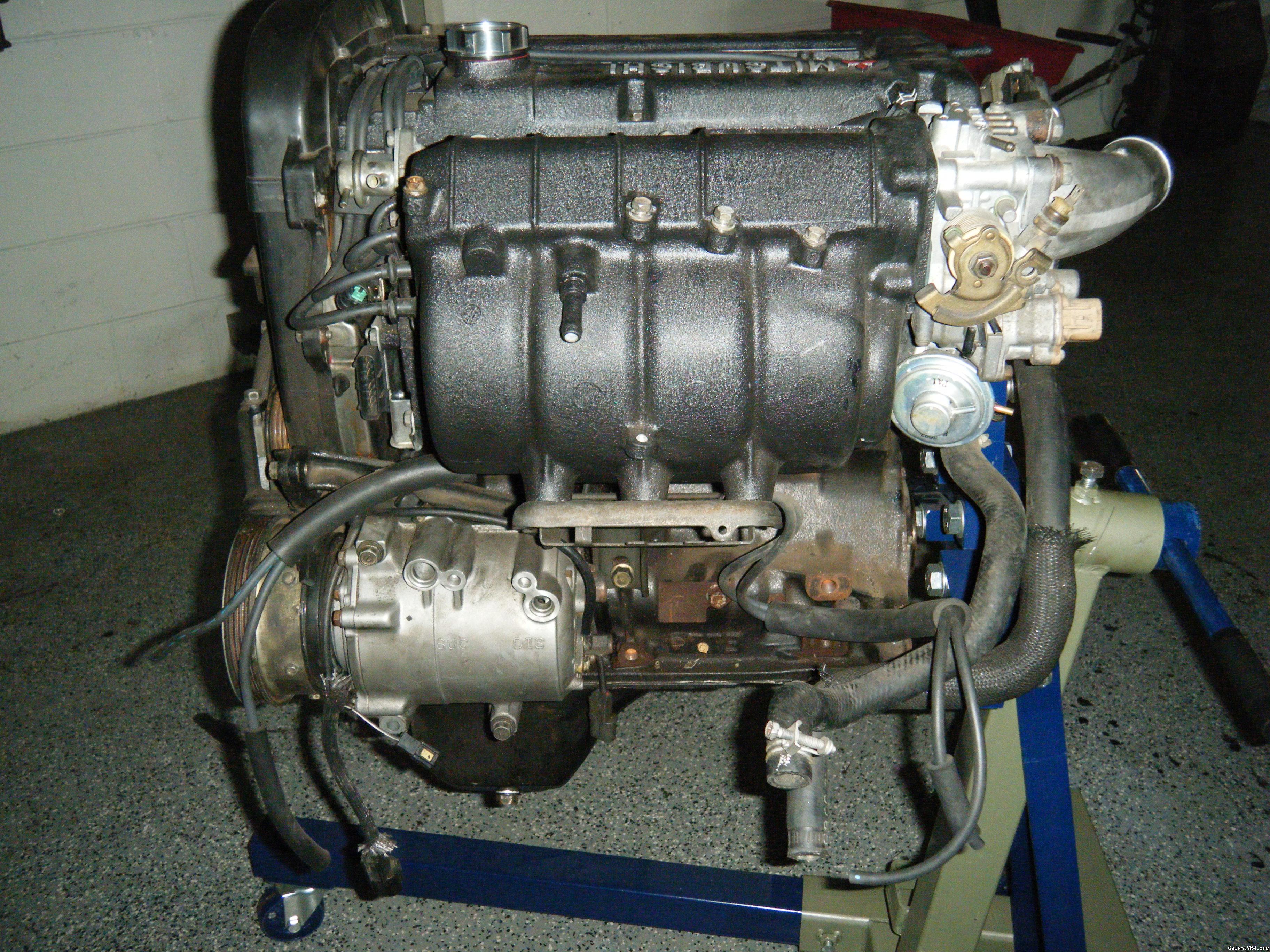

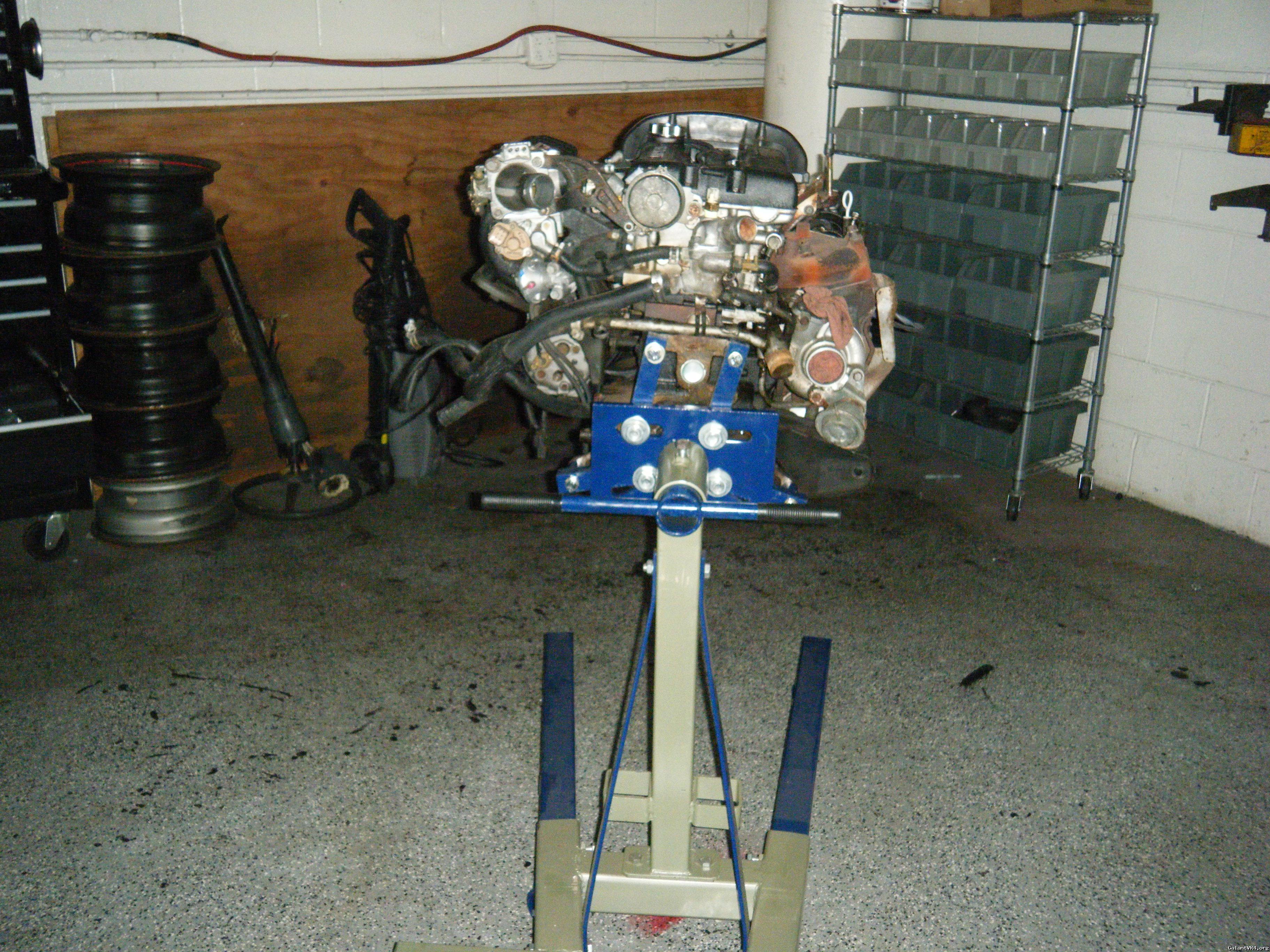

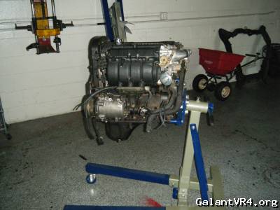

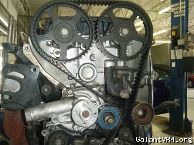

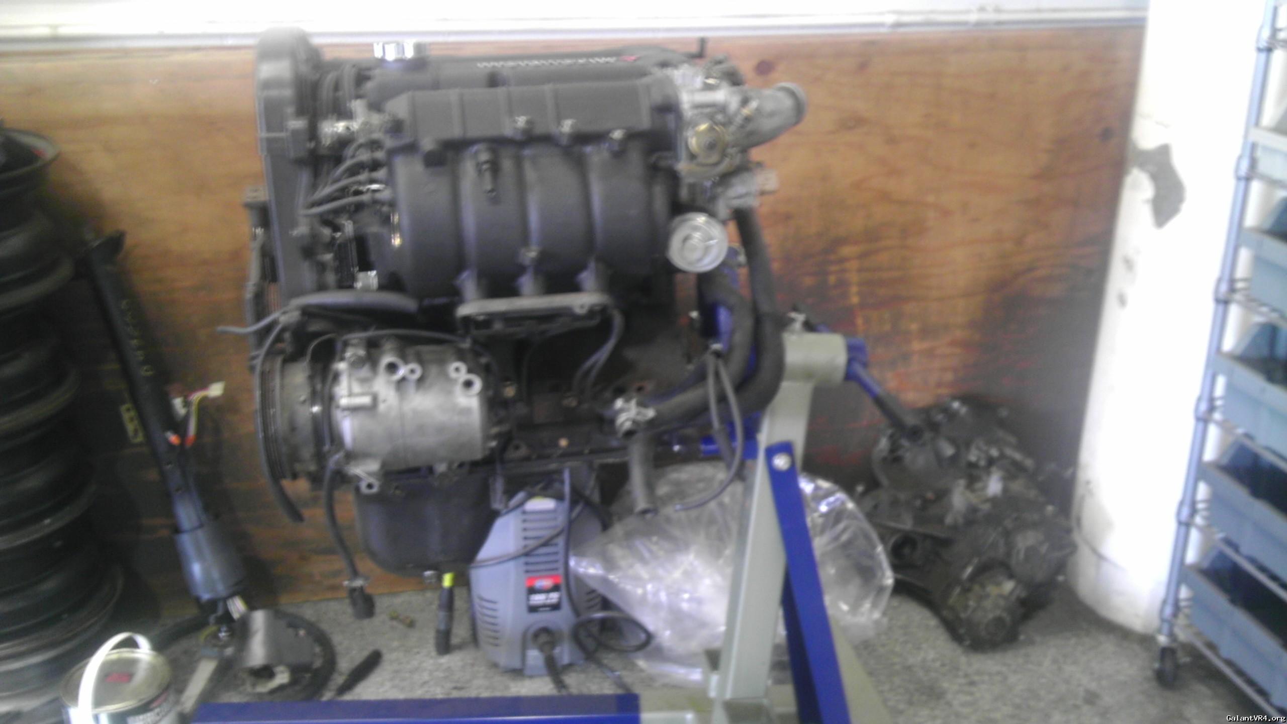

engine is on the engine stand. First thing I see to do. Remove the head and send it to the machine shop.
My question. Your suggestion's.
What do I replace?
what do I ask them to do?
I am not above the idea of replacing everything but the head casing.
Right now all I know for sure is make sure I have the updated lifter's. Even if I do I plan to replace them also.
So just looking to get myself out there and get some good advice.

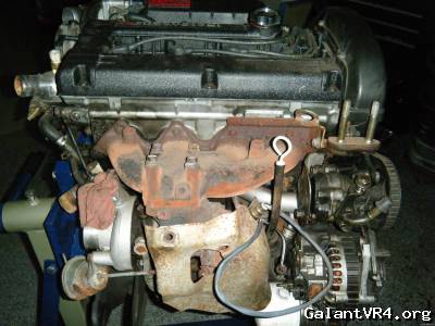

yeti
Oct 13, 2010
803
san diego california

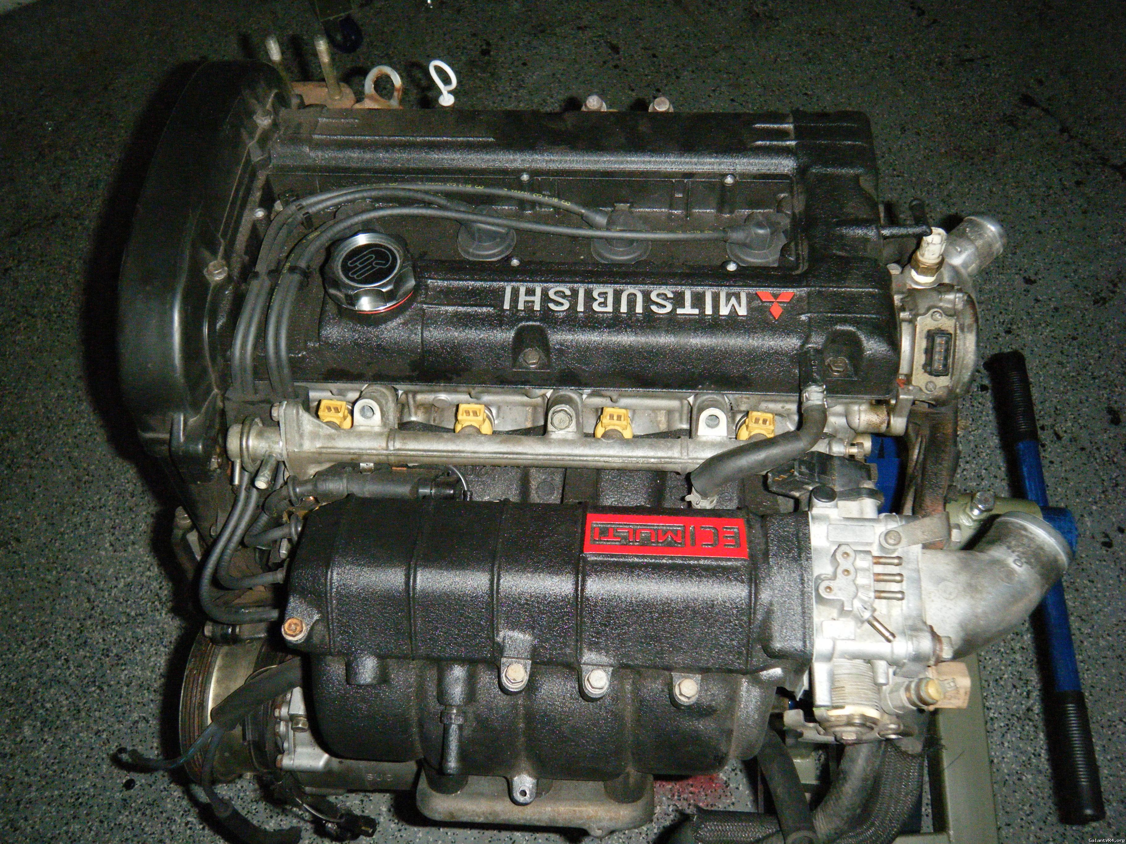

Nice, continue your hard work.. /ubbthreads/images/graemlins/applause.gif
Some ecouragement always help...

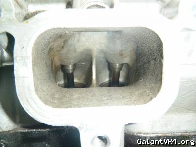

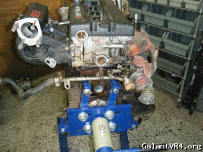

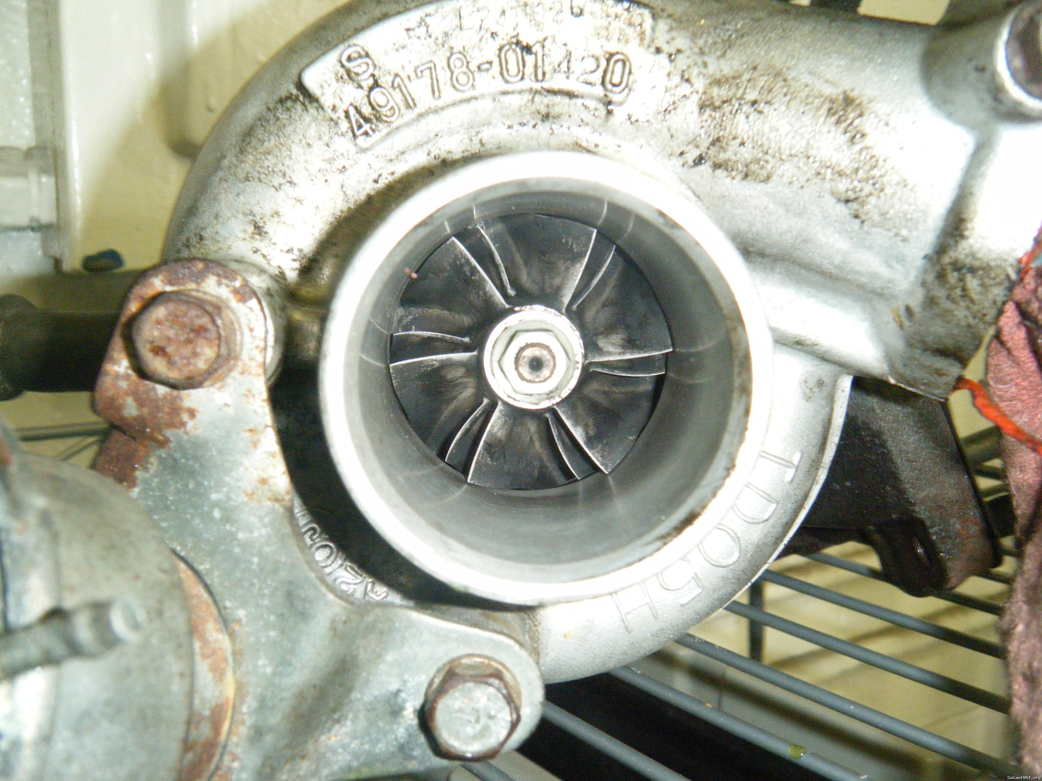

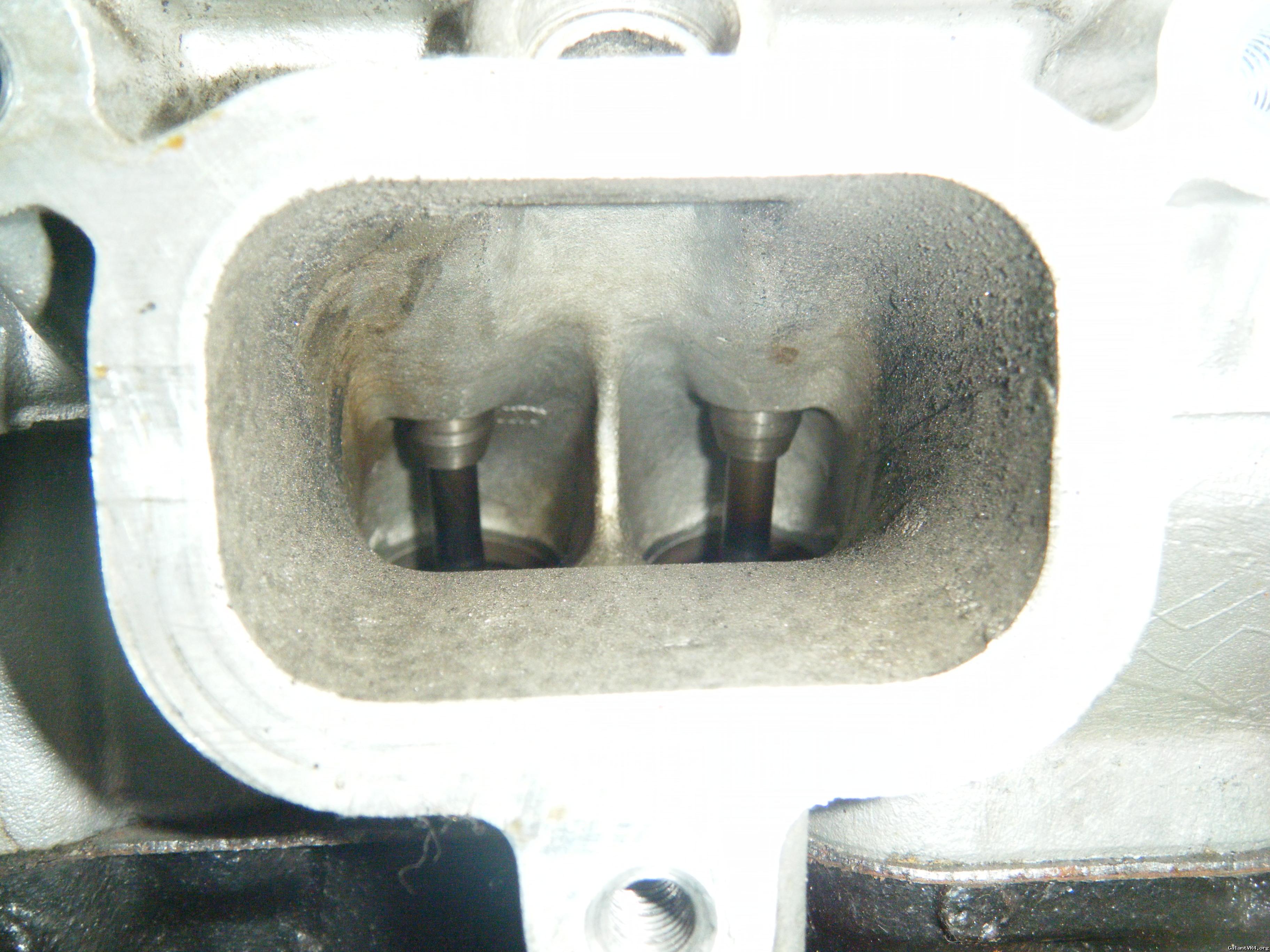

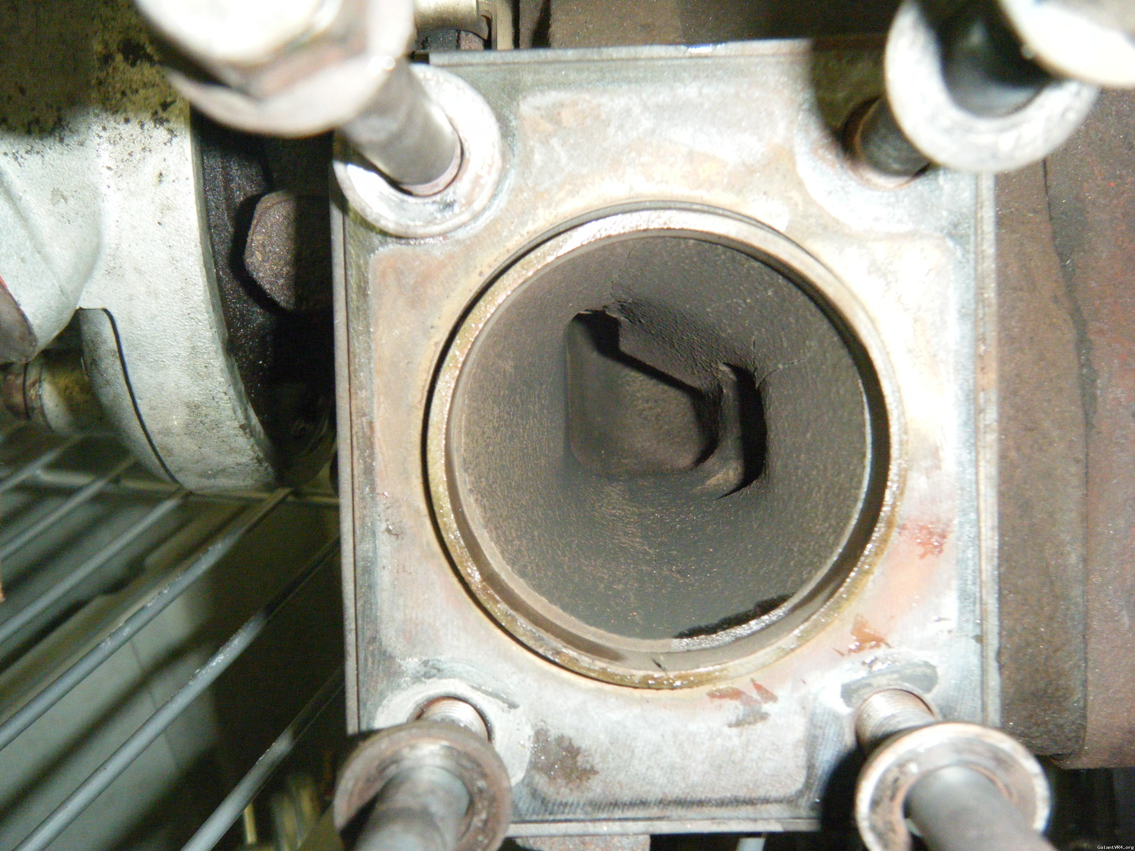

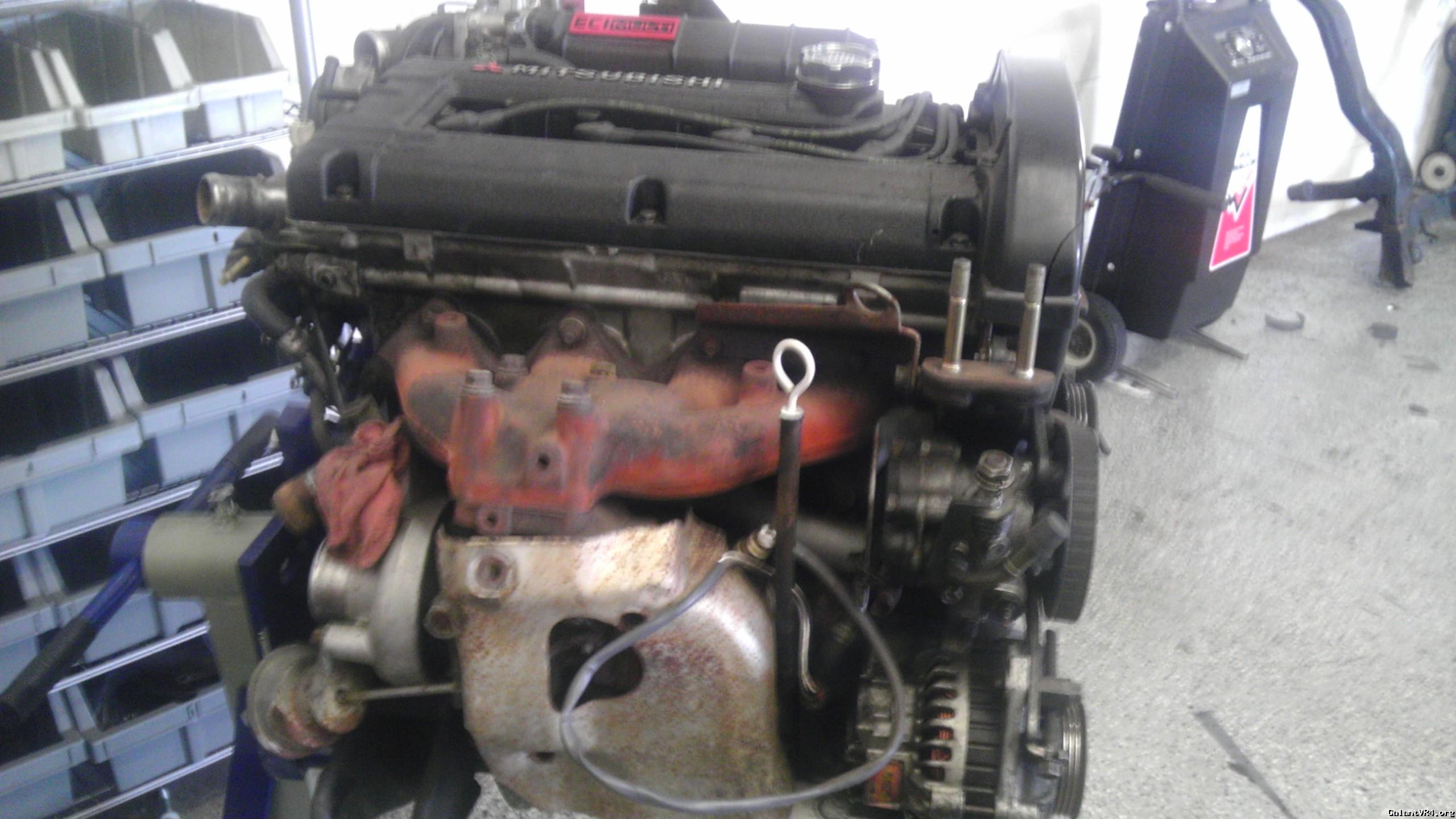

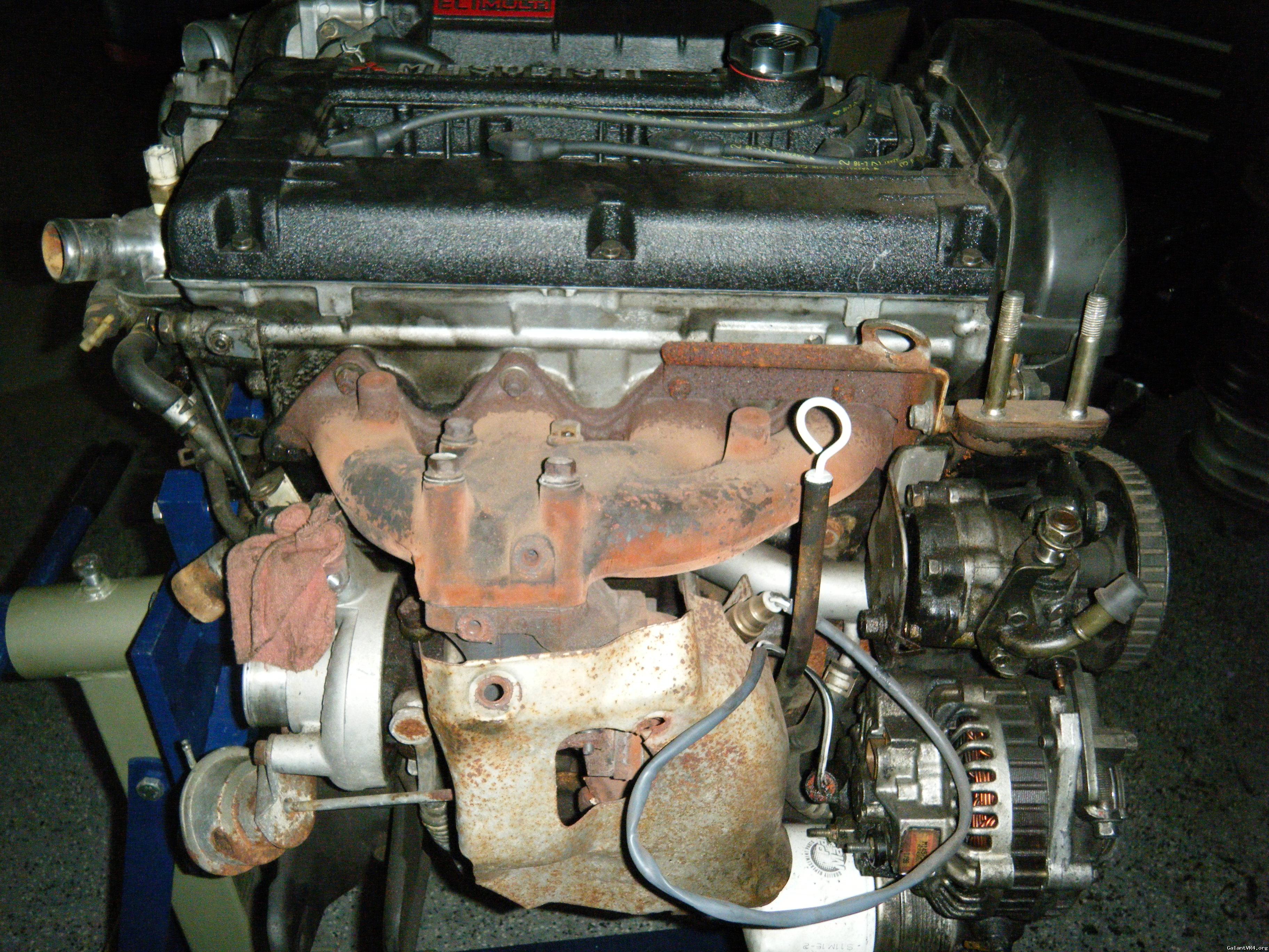

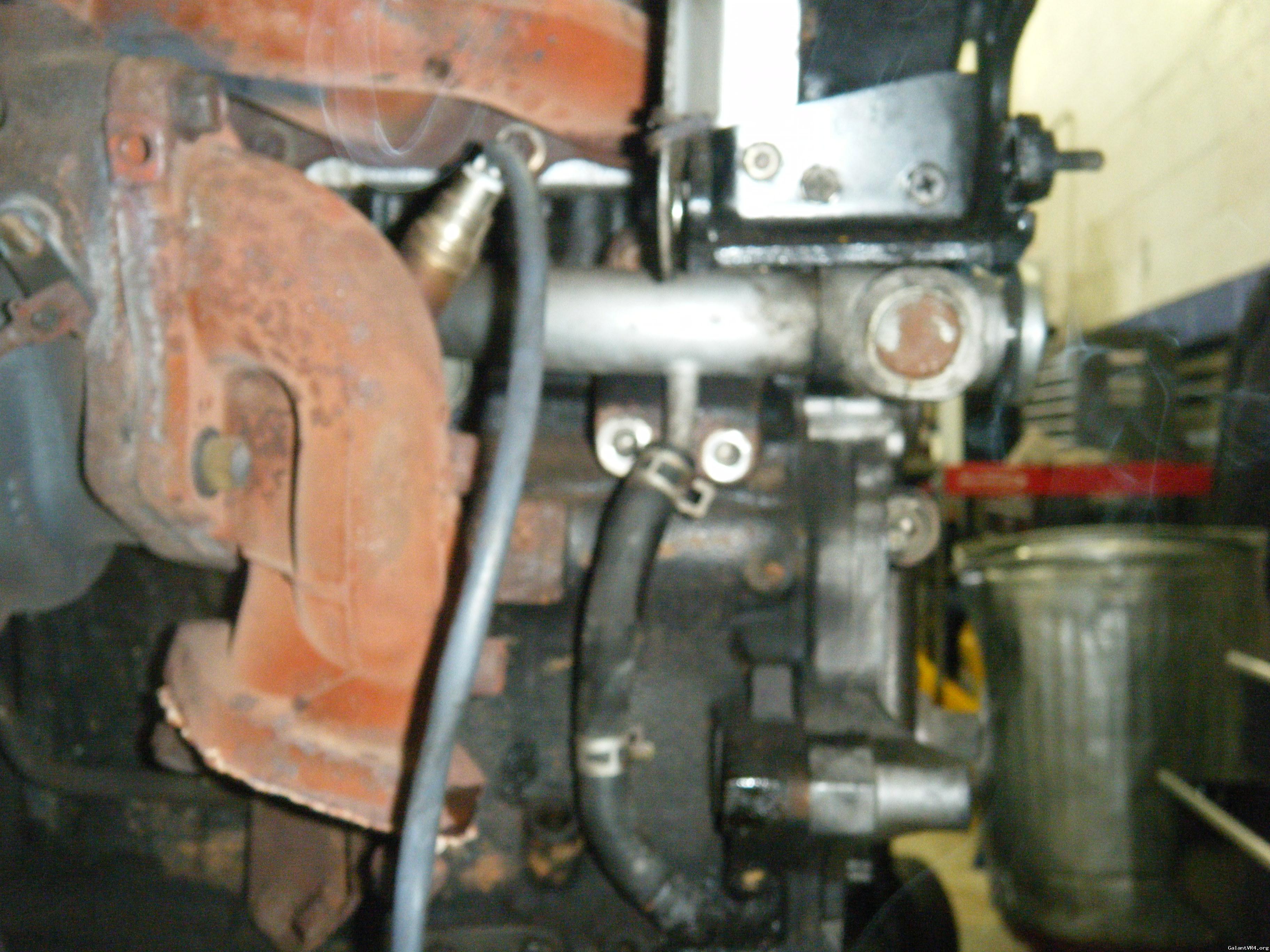

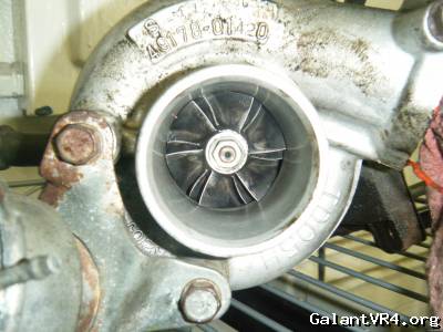

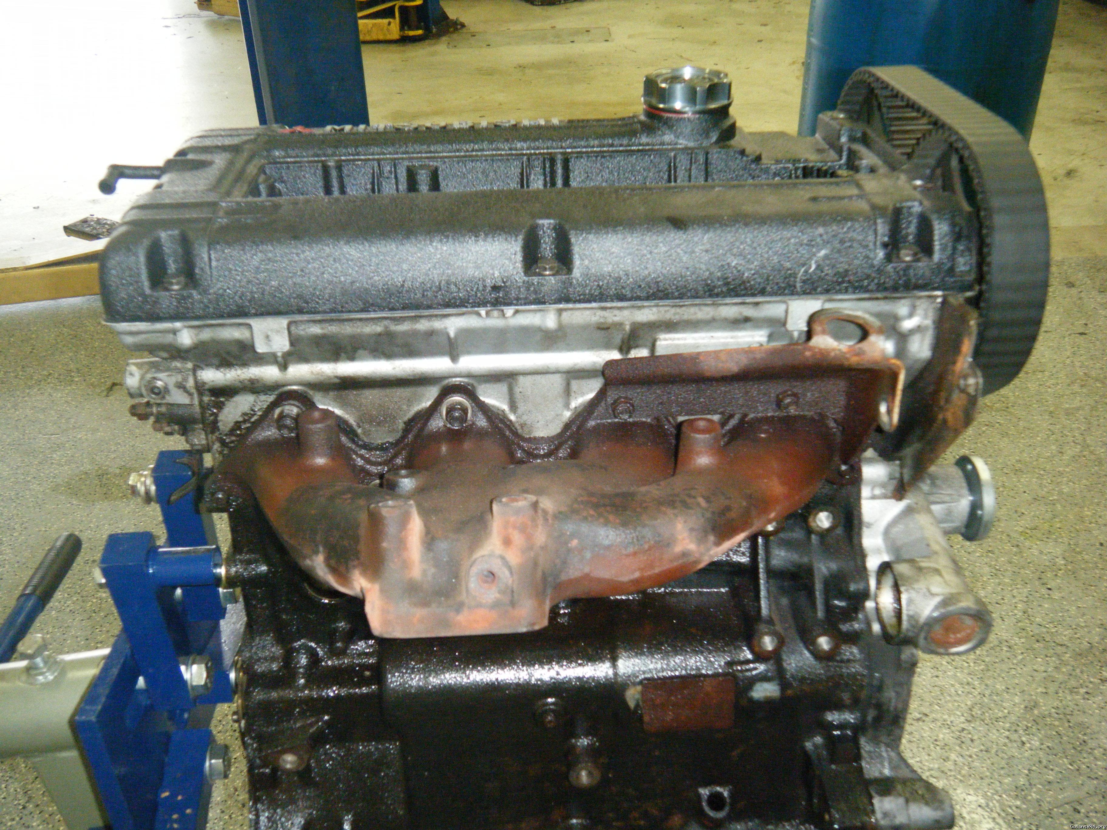

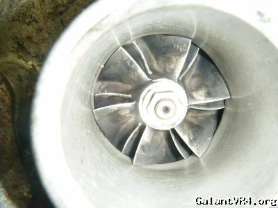

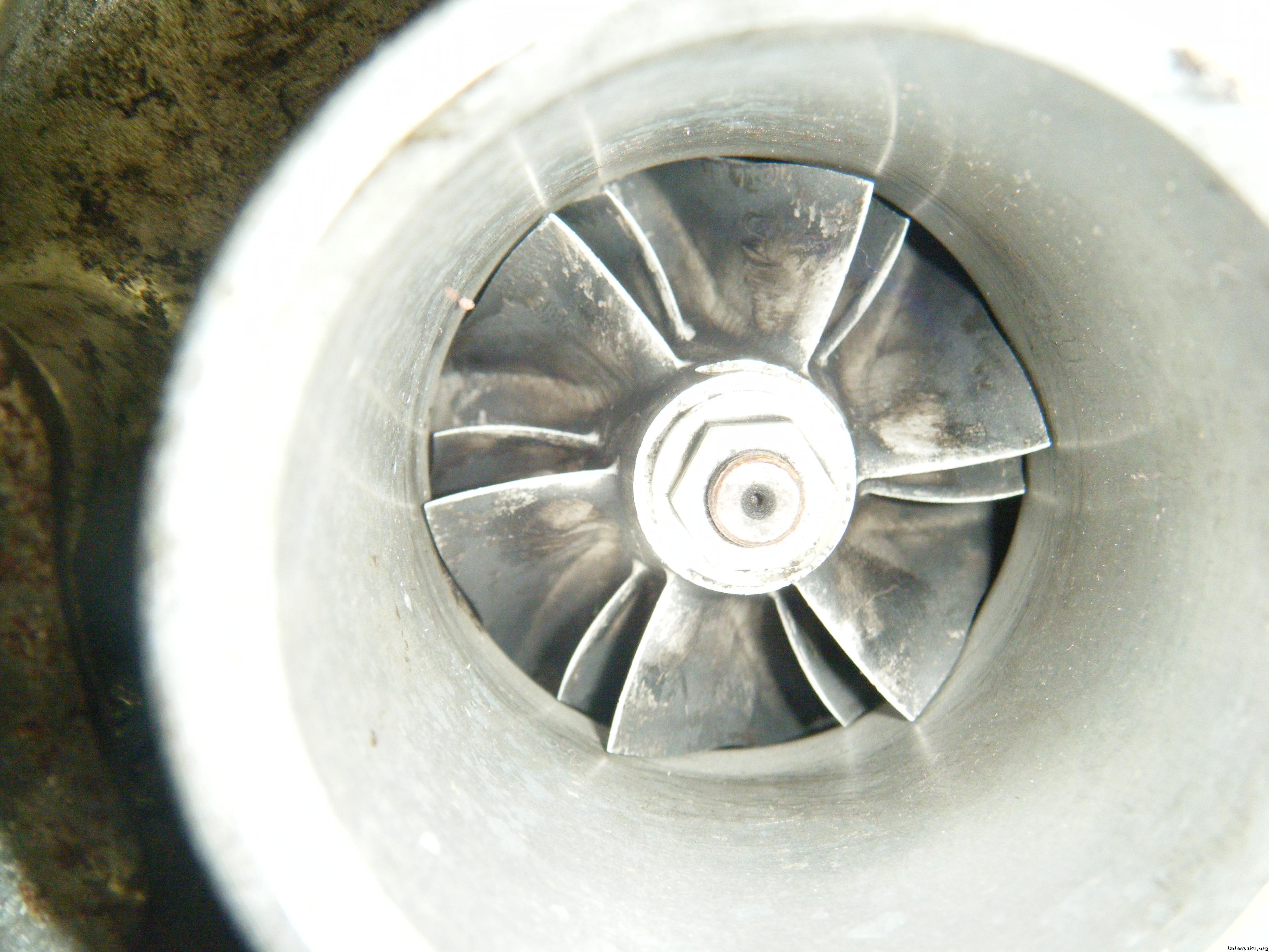

Turbo looks to be good with no cracks,is your exhaust manifold cracked?
Also.keep track of bolts bag everything no madder how little i lost a good 3 bolts and delayed me a whole day searching for them i just went and bought replacement
kooter
Jan 13, 2011
270
carpentersville, IL
thank you.

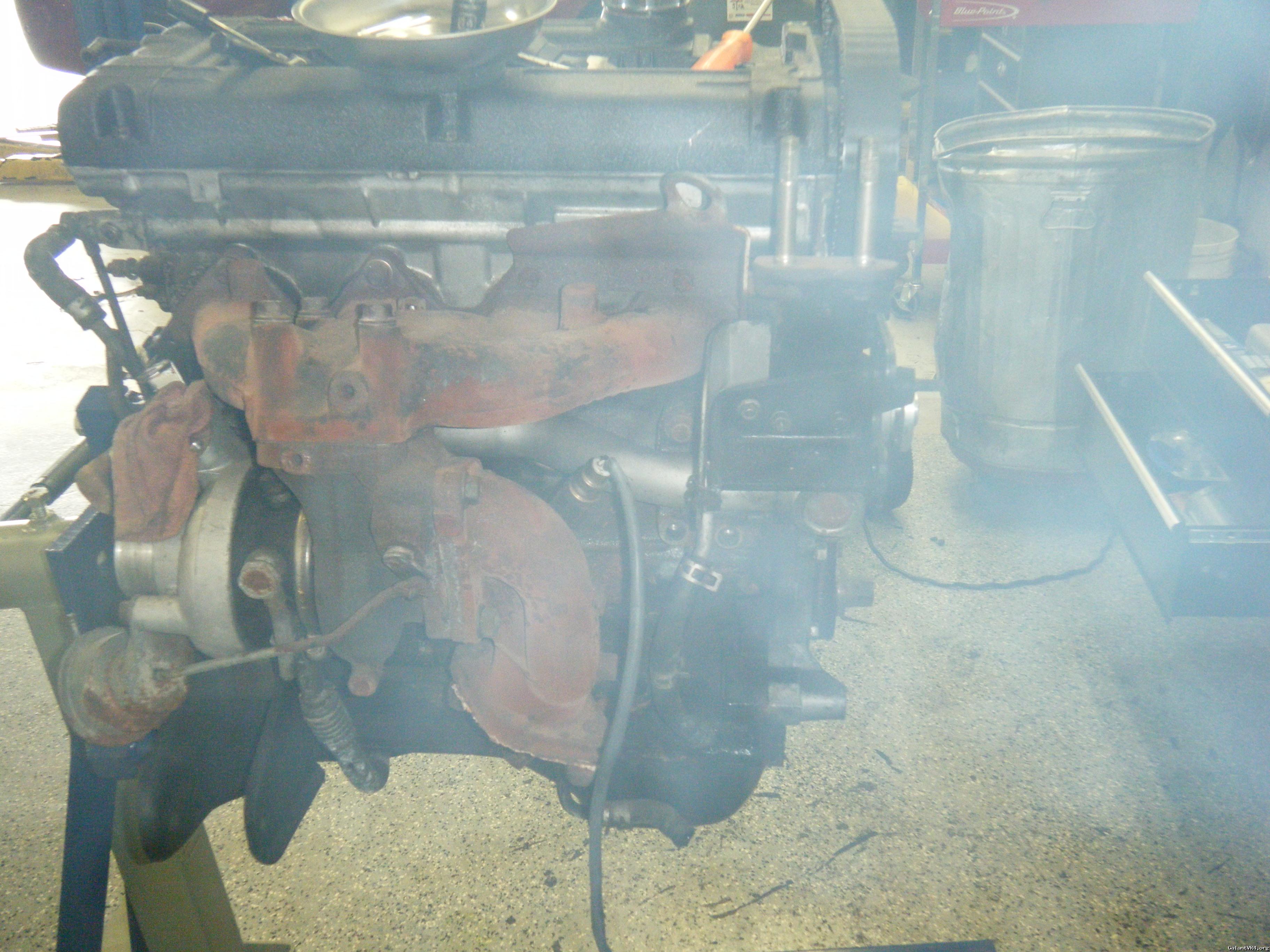

I did not see any cracks. I honestly didn't look. Got to were I am and had enough. It was a hot one today.
I will be getting a new ex mani. So any suggestions welcome. Was guessing either a 2g or maybe evo. Though I head evo needs to be slightly trimmed. Would have to look farther into that.
This is my first time doing this. The entire time I was doing the removal was remember were this goes and DAMN I should just get a new one. I love new clean shiny parts.
Also ex mani bolts are straight rusted so I soaked them in pb blaster and called it a day.
