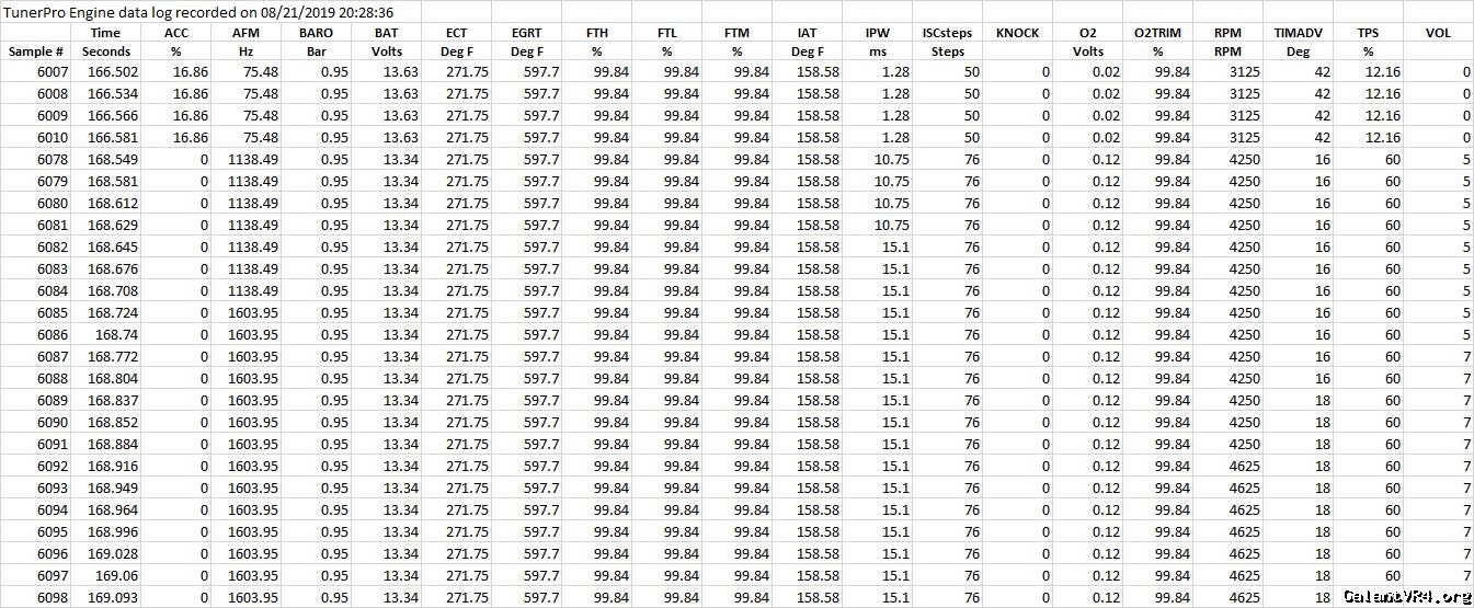

So, car now idles and drives low rpm pretty well.
However, 02 sensor not cycling. I have a new one, but figured I would go do one log to see if it would start cycling?
I logged a part throttle run through some gears. Can anyone take a look at the log if I email it to you and see what you think?
I will take a snapshot of a few rows as an example and post here.
Its been a while since I've viewed any log on the GVR4, but it doesn't look like some values are correct. You can see by the airflow hz that it started making PSI around 4250, but hz stops at 1600, so my keydiver chip did not bump the hz logable through the ECU then I take it?
Are all the values being effected by my O2 sensor not reading? I will swap it out and put the BISS back to where the ISC is at 30 steps at idle for next time. What else can I start logging in Tuner Pro that will help?

Good point on coolant temp sensor. Is that the 271 in my log?
I think I also have a connectivity issue on the ITS or IAT wire. Intake Air signal goes higher with no voltage, and so I am getting what appears to be a high reading on the ITS. With the brown wire connected on the MAFT, IAT should be 80F, not what mine is showing.
I will see if I can check the coolant sensor at the ECU. Might take a while for me to orient and figure out which is which but excellent suggestion.

New ECT sensor in. Readings in the 250F range. Seems high to me but not sure what to expect?
I decided I would try my new Denso O2 sensor.
Well, the car now cycles O2 while idling. I must have gummed up the old one 10 yrs ago with soot, etc.
So, now I have a car that goes into closed loop finally.
I took it out and just did a 1st, 2nd, 3rd pull while logging.
Interesting results. Only the FTL has moved off 100%. It is down at 81% after just a mile or two of driving.
I'm pretty sure this indicates rich at low throttle inputs and I can pull some fuel out.
In first gear I picked up massive knock right away with 50-70% throttle. In shifting to 2nd and rolling on, I didn't pick up much knock at all, and 3rd gear at 85% throttle was nearly clean with regards to knock up through 6375 rpm or so. Boost is set at about 14 psi or so.

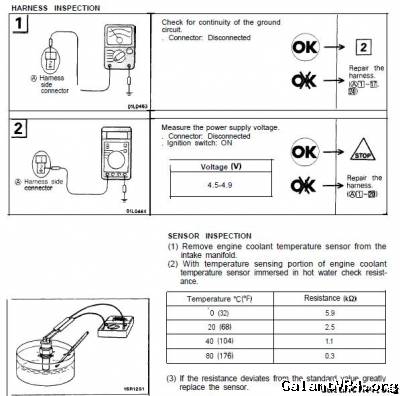

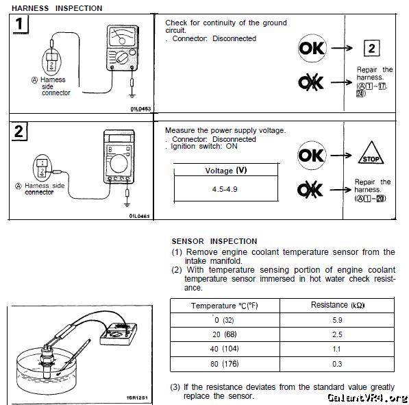

How do you check the ECT circuit? With the old ECT sensor the reading on the logger was 271.75. From cold start it definitely started out around ambient but it quickly climbed to the 271.75. I think that this meant very minimal voltage getting to the ECU at that point. I'm at work and don't have the log with me, but with a new temp sensor I think I was getting lower than that but I need to see if it was changing when driving on the road vs idling in the driveway. I still think it was in the 250s.
Is there a way to just check voltage coming out of the sensor? Can I just pull back the plug cover and with the multimeter in VDC go parallel across the two connectors so parallel to the load, yes?
Then see the voltage at the ECU by probing the pin and ECU ground?
I really don't think coolant temps are actually that high but the 50/50 mix says 265 boing point so it is in the realm of possibility?
Turbo is oil cool only and I am running the '90 oil cooler with external air/oil cooler. So no extra heat load on the coolant other than the engine.
I wouldn't be questioning this as much but at the ECU my IAT is reading 183 or something similar when the MAFT is supposed to be sending 2.5V or 80F.
