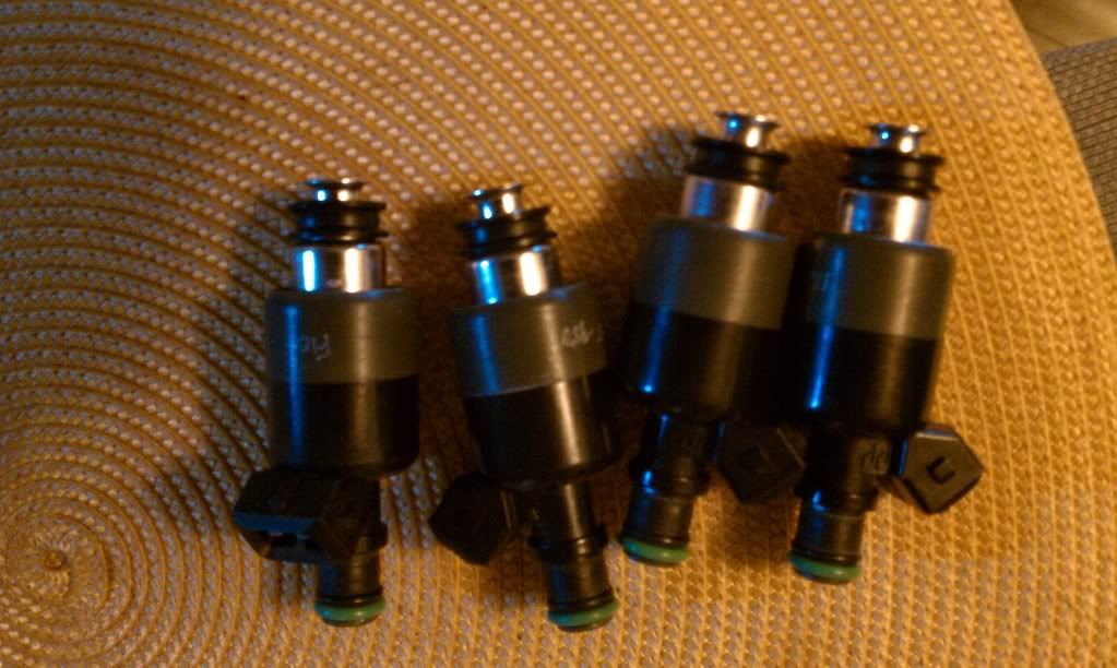

I went to a shop to pick up an o2 bung, while I was there I went ahead and asked for some injector lower isolater and he then proceeded to tell me that I needed to modify the injector. In the pic, you'll see the flare, will I have catastrophic failure if I don't remove it. He definitely said I should do it but he has done some shady stuff before, that is why I only buy small parts from them. Here is a pic of my injectors.

Those aren't the correct lower isolators. Those are the upper bushings for the stock injectors, or aftermarket if they accept the upper bushings. Not all of them do.

yeah, those belong on the injector inlet neck, between the injector and the fuel rail. (you can see where they're supposed to go)
FIC should sell the lower insulators you need, and I doubt that having a flared outlet will hurt anything as long as you can get the insulator seated properly

Sorry, I forgot to mention that I bought 4 lower isolater from the dealer after finding out they had none in stock., that's a pic I took a few days ago. Those are now located at the top. My main issue is that he wanted to machine the injector on that flare for some reason.

I appreciate it, I've had prior issues but I hadn't heard about this one, . I found nothing online to validate his opinion of my injectors. Thanks
11,982
I have the same injectors in 1051 btw. They work great. /ubbthreads/images/graemlins/smile.gif
For what it's worth, I have RC750's in 503 and they didn't require the upper bushing. I can't remember if the FIC 950's in 1051 did or not though.
