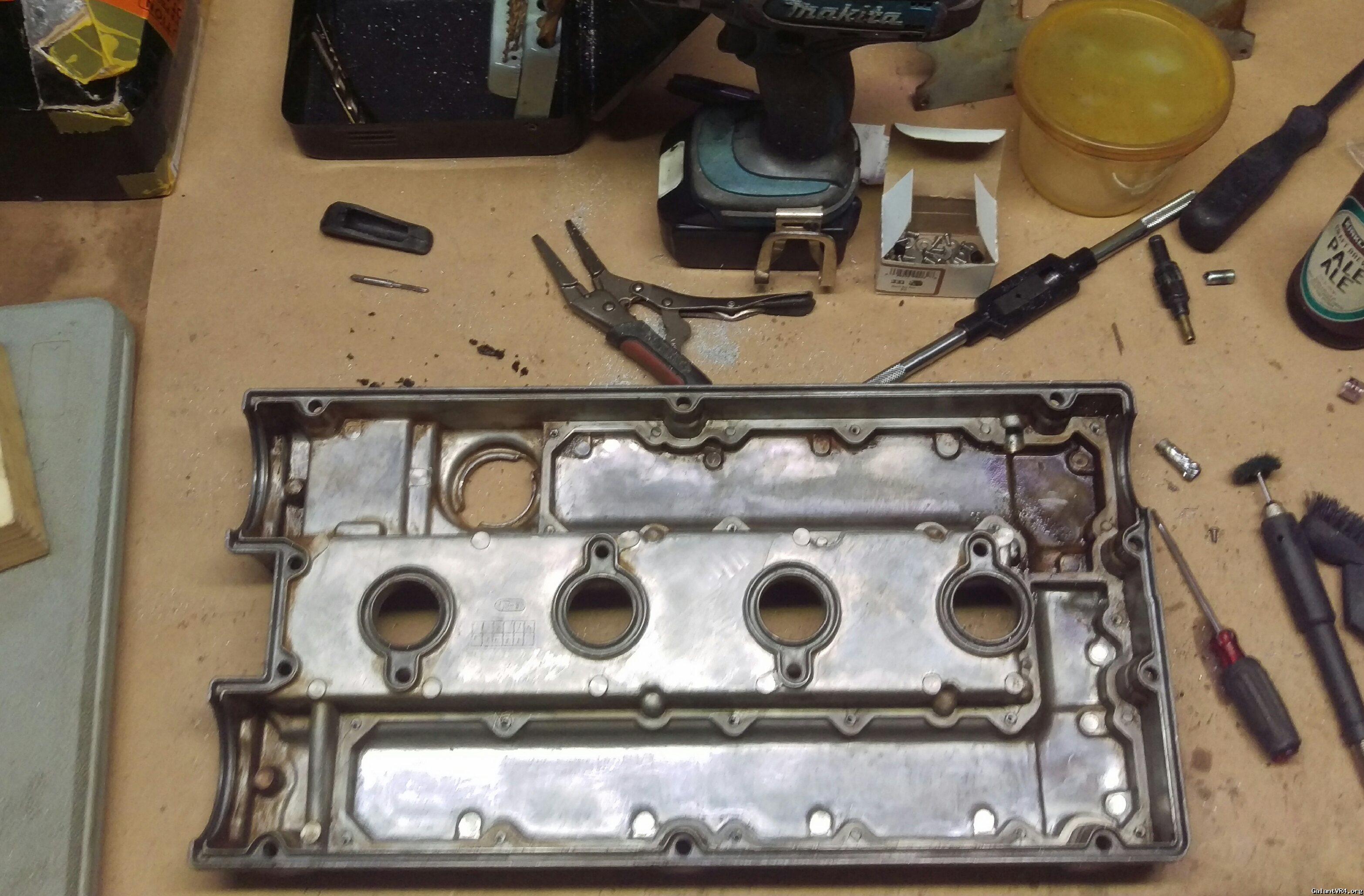

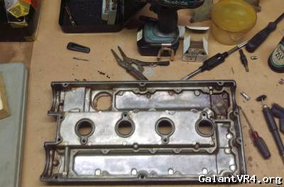

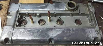

I ordered some hose barbs for the valve cover too. 1/4"npt x 12mm (1/2") id hose

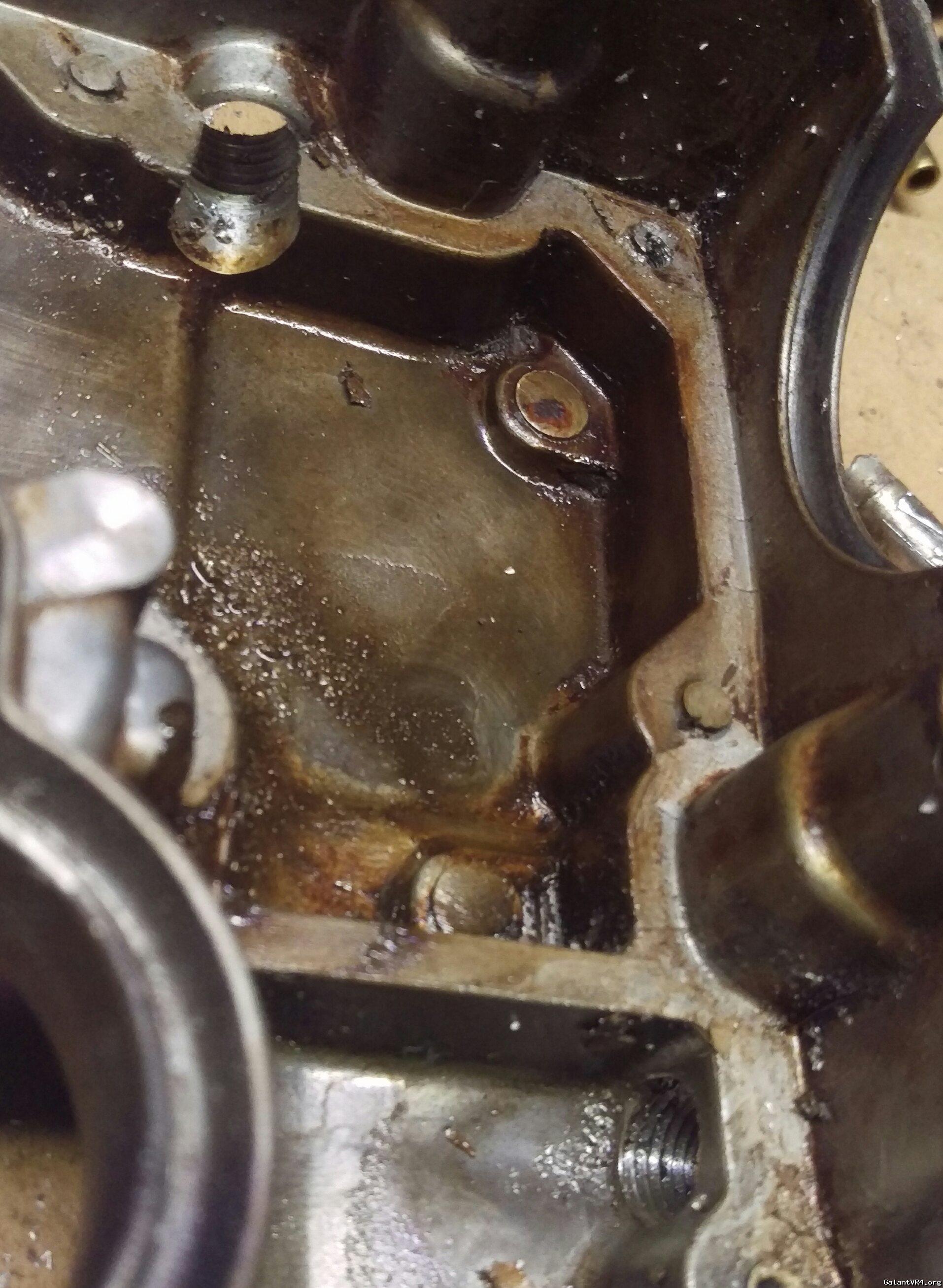

I just shaved a valve cover and removed the baffle to clean it. I'll drill and tap for the bigger fittings today or tomorrow. Will also drill and tap for new pan head screws to hold the baffle back in and smooth the inside of the valve cover. Its a very rough cast. will post pictures when I have some progress to show.
I noticed that the bottom half was very clean but the top half was filthy. I'm pretty sure this is because the port for the pcv valve is half the diameter of the one that goes out the side to the intake. That or the pcv valve was clogged.
4-29-17 update:
Drilled taped and polished the valve cover. M3x.05 to hold the baffles in place and 1/4" npt for the stock vents. Need to finish the outside now. The 1/4" hole just fits.
I decided to shave it and it's a little rough currently. Thinking of using jbweld to fill some deep gouges. I don't think regular body filler would work out right. Would it?

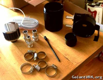

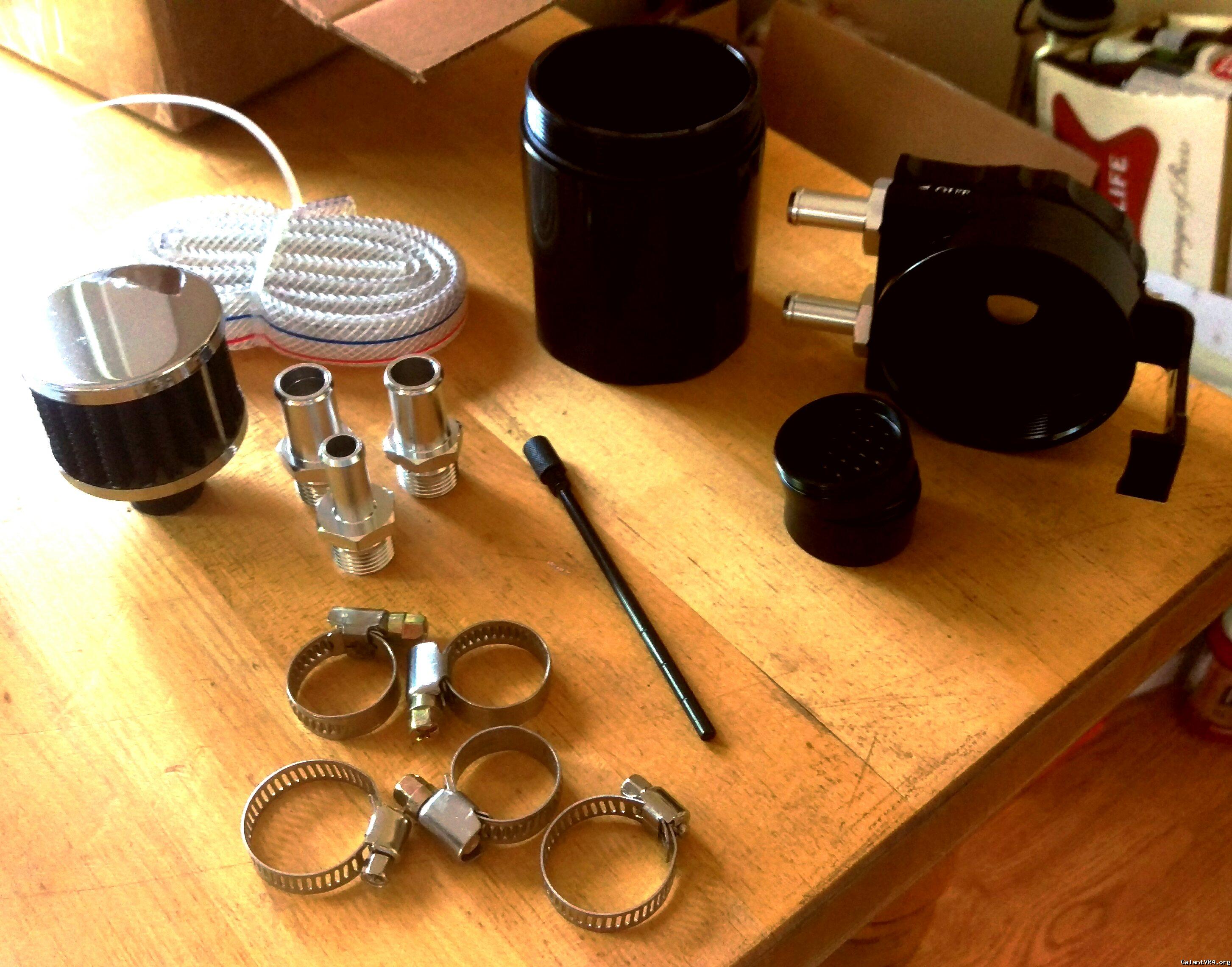

So the catch can came in. It doesn't seem like its going to work the way I wanted. The side with the filter is the one with the two ports. That should be the vacuum side. But that would leave me with only one input. Also the threads are m16x1.5. Kind of hard to find fittings and impossible locally. An6 and an8 fittings are available. I'm using hose barbs so I was thinking of just retapping to 3/8" npt. My plan is to put a 3/8 npt to 3/8 hose barb in the top and t it off between the intake pipe and the manifold with a one way valve on the intake pipe side. And then run the front ports to the valve cover. Inside the can I would run rubber tubes to the bottom put some stainless pot scrubbers in there and tap the 3/8 outlet with a 1/4" sinthered filter. Only problem is getting the tube to run off the little side. I can tap a fitting on the inside too but the dipstick is cut in a bad spot for this. I can maybe tap it an then just drill a relief for the dip stick when the fittings in place. I should have just got the can I got last time. Should have known I wouldn't leave well enough alone.

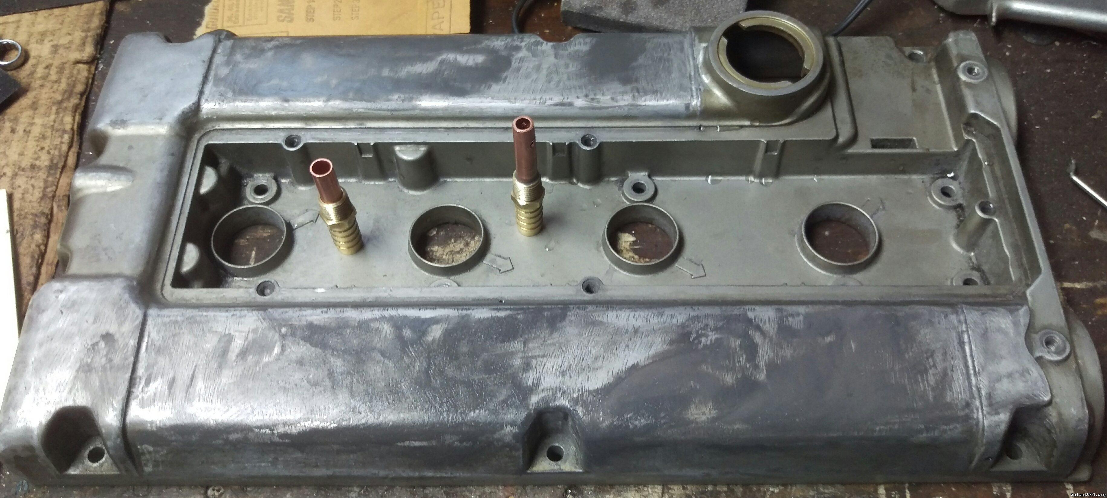

Here's the ports for the valve cover. 1/2" barb fittings drilled out to fit the copper tube.
