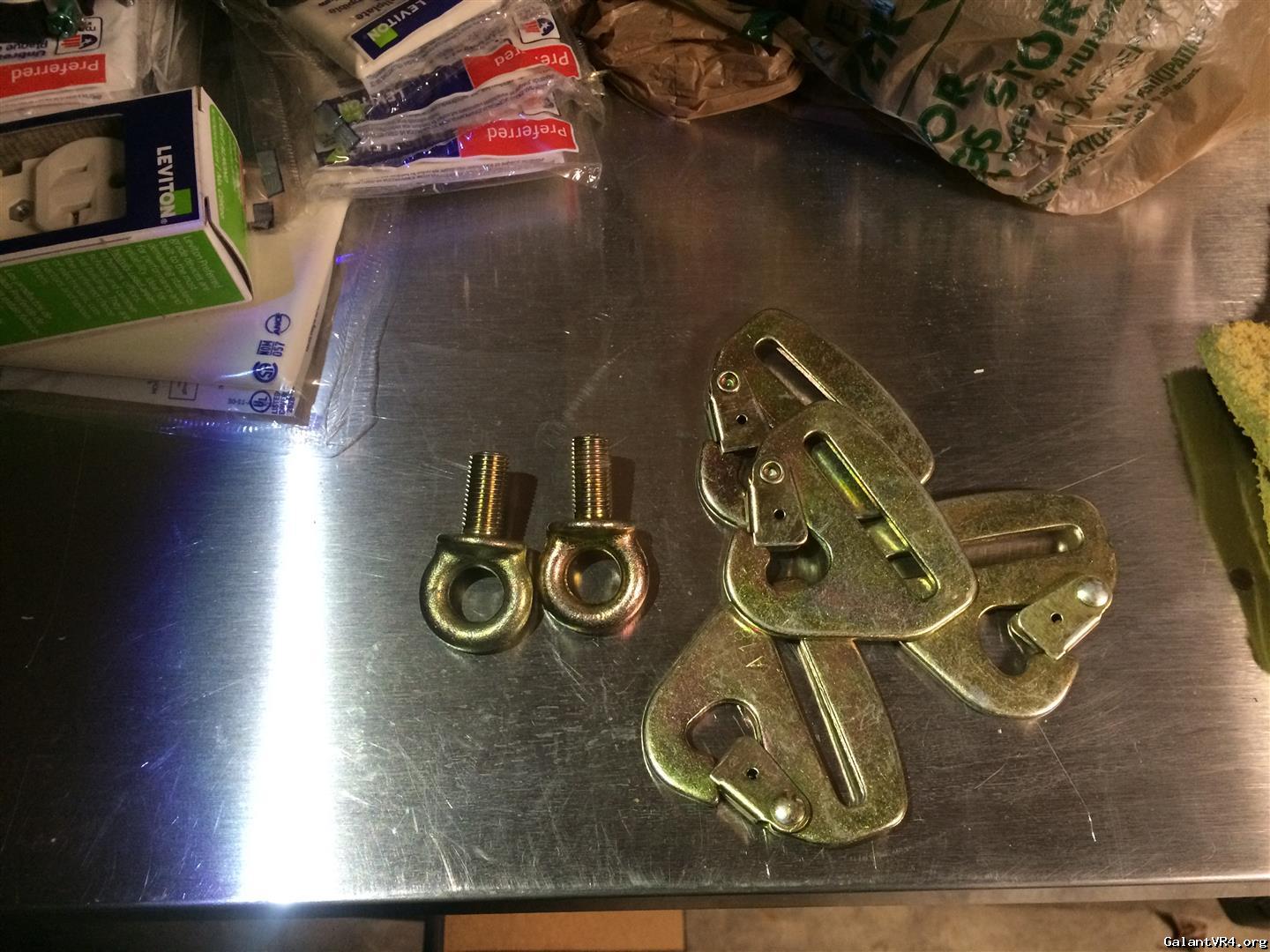

The lap belt is the only iffy part. They can only mount to eye bolts via the clippy or whatever the hell is on the end of the belt. I got the set G had for sale. You can see in the pic they have the eyelet clips on the lap belts:

I'm pretty sure those Sparco eyebolts are exactly what I have. See pic below. And yeah, the Raptor is a blast. /ubbthreads/images/graemlins/grin.gif
3,473
Thanks for digging those up, Mark. Are those the ones you have installed in the pics I reposted above. Also, any idea what size/thread pitch those might be?
11,982
I couldn't tell you the pitch or size. But the threads look pretty fine. I'd need to do some math or use a thread pitch dealie to figure it out.

my sparcos came with a slightly different bracket, that you put a regular bolt through (doesn't have the caribiner style clip on). I might have a few spares, but I don't know anymore
