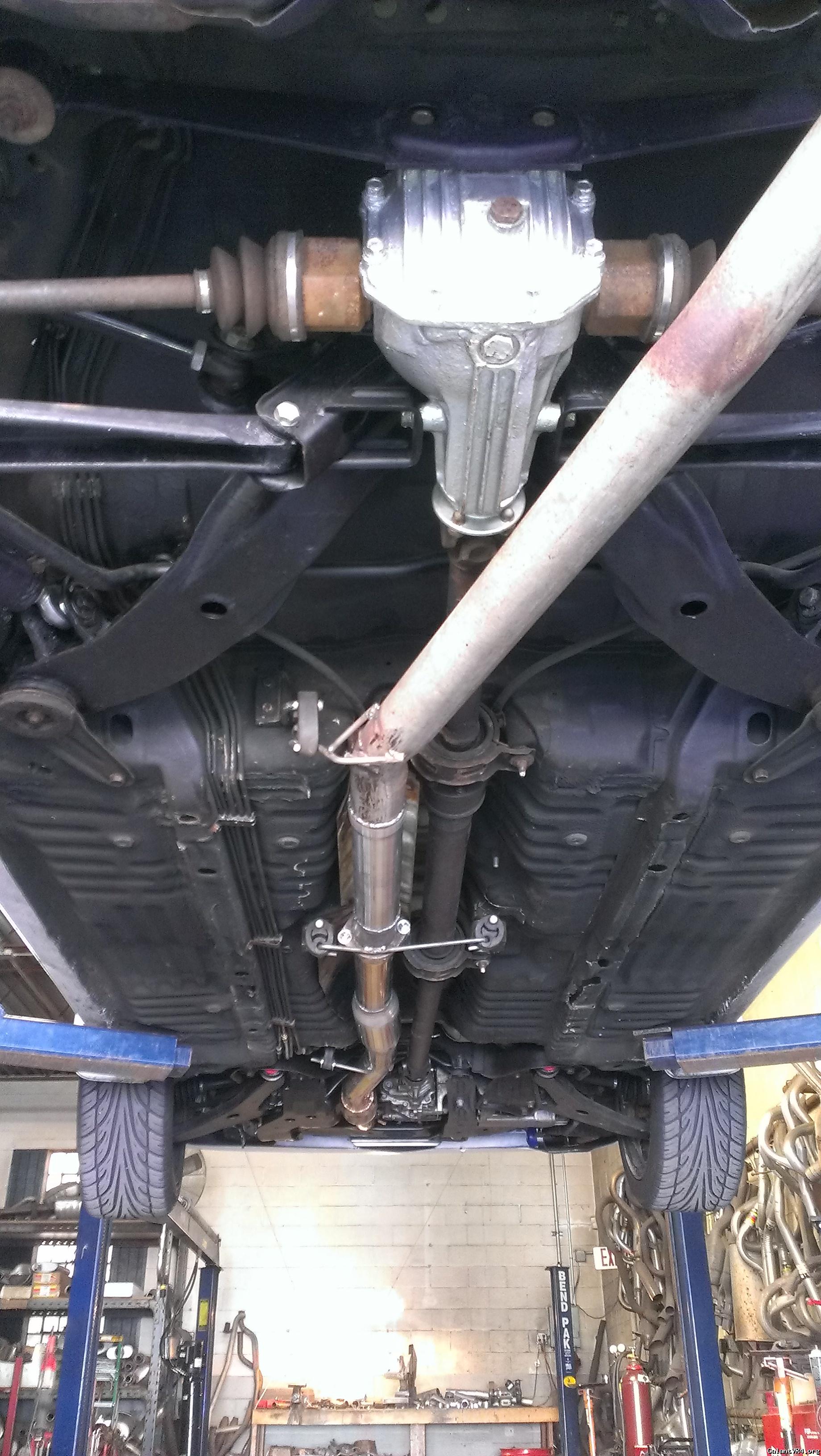

Had a vibrant resonator installed today.
It had very little effect on reducing sound. I shoud have got a bigger one. Or just went with the magnaflow. Now I don't have as much boost creep. I had exhaust leaks fixed as well so that may of had something to do with it.

Your lifting points on the front and the front right "framerail" have me like /ubbthreads/images/graemlins/uhh.gif

No, he means because they didn't use the pads of the lift on the pinch welds/subframe/frame rail etc. Just swung the arms under there and let them touch the floor and pinch welds. I'm anal, so it bothers me, but I know a lot of quick shops do this. As long as you don't have side skirts lower than the pinch welds, it's probably not hurting anything. You'll never see me do it on my or a customers car at home though.

I did that to a cop car once at work, dodge charger. I positioned the pads under the frame rail and the arms caught the pinch weld before the pads contacted. I didn't notice until the car was already off the ground and figured it would be ok. It was.
On another note, at my old job I saw somebody lift a dodge sprinter by the pinch welds. It looked fine but I know those things are fairly heavy. After he lowered it the doors barely opened due to body deformation. The customer was so pissed. That's always been a good reminder for me to watch where I'm lifting from.
