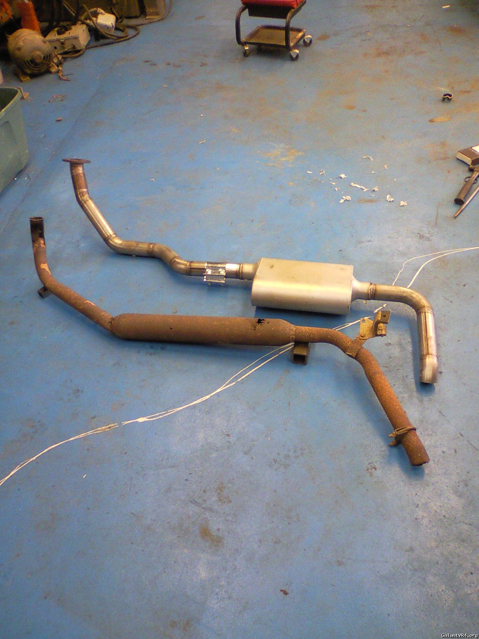

I made a full 3" from the turbo back for my car out of mandrel bent stainless pipe all tig welded. I run a fabrication business and figure I can do these for $750-900 depending on what cat and muffler are used. I'm in Indianapolis, so a little bit of a drive, but not to bad. Could do it in one day and you could drive home!
For some reason I can not find pictures of my VR4 exhaust, but here is one of a Dodge A100 I did recently.
