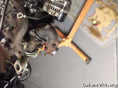

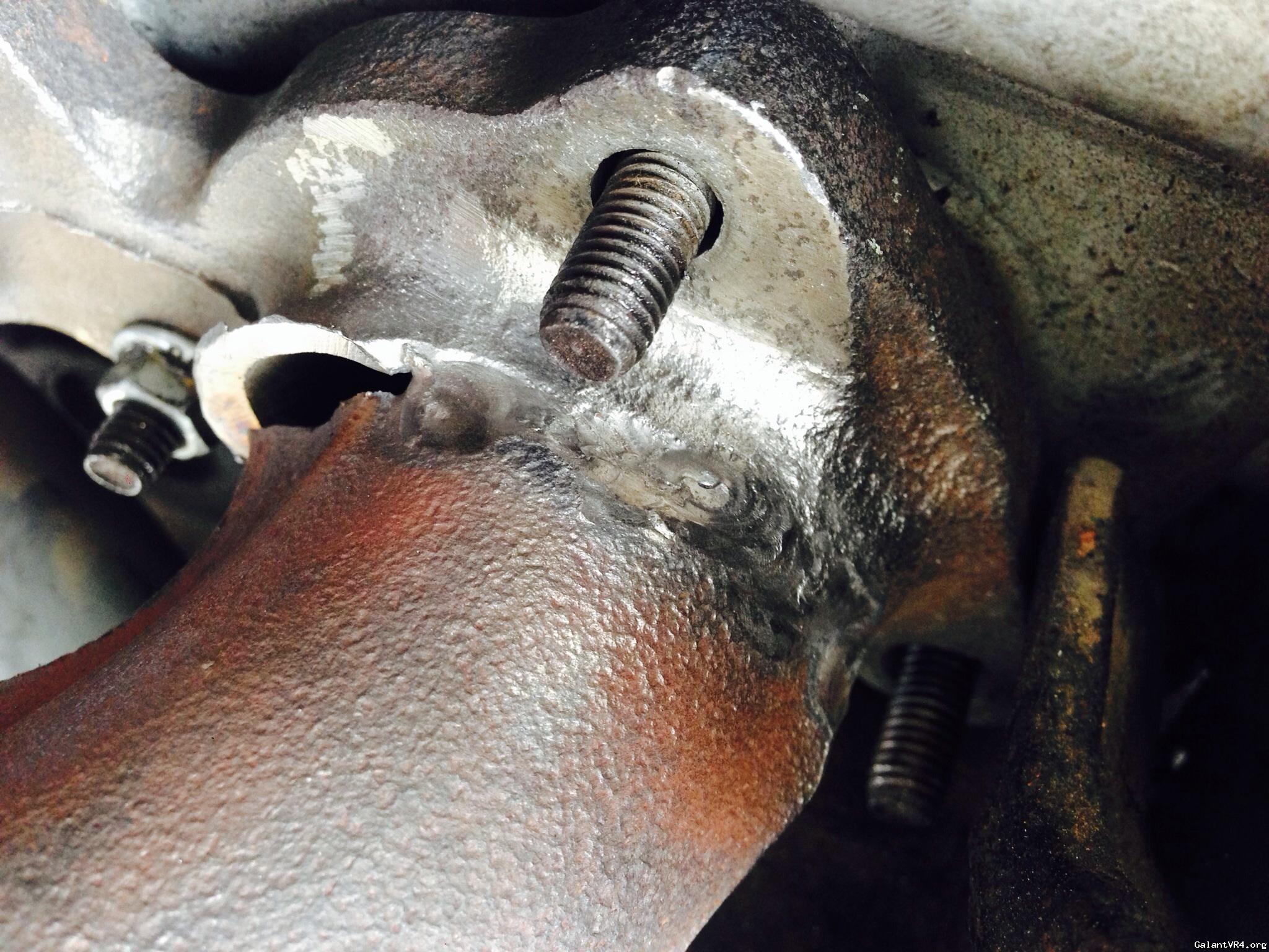

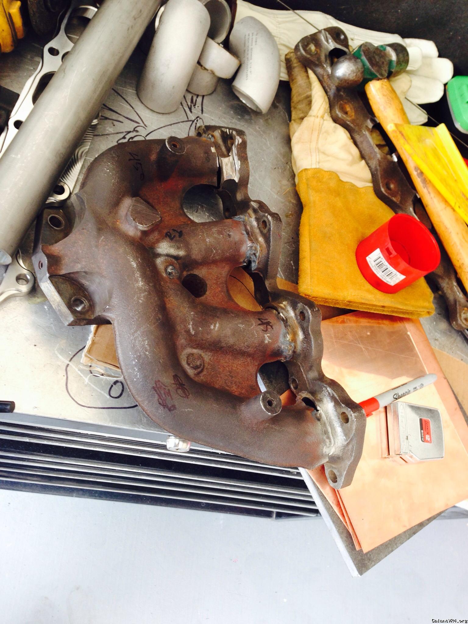

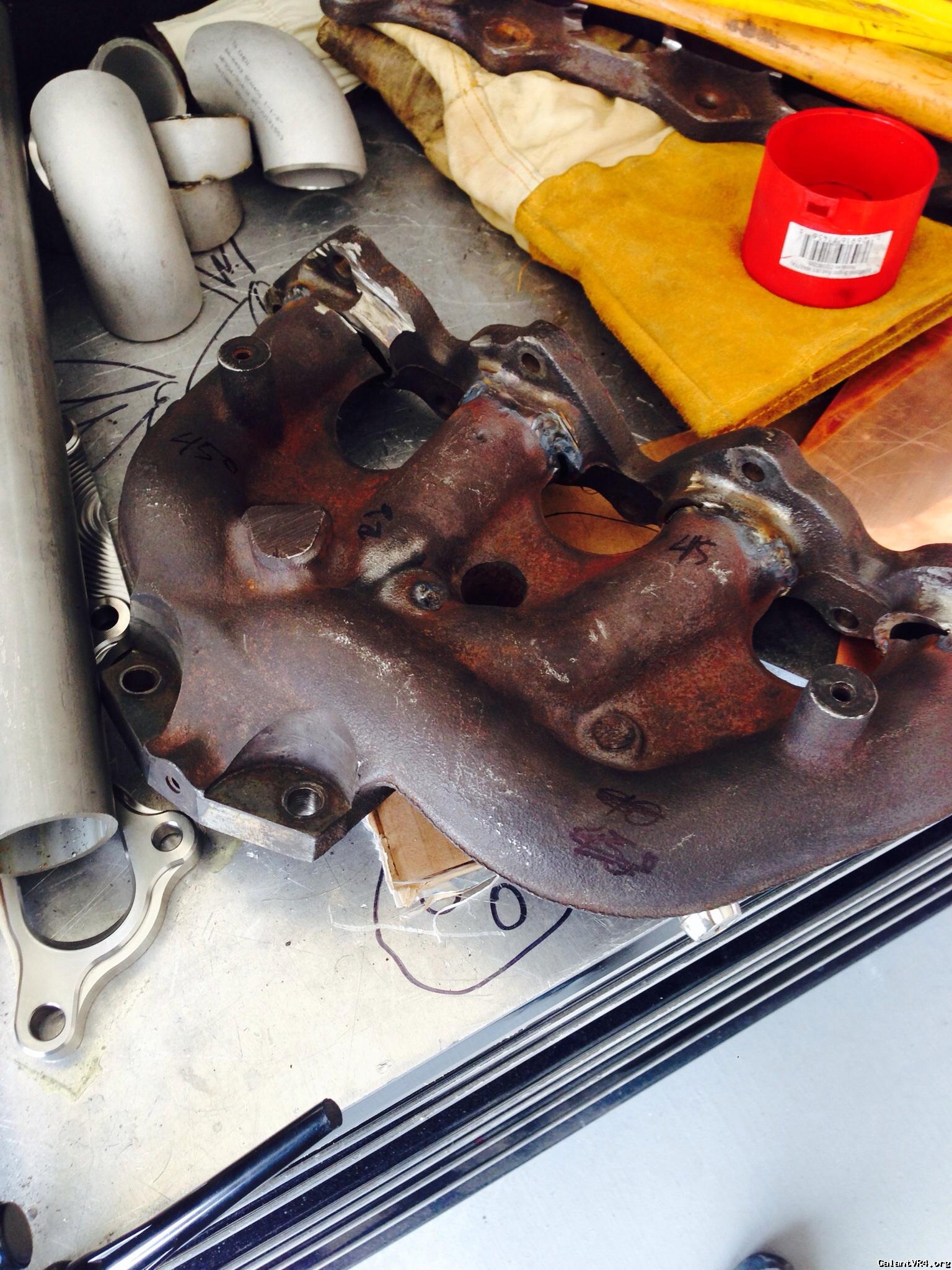

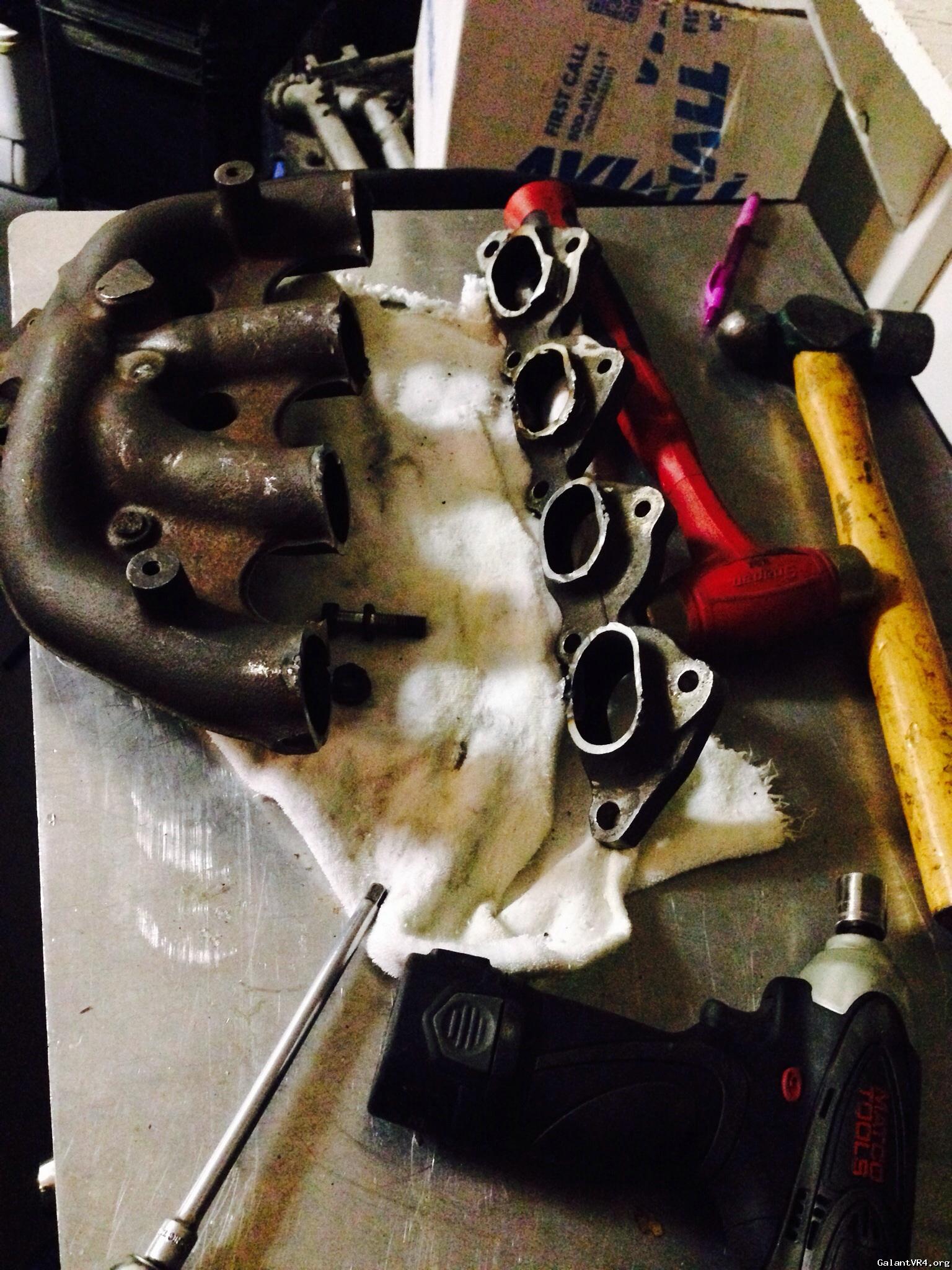

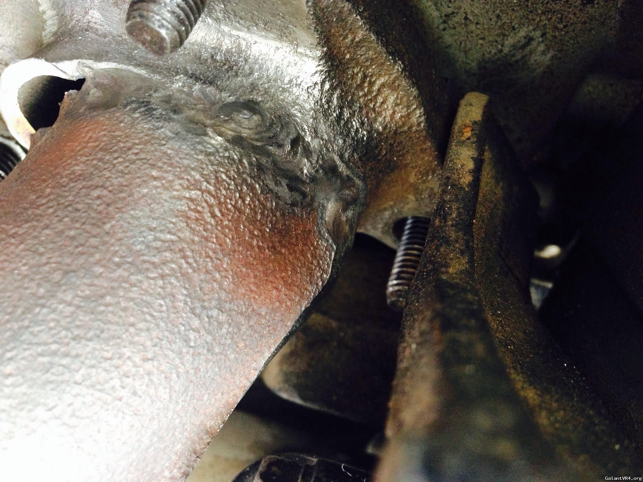

Heres something I have been trying to do for some time now. Finally have some home time from work and a nice garage to do all my welding in. I am following this build, justt with some minor changes. click
Using this new cast steel filler rod called ezweld, worked good so far. Will heat the welds red hot and beat on them with a hammer to see if they hold.

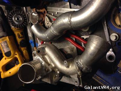

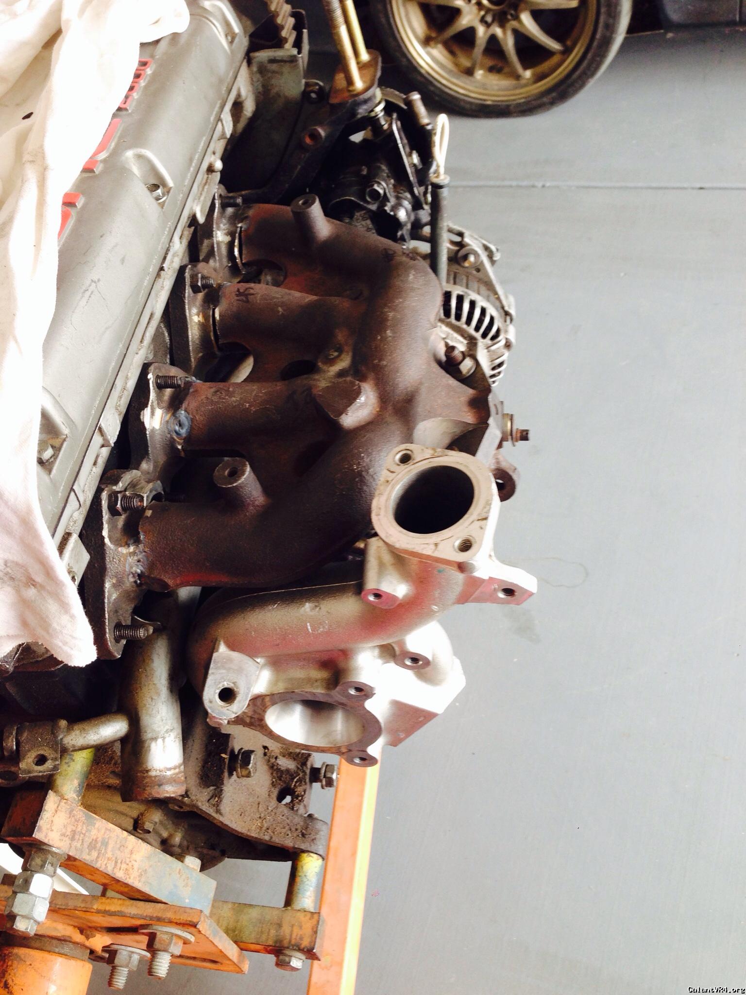

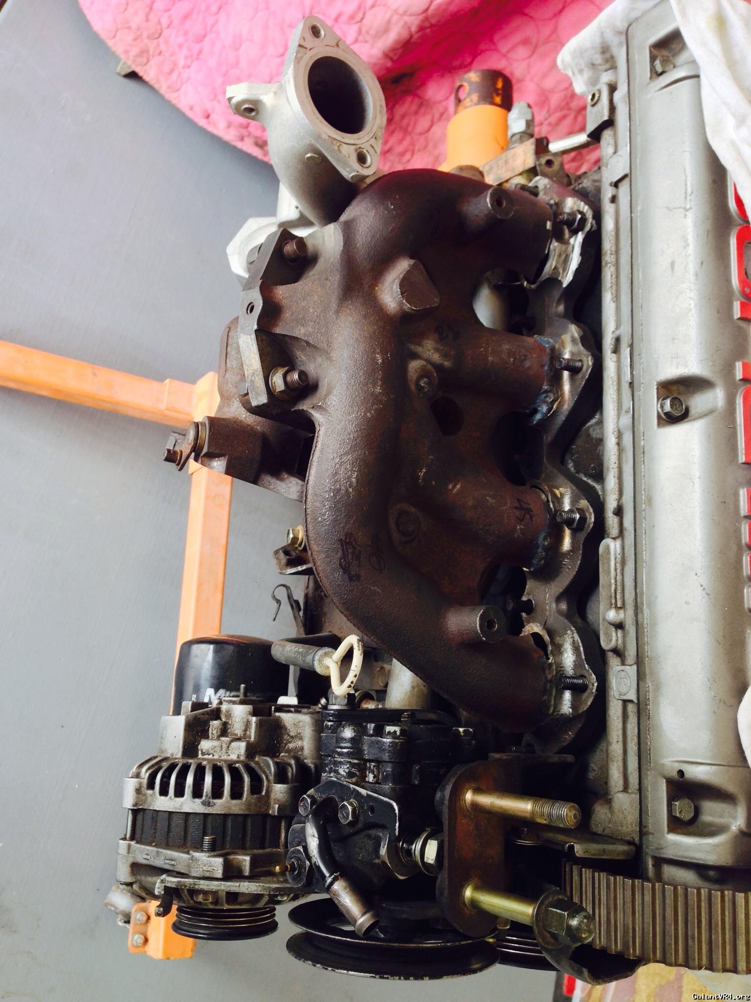

Heres how it looks with the evo x turbo installed on a spare motor I have wheeling around

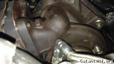

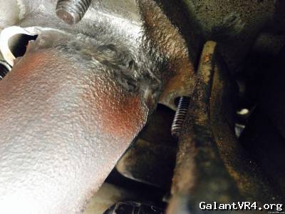

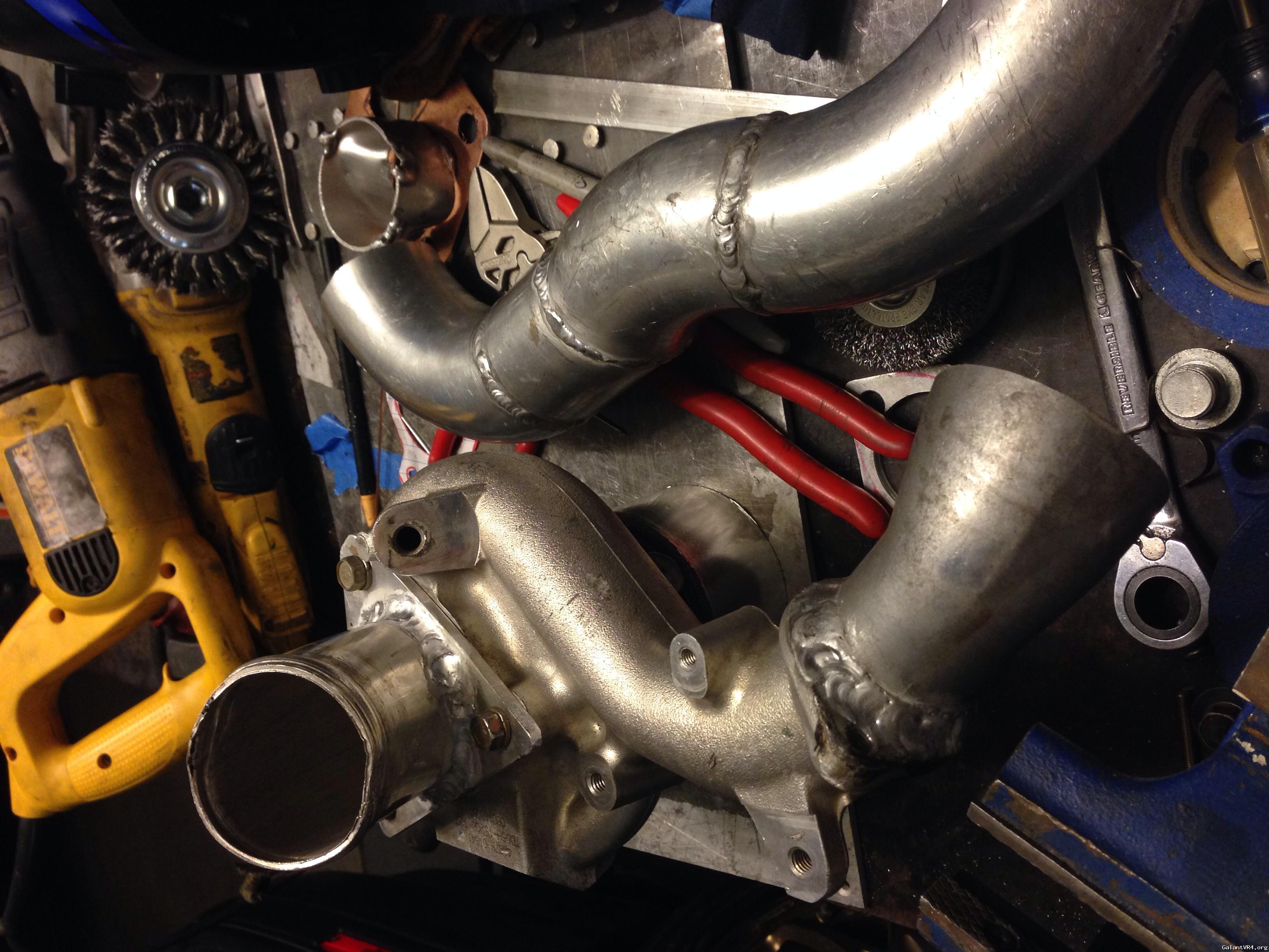

Close up of these welds, hope they hold as these guys really praise there product. Still have to fill in the voids and port match it.

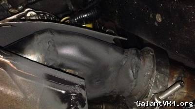

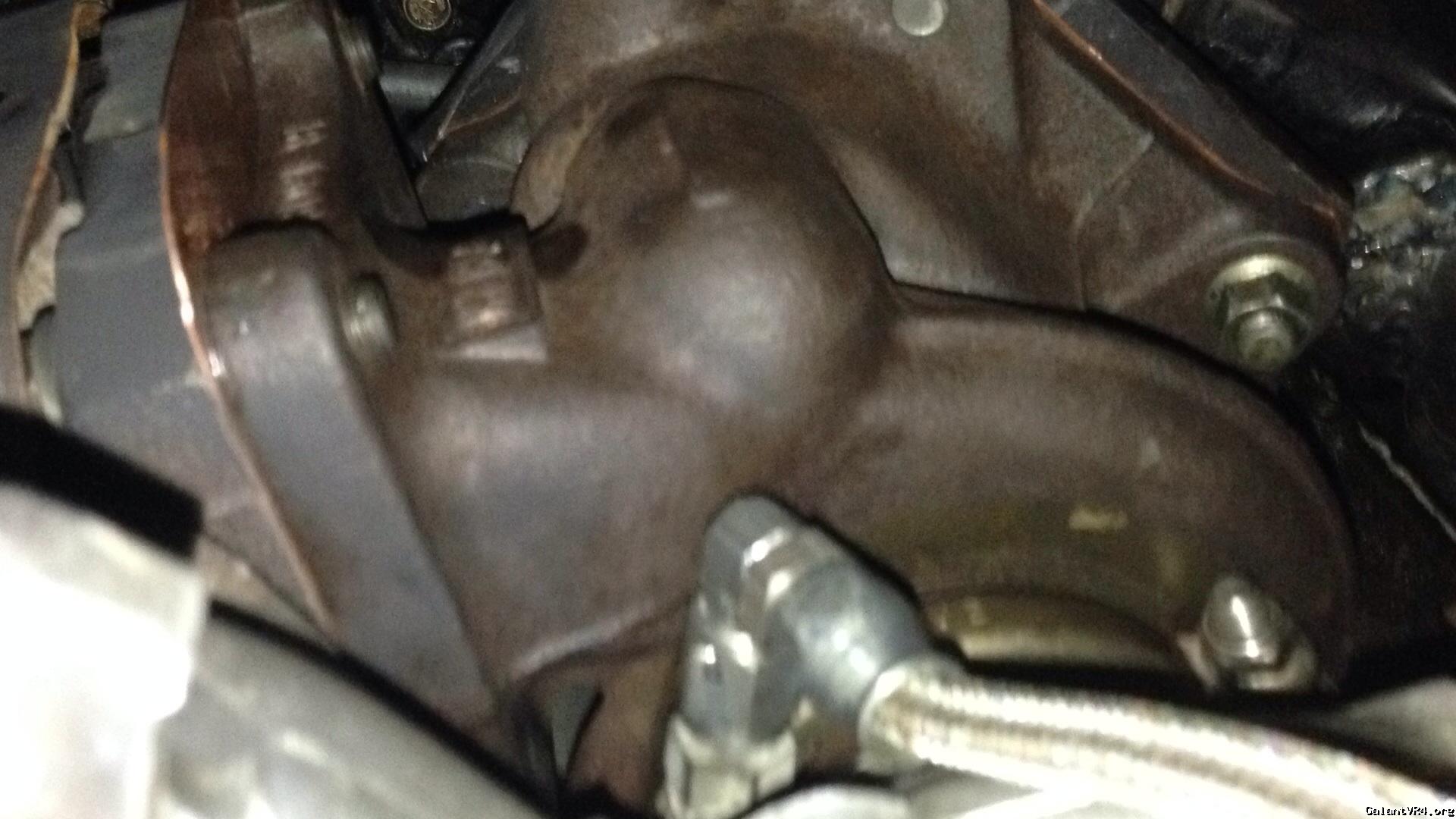

Heres how the O2 housing sits, will have to reroute or make a custom one. Goal is to clear everything just like a stock O2/down pipe

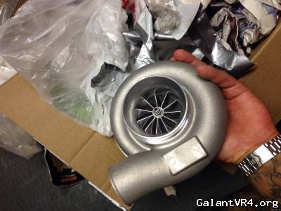

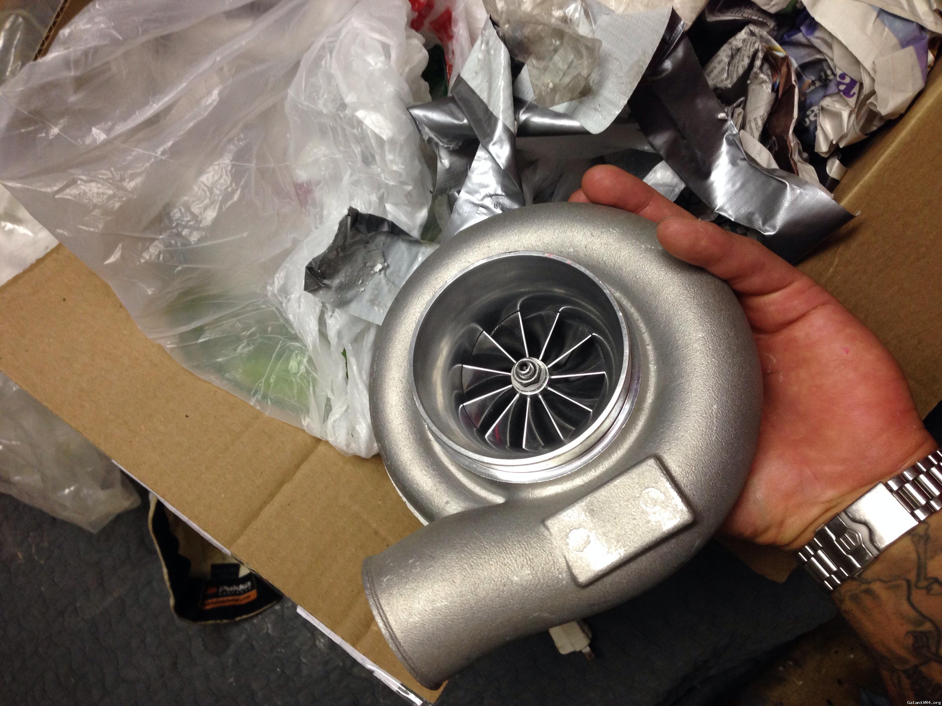

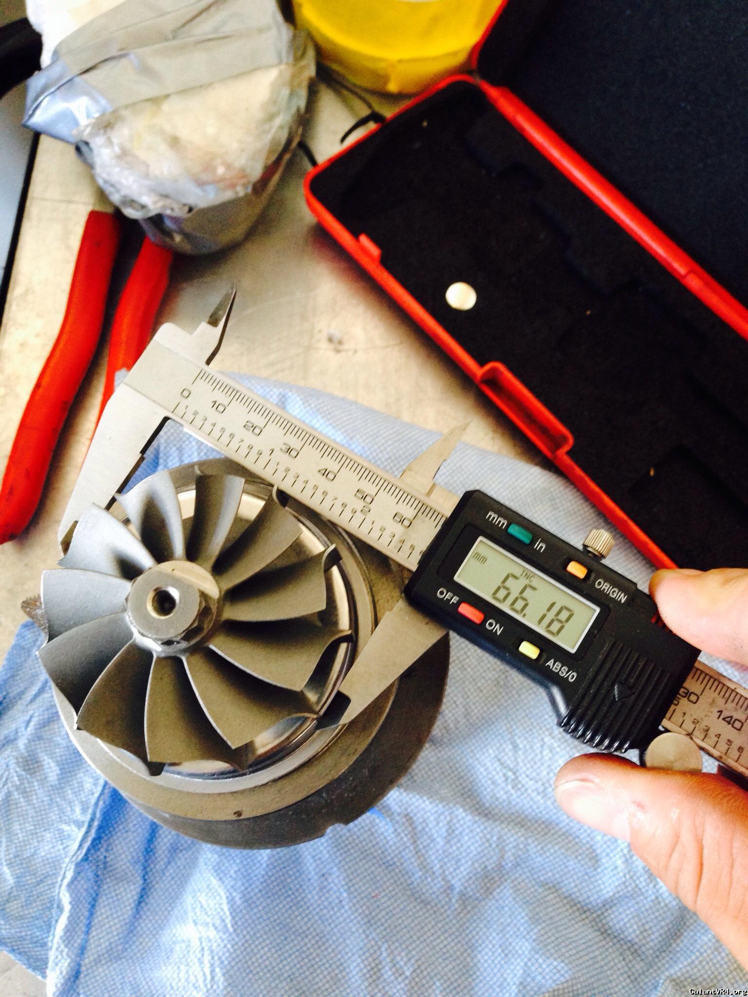

Yeah I was waiting for 16 g comment. The only reason im doing this is that the turbo setup was free, 15xxx mile evo x turbo. Im running a 3071r on my gay and the street performance thru the auto is less than stellar. If this works out good then I can get a billet turbo upgrade from turbolab for 800 so still not breaking the bank. And be twinscroll so still great spool.

My good friend has a tuner shop here in town, and often go on final test rides. For street you cant beat the twin scroll response from these evo 8/9/10. I too was looking into a billet 20g upgrade as there 450 bucks from turbolab.

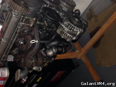

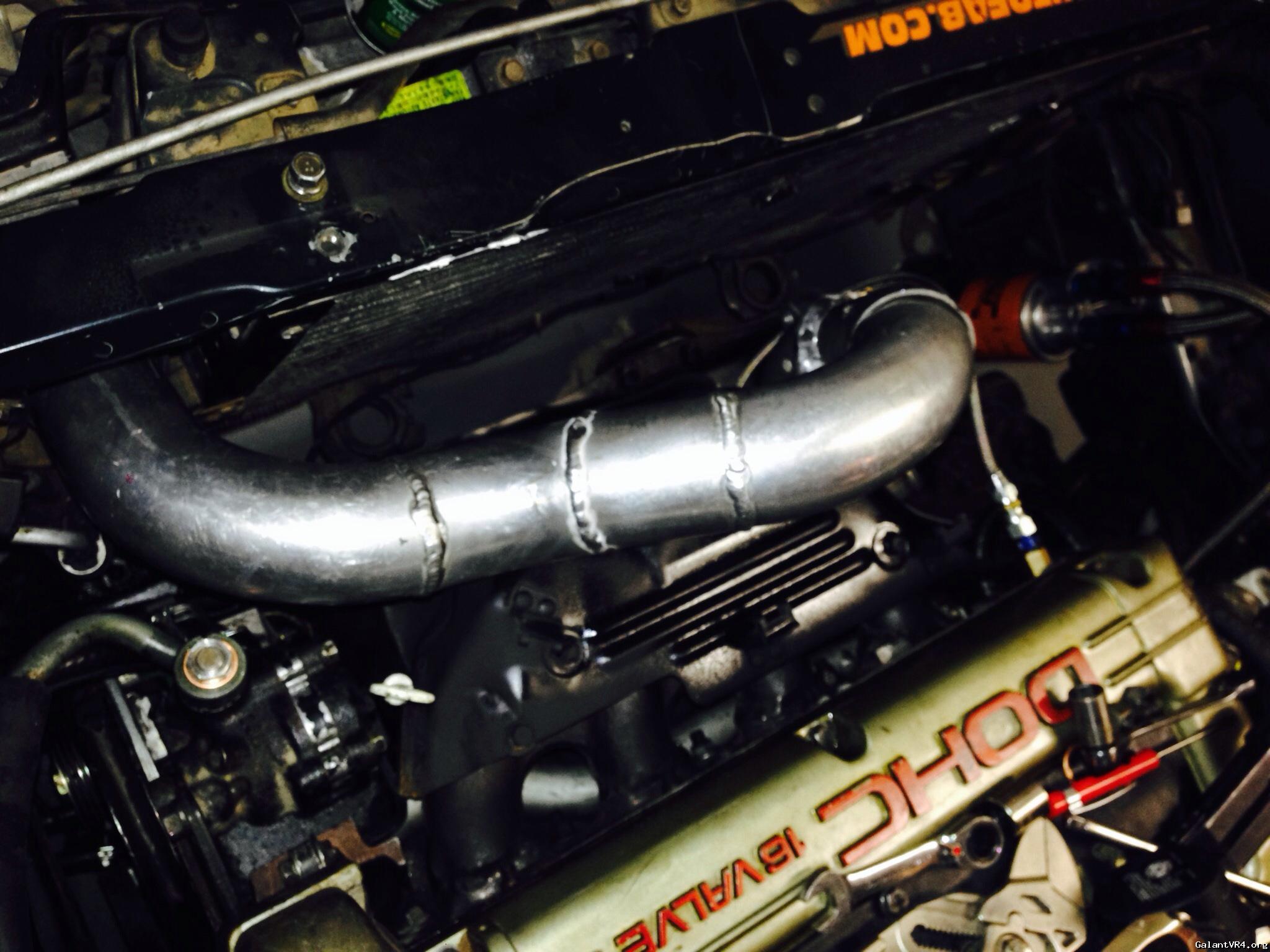

Updating this a little. Finally have been home long enough to make some progress on this.
A couple intake and charge piping

As it sits installed, made a heat sheild for the O2 out of some sheet stainless and used the stock 1g manifold heat sheild.

Still need to install radiator, oil change and clean up before I can run it. Hoping its a fun setup for street. Overall I have about 20 hours into this. Not all at once as everytime I get back home I clean and organize my work area.

Another option is to make a half inch or so thick adapter plate between the 4G63 flange and 4B11 flange so you can just bolt the whole manifold on complete. It just means shortening some manifold studs on the head and running two gaskets but it could still work out easier and more reliable than welding and trying to fill in blanks and port match what you have.
Is it just the USDM Evo X turbos that are crap? I was under the impression the regular (ie JDM/Aus/Euro/NZ etc) Evo X turbos were good.
dsmless
Jun 12, 2008
224
tucson,az
I could not say for sure if the x turbos are crap, will find out. I did think about the adapter plate but as it sits theres about 1/2" clearance from turbo to radiator so you would have to run a slimmer radiator. For me thats a no no. I will have to figure something out when I make a tube header and run this 20g billet variant in TS form
