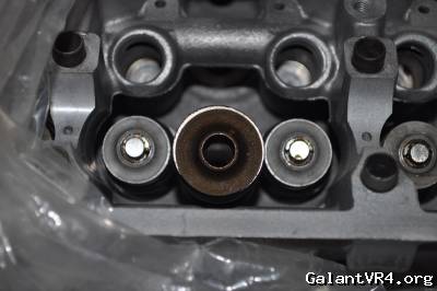

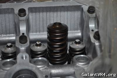

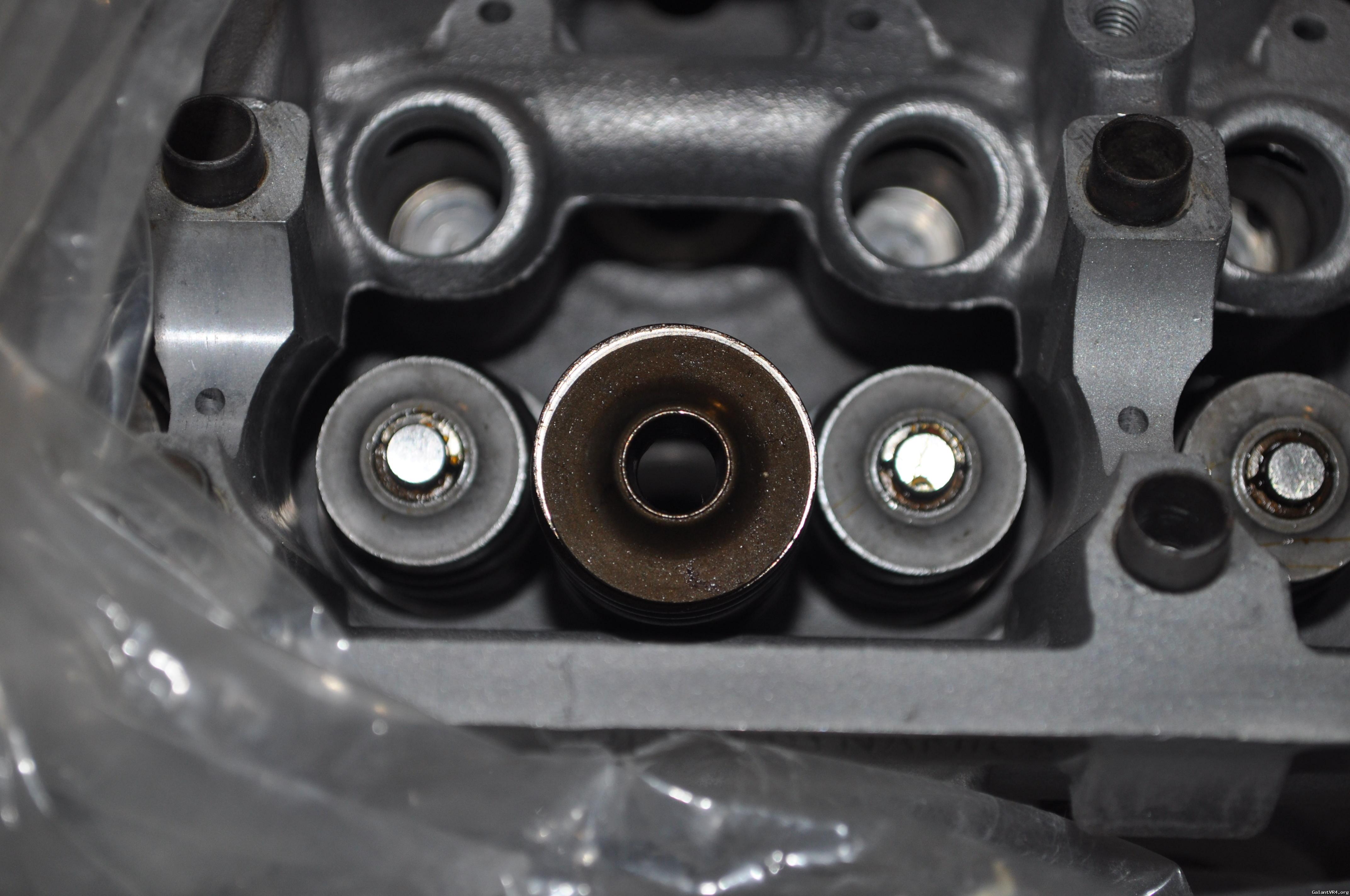

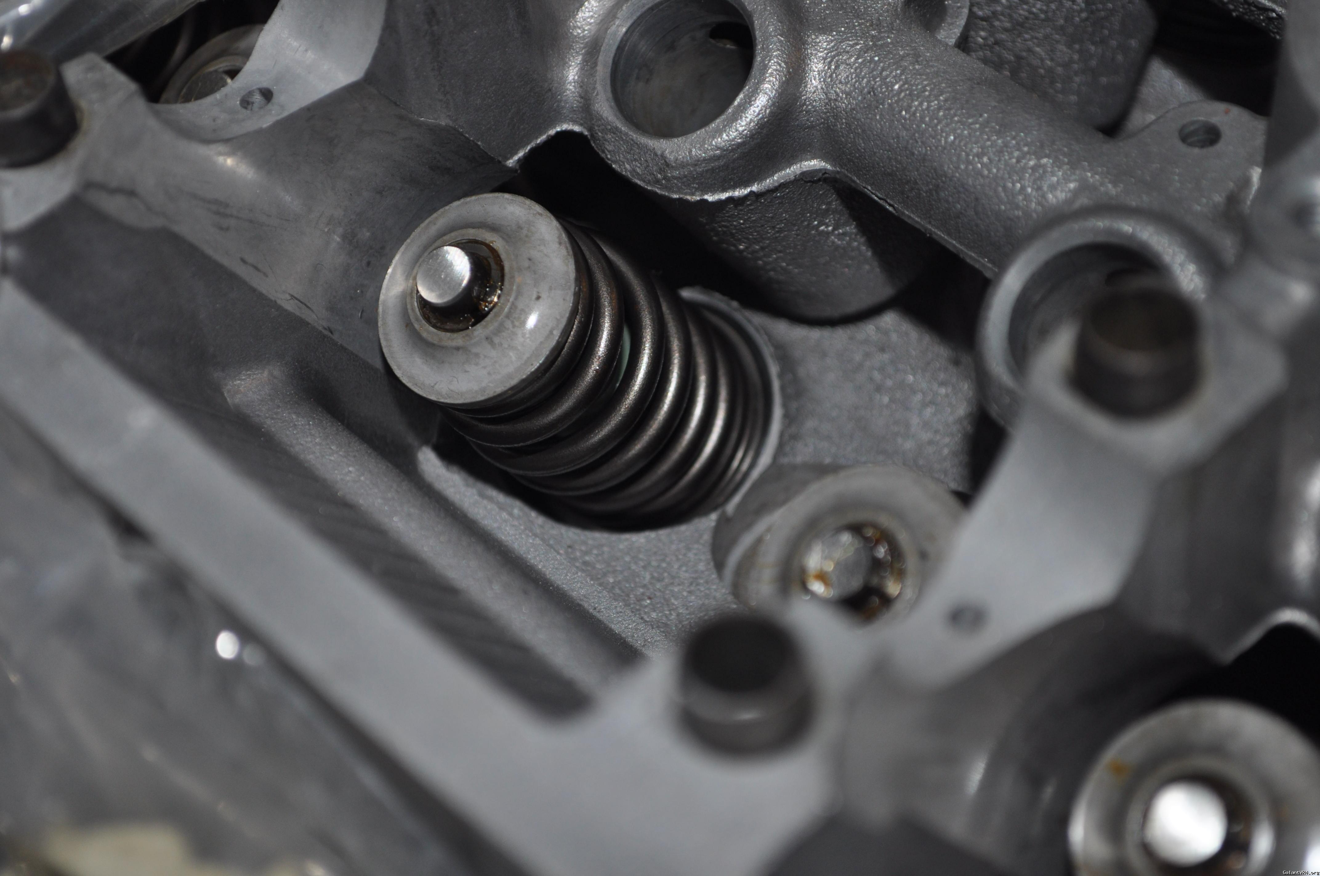

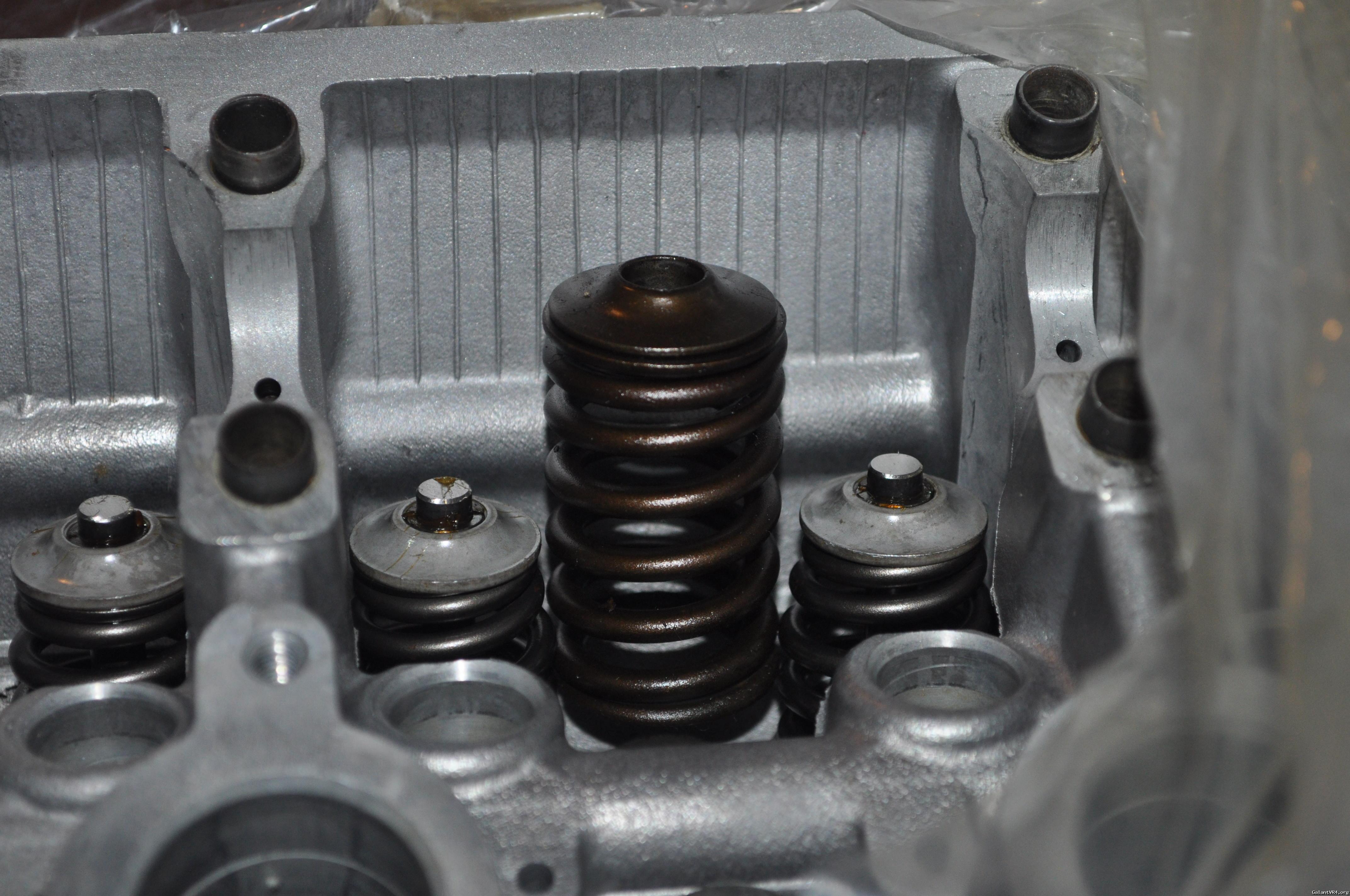

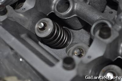

Couple pics from my grimey basement for reference:
Evo Valves and springs in a 1g head. 1g Spring and retainer for comparison.
